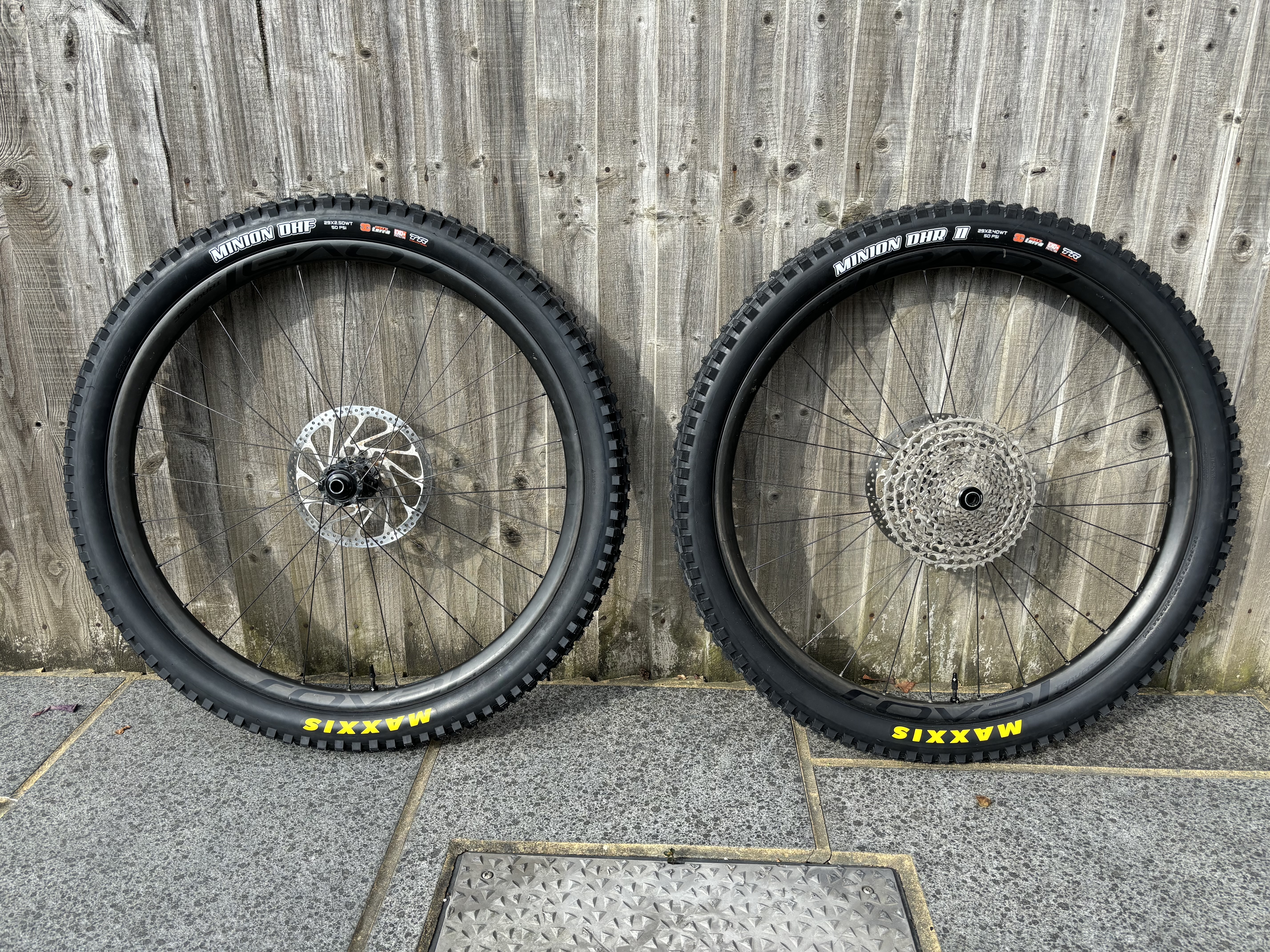

Finally got around to taking off the Bont-trasher tires and putting on Assegai & Dhr2s. The thick rim strip on the wheels made it extremely challenging to mount the new tires. Normally you can just position the tire in the center channel and the tire will go on easy. The rim strip is so thick that it doesn't give you much room to play with. I did manage to mount the tires eventually resorting to every trick in the book. But in retrospect I should just have removed the rim strip and replaced with regular rim tape. It would have been a lot less effort
So just a word of advice to everyone. Yank that rim strip and replace with rim tape. Save yourself a lot of frustration
I was lucky that I had my old carbon wheels. The DHF/DHR slid straight on. As good as those rim strips are they have previously made me very angry lol

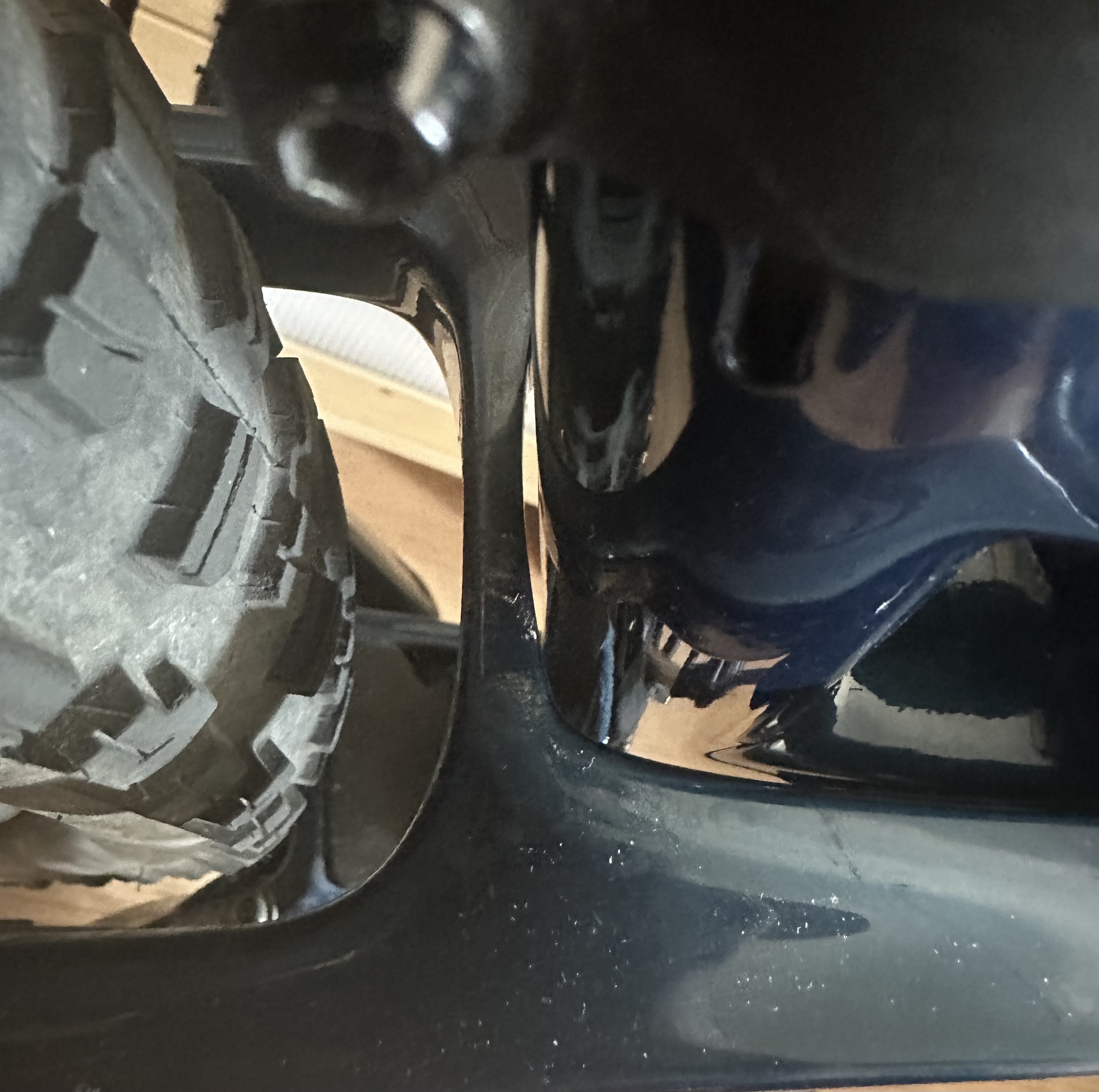

@Emailsucks98 Do you happen to know the height of the bottom out bumper in the ttx1 air? Couldn't really find any info on that and haven't opened the shock yet. I'm having about 3-4mm clearance when the shock is fully deflated / compressed. Kinda undecided atm. whether I want to the risk or not. 😅
Emailsucks98
Nov 12, 2020
Wow! Interesting. Yeah, that looks a little scary. So when I have changed volume spacers, I didn't see any sort of BO bumper in the air chamber, just the white "top hat" that the volume spacers clip on to.
Could you measure your sock stroke at full compression? I'd be happy to do the same on mine. Ohlins says my shock was rebuilt to 65mm stroke but I've never gotten that much out of it. I have also heard from a reputable source that no 205mm shock actually gets 65mm stroke, it's purely hypothetical.
The sag indicator was pretty much all the way at the top, so full stroke. Measured 63-64mm-ish, a bit hard to reach with a vernier caliper. Now keep in mind that is fully deflated with me pressing down on the saddle (mino-link on low). Don't know whether this is actually realistic in a real world riding scenario.
Edit: Reading it again, or do you rather mean measuring the leftover stroke when fully compressed? :D Even though it should be the same result.

I run TTX1 205x65 as it came from factory. Msize frame, no probs with clearance. I use full stroke (by sag indicator).
Interesting, same setup then. Did you ever check the clearance with no air in the shock? Also I assume no volume spacers?
Did not check, because before TTX1 I run Float X also 65 stroke with no issues. Have no idea how big bo spacer is inside.

Week ago I broke carbon rim, hit jump landing edge, I am sure shock went max stroke to the bottom. No signs on frame.
Holy shit haha, hope you're doing okay. Yea that shock would've most definitely bottomed out. 😄
Thanks a lot for the input though, I guess it'll be fine then. Mino-link position also shouldn't change the bottom out clearance from a few posts I've seen here.
I'm glad @Jazzii has some feedback for you, cause I am up at whistler with the coil shock so I can't help with any measurements!
The mino link does make a difference I think, and I typically run mullet with the Mino Link in high, which would create additional clearance. I have occasionally ran 29" /Low and never had issues- but maybe only a dozen rides. Hypothetically ALL 205x65mm shocks should create the same "worst case" clearance scenario with the seatstay bridge. The reservoir is what varies and the Ohlins is great there, since it is sideways. I'm pretty sure you're good but it doesn't hurt to verify.
