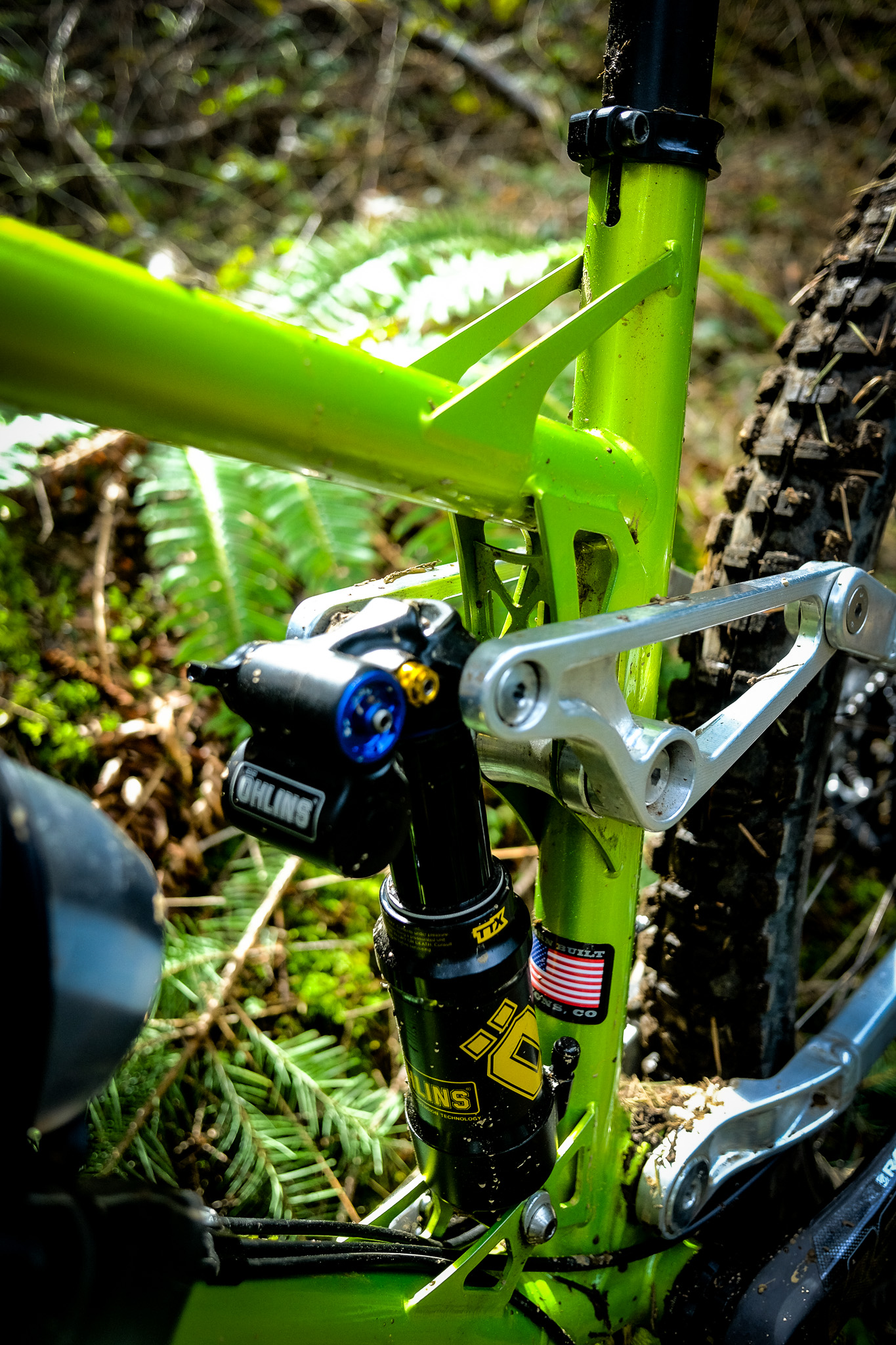

Hey @Emailsucks98, are you still running your TTX1 Air? What's your experience with it until now? With all the restructuring at Ohlins going on I was able to grab a 205x65 ttx1 air for a pretty good price. Chose it over the ttx2 due to a few reviews and what you wrote in #2,937. Planning to run it with 65mm travel tho on a size M frame. Being almost similar weight at ~200lbs, would you still run middle/large spacers?

I am running the Ohlins ttx1 but on a REEB Steezl now. It's been a great shock.
On the Fuel EXe I'm running an 65mm stroke Marzocchi Bomber CR that's been modified by Avalanche. They revalved, shortened the reservoir & added quite a large BO bumper. I learned quite a bit about the EXe working with Avalanche. The EXe's progression is only 16.5% with an average leverage ratio of 2.33. Since the frame is very linear, it can benefit from both heavier compression damping and a progressive spring- i.e. the ttx1 or the ttx2 maxed with spacers. Avalanche's opinion was that these frames are too linear for most coil shocks, mine has the thickest BO bumper he makes.
My experience with the Ohlins was that towards end of season, I noticed bottoming out more frequently, which I addressed by adding spacers. I sent the shock in for service at 9 months of riding and was told the shock was way overdue for a full rebuild. The entire resevoir assembly was replaced at no extra cost. That was great customer service, but also reminded me that on eBikes it's really easy to blow past the service intervals. Thus I now have two shocks of the same length I can swap between bikes.
I'm impressed with the Ohlins everytime I ride it. For the ttx1 on the Trek I would start with the next step-up from smallest volume spacer added. I recall that had me running about my body weight in lbs to get 30% sag. On the steezl I run no spacers.
Thanks a lot! Yea I figured I'll end up with two rear shocks. My rs deluxe select+ started to have a high pitched whistle/squeel, doesn't really change the performance but it's pretty annoying. I guess I'll send that one for a service and tune and can try the ttx1 in the mean time :).

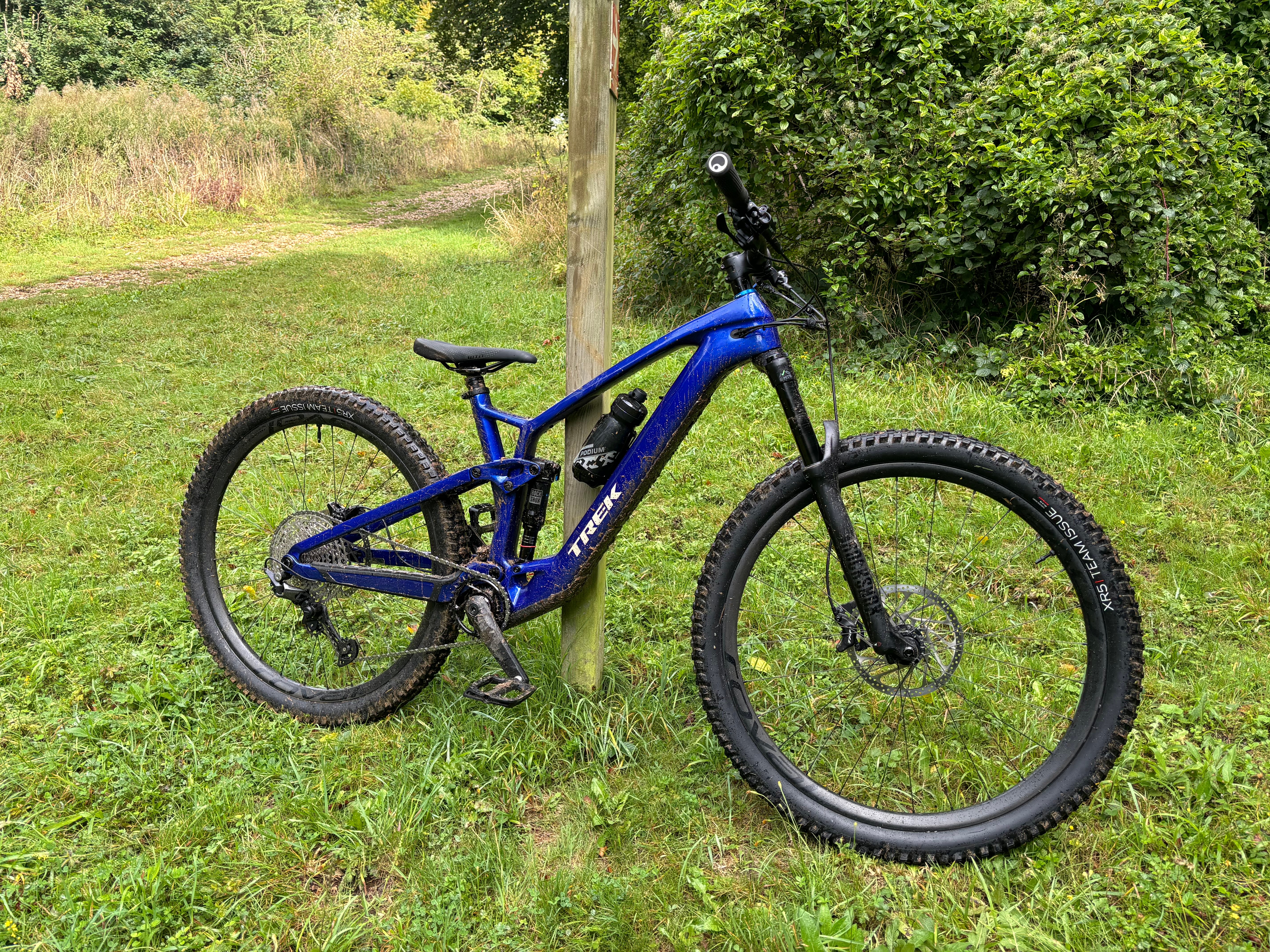

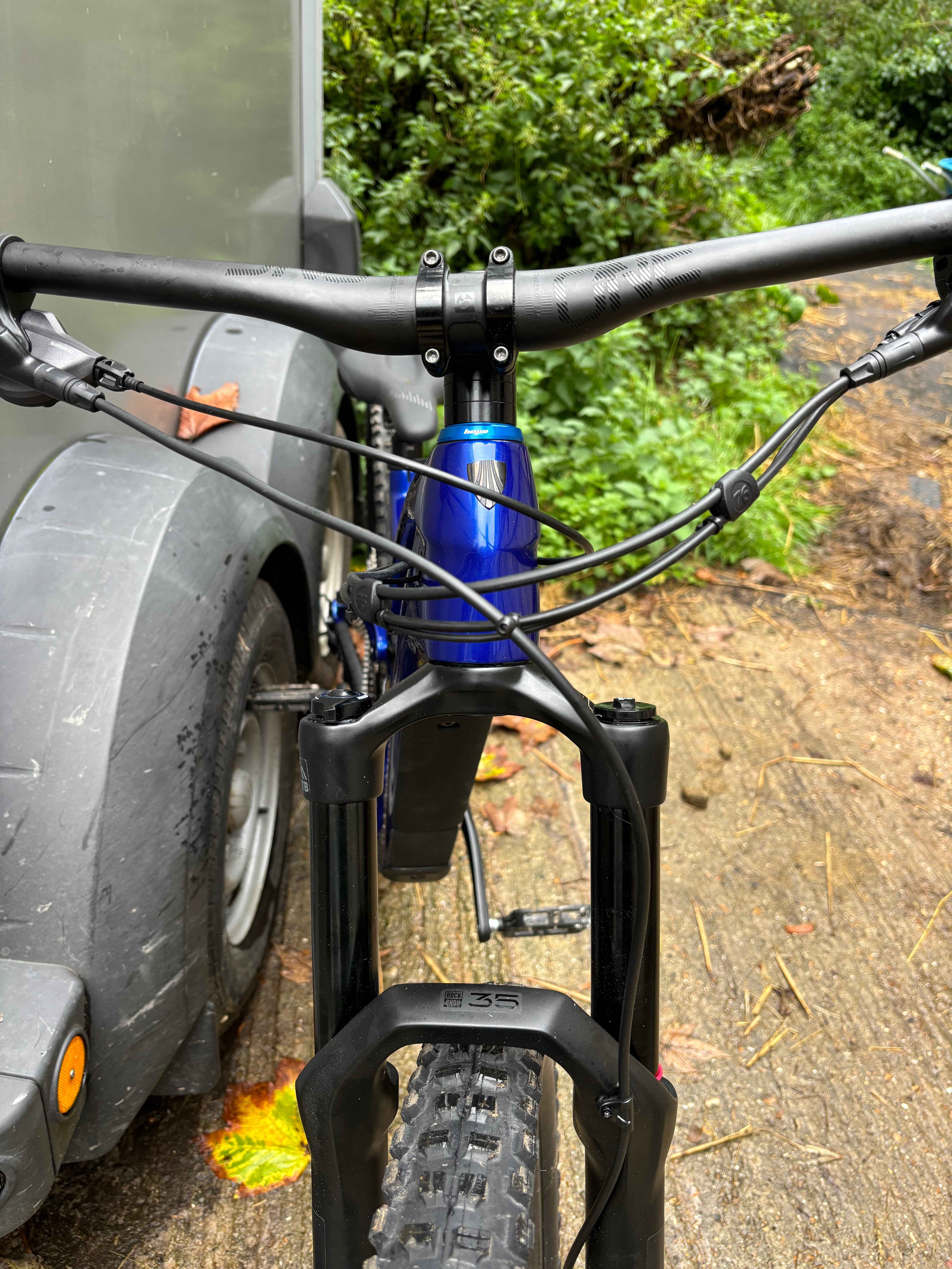

First ride out today. Very enjoyable. Like the way the bike still makes you work for it up the steep hills!
Forgot to set up my app so only went off strave. 9 miles with plenty of steep climbs. Mix of all modes and 53% left.
Things need to address. Front too firm. Think they might have set it up with too much pressure or not enough rebound.
Motor was pretty quiet. Little bit of a whistle when at max pelt but hardly anything. Probably normal behaviour?
The tyres were a little skittish is the mud and roots. Well very actually. Made me take things slower. They need to be changed pretty quickly!
Overall I am very happy. Rides really nice without power too.
XR5s (and XR4s) come alive at lower pressure. I'm 72kg on the bike and I run 1 bar F/1.2 bar R - very rocky trails

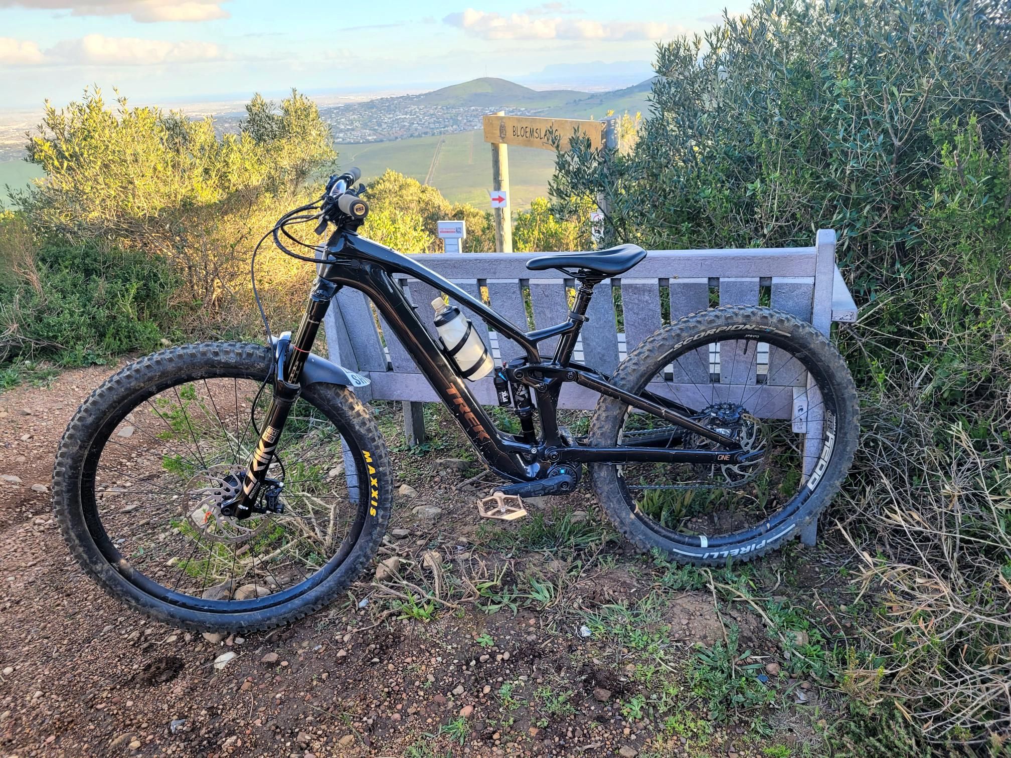

Took my fuel exe to morzine/portes du soleil at the weekend, you're not allowed to take the main battery on aeroplanes, so I left that at home and just took the range extender battery.
The bike did pretty good on all the bike park trails, despite not really being the sort of bike you might use at a bike park. Ideally I'd take a bike with more travel, but the EXe was perfectly decent.
the trails were mostly accessed by chairlift so didn't really need any motor assistance most of the time , but we went over to chatel one day, and as it's the off season for them now ,the chairlift linking morzine and chatel was not running, so we had to climb 500m on our own. The range extender managed this fine, had 6% left after this climb.

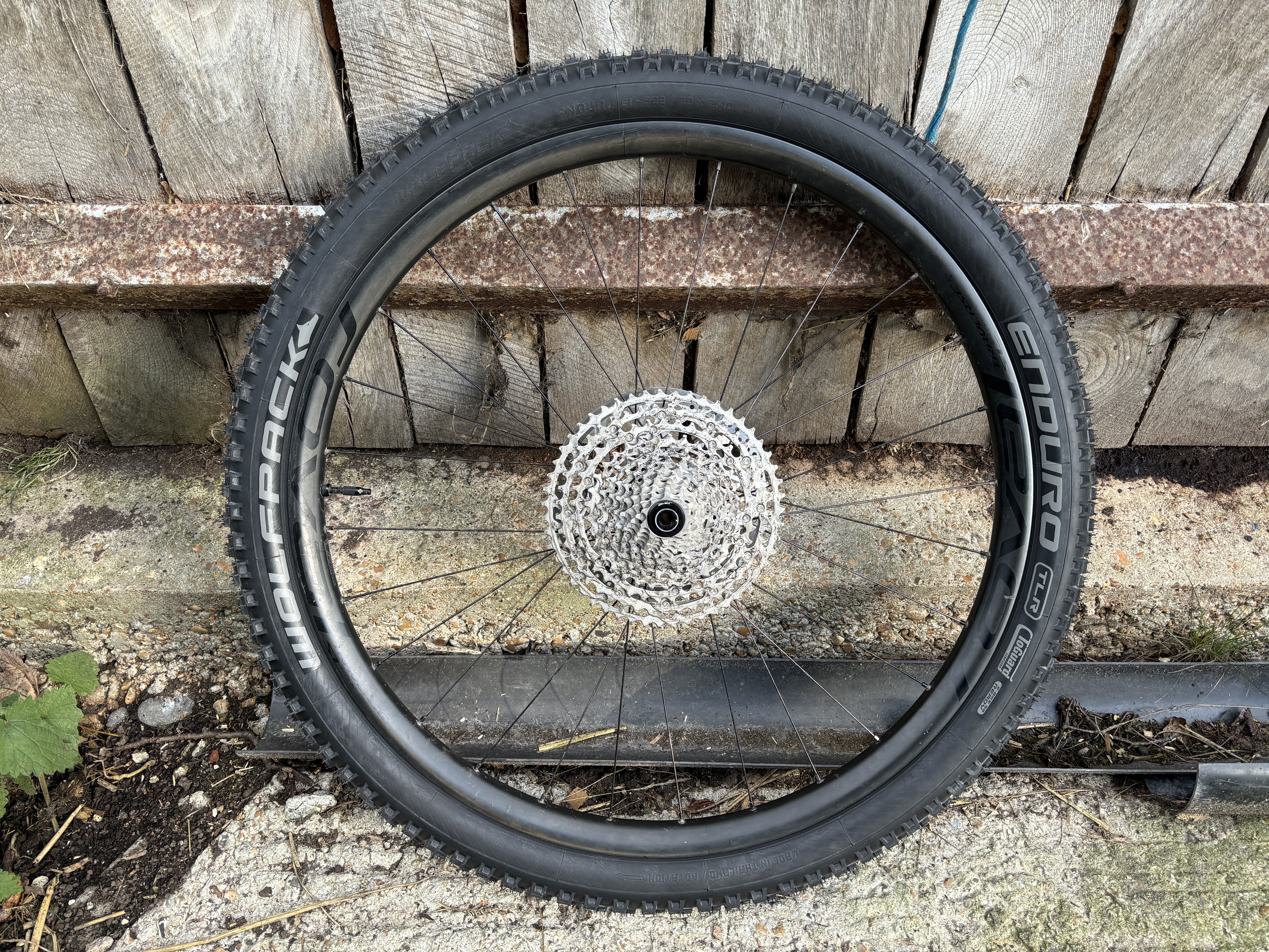

Trying out some more tyres from Wolfpack. Had a Speed and Cross on the old Fuel EX during the brief try UK season which I really liked so giving these Enduro ones a go in 2.4 flavour front and rear this weekend.
Mounted pretty nice and no sign of leaks so far!
