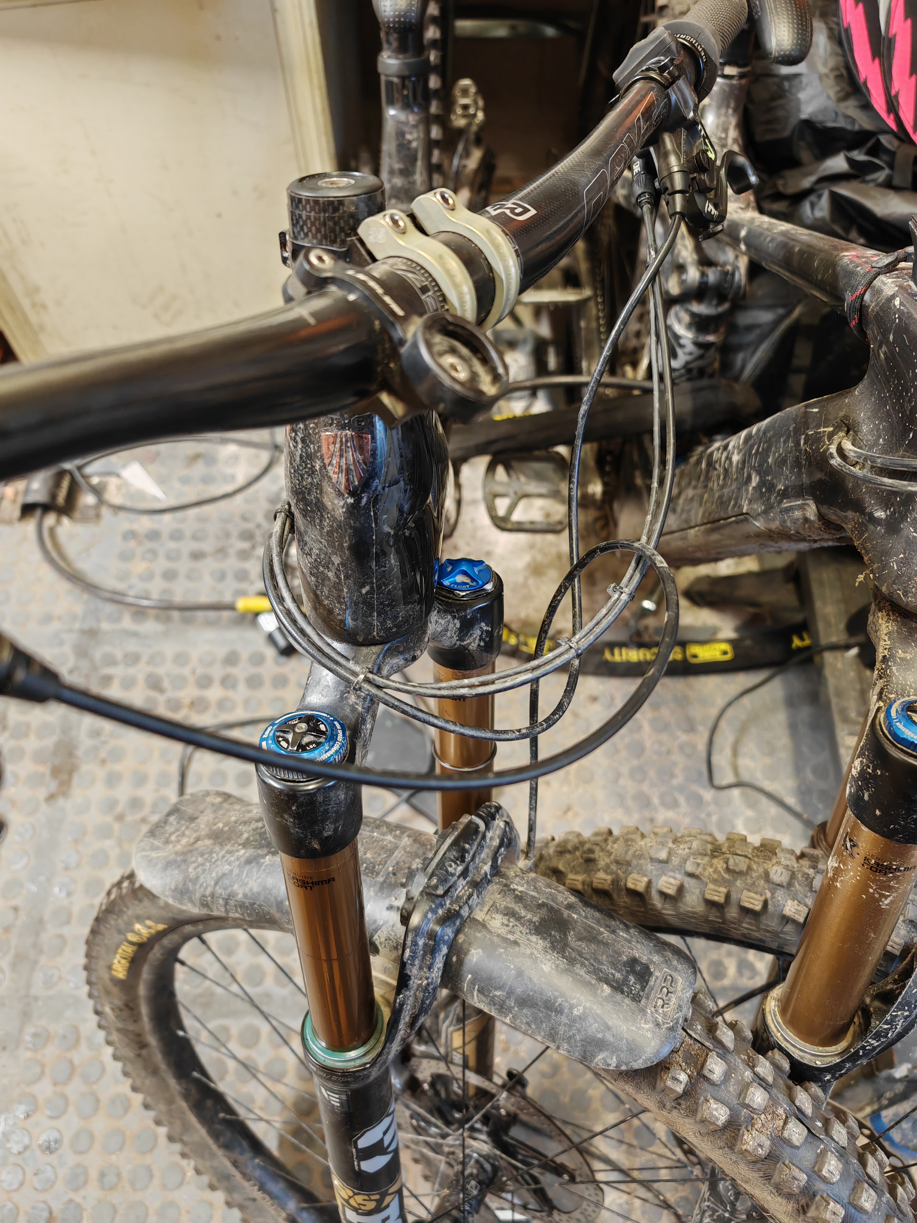

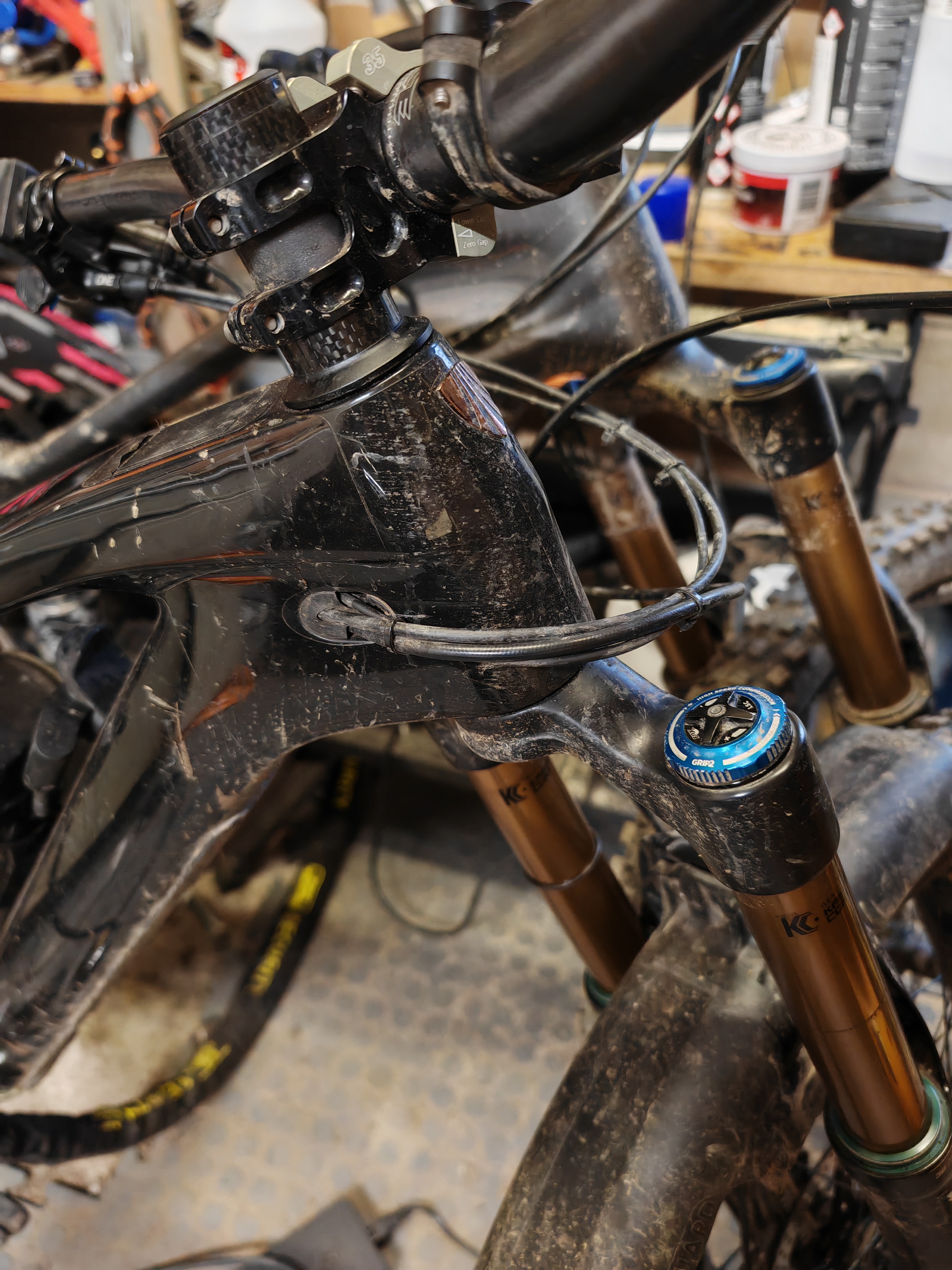

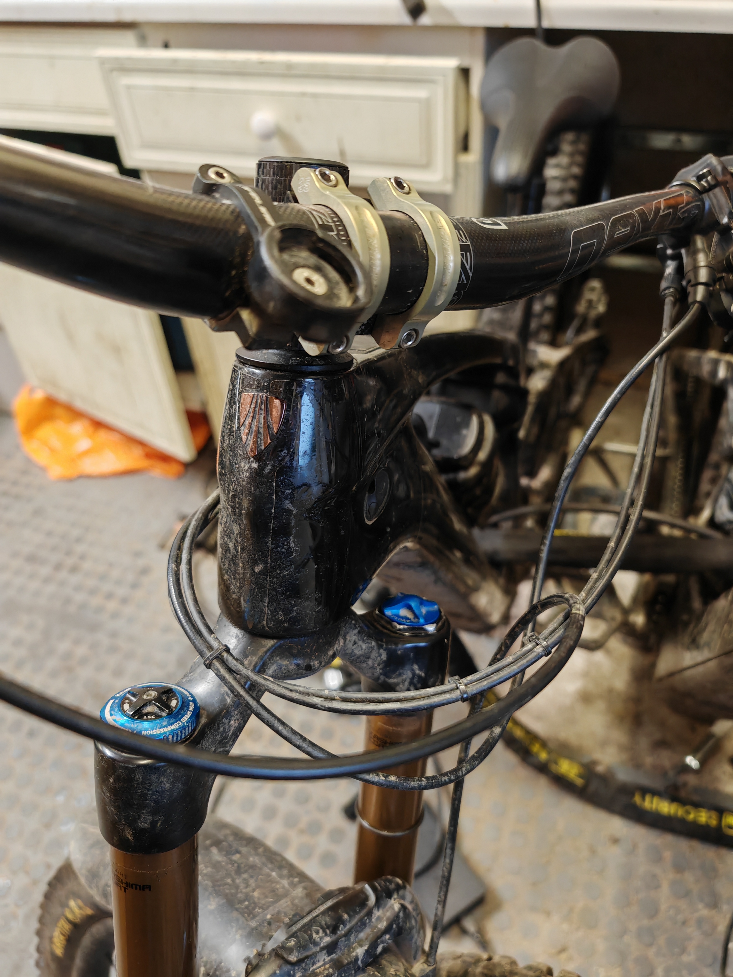

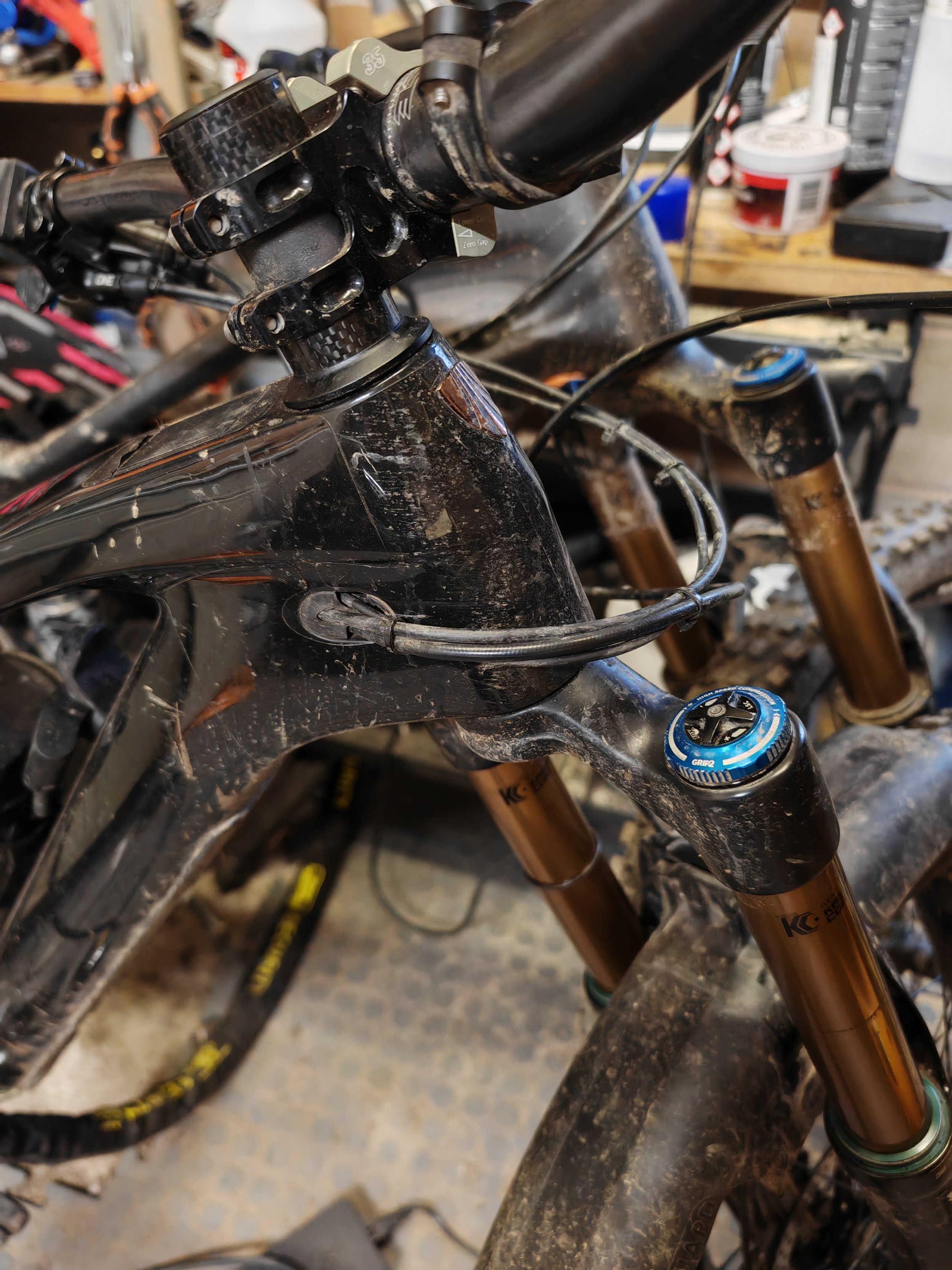

Random request, but could you take a photo/photos of the set up? Bike shop said they would set them up how I like so thought if I show them it couldn’t possibly go wrong!!
Mteam
Aug 3, 2020
1,920
1,855
gone
Here you go

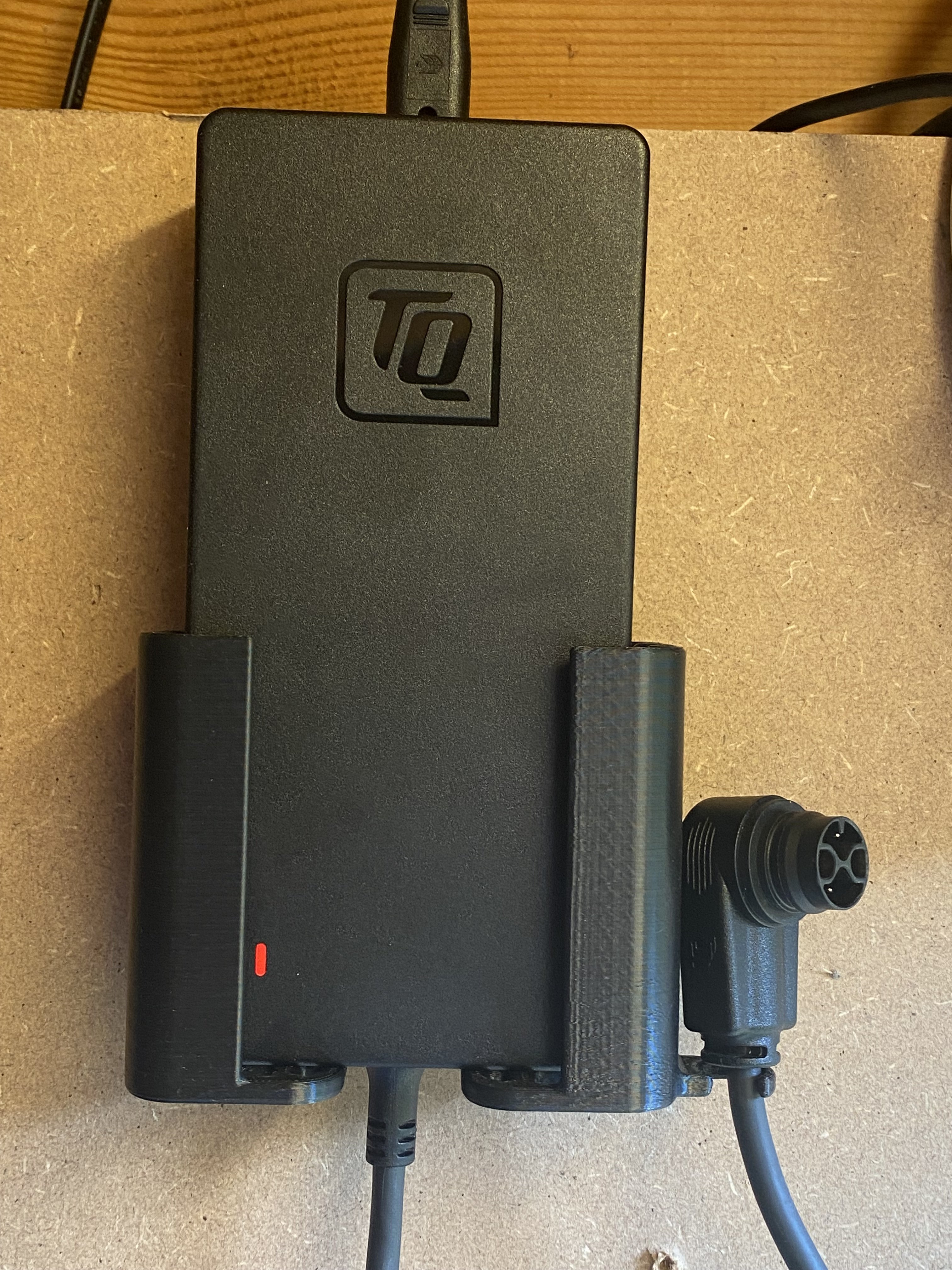

@woody65 and others who might be interested: I have uploaded a 3D model for a TQ charger holder to Thingiverse. You can get it here:
Have fun
