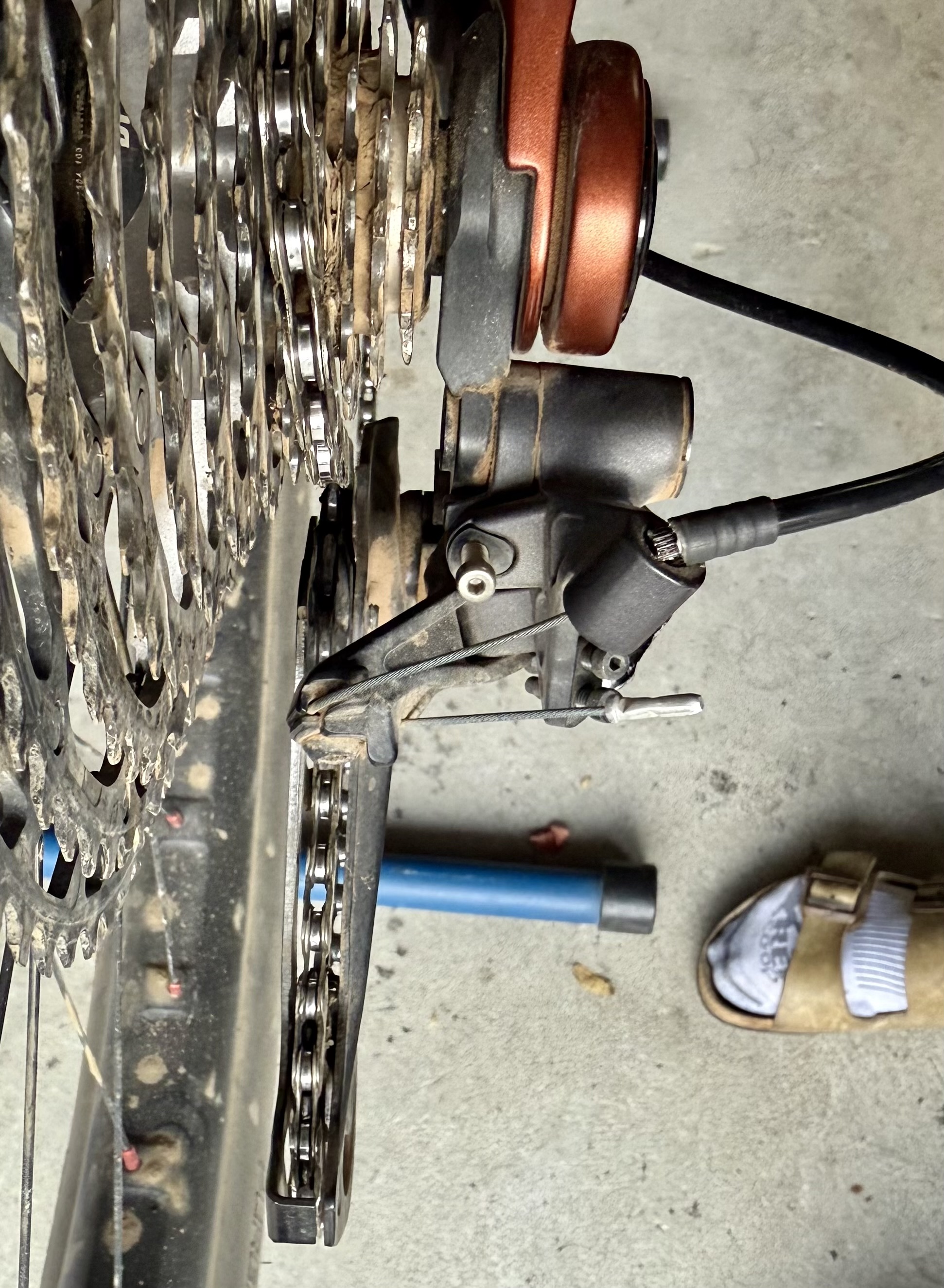

JayX2A
Aug 11, 2024
83
23
England

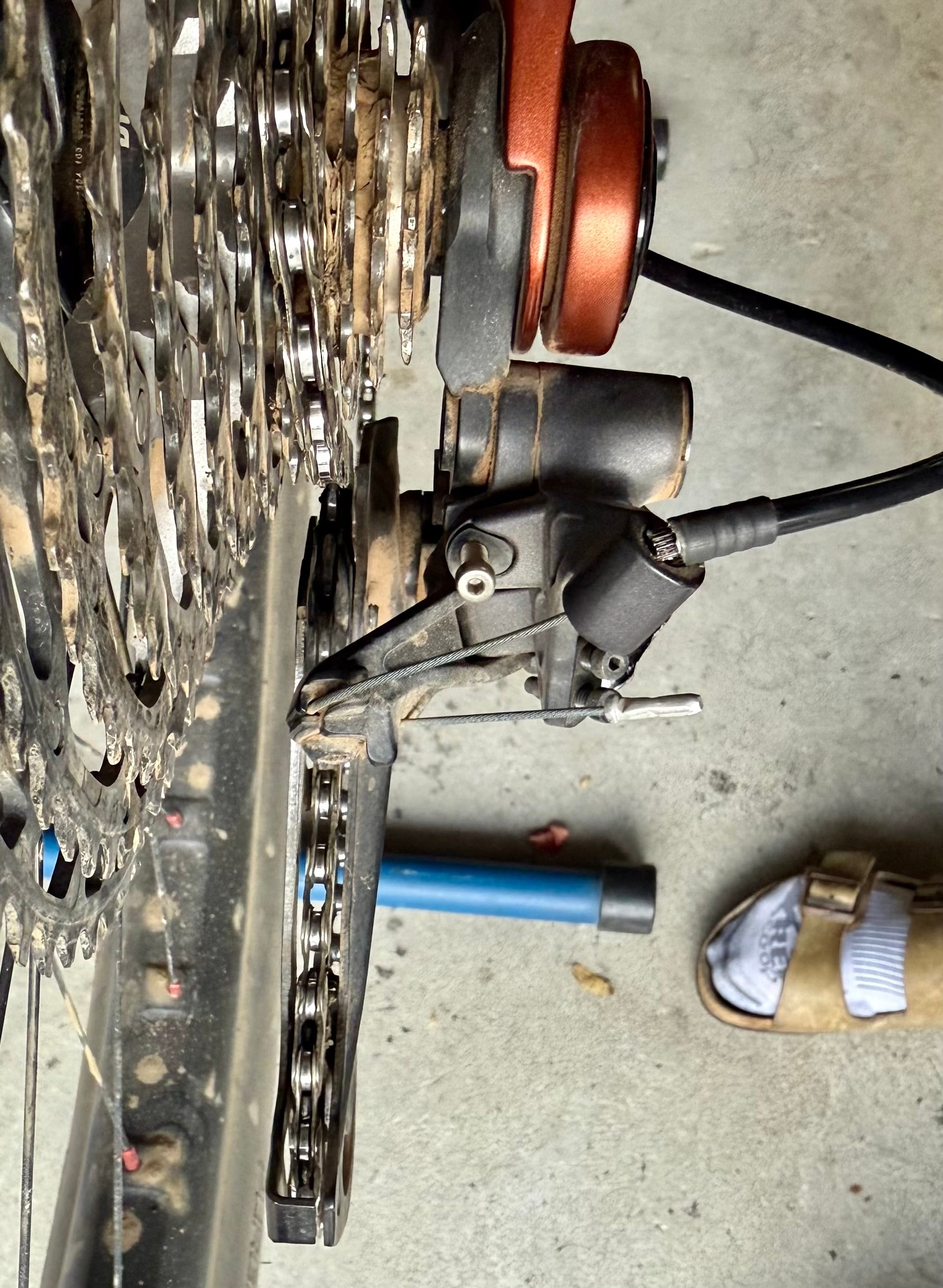

Annoyingly when I was faffing around with bars I lost the little bolt and square nut for the remote. No idea how to find out what size that is !!
XrayZulu
Nov 8, 2022
30
20
Would suggest you contact dealer you bought from and ask them if their workshop happens to have a spare nut/bolt lying around. The buttons do fail and so they get returned to dealers so they can be warranted etc..
If no success, PM me.

JayX2A
Aug 11, 2024
83
23
England
Dealer had one recently but can’t find it right now! Still looking. They can’t order the bolt as they buy then whole unit direct from TQ. Quite annoying! I’m sure there must be a nut and bolt that fits somewhere is a diy store.
Emailed TQ to see if they have specs of the nut and bolt too.

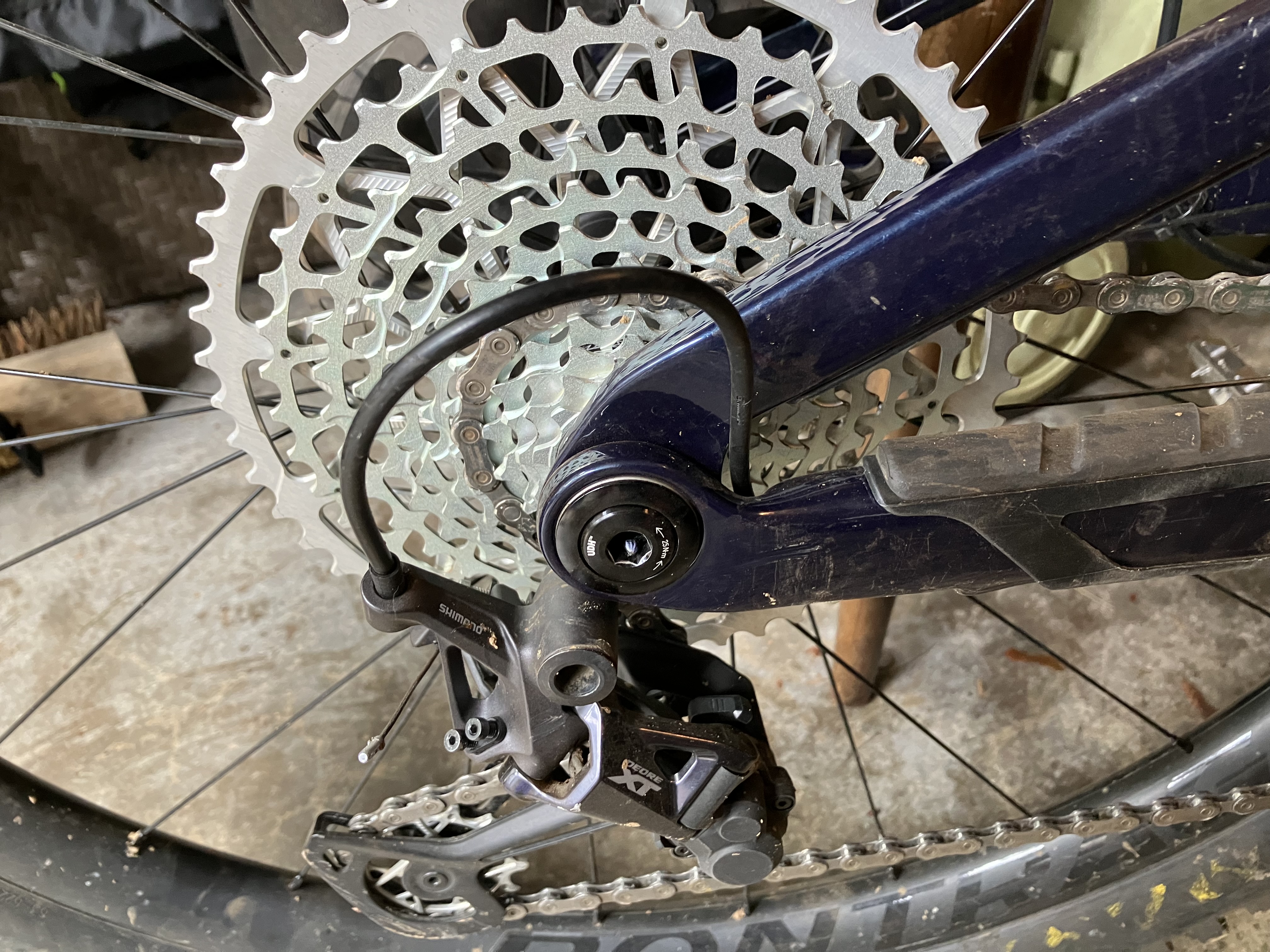

Johannes
Aug 13, 2024
9
7
I checked my bike to get the dimensions. It is this:
Bolt: Din912 Socket head cap screw M3, 12mm long (excluding the head)
Screw: Din562 thin square nut M3, 1.8mm thick, 5.5mm square
Have fun

If your shifting is getting a bit notchy or suddenly needs adjustment you might check the cable housing end cap at the rear derailleur. The plastic one that came on the XT derailleur of my 9.7 cracked. Replaced it with a metal end cap.
Have fun
Johannes
Perfect. Now try to find somewhere that doesn’t have a minimum purchase of 100 lol. Thank you.
THIS! I had the same issue and tried routing the cable through the rear triangle. So far no issues after 10 or so chunky rides.

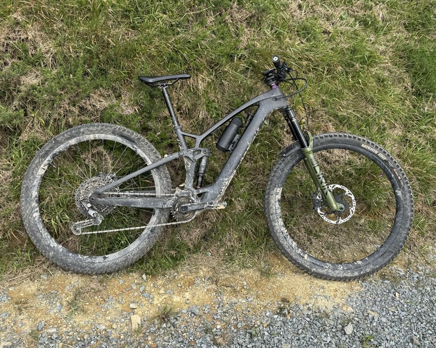

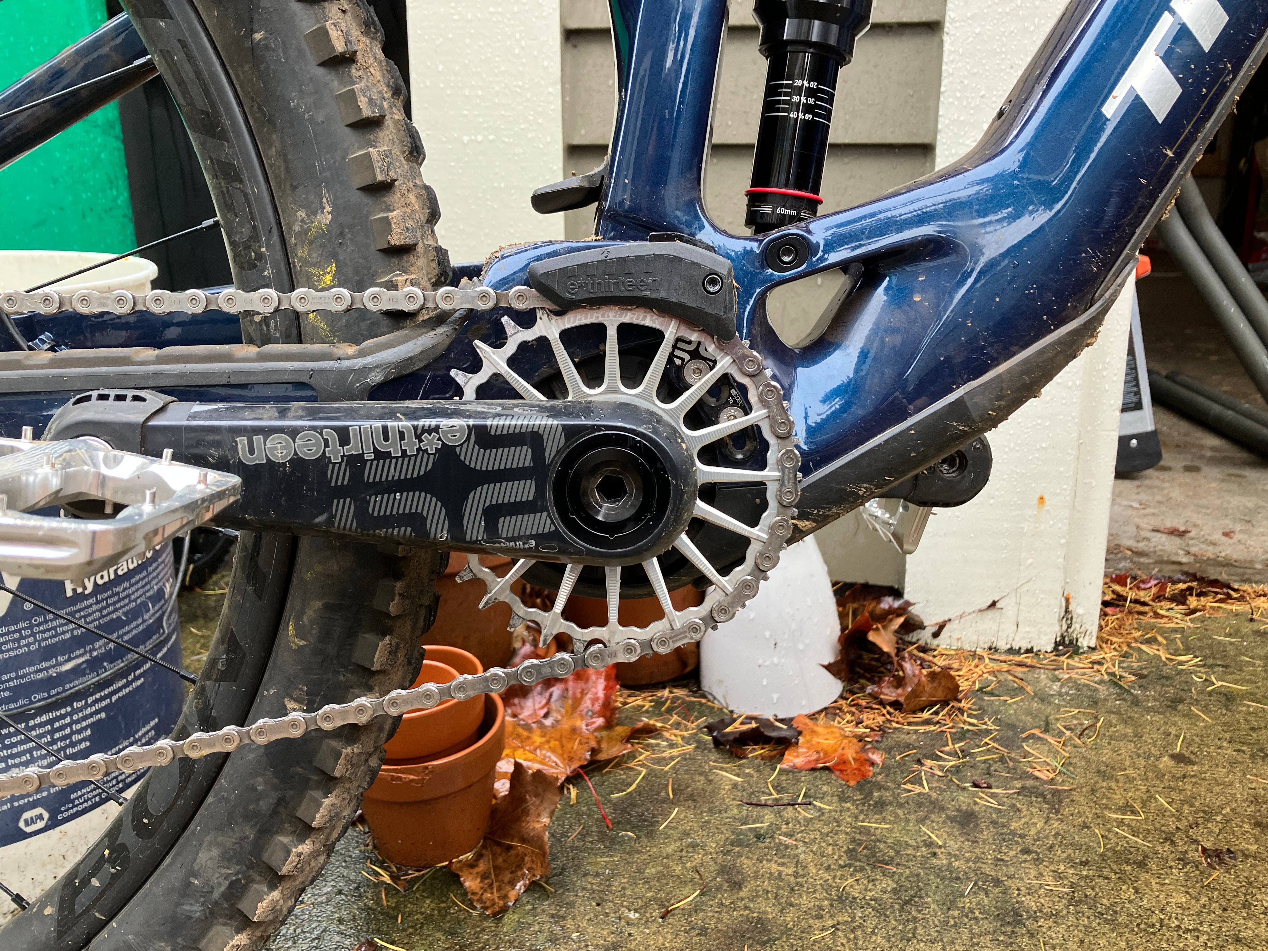

Hi All,
Anyone running the Garbaruk front chainring on their Ex-e? If so, can you post pics?
I remember seeing a post about it, mentioning you can't run chain guide, but can't find it any longer.
Is the offset different from the e13 stock chainring?
edited to add a pic of my mostly custom 9.5

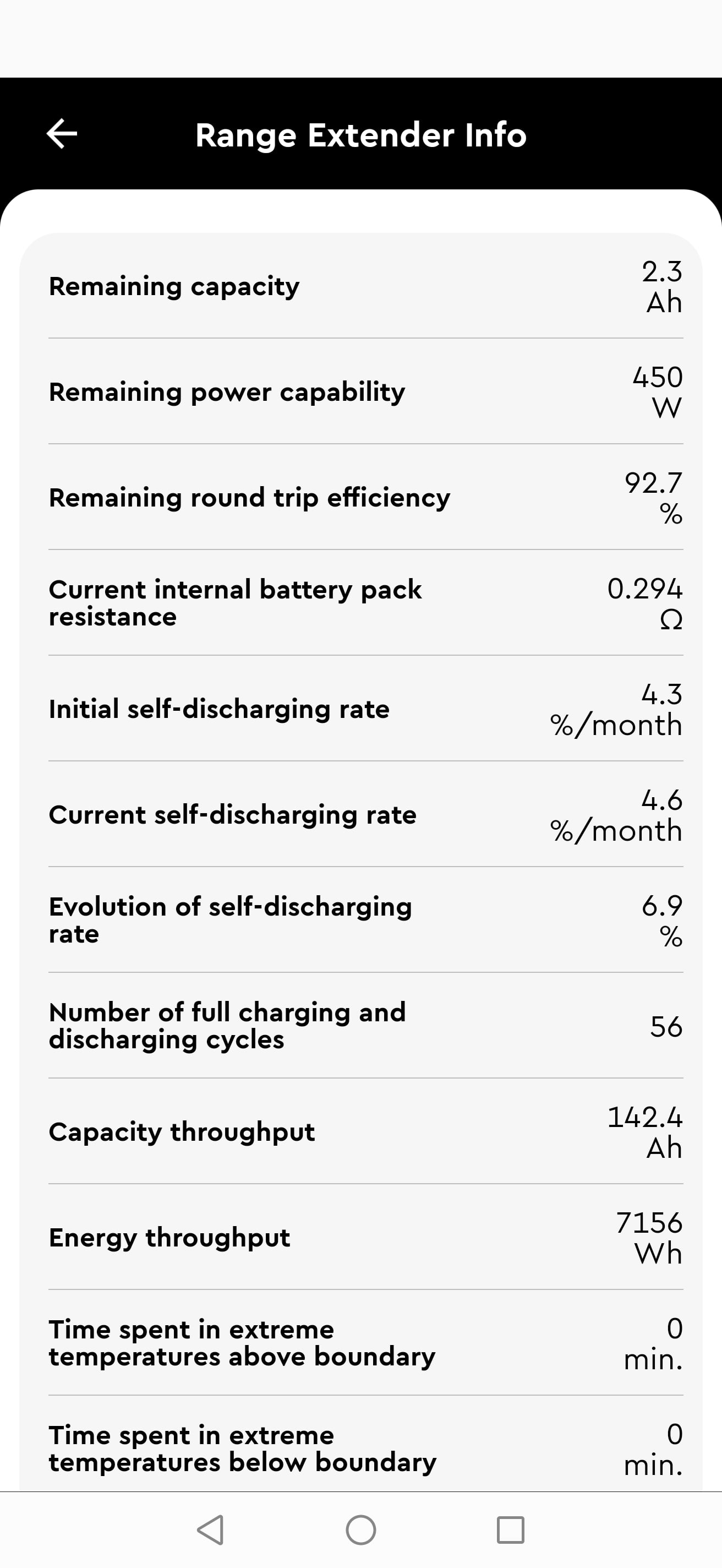

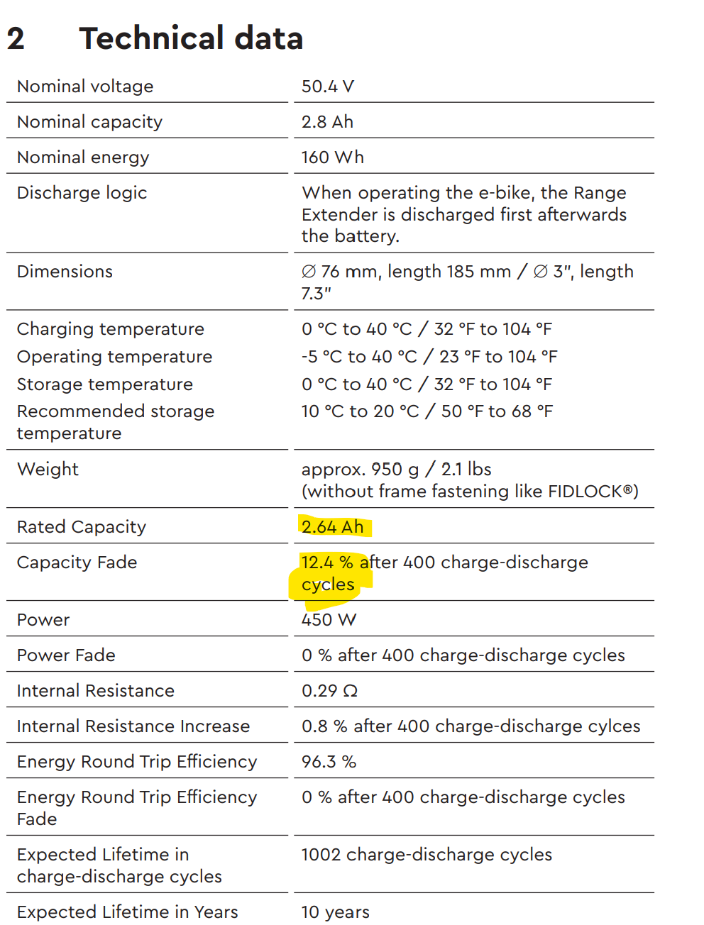

Is anyone else range extender battery losing its capacity quite rapidly?
The TQ specs (in the user manual) say its rated capacity should be 2.64ah, mine is showing only 2.3ah available in the battery health stats according to the TQ app, so a loss of 12.8% in 56 charge cycles.
This seems quite high to me, anyone else noticing the same? The specs say that it should lose this amount of capacity after 400 charge cycles, mine has lost it after 57 cycles
The main battery is also showing some loss of capacity, but not as much as the range extender, the main battery should have (according to the manual again, but I havent screenshotted that manual here) 6.24ah, but now has 6.1ah after 38 charge cycles according to the TQ app, so only a 2.5% loss of capacity, which is probably more in line with what I would expect.
I'm tempted to try and warranty the range extender as it seems to be losing capacity way quicker than it should be - unless I'm reading the specs/tq app incorrectly? any comments/words of wisdom for me?

Hi All,
Yep. I have the 32 T one [DM MTB chainring for TQ Motor]. I reckon the 34 T would fit fine too but the 38 T might be too big [unscientific guess].
That is great info, I wasn’t aware the TQ app had that facility, however on my app the only data it will give me it the remaining capacity and nothing else for both main battery and extender. Have tried different ways of starting it but none of the other fields have data in them????

Hi
You need to have all the hardware running on the latest firmware versions shown on the tq website. The firmware was released last month.
IME, 5mm housing fits and handles the internal routing much better than the normal 4mm. Tried a lot of different things and that finally got my X01 setup shifting as light as my other bikes.
