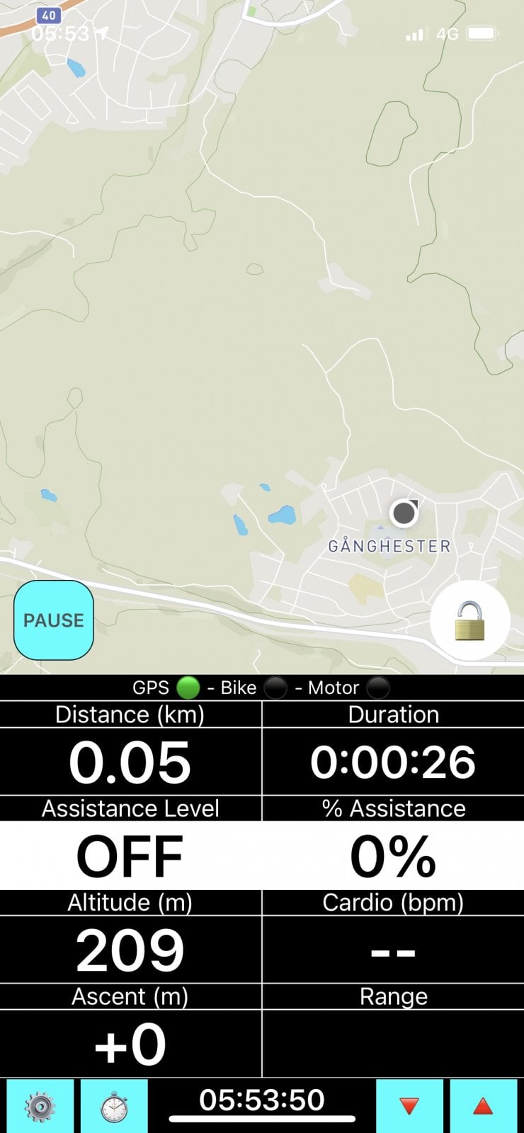

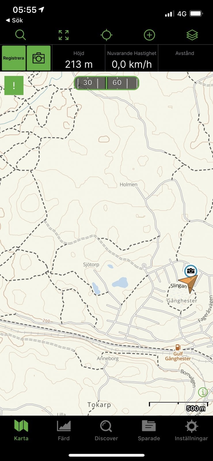

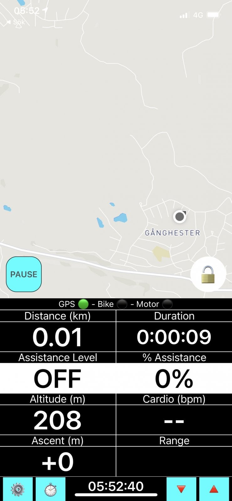

First of all it is better to solve the issue with BV6000 that is very good for bike and BLEvo..
I think there are some settings in the Android setup to avoid Bluetooth issue.
For iOS, your are showing the Map after ride, not the map during the ride that are Mapbox and not Google... Mapbox is a little better than Google map..
Ok, thanks for the answer. Here is the normal map of Blevo and the terrain map and Gaia as a compare:
781F75AF-3401-48A6-826F-E8AAFB592CB0.jpeg B1184436-1354-4C9F-8374-FD7EB9BDF33D.jpeg C6D5B2F9-9F9A-4A8C-87ED-9D13F68C70C6.jpeg

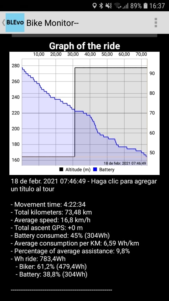

Hello BLEvo friends.
I already said in a previous post that I am doing tests with different Smart Power configurations and for now everything is going very well.
But yesterday something did not suddently work. BLEvo did not detect the altitude, as it had been working until now. The horizontal coordinates worked fine. The track was created with no errors. But there were no altitudes, no ascents, no gradients, no data in the history. I attach the graph. It was a circular route with start and end at 125 m.
Before my ride tomorrow, I wanted to check if it worked today. The answer is that it doesn't work. I did a short known 4 km route, from 6 m to 195 m. When starting the tour, the altitude is displayed at 166 m and it is shown so all the time, while another GPS device indicated the altitude correctly.
I have checked the GPS of my mobile and I have reset it. I do not know what else to do.
I hope Paolo helps me.

I saw that now the GPS altitudine is not working correctly.
Now I'm trying to fix this issue, but it seems it comes from the google library..
In the meantime you could try the DEM functionality that offer to you a better elevation and ascend calculation.
Let me know.

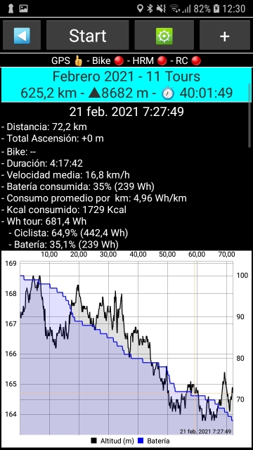

maxx
Dec 17, 2020
16
13
08392
Let me know.

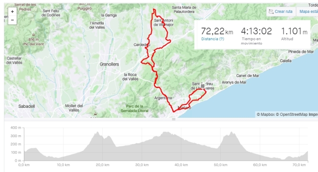

Hi Paolo.
Yesterday I used the DEM maps and the problem persists. In fact, I had already tried DEM to check the difference in accuracy with the GPS data.
I did another test: I use BLEvo on my old Samsung with Android 8.1 and memory card, mounted on the handlebar. To make sure there wasn't a problem with the phone, I tested my other Android 10 phone yesterday. And the same thing happens. I can add that everything worked fine until my ride on February 16. On February 18 it started working badly. Something happened on the 17th!
Attached is a screenshot that I managed to take yesterday during the tour and the graphics for BLEvo and Strava.

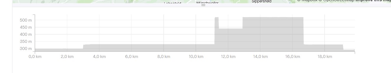

In January everything worked fine. Now since last week I get problems with the GPS height data. Have a look at how it looks after the upload in Strava.
Is anyone else experiencing this issue?
OnePlus 6 with up to data OS and Blevo-Version.

View attachment 53830 View attachment 53831 View attachment 53832
Hi Paolo.
There is a bug in the Android GPS library.. from 16th to 18th BLEvo is not changed.. The GPS altitude is totally wrong.. I will fix in the next release..

It seems that BLEvo was not correctly connected to the bike.. In this case it is better to restart the ride and be sure that the biker power and motor power and received correctly...
PaoloBLEvo
As I wrote before, I saw that now the GPS altitudine is not working correctly.
Now I fixed this issue, it seems it comes from the google library..
Let me know.

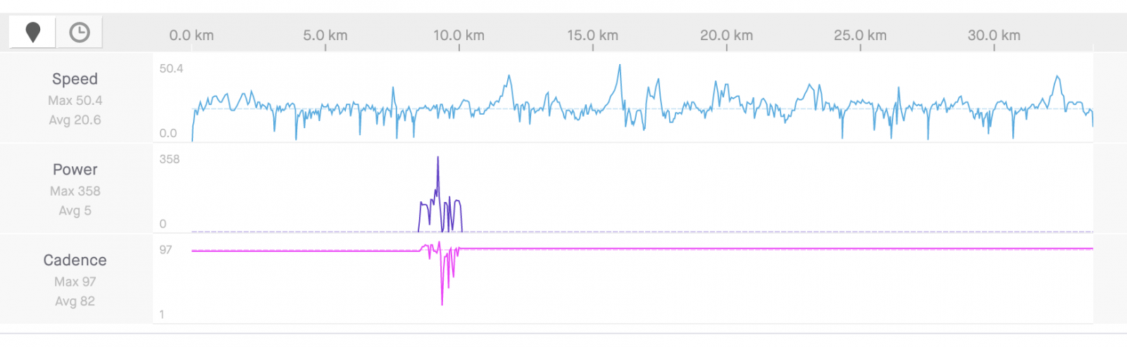

Thanks for your reply @PaoloBLEvo
BLEvo does have a solid green indicator for GPS, Bike and Motor, but most of the time I don’t get power or cadence data. Sometimes in the middle of a ride I start getting the data for a few minutes, but in never lasts.
You can see power and cadence suddenly start, then stop, working from the Strava analysis.
There’s obviously an issue with the connection between the phone and the bike, and I have tried using different phones, iPhone and Android, removing the Bluetooth code from the phones, restarting the phones, making sure nothing else is connected to the phones, but nothing seems to work.
Is there something else I should try?
PaoloBLEvo
Trader
Jun 13, 2018
1,456
1,188
Varese
Which is the firmware version of the TCU?
