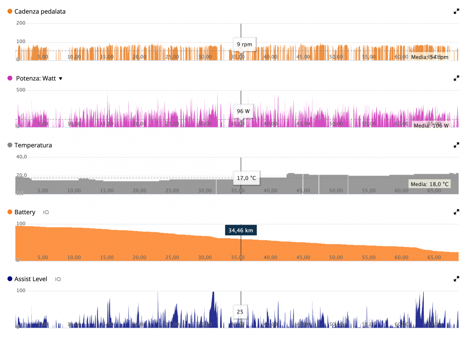

After a couple of months without releases, the new version 3.8.1 of BLEvo for Android has been released (it will be online soon).
Finally I have put support for .FIT files so you can import them into Garmin Connect and also view the battery level and the assistance required .
I am attaching a screenshot of what you will get (to also enter the room temperature, I'll give you more information shortly).
In the graph you can also see how the Smart Power works by continuing to change the assistance percentage depending on the leg push.
