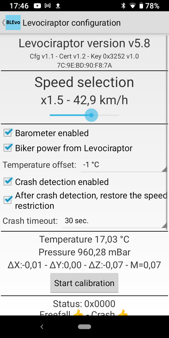

After more than five months of testing, I am pleased to announce the full integration of the new Levociraptor Generation 2 into BLEvo.
The new Levociraptor (called Gen2) integrates a Bluetooth module for connection with the SmartPhone. In addition to the unlocking of the speed (for Brose and SL motor) that can be customized from the phone, it also allows you to detect the ambient temperature, the atmospheric pressure to have the altitude measurement with extreme precision.
The joint development team has made it possible to achieve important improvements in SmartPower management in BLEvo as BLEvo will receive data directly from the Levociraptor without waiting for the delays introduced by the TCU. This integration with the SmartPower allows an improvement in responsiveness and fluidity in the delivery of engine power.
Through the BLEvo interface it is possible to instantly remove the speed release or send the position in the event of an accident, these two functions can be activated automatically in the event of an accident.
The interface with the Levociraptor Gen2 is available to all BLEvo users in free mode. Versions 3.9.0 for Android and 3.7.0 for iOS have been released and are available in the stores.
For more information on the product visit the website
The Levociraptor Gen2 will be available in a couple of weeks.
You can preorder it.

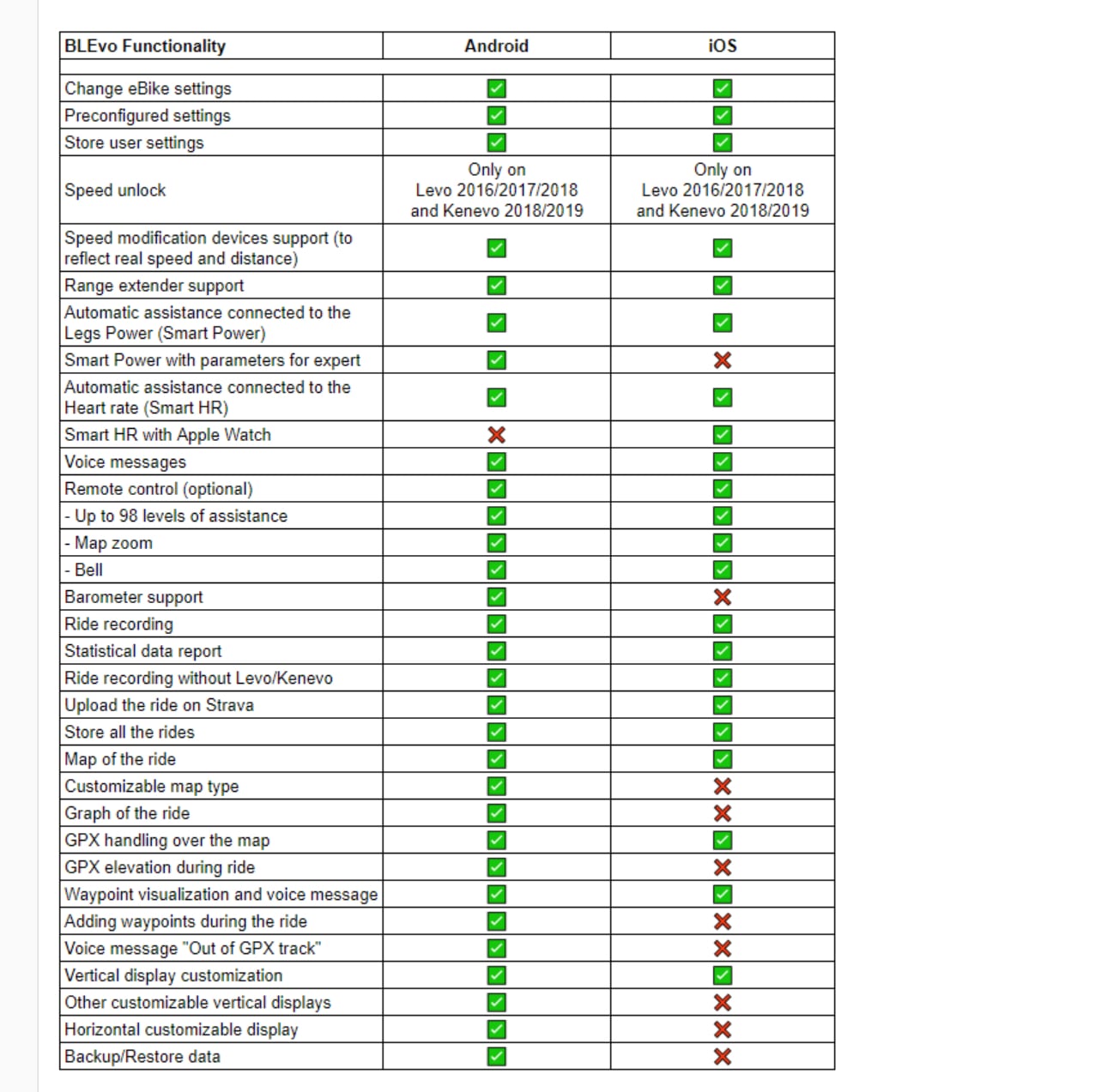

Switzerland
Hi Paolo.
which operating system is better to use,, IOS or Android.. I presently use an iphone and a few things I’d like to do but can’t,,, total range with battery extender (not specialized) and drop waypoints on route, had a quick look thru forum. I think you can do this on android. Maybe things have changed..
would you have list of what can’t be done on ios compared to android.
cheers

Hi Paolo.
cheers
I mainly use iOS devices and Macs but I have bought a refurbished Samsung S10 Plus to use on my ebike. It is less €€ than a Garmin Edge and has many advantages. I also use the bluetooth remote with it, a very nice setup. I also don't want to ruin my expensive iPhones cameras from vibrations sitting on the handlebars.

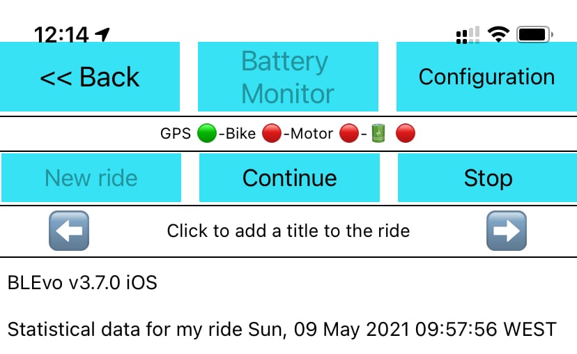

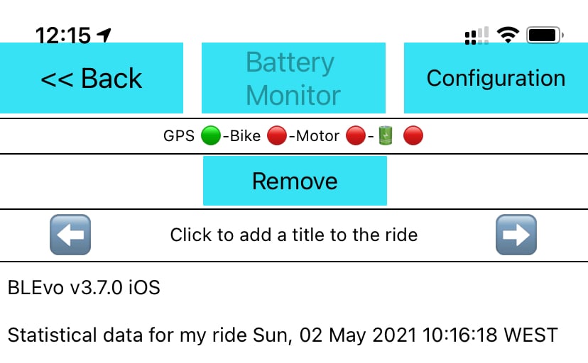

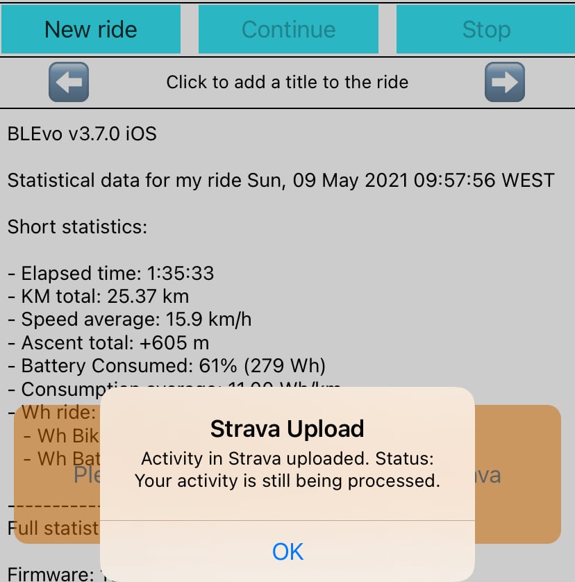

Paolo!
I am having a problem on the lastest iOS version. Recorded an activity on the 2nd may. stopped as always and uploaded to strava. Strava didn’t show it but I didn’t care at the time. Today started a new activity as always. When stopped the same problem happened. Even worse. If I choose the 2nd May activity I can’t upload to strava. Return to the 9th May activity it’s still going even if I did stopped it. If stop it again and go to the 2nd May and back to the 9th May, it’s still going!
