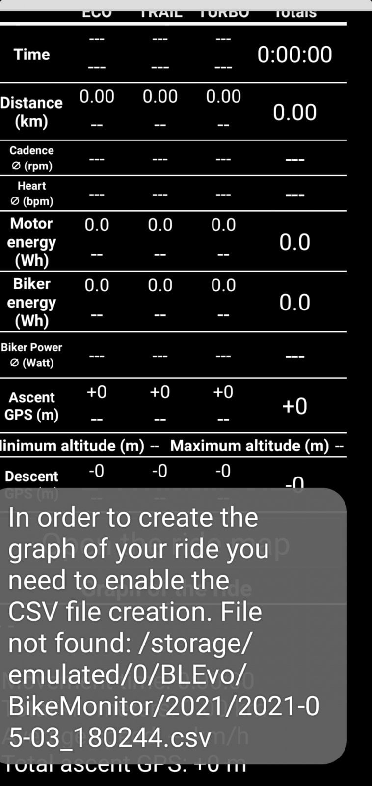

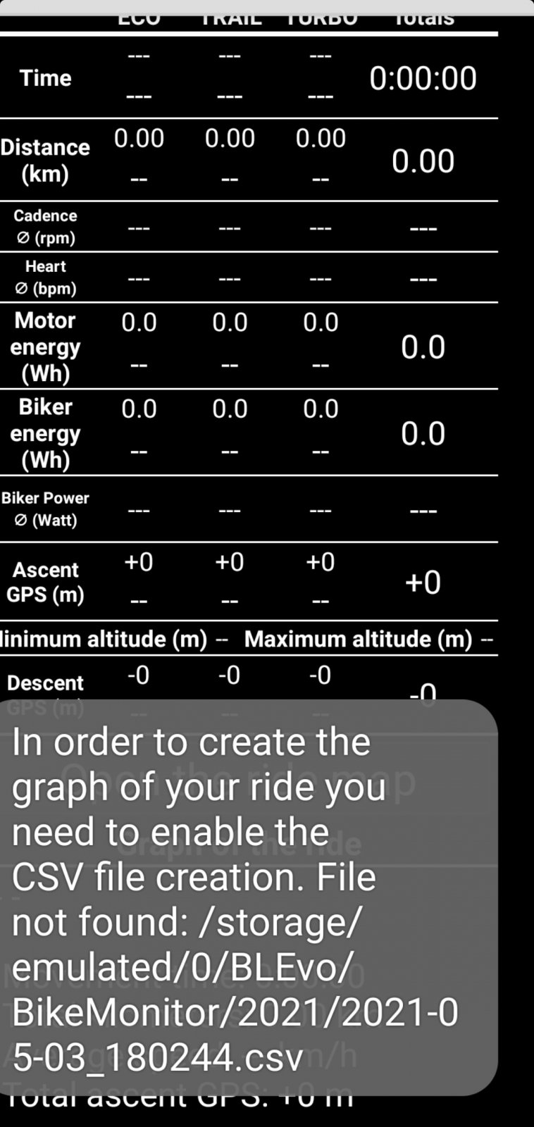

Hello,

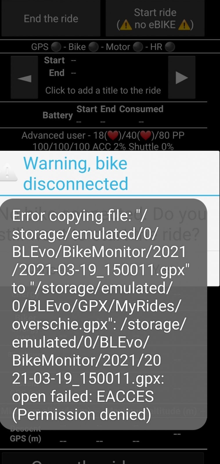

I used Blevo since february and it was oke. Since april I have trouble with CSV file data and gps connection goes on and off.
When I want to see map. I get : " no data found in csv file".
When I look in the blevo map, I can see a map with data.
When I want to see a graph. I get message: That I need to enable the csv file creation. But I can not find this option in Blevo.
I once got an error about copying file with gpx. See picture.
What can I do to fix this?

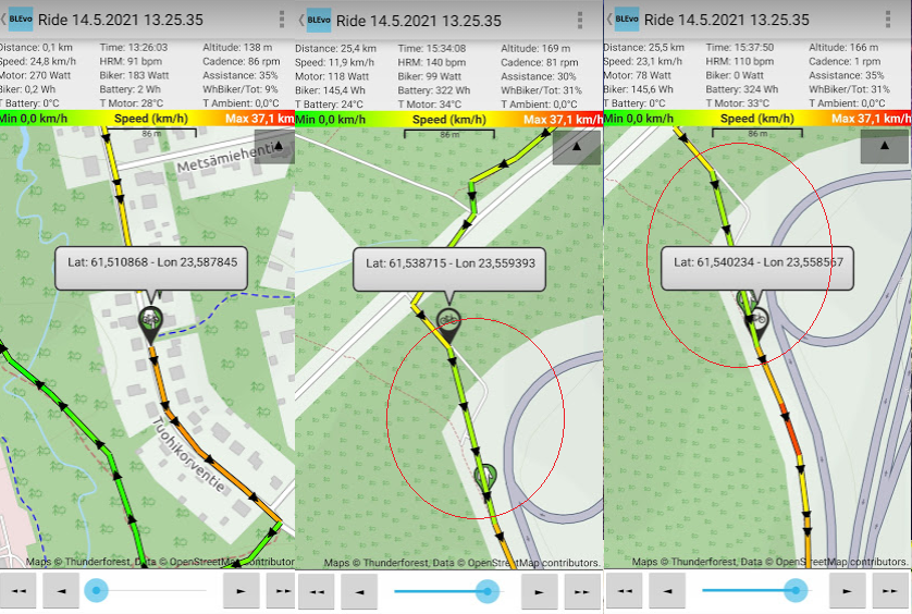

We had also disconnect problem last ride with two bikes. It happened exactly at same time with both bikes. I had to go to main menu to get It connect again. We both had latest Blevo.
After how many km and time?
This happened also to my friends and his wife..
In the next release I will improve again the connection procedure..

Hello,
I think you have Android 11..
Please go to the authorization of the app and remove it.. After restart BLEvo and answer yes to all the request of permissions..
Let me know..
First picture is from start. Second and third are from point that connection was lost. It seems that it didn't save gps coordinates at that time. Kms are around 25,5km and time was around two hours.
I had yesterday longer ride and connection worked flawless at that time.

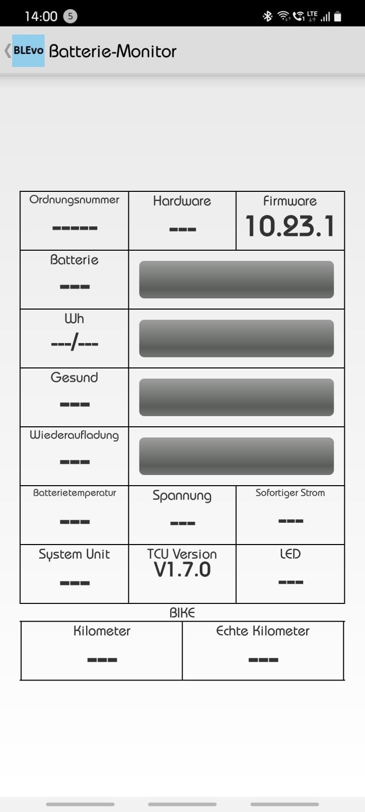

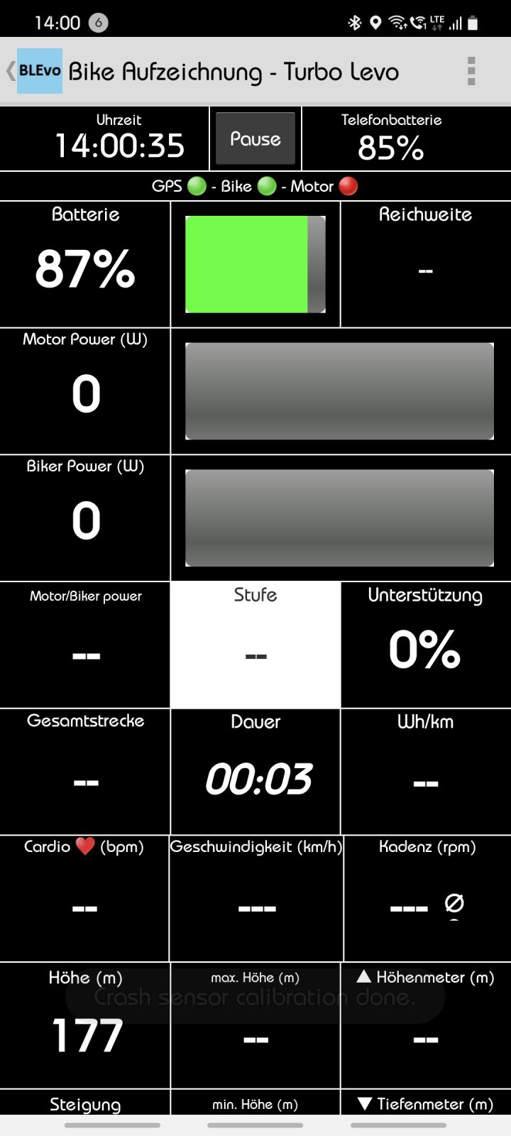

a small problem with BLevo Android (newest Version) since a few weeks. When I start a new ride after successful connection, BLevo asks if I want to start without motor. Display still shows the Eco Mode. When I click cancel and start Tour again, I get the normal popup to enter the actual height and everything is as normal.
Edit: disappeared after connecting to a new battery.
Windsurfer
Aug 31, 2019
18
8
other thing, I've got a new battery and when added it to BLevo I was not asked for a passcode as stated in the manual:
"You will be presented to enter a 6-digit passcode on first connection to the bike.
This can be found on a yellow sticker in your manual or written on a white sticker
on the back of the TCU module."
Has this been changed?

and further: since the new battery is in use, I do never get the blue dot on the home screen after the bike is switched on and BLevo hast been started. However, when I start a tour every thing works as usual and I have three orange dots on top of the sceen.
Should I take a backup and reinstall BLevo completely?

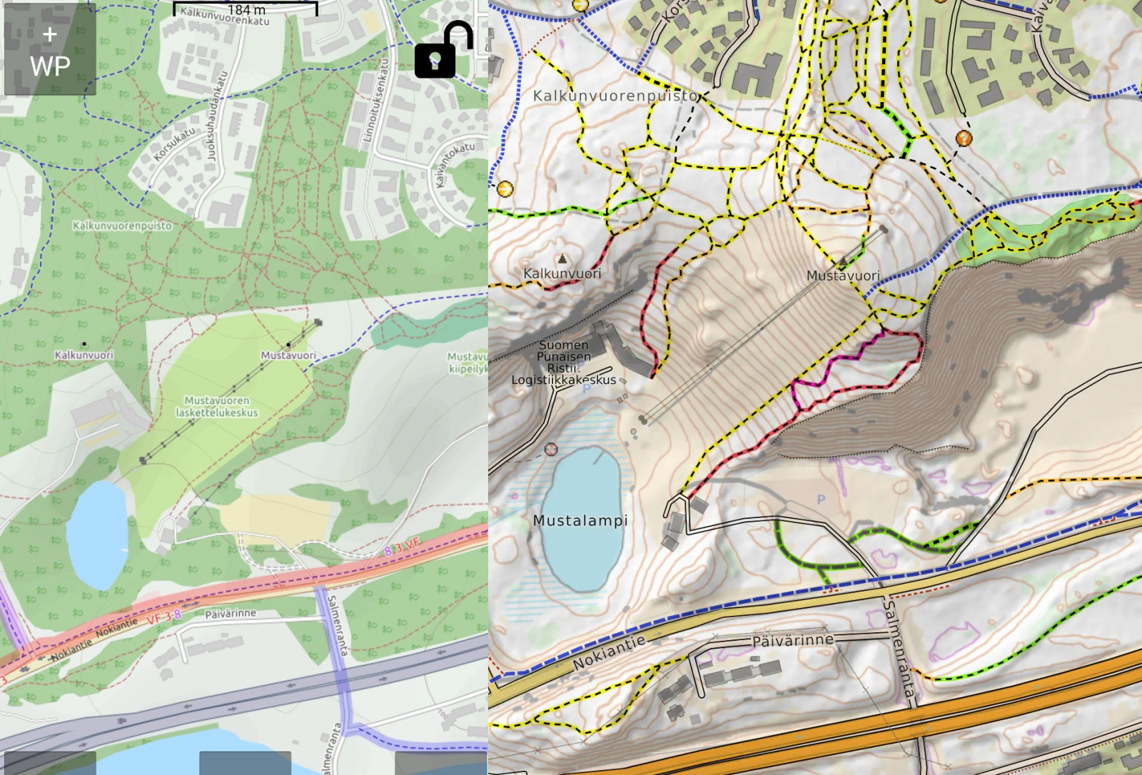

We have nice openstreet based map here in Finland and lot of people have marked and classified paths to maps. Is it possible that blevo could use Trailmap tile server? (Only Finland is included in these maps)
Example of the map (Trailmap - Löydä uusia polkuja)
Tile server address
3D MTB map, also .png works
https://tilestrata.trailmap.fi/d3-mtbmap-cache/3d/{z}/{x}/{y}.webp
3D MTB map (high res), also .png works
https://tilestrata.trailmap.fi/d3-mtbmap-cache/3d/{z}/{x}/{y}@2x.webp
Sorry but the map library doesn't handle the 3d maps..
I think BLEvo asks if you want to ride without the bike connected, not without motor.. could you share the message?
Which bike you have? The battery is not the TCU. If you have an old bike, the battery with the bluetooth module doesn't have the passcode
You need to scan for a new bike, if the bike model has the bluetooth module in the battery
Mapserver is ordinary OpenStreetMap-standard "tiled web map",/"slippy map". Map name is 3D mountainbike map because it looks like "3D". It is combination of many maps. Hill shading and countour plots make it look like 3D. There is much more details than just OSM map. Map users have mapped and classified over 10000kms of paths to the map last year. Green is easy path, yellow normal, orange little tougher, red hard, and turqoise really hard.
Blevo has map option for 4umaps.eu, if I have understand correctly, just website has to be changed to different one. :rolleyes:
http://tileserver.4umaps.eu/{z}/{x}/{y}.png -> https://tilestrata.trailmap.fi/d3-mtbmap-cache/3d/{z}/{x}/{y}.png
Low res tile sizes are 256x256 and hi res 512x512.
This is open cyclemap and "3d MTB" map comparison. Open cycle map looks flat and doesn´t have much details like swamp, cliffs etc...

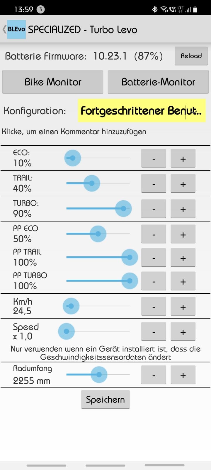

Hi Paolo,
thank you for the answers. Bike is a 2018 Levo, bought in 06/2019. I am using BLevo since 07/2019. I did scan for the new battery (TCU and Bluetooth modules included in the battery).
I had three rides with the new battery, but I never got the blue dot on top of the main screen. However, when starting a tour, Blevo/Smart Power worked well.
I will try to add it...

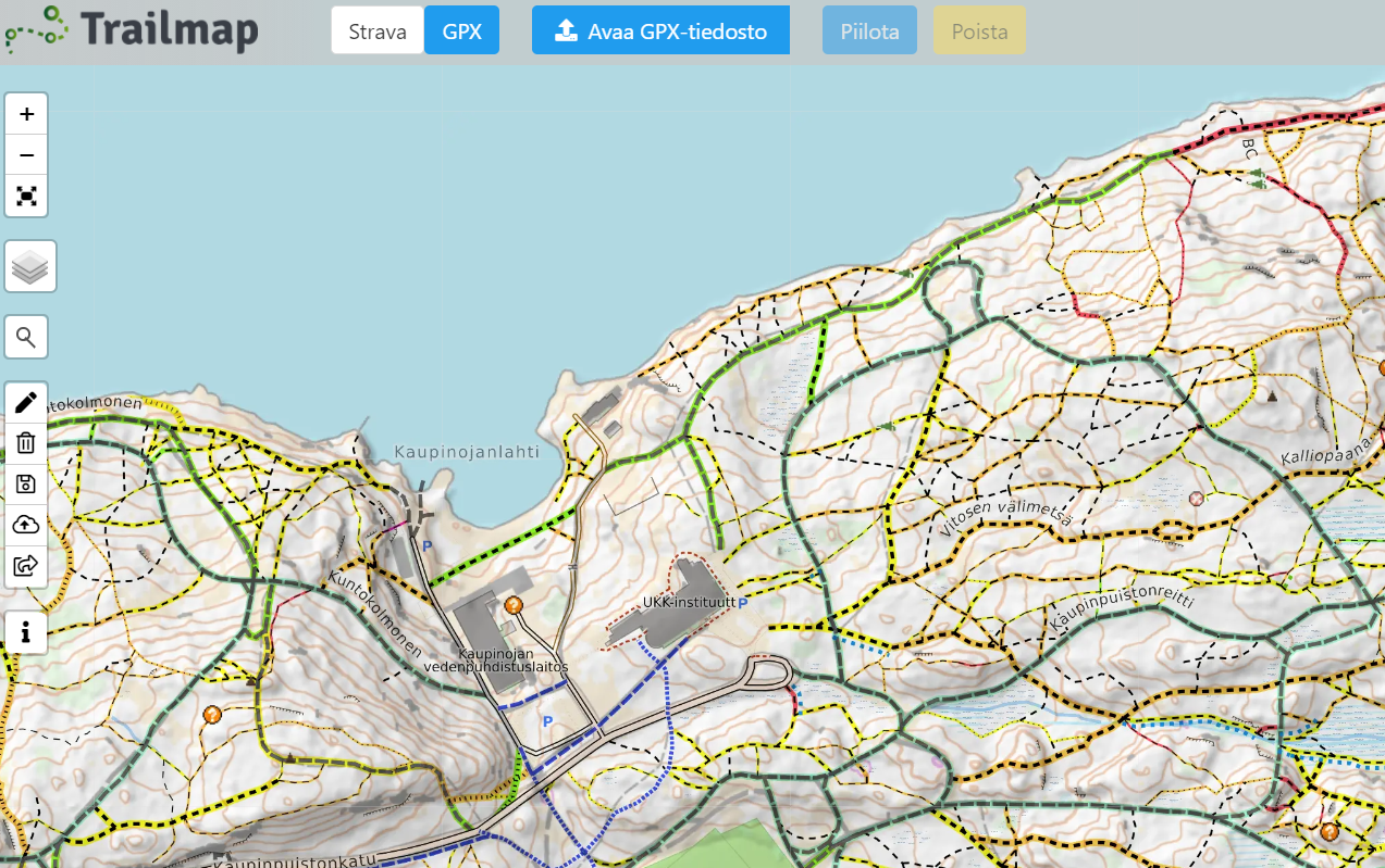

I tried to integrate but I think the path is not correct..
This x,y,z combination works for 4umaps
but it doesn't works with your link
maybe is because it is out of coverage maps..
If you can check and also send to me a GPX in your zone, I can add easily the new map type..
Subeerb! I think the location is the problem because just Finland is rendered.
Here is link to .gpx file
First gpx
and another one in different location but in same country (Finland)
second gpx
First gpx
second gpx
I tested the maps with not 3D map and it works even if I'm not in Finland..
This link works..
it return a white picture and not a server error..
Could you check why the link
https://tilestrata.trailmap.fi/d3-mtbmap-cache/3d/13/4296/2919.png
is not working?
