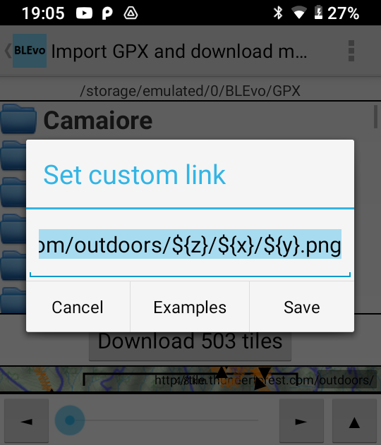

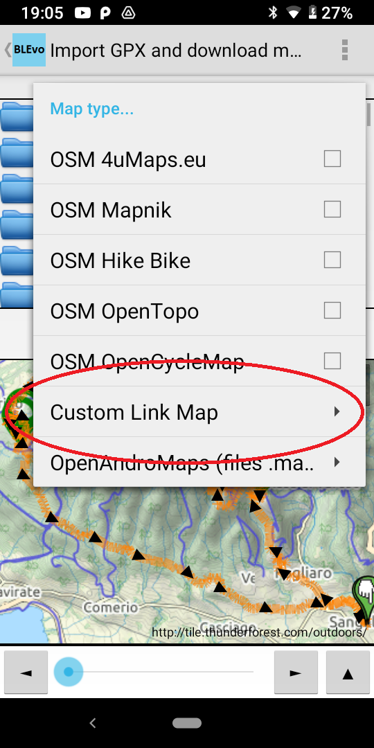

I just released BLEvo version 3.9.6 for Android.
In this new version I have added the link configuration for maps. In this way everyone can put the maps they want as long as they are compatible with the format specified by open street map.
Here you can see some examples of the links

We had first ride with new custom map setting yesterday. Everything worked well. I have missed this feature over year. Thank you for that. (y)

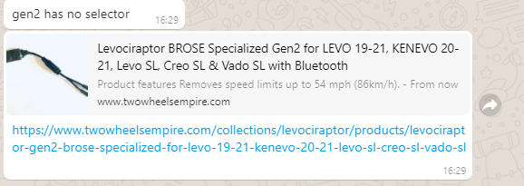

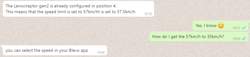

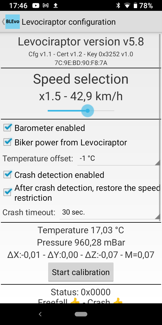

@PaoloBLEvo Thanks for the fast answer, but not an answer to my question. According to 2wheelsempire, the manufacturer of the Levociraptor, you can not change the selector on the Levociraptor GEN2 - it is always on 4. See below the picture from the communication. This seems very strange to me.
I do not want my speed limit at 57,5km/h. I want it at +/- 35km/h. Is this possible?

It seems the setting in posistion 4 is just a PRE-setting, you CAN change it !
I have exact the same question, would only want it to go a bit over 30km/h to not drain the battery in ECO
but still have some assist.
