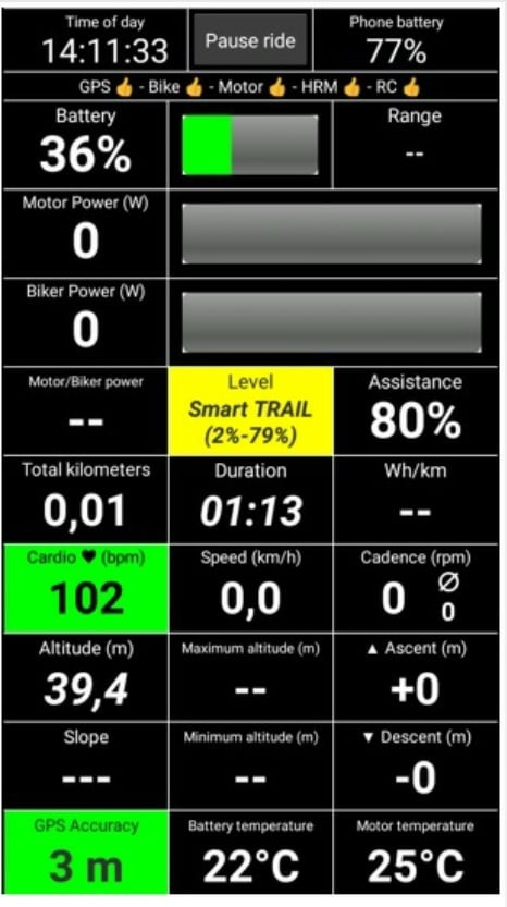

Hi Paolo,
Long time no speak! Hope you are okay in this crazy world we live in.
I have a request for the voice notifications/alerts, it is possible to add motor temperature and battery temperature?
robespana
Jun 21, 2021
23
9
Spain
Hi Paolo,
Check the last line...

Carmarthen, Wales
You have not understood my request.
I know it appears visually, however I want Paolo to add it to the voice alerts so I can hear it as I ride with my device in my upper side pocket in my armour hence me saying ‘voice‘ notifications and alerts ;)
You're right, i did misread and missed the voice part. Sorry ..
