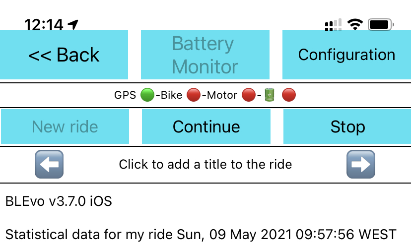

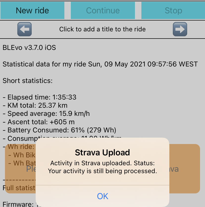

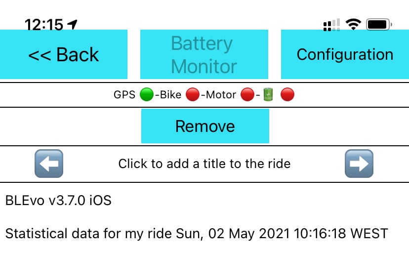

I am having a problem on the lastest iOS version. Recorded an activity on the 2nd may. stopped as always and uploaded to strava. Strava didn’t show it but I didn’t care at the time. Today started a new activity as always. When stopped the same problem happened. Even worse. If I choose the 2nd May activity I can’t upload to strava. Return to the 9th May activity it’s still going even if I did stopped it. If stop it again and go to the 2nd May and back to the 9th May, it’s still going!
another piece of information. even emailing the .tcx or .gpx the file upload on strava shows incorrect formatted data... :(

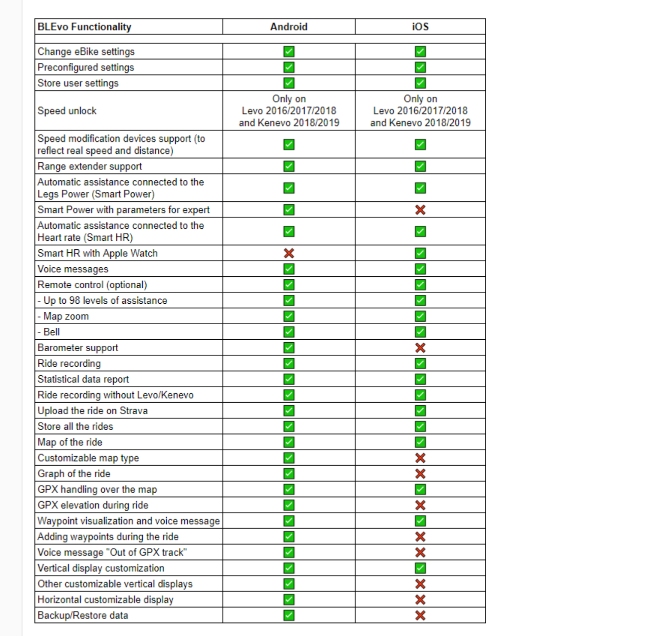

It say range extender support for ios,, is that only if you have the SL extra battery? View attachment 60617
Any more changes.
The Android version is more dedicated to be mounted on the handlebar..
All the version have the extender handling.. If you have an SL motor with an SL extender, BLEvo recognize automatically the value of wh and the percentage of the charge of the extender..

Paolo!
Try to send to me ([email protected]) the TCX files and I will try to fix them..

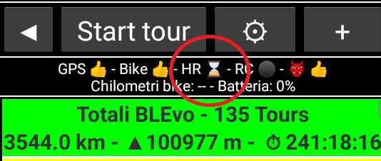

I have released version 3.9.4 of BLEvo for Android.
Finally all the problems of connection and automatic reconnection of all the Bluetooth peripherals should be solved.
As you can see from the screenshot, an hourglass now appears indicating that BLEvo is trying to connect to the peripheral. As a guideline, it takes up to 30 seconds to connect to one peripheral and move on to the next. Please wait.
In this release I have also added buttons to keep the screen on forever or turn it off after timeout.
The update should be available tomorrow.
Enjoy your ride with BLEvo.

Has anyone ever switched from the Android version to iOS and what are your experiences?
I've been an iPhone user for years and don't really like Android. I've been using an old Doro Smartphone with BLEVO for a year and I love the app. But I just don't like Android. ?
So consider switching to the iOS version, but the Mapbox maps are really bad. Every path looks the same.
@PaoloBLEvo
What is the reason that there are no other maps? It can't be due to iOS, apps like Mapout or Footpath offer great maps under iOS
@PaoloBLEvo
The maps are not so easy to handle like in Android... sorry..

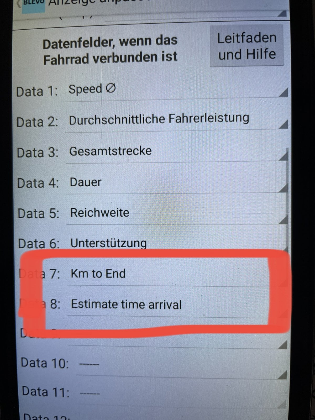

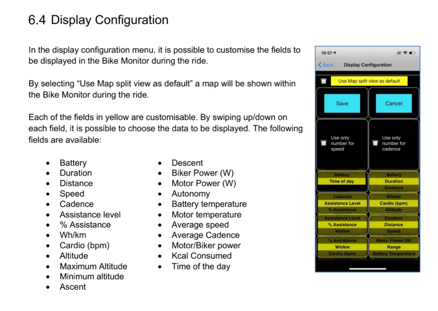

When you select a GPX, BLEvo can provide to you these information in function of your average speed and km to do.. but you need to follow the GPX...
Yes I know this and have these two datafields displayed in Android.
My question is, if the iOS Version can Display these two fields? I can‘t see these fields in the iOS manual.

Paolo!
I'm having the exact same problem. IOS 14.5.1 BLEvo v3.7.1 iOS
