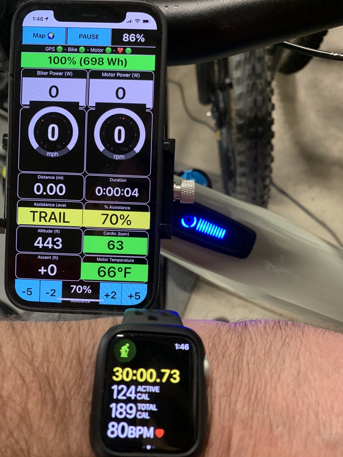

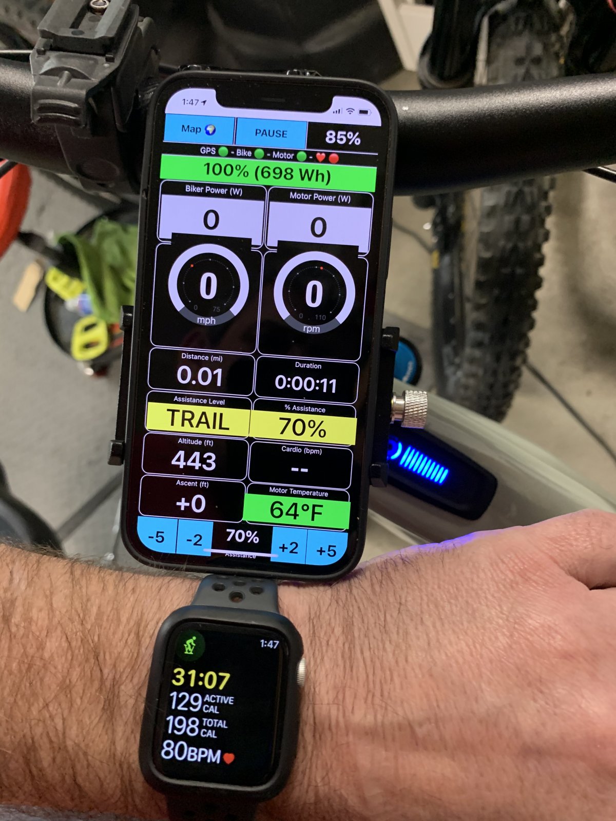

I'm having Apple Watch HR issues too...been trying many things for the last few months, but seems there is no fix.
I'm using a iPhone 12 pro with Apple Watch Series 5.
I've tried it using my wife's Apple watch Series 5 and her iPhone 8 Plus too and having the same issue.
Does anyone have BLEvo working consistently with Apple Watch HR?
if so, what version iPhone and Watch do you have?
Attached are photos of it connected but with the HR being off, and then it disconnects, even though the watch is still showing HR.

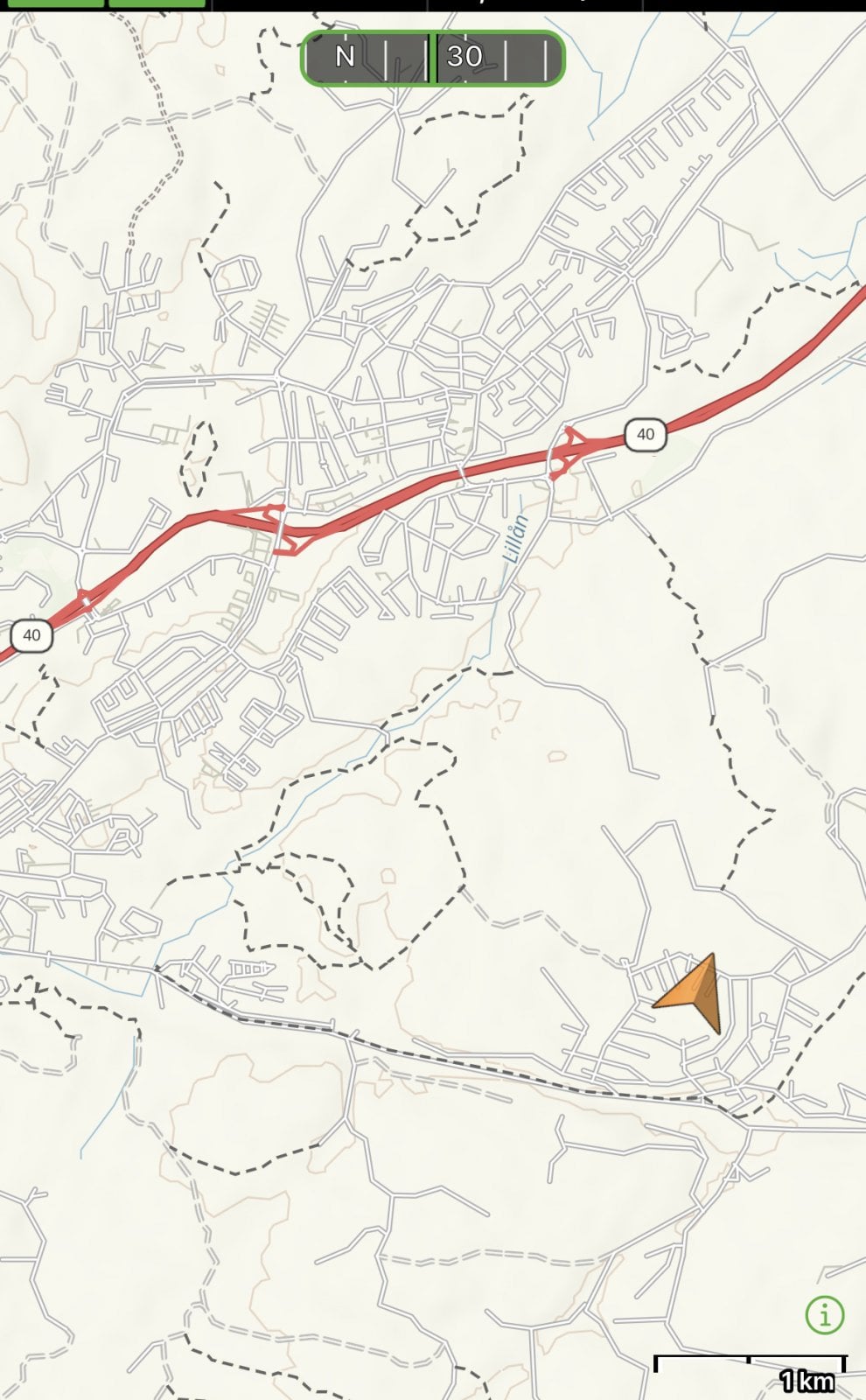

Bm dia @PaoloBLEvo utilizo uma LEVO aqui no Brasil (interior da Bahia / Vitória da Conquista) há 3 anos. E descobri o APP BLEVO e já divulguei o app para 6 amigos. Um sucesso! Pergunto: É possível colocar um "alarme" / notificação sobre a temperatura do motor? Pois o APP mede a temperatura e termos a opção de colocar uma temperatura máxima seria bem interessante. O que acha?
English please..

I’m switching from a Levo to an SL. Does the app work with an SL? I’m guessing yes because the TCU is the same but want to be sure. I don’t have the SL yet to try so was wondering.
View attachment 52561 View attachment 52562
I haven’t ridden recently but apple watch support is the main reason I purchaed the app so that’s dissapointing to hear.
Yes, BLEvo works with the SL.. I have the SL bike..

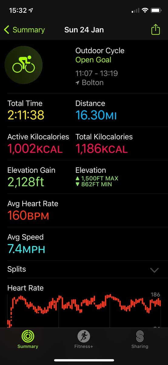

Tonybro
🦾 The Bionic Man 🦿
Jan 15, 2021
1,307
2,960
Lancashire

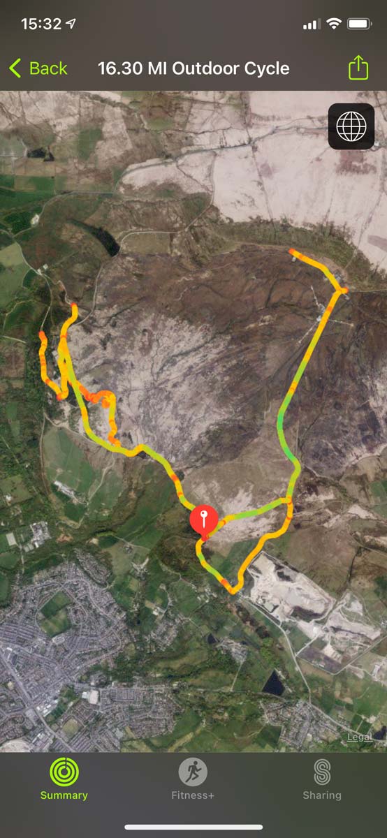

Just use the Workout on the watch - Outdoor Bike Ride and look at the stats on the iPhone it syncs with (Fitness app). On Fitness app it shows the workout, tap on it, see all the stats and at the bottom is the map - tap on that to get the details...
mu71rd
Jan 31, 2021
8
View attachment 53081 View attachment 53080
yes recording it is not an issue. the issue is whether the HR data can be read in real time by Blevo so that the HR features work on the app.

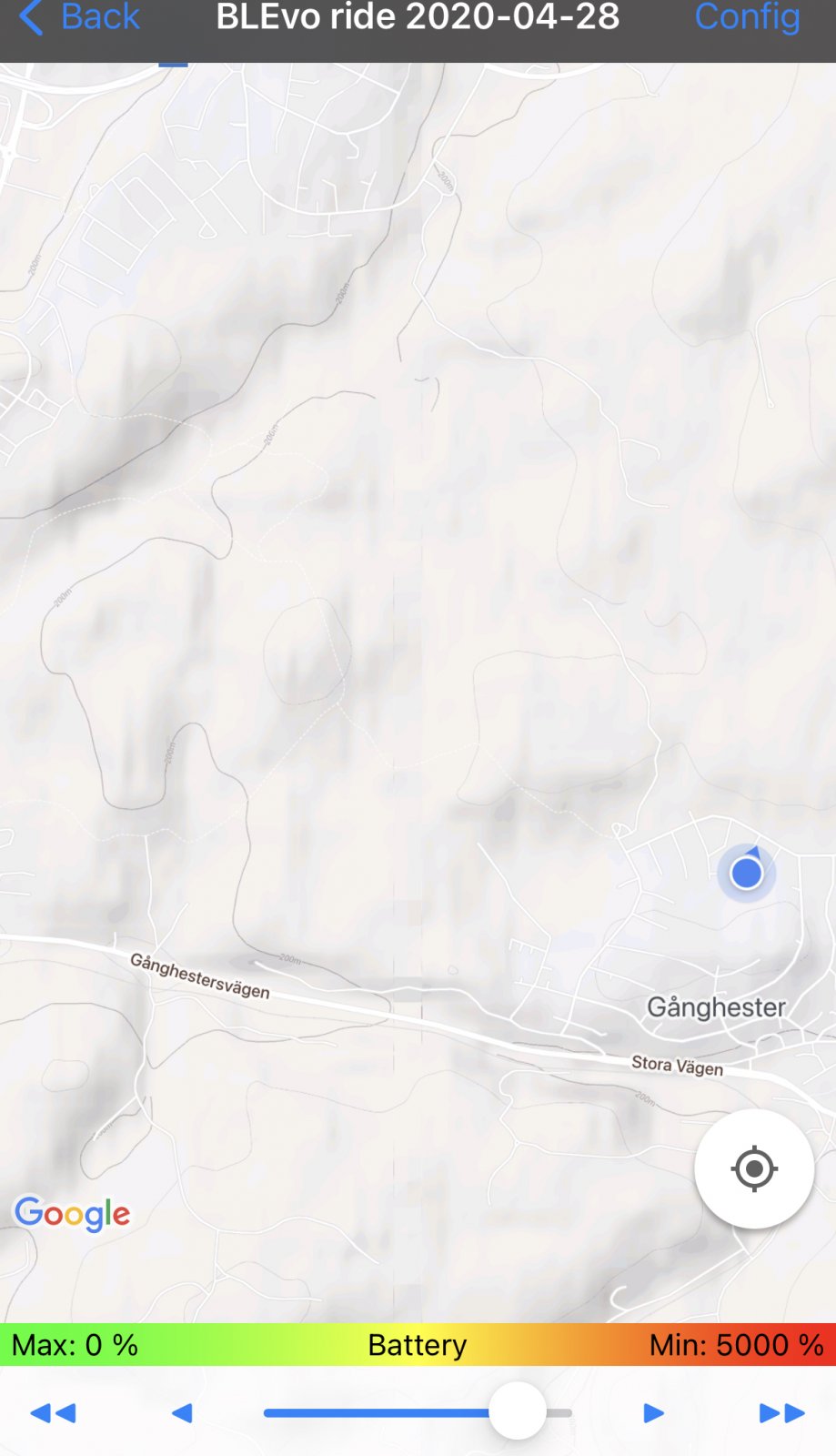

So, i have so many bluetooth issues with my Bv6000 that I consider using an older iPhone instead for Blevo. However, the map display on iOS is so bad. Is there any possibility that you will change this to some other map source? On the android I use the downloadable ones and they are great. Here is Gaia GPS using the same openstreetmap as Blevo but with a much greater visibility.
First of all it is better to solve the issue with BV6000 that is very good for bike and BLEvo..
I think there are some settings in the Android setup to avoid Bluetooth issue.
For iOS, your are showing the Map after ride, not the map during the ride that are Mapbox and not Google... Mapbox is a little better than Google map..
