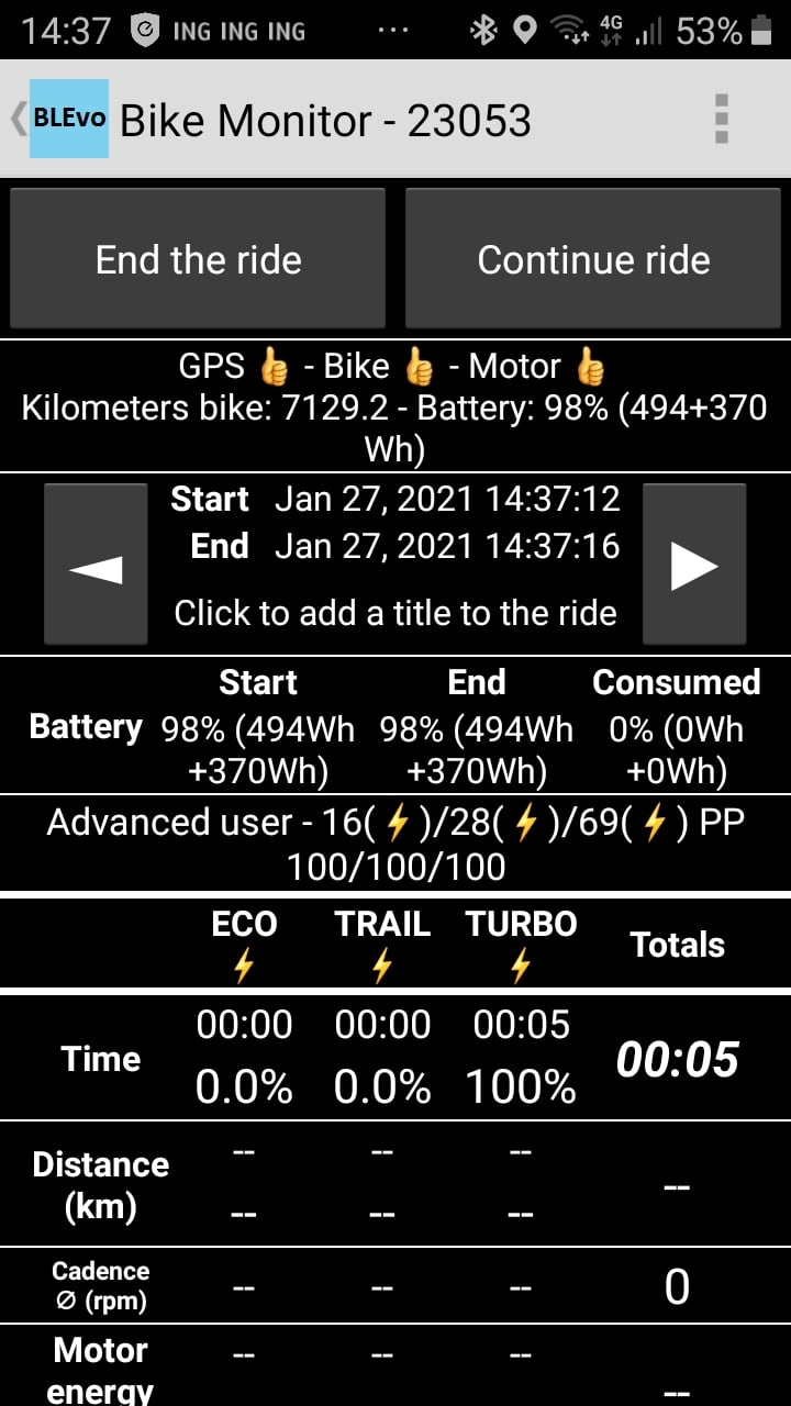

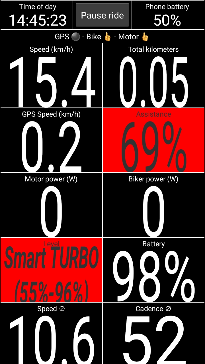

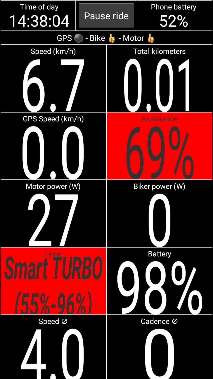

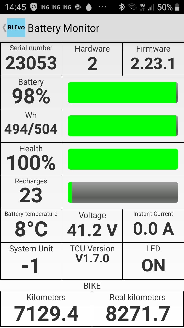

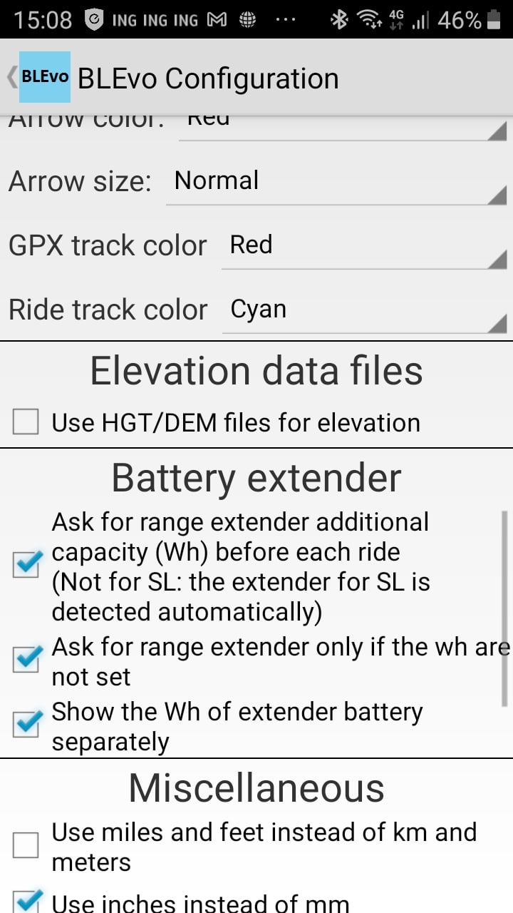

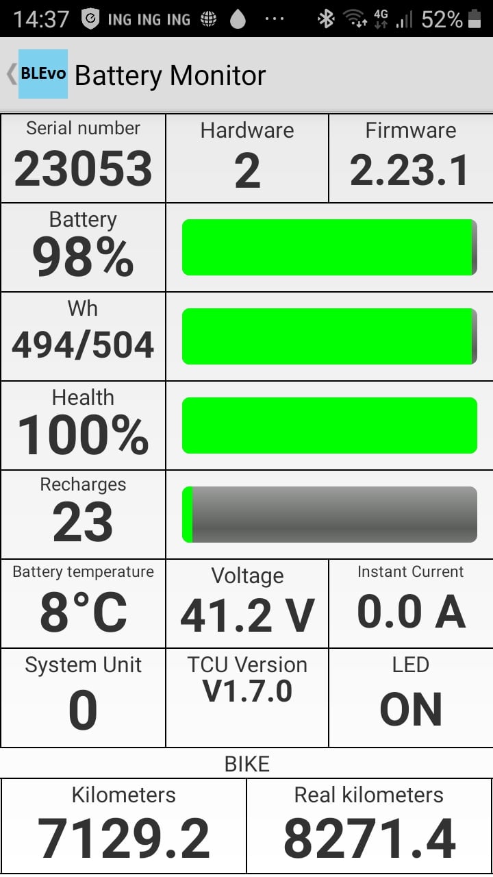

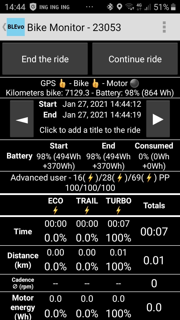

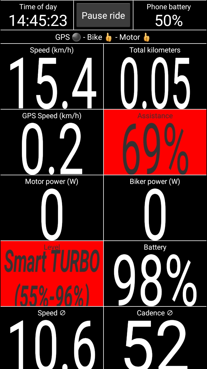

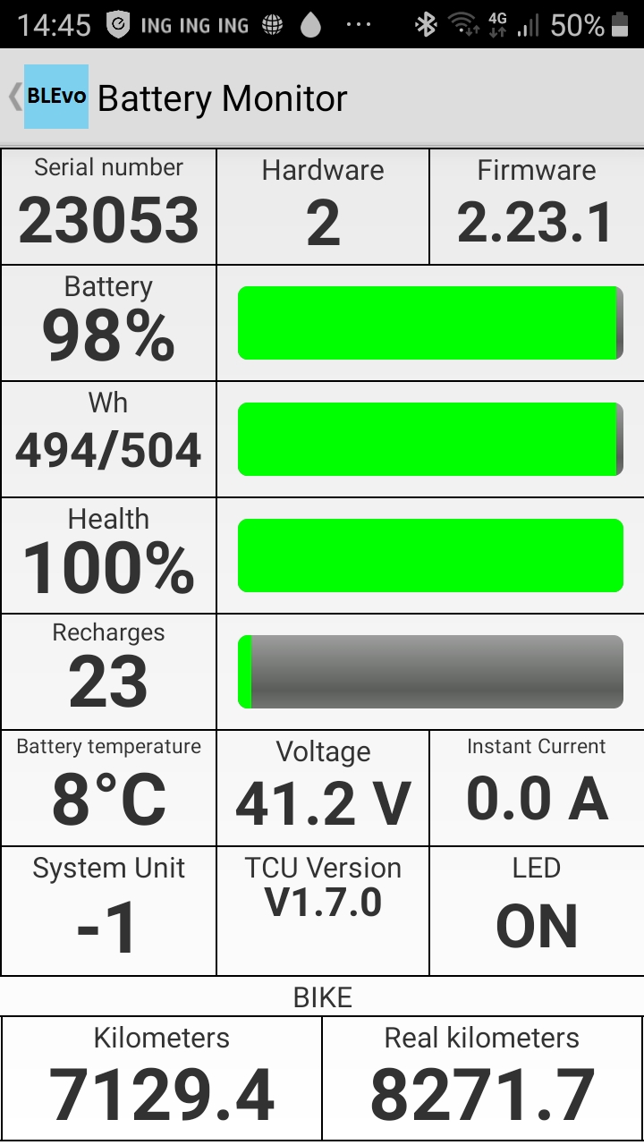

Paolo since a few weeks I have mounted an extender on my LEVO FSR (2016/17). Everything works fine and my range is much wider. However I set the configuration BLEVO keeps indicating that my battery is 98%. If I indicate in configuration that I want to have the batteries shown separately or added together, then that works ok. I have read on the BLEVO site that the battery indicates above 100% when an extender is mounted. What am I doing wrong ? See attached pictures.
This sentence
"I have read on the BLEVO site that the battery indicates above 100% when an extender is mounted"
is true only for SL model where the extender is the Specialized extender, because BLEvo can read the data (percentage and wh) directly from the extender battery. For all the other kind of extender, BLEvo doesn't know these data..

This sentence
Clear. Thanks

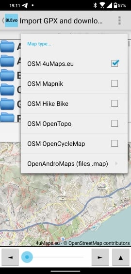

You can use any of the preset maps. All maps are based on OpenStreetMap and cover the whole world.
If you want to use the OpenAndroMaps map, you will have to download it from the net and install it to the Blevo MAPS folder.
