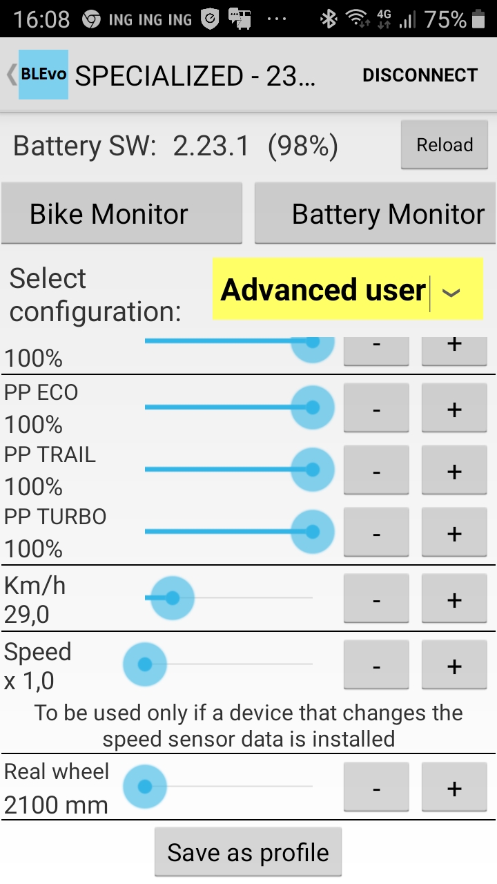

thanks for your quick respons.
BLEvo version = 3.8.0
settings are
Eco 20% // PP 60%
trail 70% // PP 75 %
Boost 100% // PP 100%
km/h = 36.0
speed = x 1.0
real wheel = 2255 (messured over length of 10 wheelcycles ; =length : 10)
Your answer will be apreciated.
Could you answer the thumps-up versus green led also?
thanks in advance.

very strange this big different values...
Maybe you can try to use the GPS instead the bike data, or try to recover the max speed to 25 km/h...
Let me know..

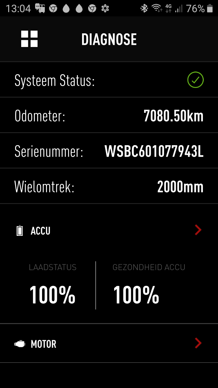

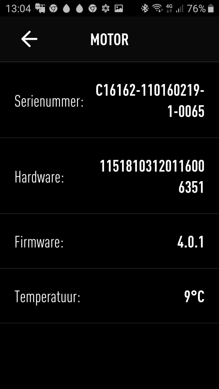

Maybe it is the setting of the wheel size of the Sworks bike... could you post check the wheel size with Mission Control?

I suppose yes.
First of all you need to set the real wheel size and then modify the Km/h value..
Let me know.
