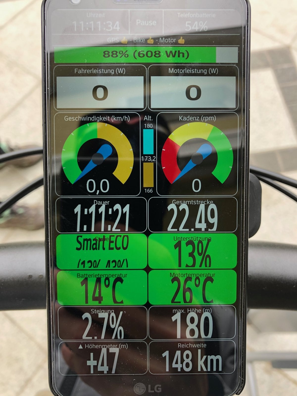

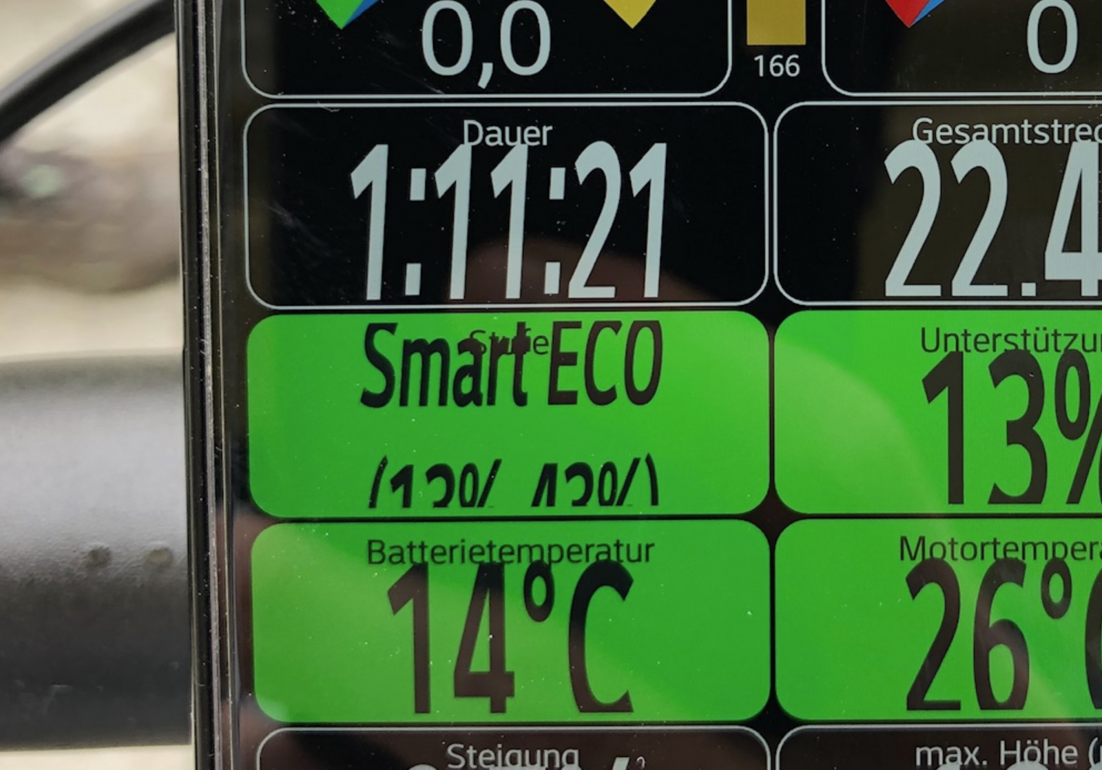

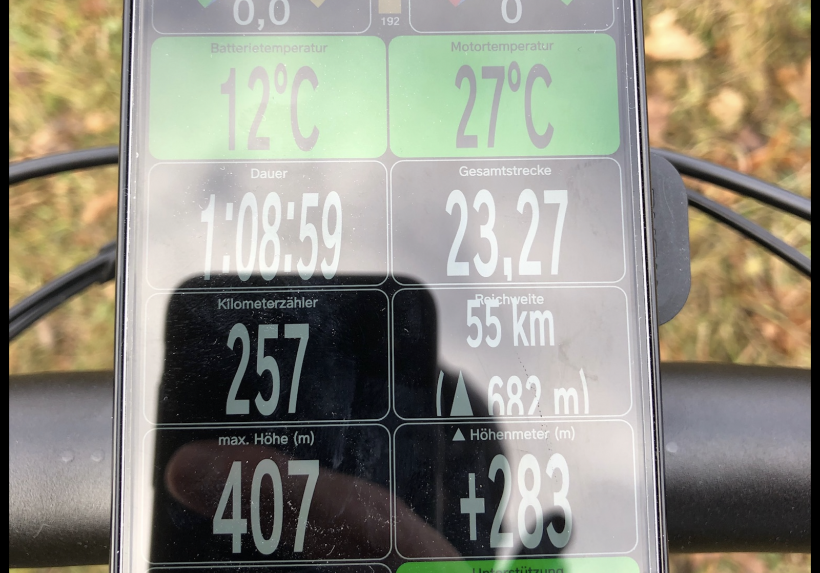

Sorry Paolo, the battery temperature is displayed correctly. Perhaps it seemed like a transcription error. Here is a picture from my phone, all correct.

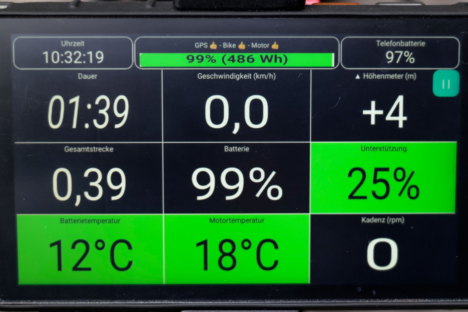

@PaoloBLEvo

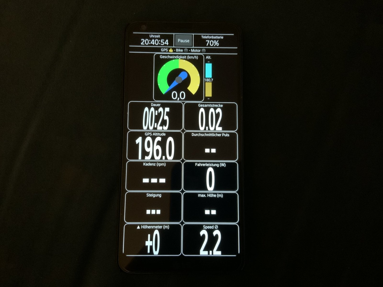

here a screen Shot when the bike is connected. As you can see some details are shown to big.
is this correct? Or should I try to rearrange the fields
Only the range is shown correct.
EDIT: have found it out. Had to change the size from the Apps to smallest of three possibilities
thx

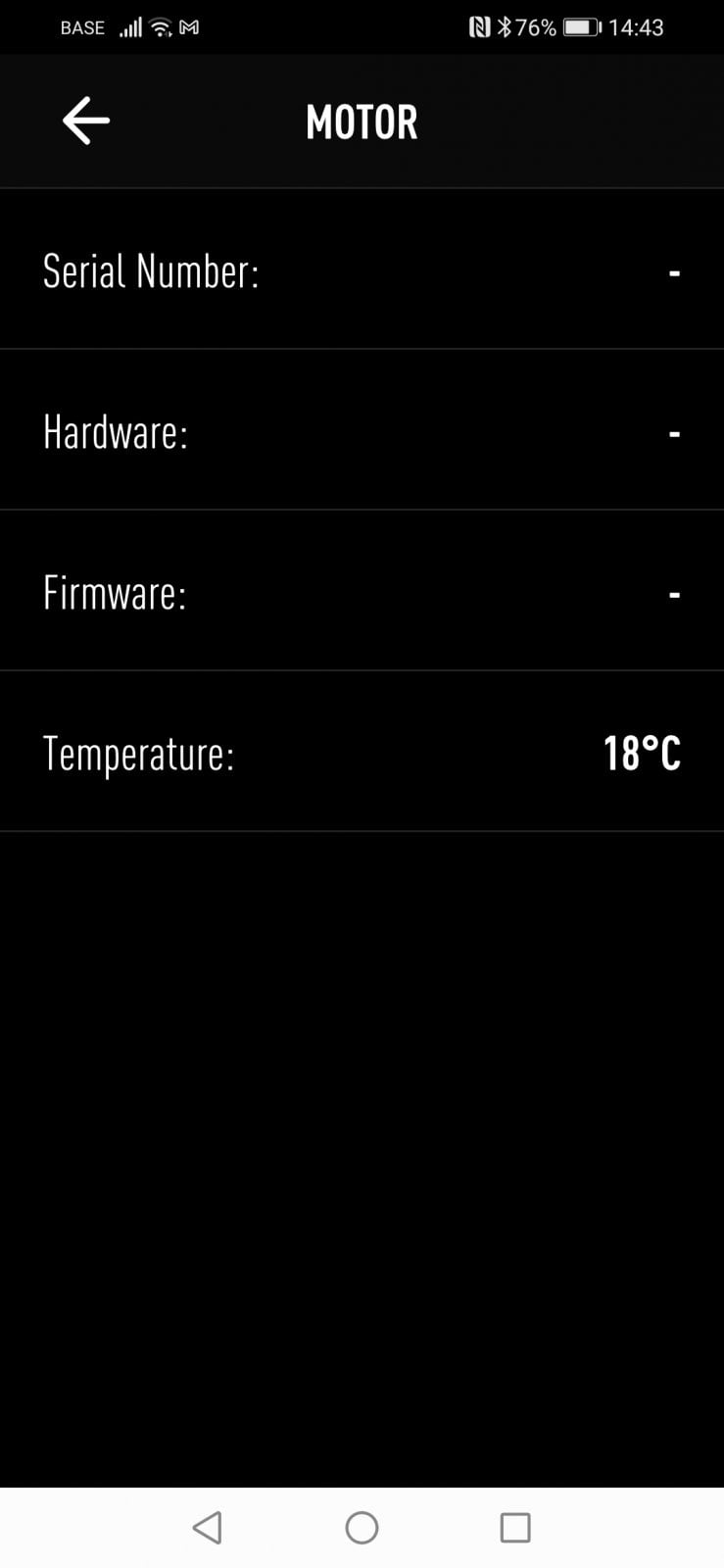

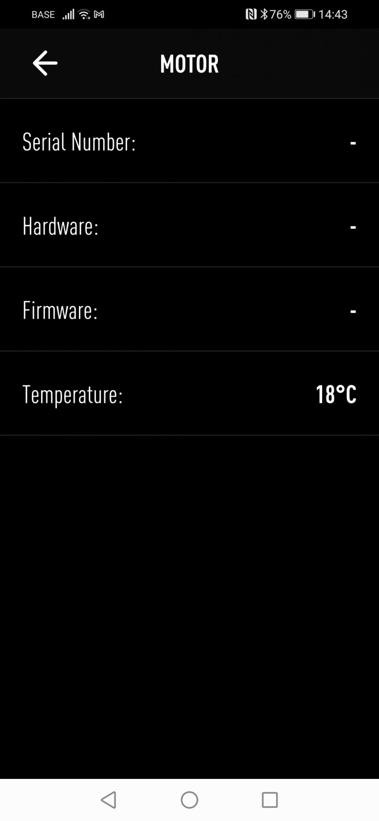

After starting BLEVO for the first time, I found out that the assist has gone. Also on the mission control there is no info on the motor (see picture). The motor was on 4.0.1 firmware. Any ideas what is wrong? Thx

I just bought a used Android phone (LG V10) to use for Blevo, and I’m having the same problem with font size. I tried changing the font size in the phone Settings - no luck. Where did you go to change the Apps font size? I’m running 3.7.5 Blevo.

@2cool2fool try this: scaling of apps on the LG G6. The most direct way is to head to Settings > Display and then scrolling down to select "App scaling". you'll see a long list of all the apps installed on your phone

@PaoloBLEvo
thx
Good to know.. I think if you set the font as "Normal" the value will be big enough
I think you have issue in the connector from battery to the motor.. please clean the contacts and retry..

@PaoloBLEvo Once again with the size. ? Why is the Range shown not correct? The same issue happens with Smart Power
It‘s not a major problem but maybe you find a fix for it. thx for your hard work?
