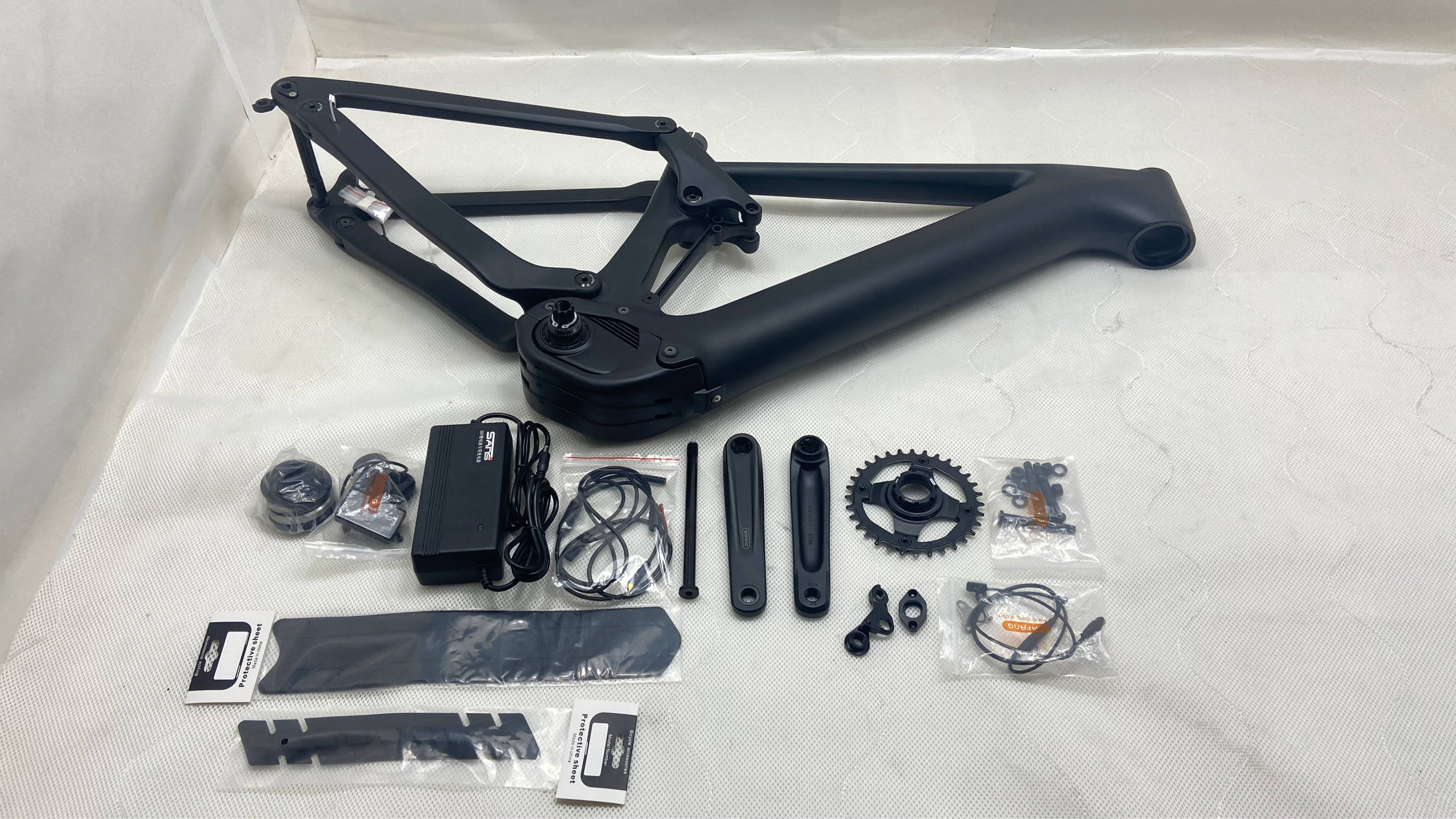

This is mine with 720Wh battery before delivery 2 days ago. Linda said all already tested and have no problem. So I'm just hoping everything will be OK when arrive.

This is 15" size for small guy like me. On December I ordered CEF49 frame from Linda, and she didn't tell me that sensor cable and magnet is different from Dengfu or Light Carbon, it has the same sensor cable as CEF50. So I pushed her to send the right sensor together with CEF50.

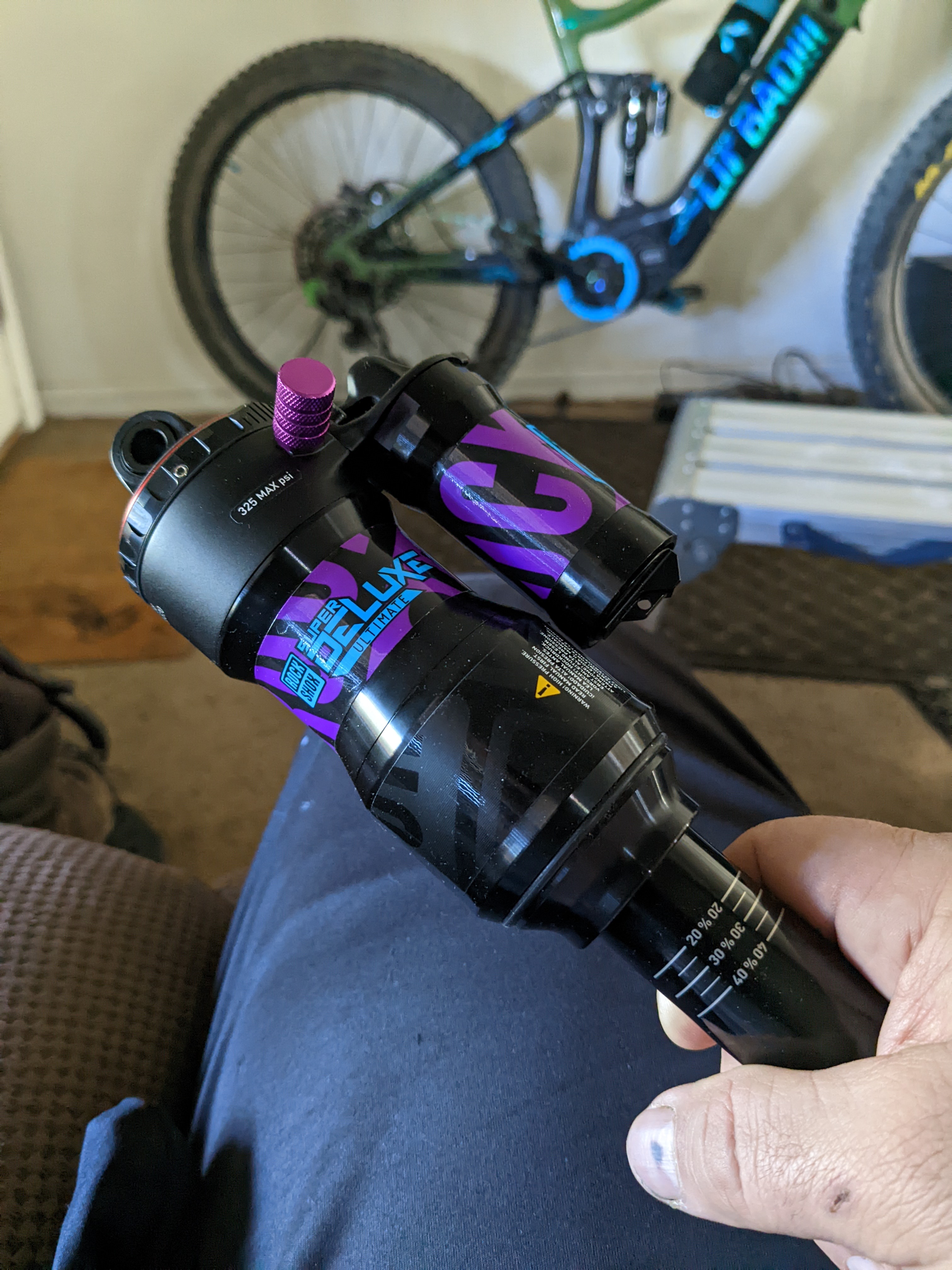

I will use this old rearshock, just for Trail and adventure riding is enough. Only cost $150 :D

the more I see pictures of the frame, the more I think a coil shock won't fit...
I’ll try fitting a coil shock as soon as it arrives. Will try the following shocks
Rs super deluxe ultimate air 210x55
Rs super deluxe ultimate coil 210x55
Suntour triar 3cr 210x50
I dont want to overstroke it so probably will end using the triair @ 210x50 or max 210x52.5 so I can swap between mullet and full 29er without touching the shock

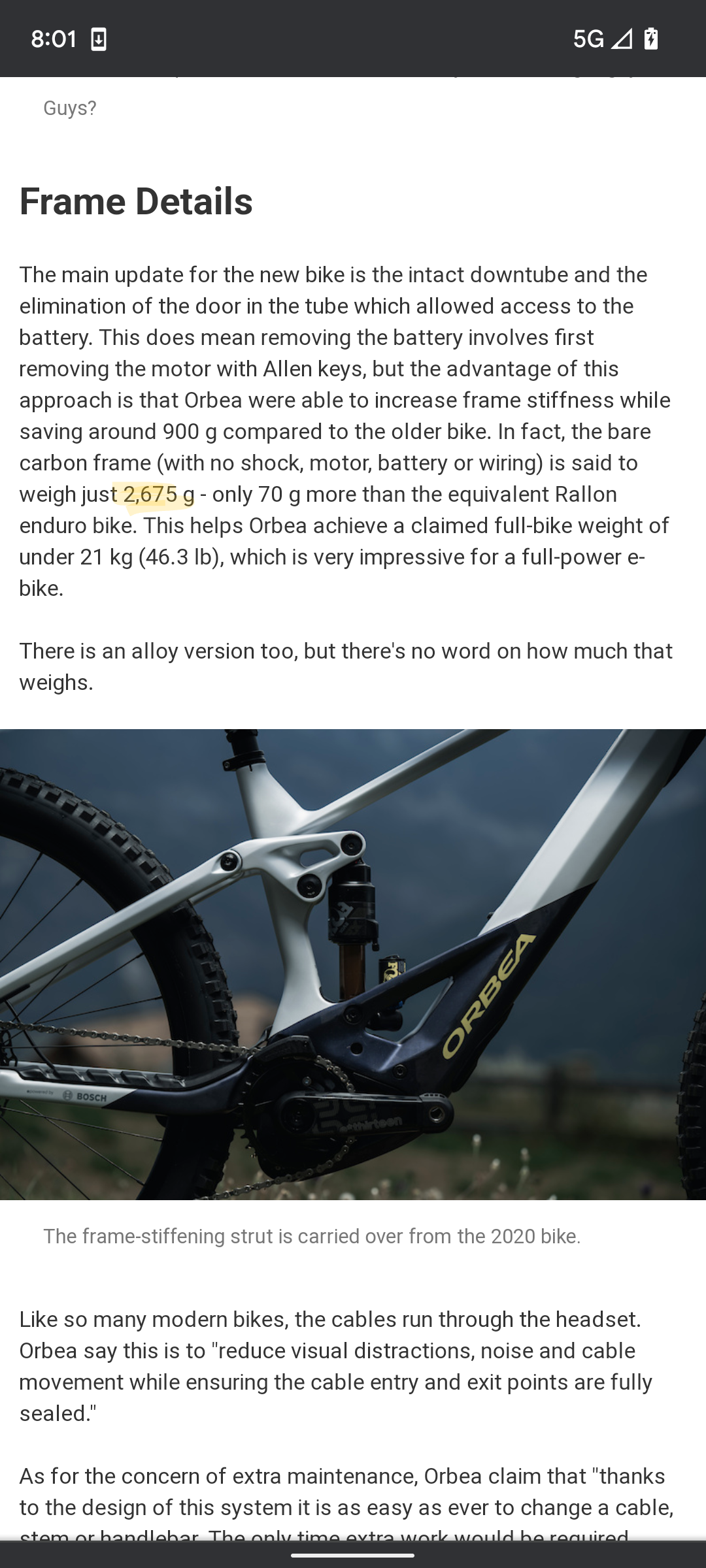

For frame integrity comparison: The 2023 Orbea Wild FS M-LTD full-powered is a full race Enduro bike with not battery cuts out. They claim 51% stiffer while shaving off 900 grams.
It's large frame carbon weight is 2600 g +/-, similar to a large CEF50 frame. So, not saying same quality control as Orbea but in theory the CEF50 engineering should be Ok.🤞

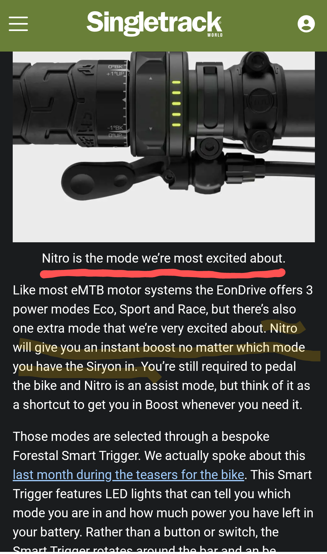

Yep. 💯 it's the superburst 95Nm peak mode. I'm hearing no long 4sec ramp up like Fazua60 (kinda sucked when I rode it) and varied only 6-12 seconds depending on how hot the motor was running.🫣
I'm hearing instant up burst up to 30 secs for the m820-75. If so, this is a major feature to standout among the others.🤘
If it's anything like Nitro of Siryon's M820-60....should be nice!

I rreally like this too. I hate having to turn a corner and hit a vertical wall and try to change the mode in an instant. This way I can leave the mode in eco and just hit the nitro for help up a steep climb then back to normal.

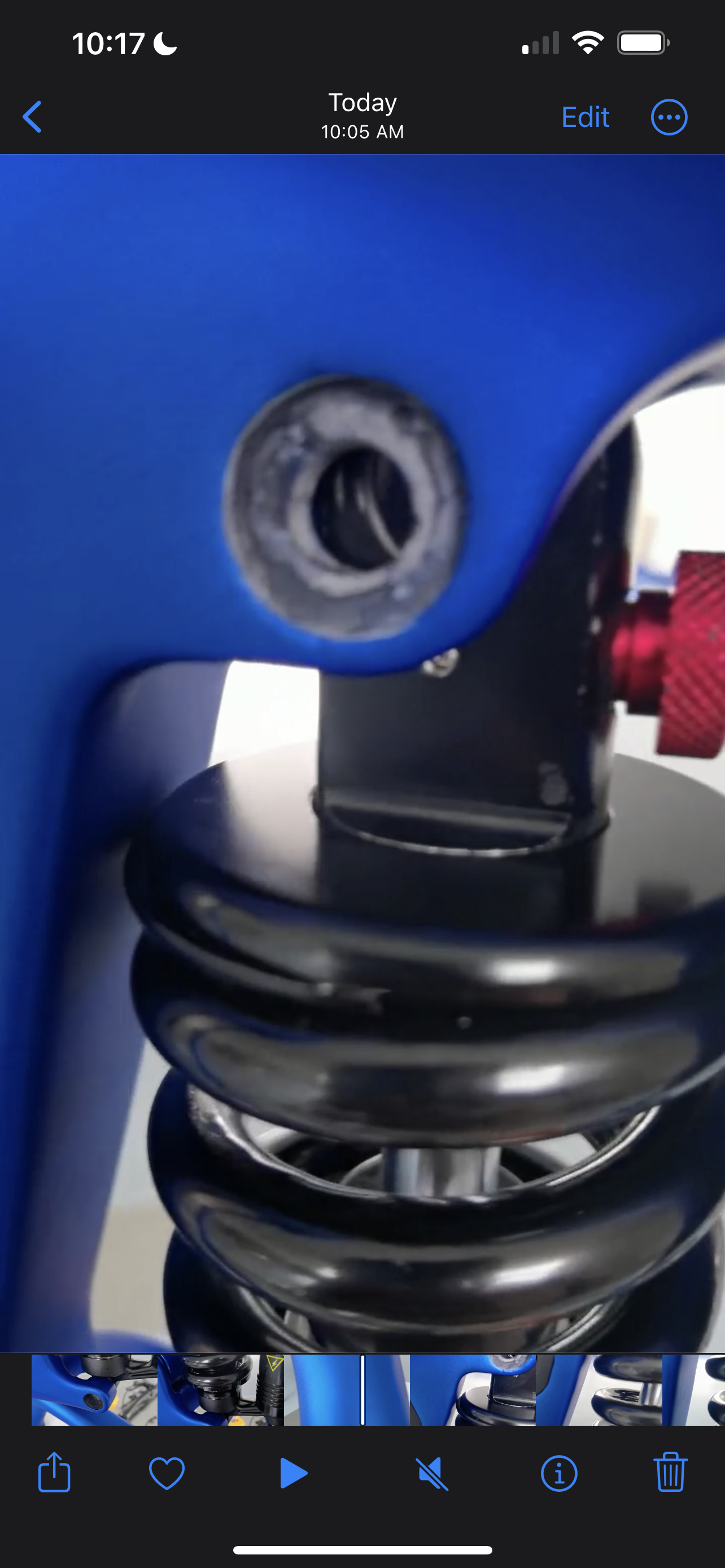

I took a screenshot of a video Linda sent me.. looks like a big problem. This is a coil shock and it looks like the bottom isn’t able to fit at all.
What has me worried is if an air shock fully compressed, it would also hit the frame at that point.
Yipes! That's tight! Any more pics that you can show the whole setup!

Wish I could just upload the video.. she is pretty zoomed in the entire time but the picture above is the bottom part of the frame.. the upper portion of the frame with the linkage actually fits.
Alright, thanks for sending me the full video. I'll confirm vid with Linda. But your pic is clear enough...too tight for coil tolerance!🫣
But it looks a coil is not going work on CEF50. Neither is my fat air can. 😜
Well, the next best option for a M820 frame with a coil is the LCE930 still in development. 🤙
LC Jim does a good job, so might be worth the wait. I can't however.
I think I'm out. I needed the coil/big air can option and the big 720 Wh battery being a heavier dude.
I'm going back to full-powered while I still have a chance to purchase the frame.
Good luck peeps! The CEF50 looks pretty sweet and I look forward to seeing some mean looking steeds out there! Also, some good reviews on the exciting M820-75 big, light-weight, mid-powered motor.✌️

That picture is upside down from left side. Isn't your aircan at the top sitting towards the middle of the frame triangle?
