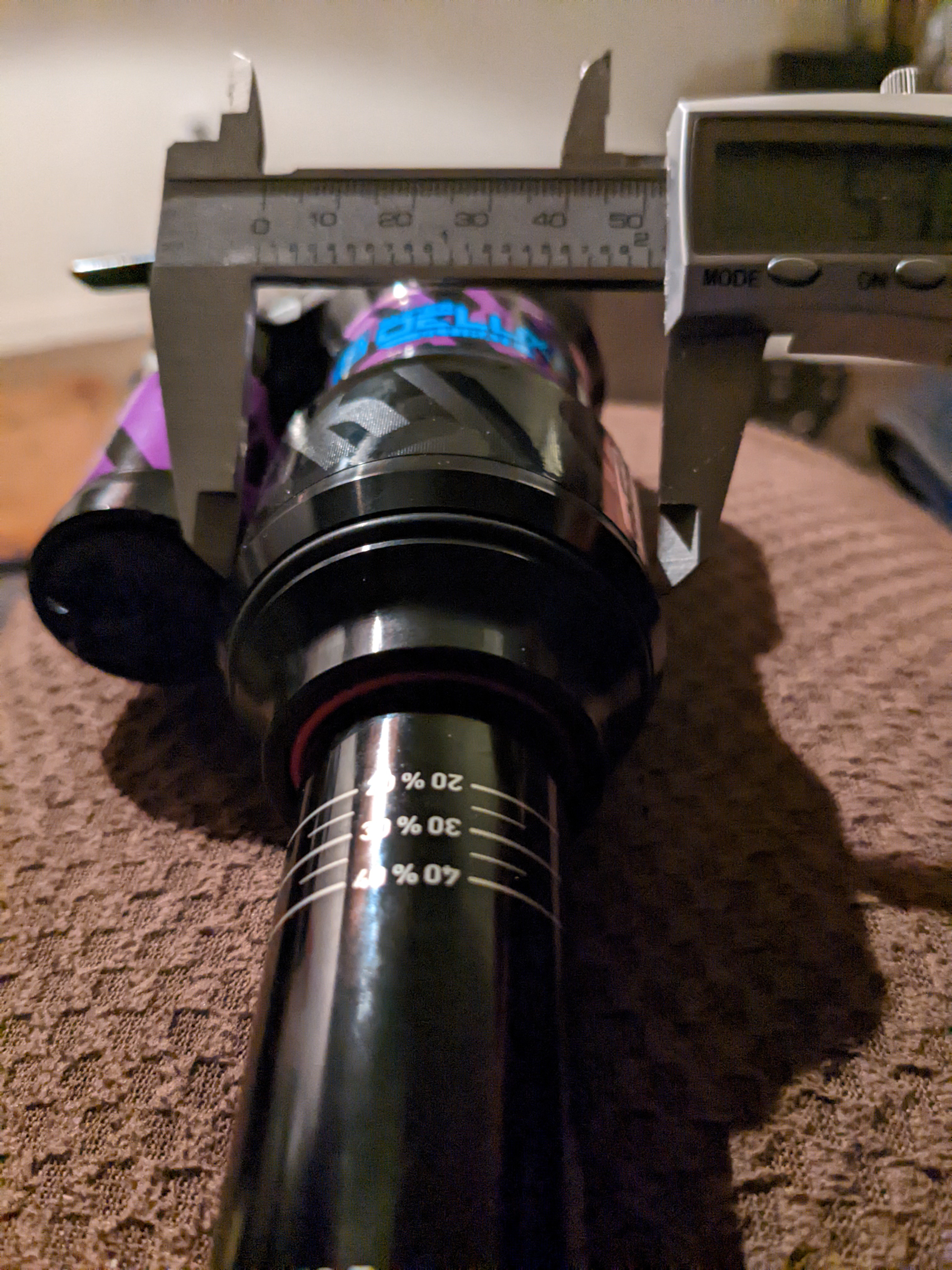

A megneg/float x should fit.
The issue is with a coil, i can confirm in some weeks as soon as it arrives, will take the coil out of my jeffsy and try it
I think the Float X should fit. My MegNeg is as thick as a coil unfortunately.

The shock fit is kind of worrisome but as long as your shock has one skinny end it looks like it could work out. That coil was just to fat on both ends, maybe.

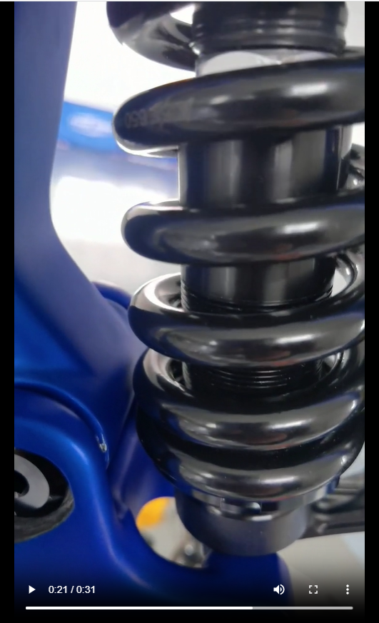

It looks like it should fit to me.

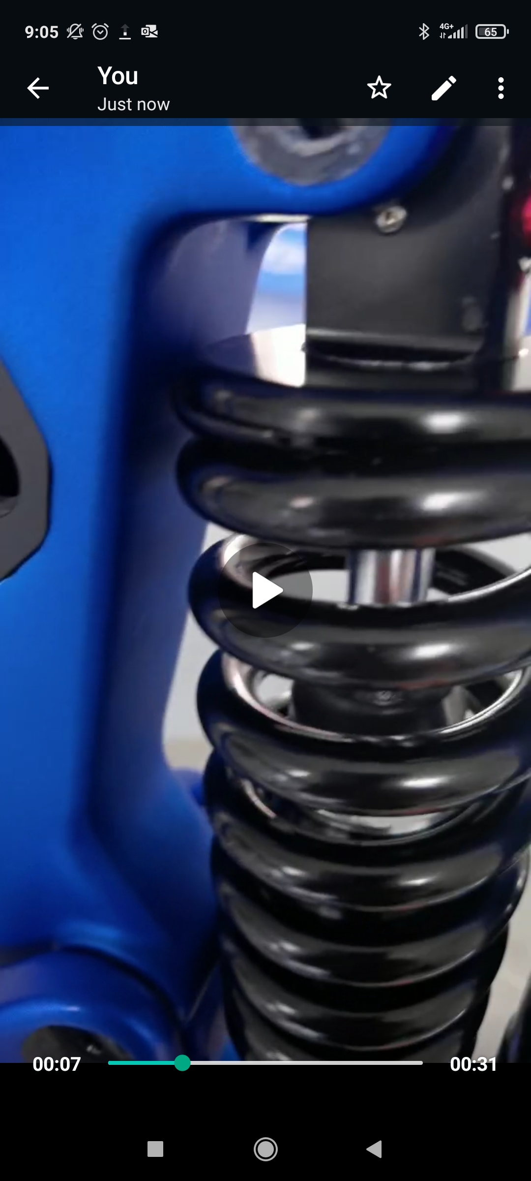

I'd ask Linda to have a better video demonstrating the coil shock in full compression. I'd switch to a Float X which should work, but cash...I'm out of it! I don't want to sell off the MegNeg and buy another $500+ shock.

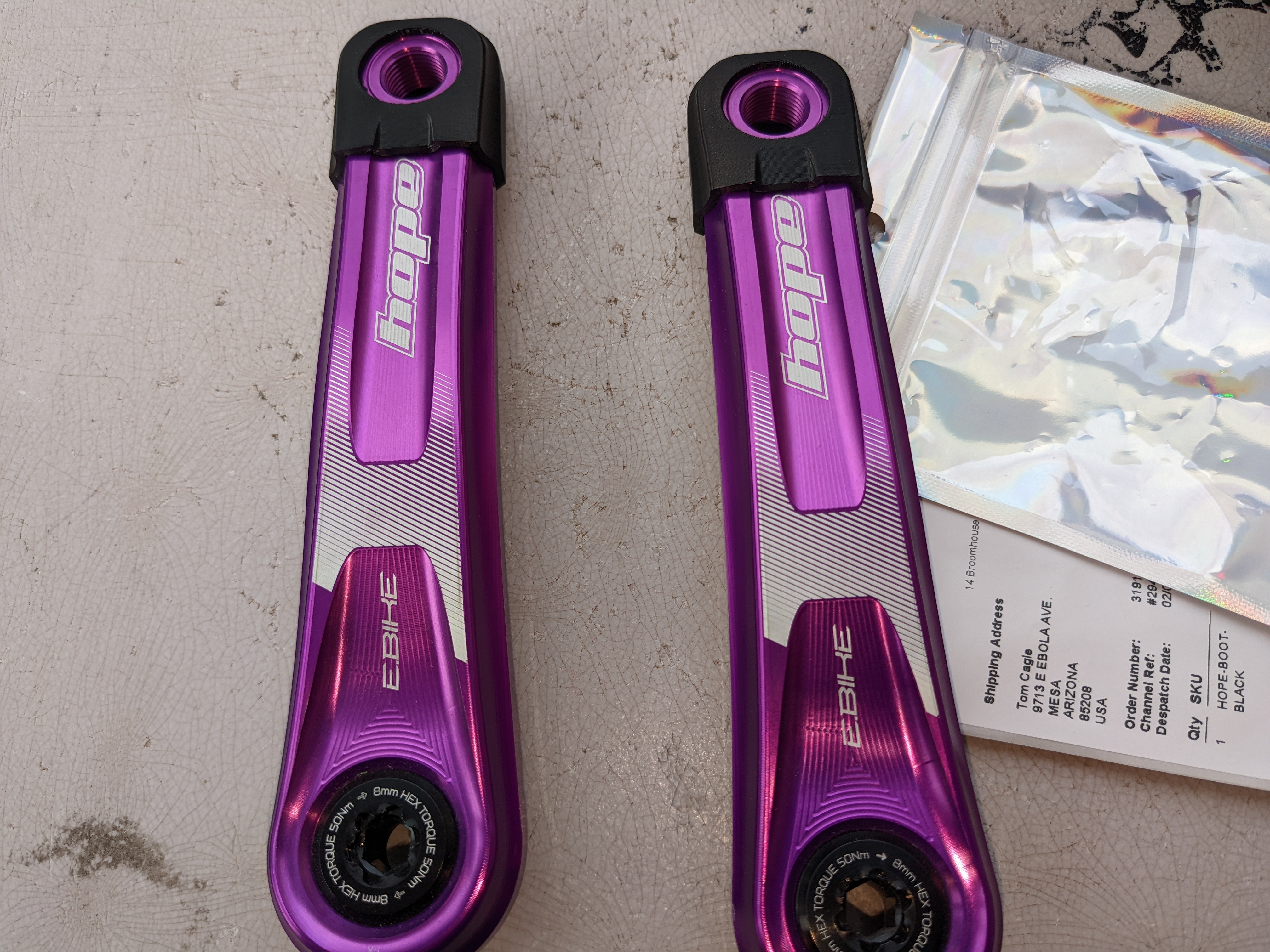

Sell off my purple Hope E-cranks only ISIS compatible. And that keeps my allocated budget even.
If you live in the US and want some sweet Hope bling, I'll sell at a discounted price before I list them on E-bay!

All they need to do is concave the seat tube area where it is hitting. Surly they could modify there mould to make it work.
I also think your megneg might work. As the shock will move forward ever so slightly. So it could work.
Any shock similar would be fine if this was the case.

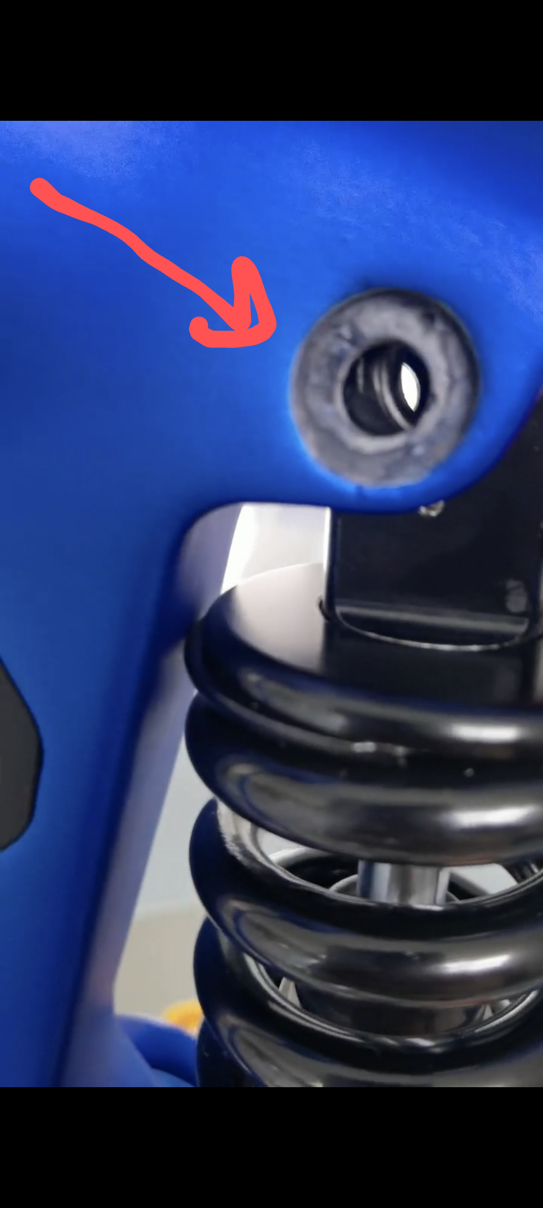

Look at this pic. Notice the eye hole on the lower mount isn't flush either...so it would even be MORE tight if centered on the bolt hole correctly.

Alright, thanks for sending me the full video. I'll confirm vid with Linda. But your pic is clear enough...too tight for coil tolerance!🫣
But it looks a coil is not going work on CEF50. Neither is my fat air can. 😜

That pic has the bike upside down. If you run

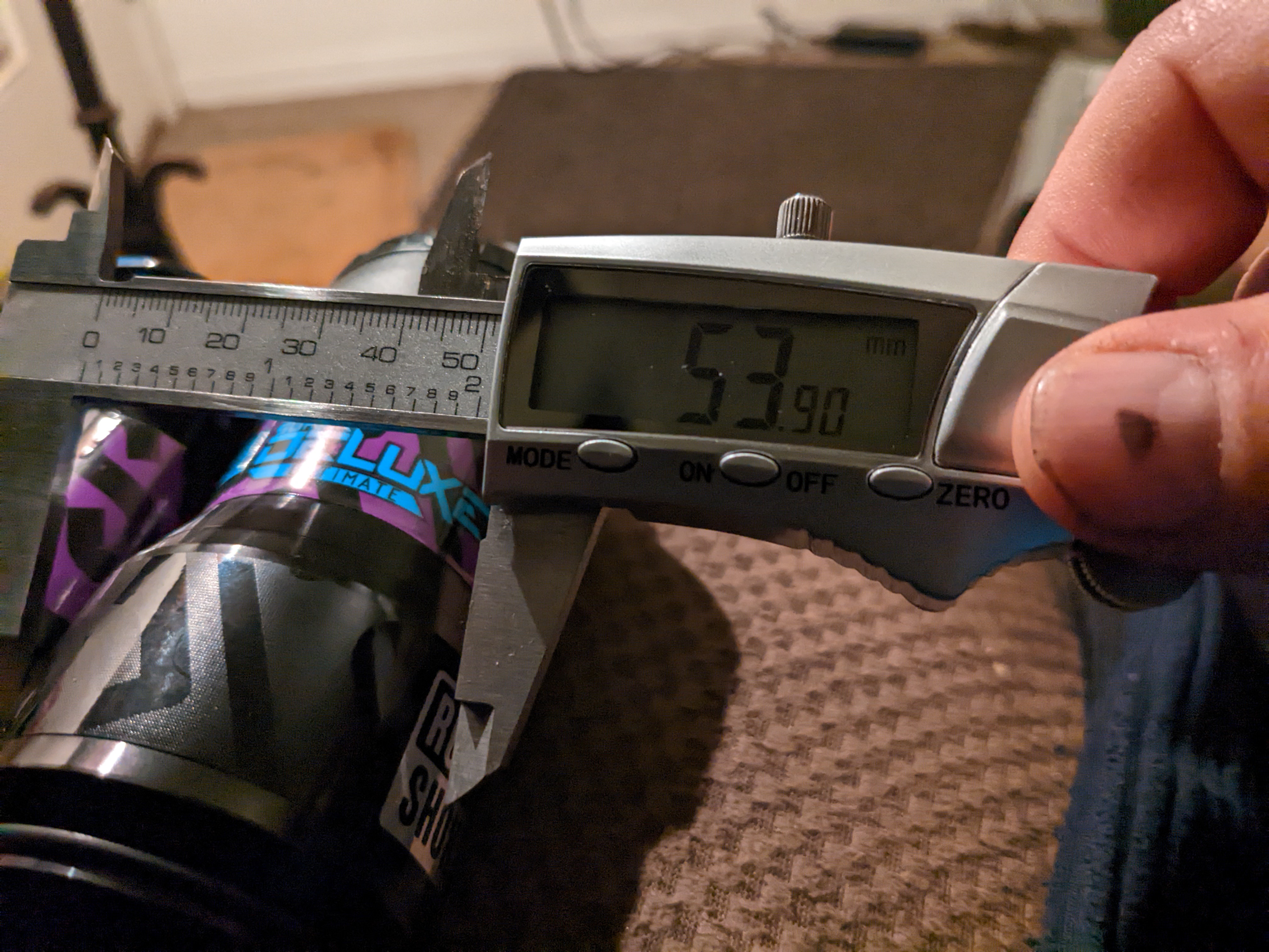

The pictures show clearance issues near the ends, but the megneg can is thick in the center. I still think it will work.
I tend to agree. When the fat part of the shock gets pushed down it will also get pushed out away from the frame. The coil is a problem because they are fat all the way down.
Too risky. Linda said she'll do a compression check on a standard shock Monday..This tells me Linda knows the coil won't work.
