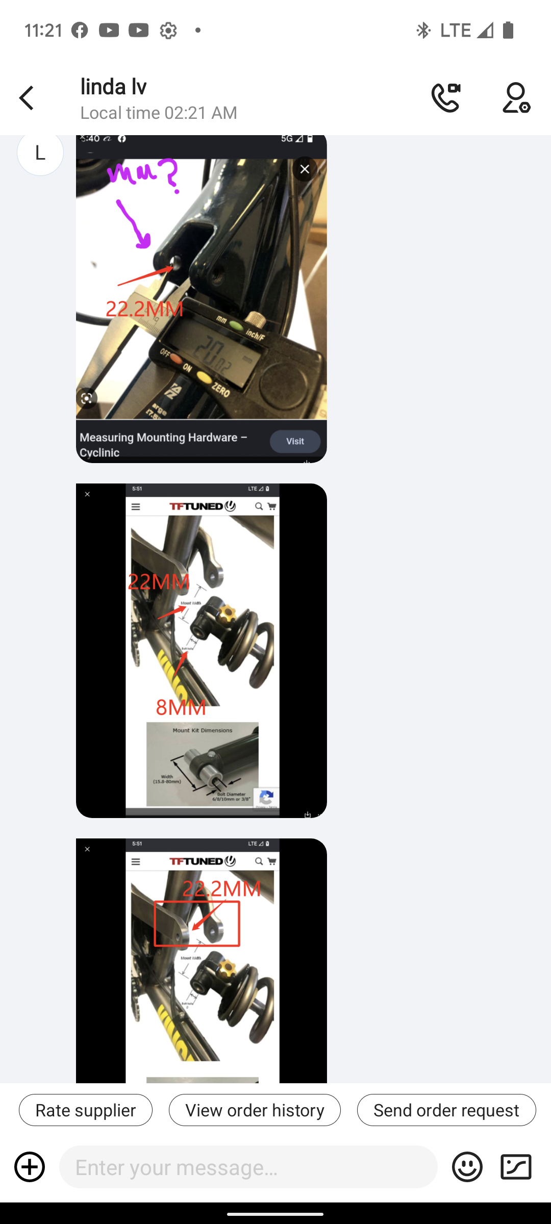

they sent me those same pictures. So I posed a very specific followup question as to what size bushing to buy. They checked and engineers said 22mm. You can see on those pictures, the opening is 22.2mm and bushing size is 22mm. Guess they factor in tightening?
Quick search I see locally can get Cane Creek in that size. Or if you can wait for the slow boat from China, Aliexpress has them cheap: 2.63£ 6% OFF|Shock Absorber Bicycle Mtb | Bicyxle Shock Bushing - Mtb Rear Shock Bushing Bike - Aliexpress

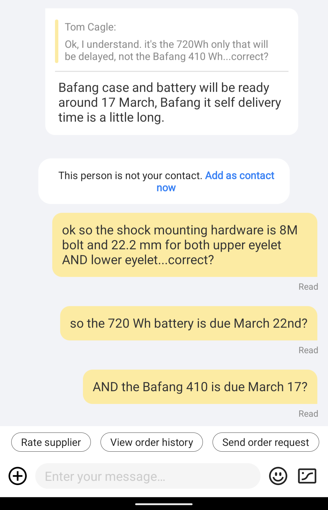

For my RS Ultimate MegNeg shock. I'm doing it for both upper/lower eyelets.🍻
