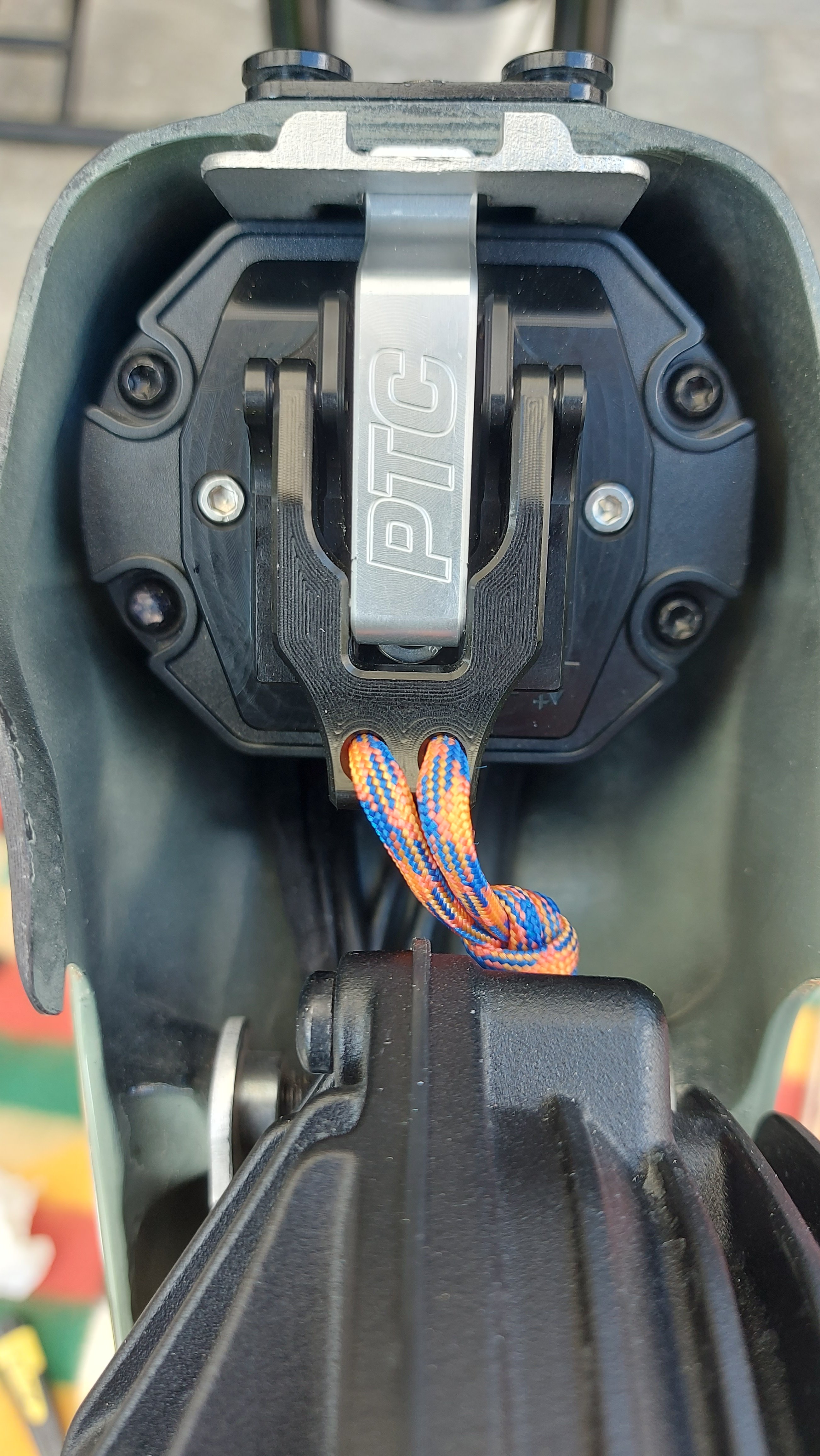

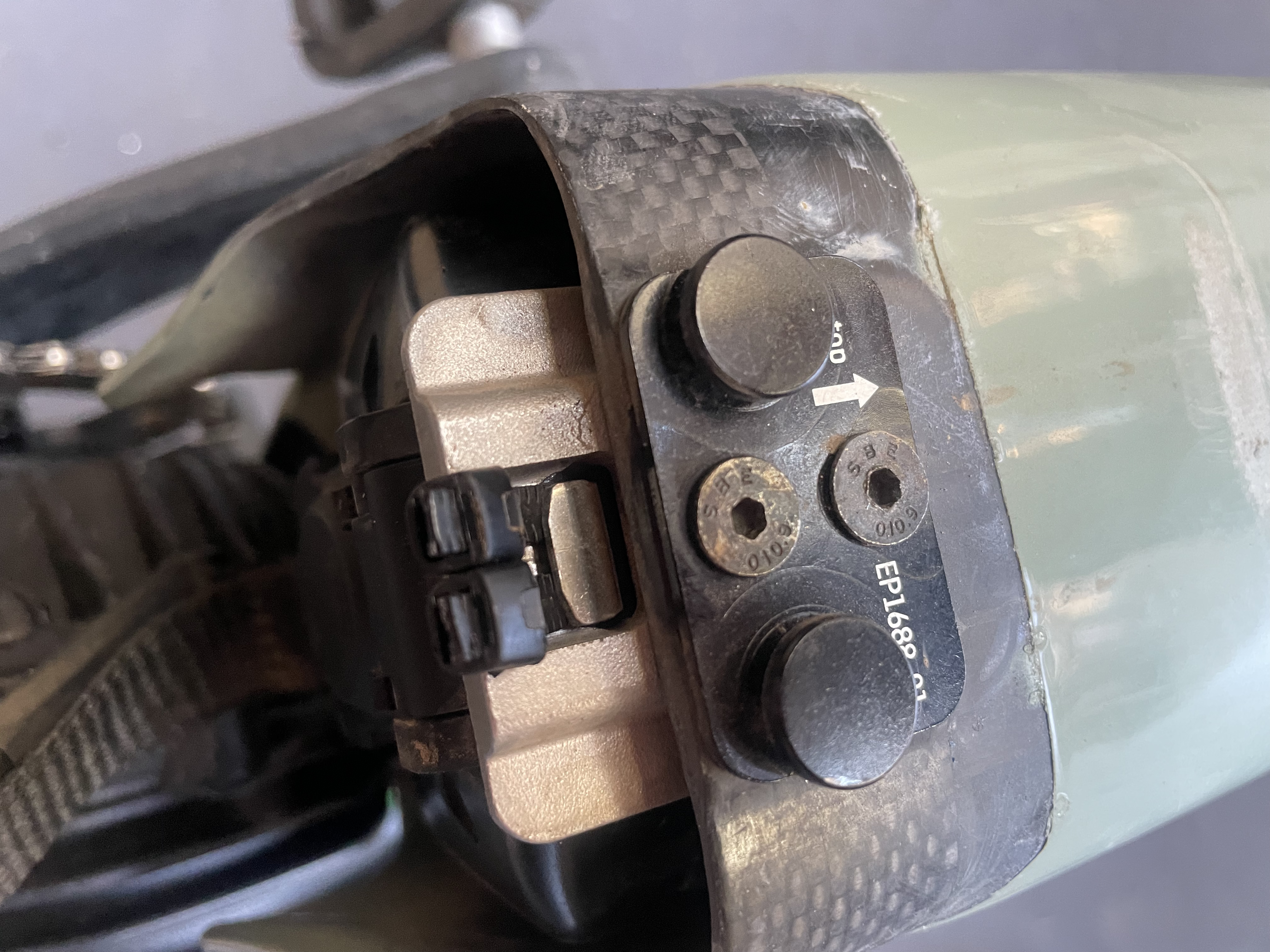

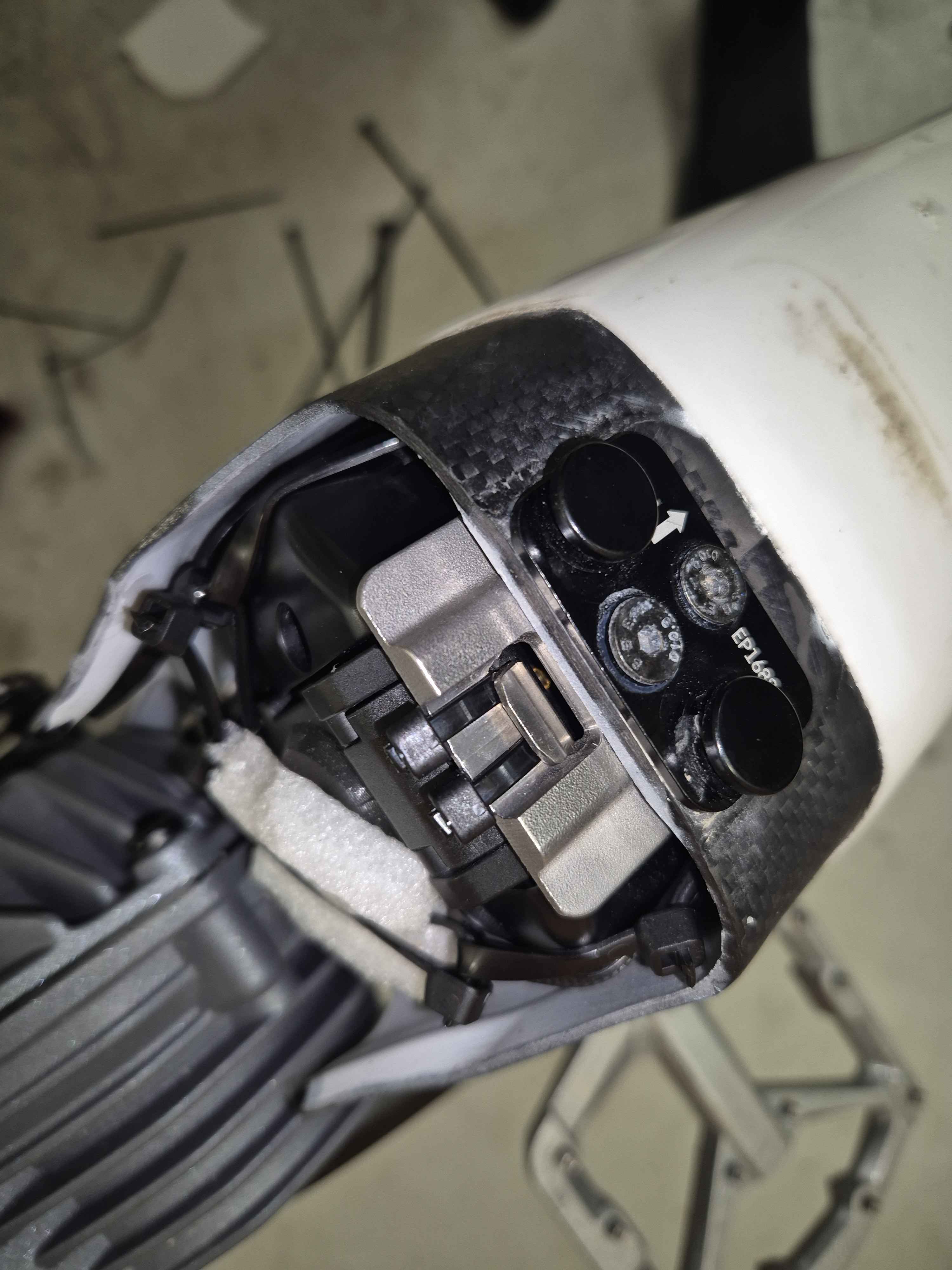

What I found:
Upper Connector completly lose on the support that attatchs to the frame (which is stainless steel by the way).
A wire that was a bit damage (bent and dented). Took care of this, and move on!
The connectors (proctruded steel parts), full of deposits. ---> cleaned properly.
Check that the protective cap, that goes in this upper bracket don't fit snugged, so I solved it. No more moving things on this side, so, no more noise (I hope!)
Everything was then assembled, using threadlocker, and that is it!
This was done!
After assembly the battery, I could notice some side to side movement, so I figured out a Prototype.
Thing has been steeler, up to this point! It has also quieten the bike, and the rattling noise is reduced by a long shot, and mainly from the motor (at least it seems like it).

What I found:
This was done!

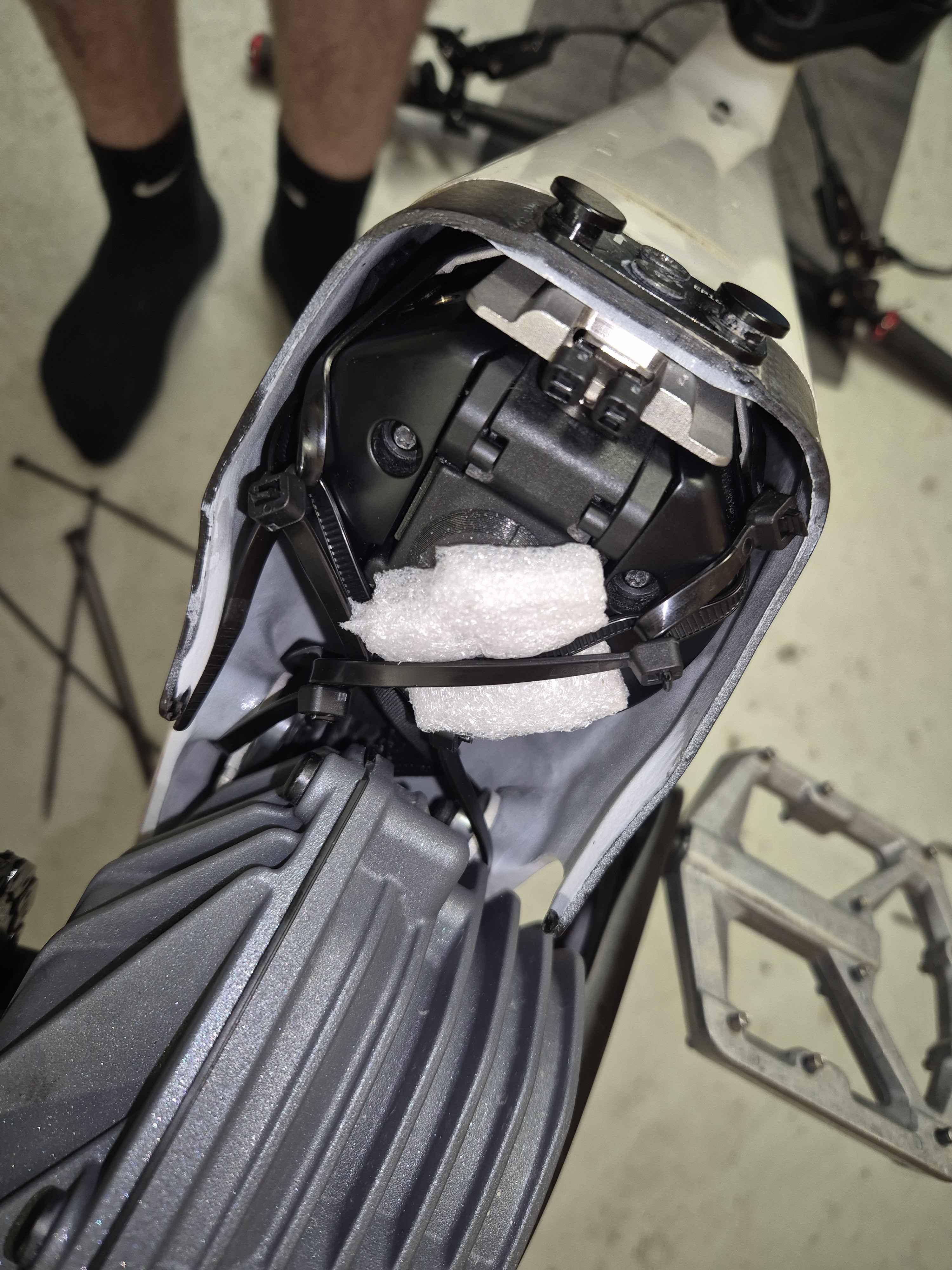

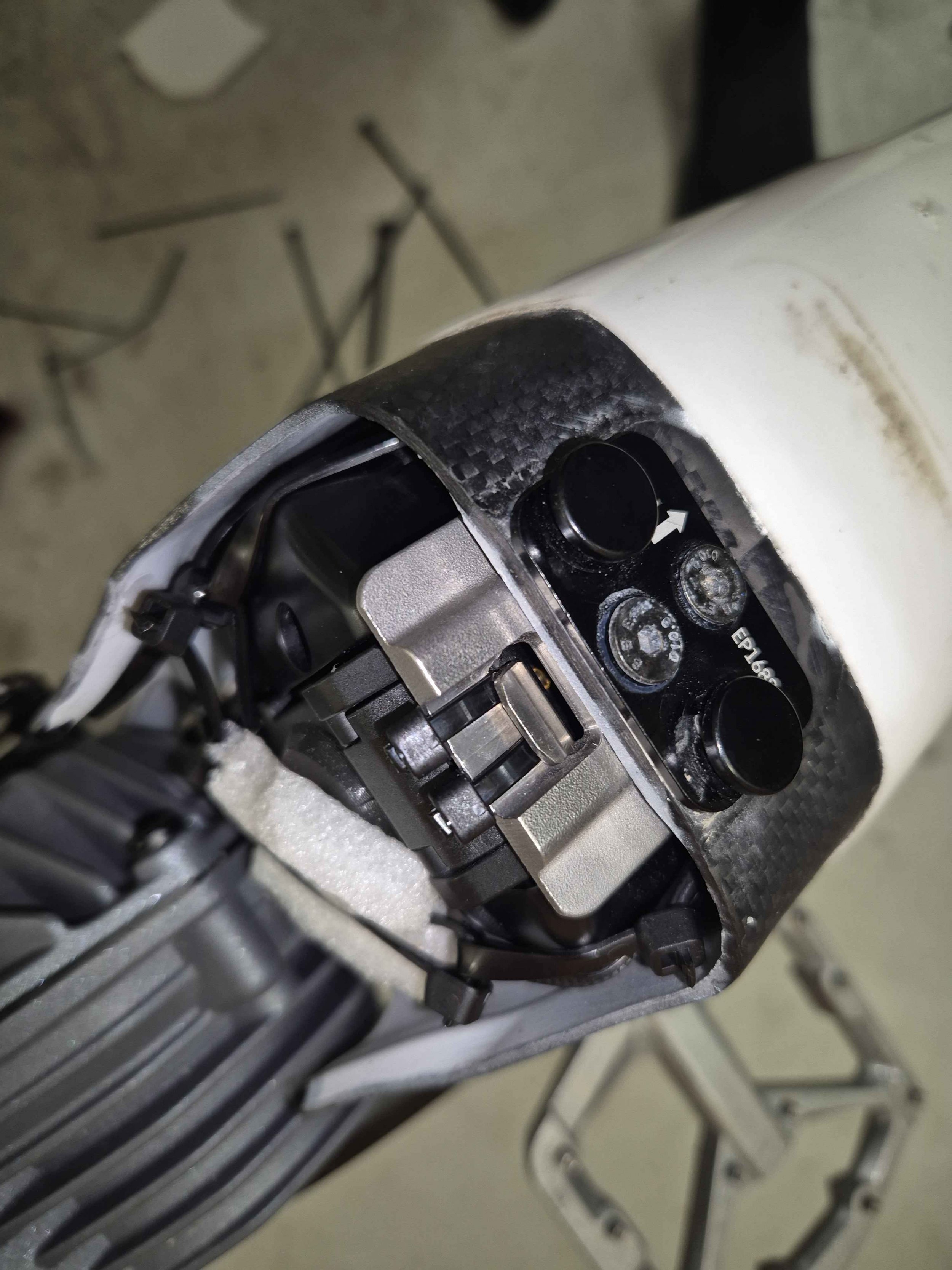

I am going to have to try this pre-emptively with some dense foam tucked along the battery sides. Thanks for the awareness
I tried something like that too. Please be careful. If the foam is stuck tightly (so that the battery can no longer move), then it will be very, very difficult to get the foam or the battery or both out again!

I would prefer to place some Foam Tape (eg: )
It's not the solution I'm testing BTW, but it's a solution and easy to install!

I had a similar problem with a Trek Rail, I used 3m adhesive foam pads and just kept adding them till the battery stopped rattling.

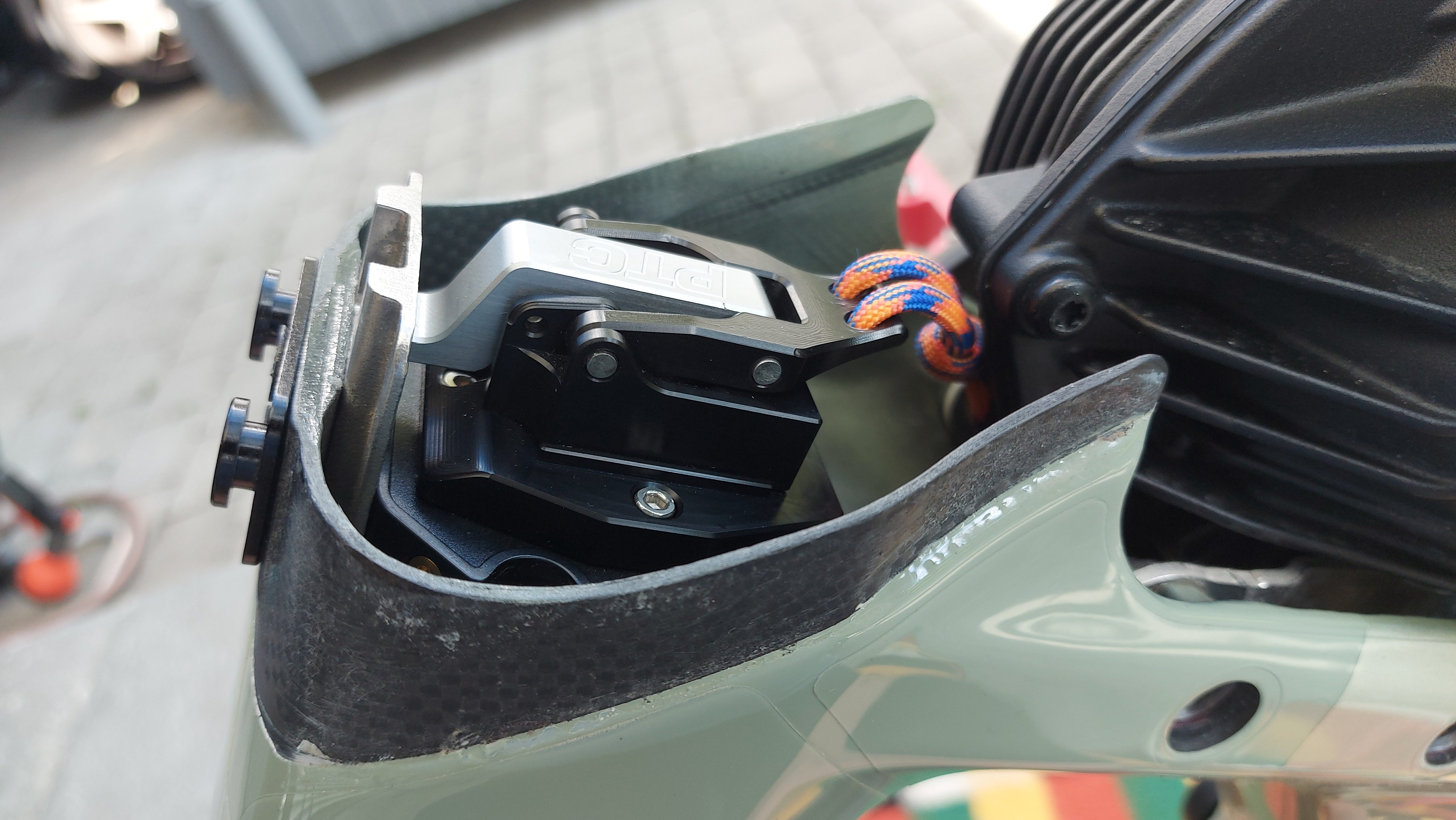

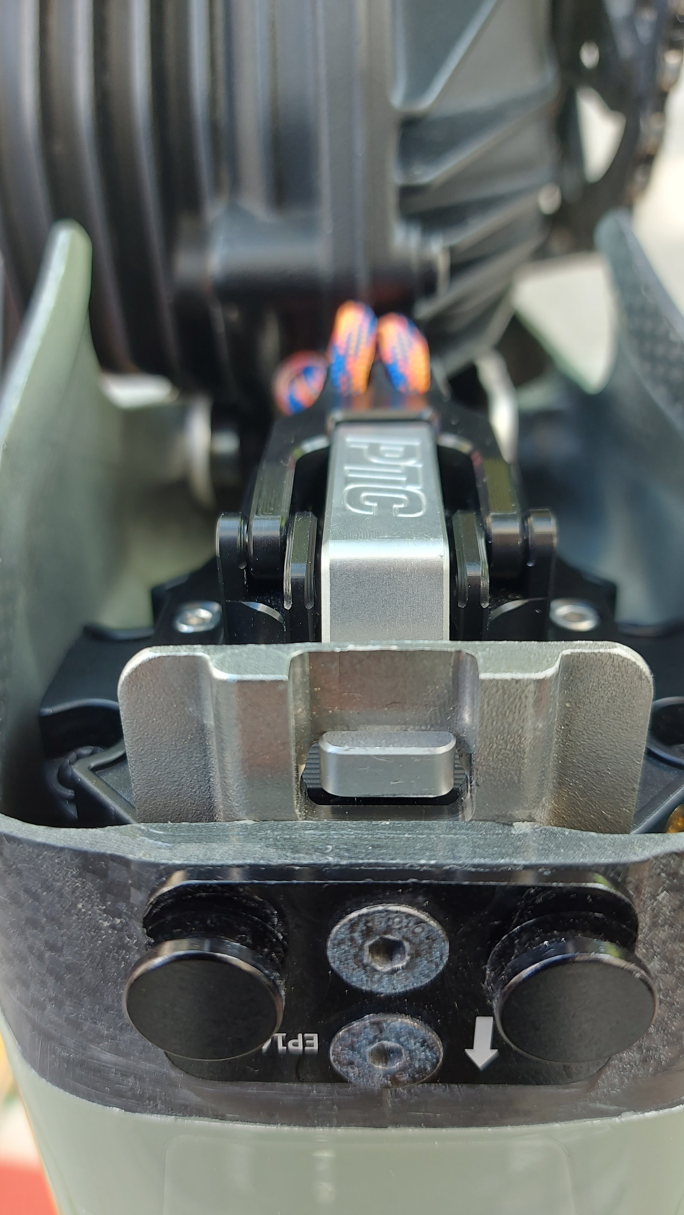

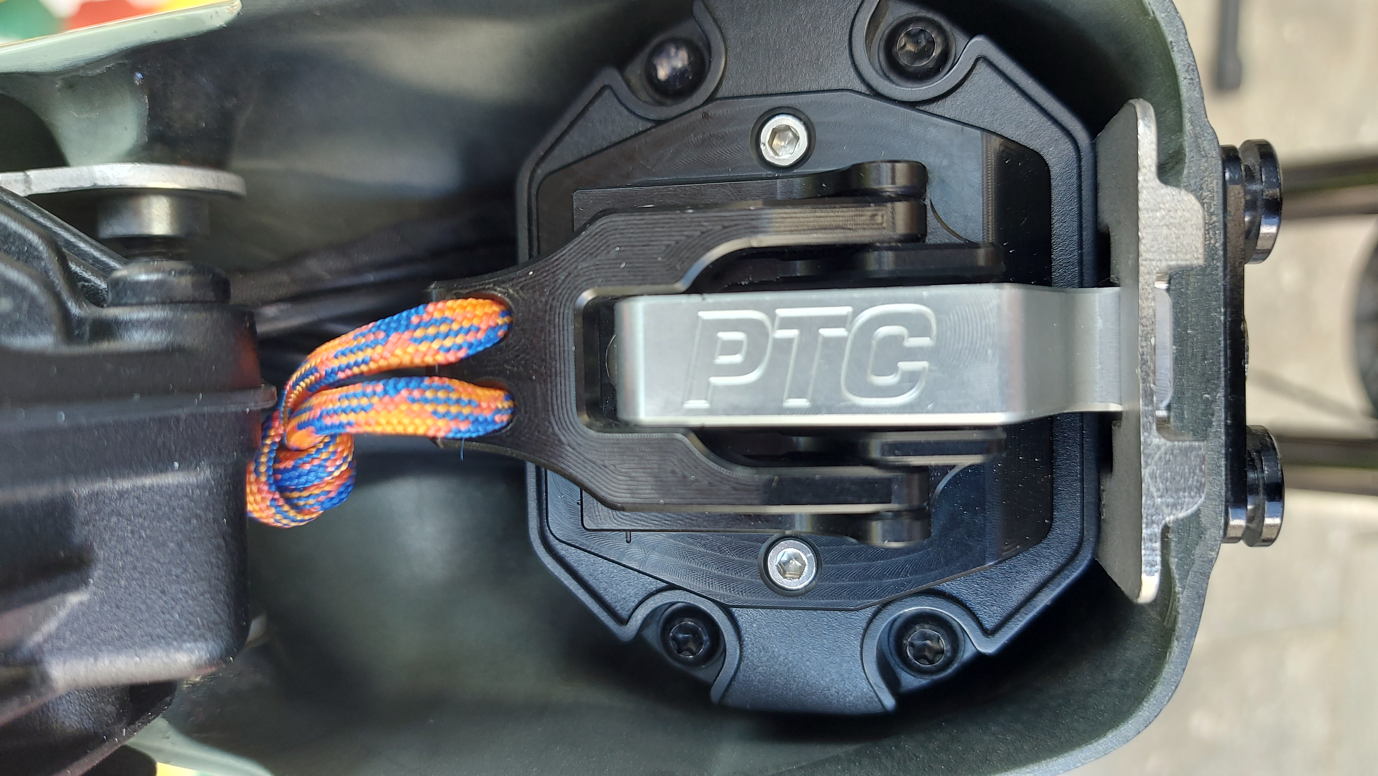

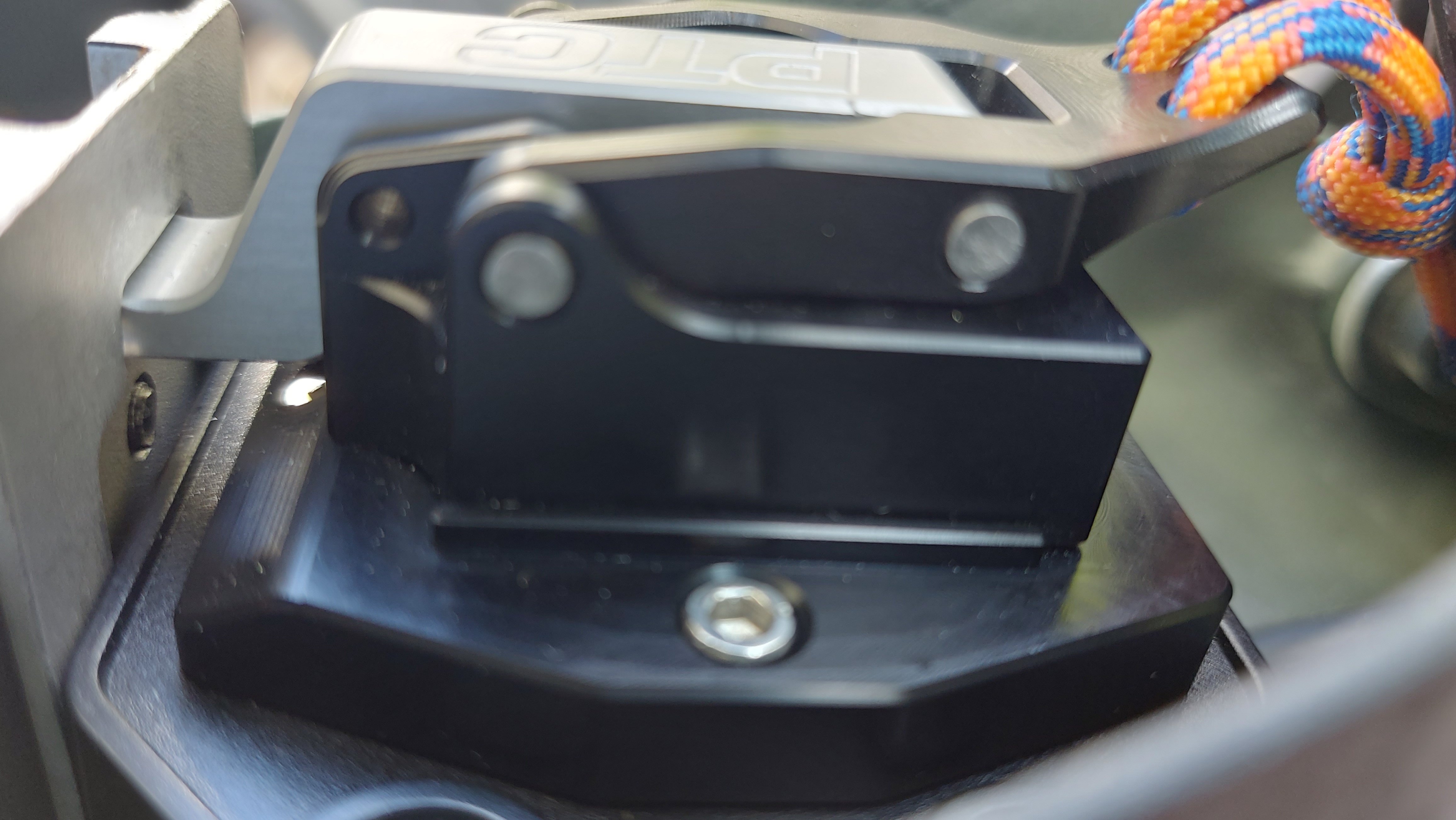

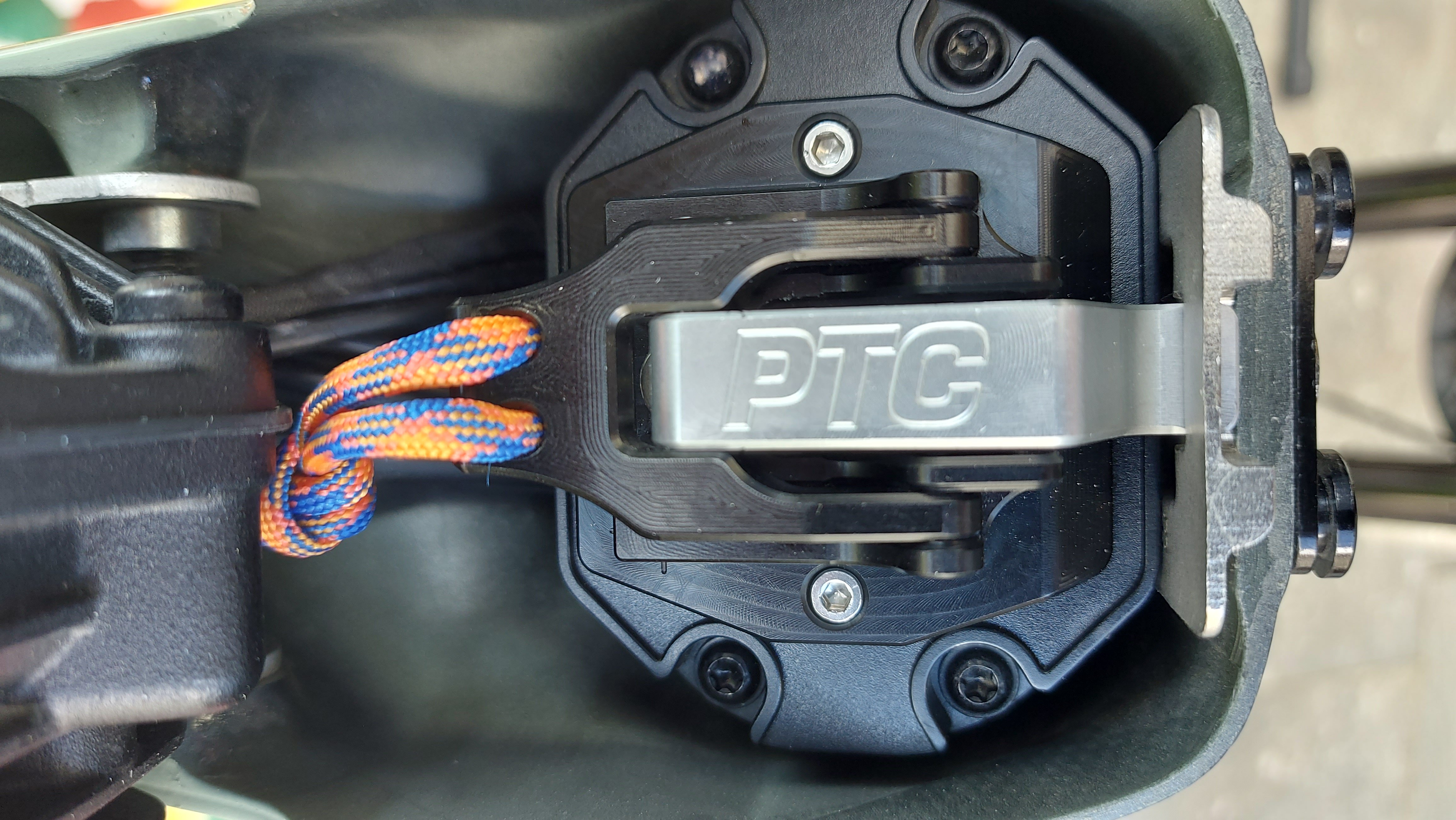

I also had the dreaded battery latch disconnect issue. and I solved it with a small rebuild kit from a buddy on FB.
Works like a charm, super easy and no more issues!

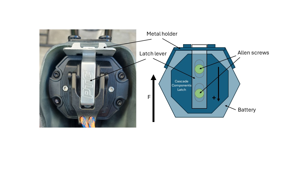

Hi Mike,
First of all: the Strive:On is not available with the older (non-smart) Bosch system. Even if it were, it wouldn't change anything, because Canyon actually only uses the battery rail to guide the cables under the battery. The battery itself is not attached to the "rail" at all, but only to the upper contact pod and the lower latch. I would have also wanted to replace the latch with a bolt/screw connection, but that's not so easy, then you have to design a completely new mount and then you will certainly lose any warranty (whether from Canyon or Bosch, it doesn't matter).

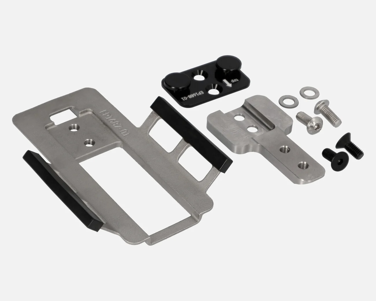

I think (I haven't tried it yet) that Cascade Components' solution looks pretty good to finally get the problem under control (you probably lose the warranty with it too, but Cascade Components have been testing this solution for about half a year, and I've been waiting for that). I guess they wouldn't come up with this solution if the issues would still exist. Otherwise, if @Mario Antony finally tells us his solution (he also tests it extensively), I think his solution will certainly be very promising too.

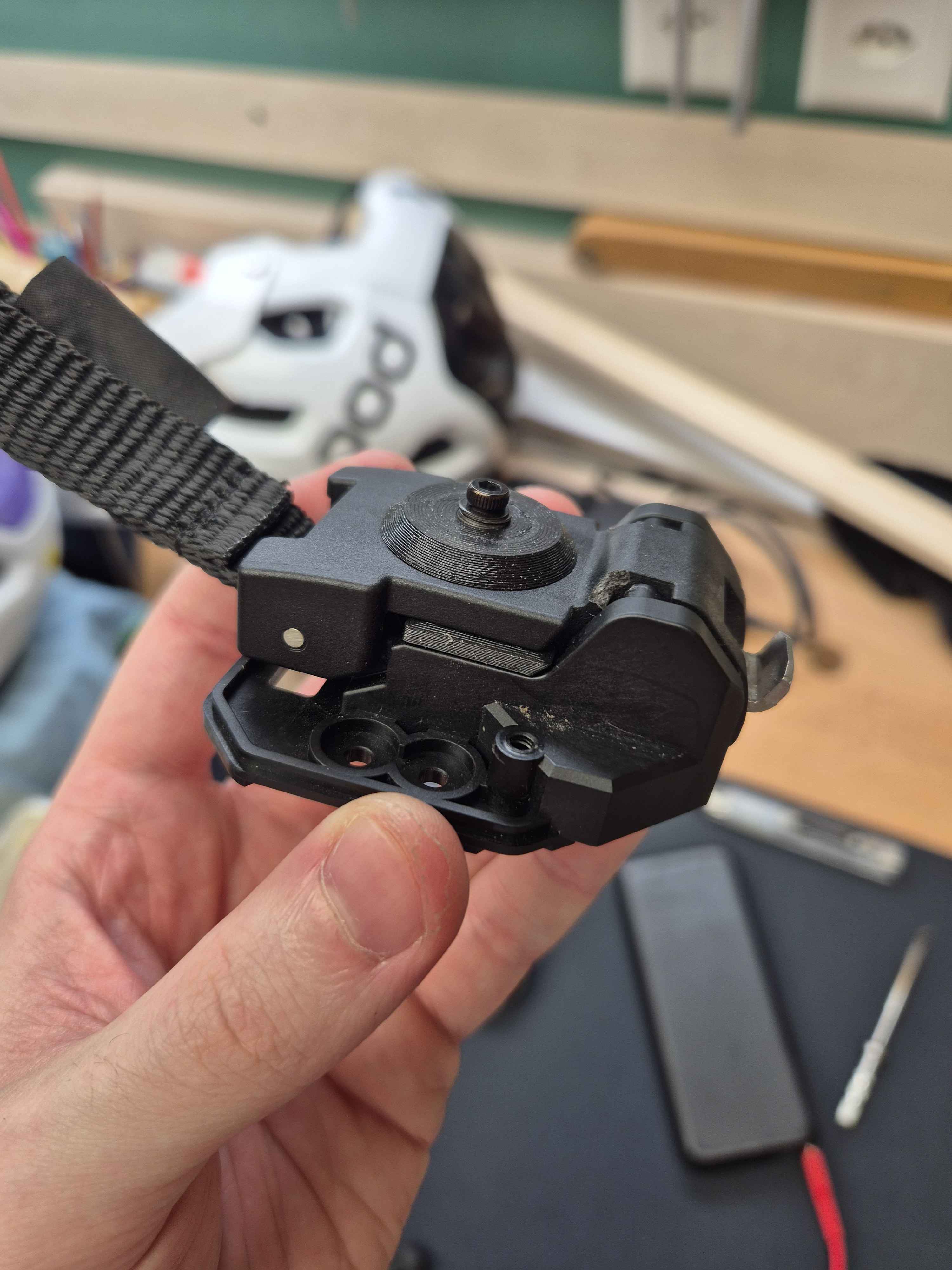

I have now also ordered the Bosch Power Latch from Cascade Link and hope that this part will finally calm my bike down on the downhill.
Bike Canyon Strive ON CFR LTD.
Where or how exactly is the battery causing the noise?
Does anyone here know more and can explain it?
Thanks Marco

Having read about the multitude of battery connection issues I am wondering if anybody has replaced the catch mounting with a bolt in system, I can’t see me having to remove the battery that often and a couple of screws would not be an issue.
A ridgid mount would solve a few issues.
Mike
I wouldnt recommend this bike to anyone. These problems are an inexcusable waste of new owners' resources.
An incredibly lame flaw that doesnt get enough attention is that the maximum chainring size is insufficient except for the weakest/slowest riders, and there is nothing we can do about it.

I finally got it. It got stuck at customs for a bit... well, Swiss customs... Of course with the four screws for the battery (in case anyone is worried about that). Looks good and the quality is OK, as expected. Dilbert also took a look at it and thinks it's great. I'll keep you updated on how it holds up in tough use.
