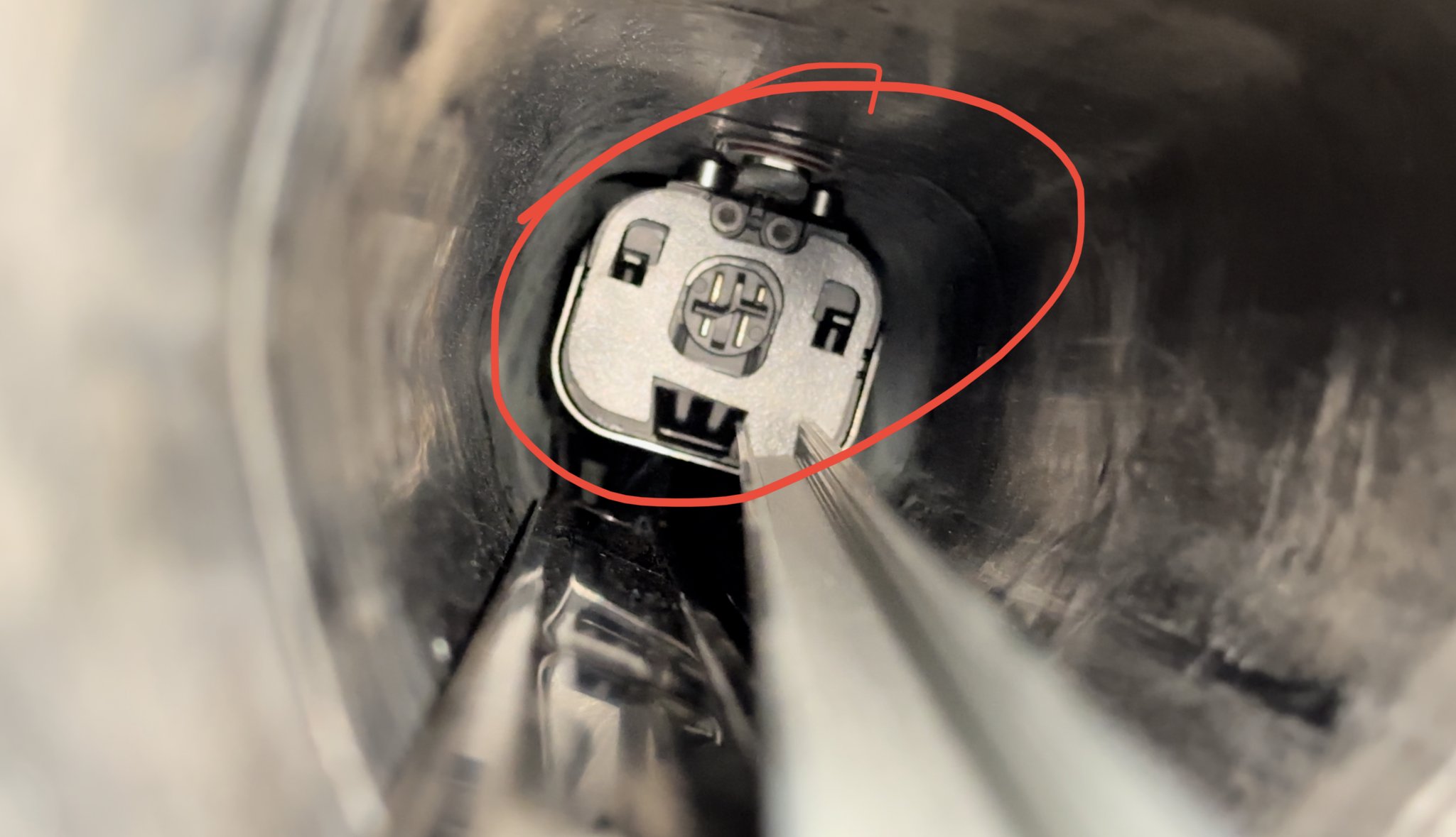

In the meantime I investigated battery connector inside the frame and I see it has some play. Currently that’s my primary suspect for engine cut-offs and rattle.
Does anyone know how that connector looks like, how it’s mounted and if there is any adjustment there.
@Rob Rides EMTB , you built your bike yourself, do you have any photos of that connector by any chance?

As of now, my primary suspect is the battery connector, and I am wondering if there are any adjustment bolts that may be simply loose.

@hubertsk my connector was pre installed in the frame. I’ll try the adjustment screws. Battery seems like was fully secured but possibly a bit of rattle inside.

I'm almost certain that the problem is the loose (or broken?) connector in the frame.
Mine rattles, and I see it has some play.
The problem is that in order to fix it, one would have to take all the cables out, which means dropping the motor first to disconnect all the wiring. I'm not sure how the connector is placed in the downtube, but I suspect there is some kind of long tool to put it in place.

Yup, there is a battery damper (foam sticker) already installed from the factory.
I think it's the piece the damper is attached to (the battery connector housing) that is loose.

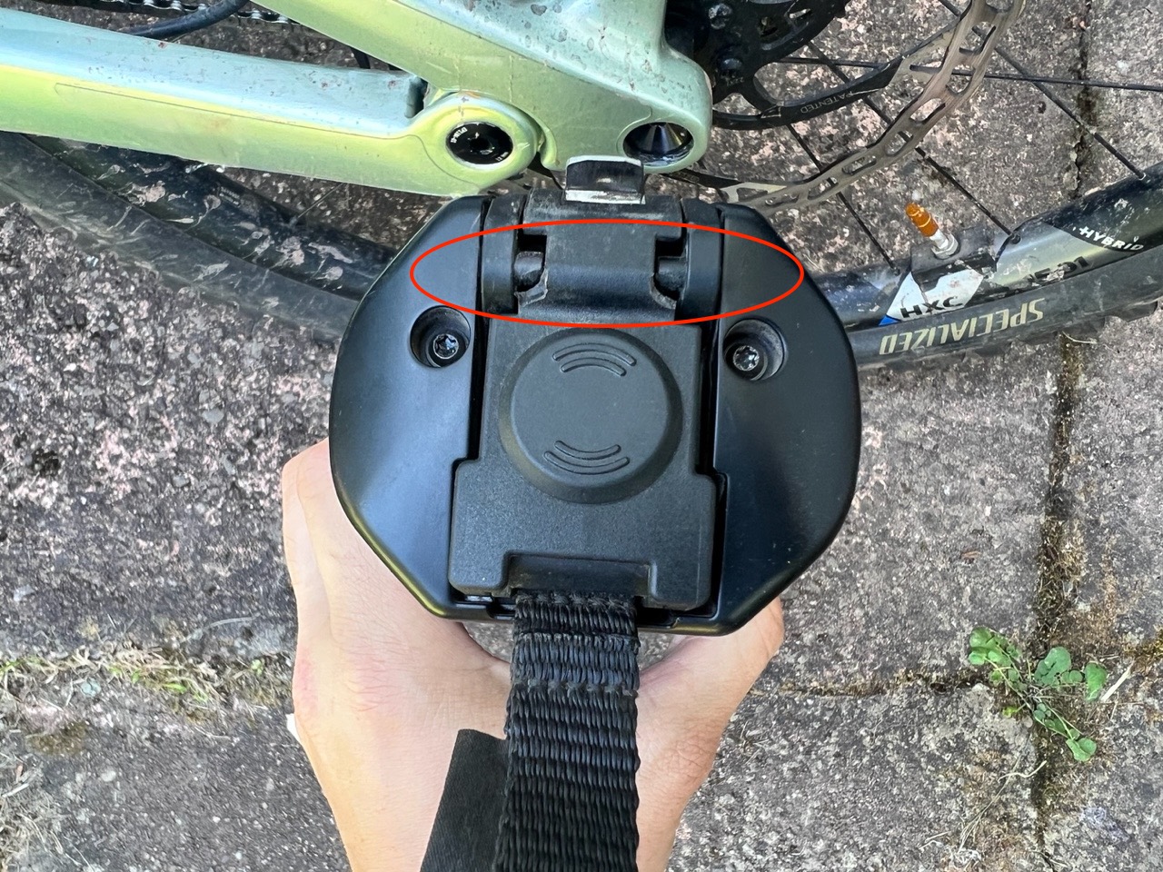

@hubertsk one for you to check if you havent already.
I noticed that my bosch battery latch is cracked, which might lead to excessive play in the battery latch mechanism (especially over chunky terrain, which is where mine cut out).
I will try a replacement.
Hey @Rob Rides EMTB , did the replacement help?
I'm wondering why this battery latch actually cracked, and I'm wondering if that was not due to the fact that it actually holds the whole weight of a battery.
In my case, the upper connector is also loose and rattling.
As of now, my bike is already packed and waiting to be sent to the Canyon Service Center, so let's see what they say.

The bike came back from Canyon Service Center today. I was told that the problem was a cracked battery latch (similar to what happened to @Rob Rides EMTB ). The latch has been replaced.
Canyon states that they only replaced the latch. Honestly, I'm not sure if they did anything more than that, but they forgot to re-attach the bottle cage, which should not be removed if only the battery latch was replaced.
One would normally remove the bottle cage to access the cable guide bolts, but what they actually did remains a mystery.
All in all, the bike seems good now, and there is no rattle or motor shutdowns anymore. I hope it stays like that! :D
