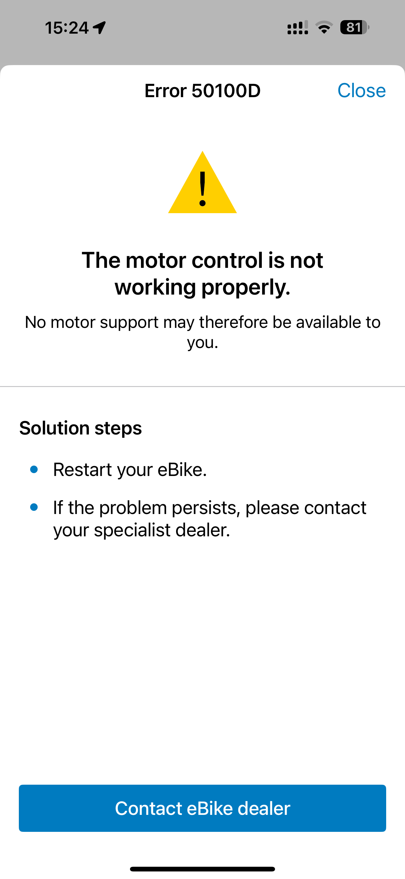

Error 905007 just went away on its own. I think the module battery just needed time to recharge or something. I did contact canyon and they told me to bring it to a Bosch center for diagnosis, and warranty service but turns out I didn't need to.

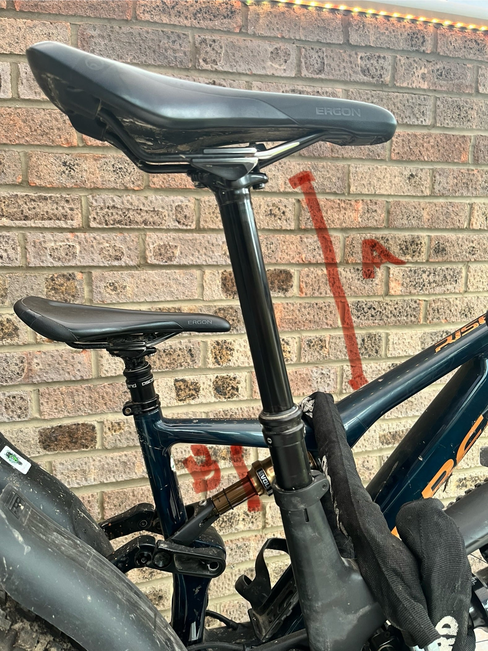

I am looking for a rear mud guard and can't seem to find anything that's bolt on. Are you happy with the one you got?
Do you have a link to where I can buy the same?
S1mmo
Aug 30, 2023
97
74
Yorkshire
I've got this one which looks very similar to the one in the post above.

Thanks! Looks tight though. Does it work well?
It's not tight and it works really well at keeping crap away from the bearings at the back of the bike.
It doesn't stop me getting a wet arse and back, I think a longer Mudhugger style guard is needed for that but they don't look too good and can hit the floor if you're moving your bike around on the back wheel.
sorry just saw this. Its a mucky nutz short guard. You have to make a small hole on the top to tie it to the seatstay brace, and trim away a small section so the chain doesn't rub, but the plastic is soft so its pretty easy. Fit is perfect and I like the way it looks.

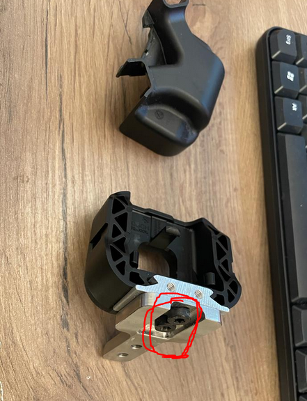

Fully agree to all of this. But there is one "small" issue with it: the battery latch problem always prevents me from using the full potential of this extremely good bike (it is meanwhile a kind of latch protection built into my brain...).
Solution is on the way!
In the meantime, check your upper bracket, and assemble everything with threadlock

I would (really, really and honestly) love to believe that, but unfortunately there are others who have had the problem after a while despite having a new latch. In principle, this is to be expected, because the two small additional "struts" cannot seriously be a solution to the problem. The static 4.3 kg of the Powertube 750 plus the corresponding additional dynamic forces when riding in tough terrain require a "slightly" different solution (something an engineer learns in the first semester..., sorry). As I already said before: Canyon should have accepted a few grams more and installed a Bosch Rail so that the static and dynamic forces are not absorbed by a ridiculous latch on one side and the battery connector on the other side. Just to avoid misunderstandings: the bike is great, but whoever came up with this battery holder solution should first be slapped on the backside by everyone who bought this bike and then be fired by Canyon. That wouldn't help anyone who owns the bike, but hopefully it wouldn't happen again.
Mario Antony
May 5, 2023
232
183
Portugal
Unfortenatly (Very Unfortenatly, btw...), I had several battery problems after the first 1.000 kms.
When I first saw the msg stating the problem, I thought it would be just some, and mostly those that remove/install the battery regularly.
Never thought it won't happen, but since I rode over 1.000km problem free.... There was a bit of hope, that the Strive :ON, I received was ok on this battery/disconnection issues (it had other issues, that were solved).
Thing is, I don't recall seeing someone wirh problems from kilometer 0.
battery/disconnectiin problems start after XXX kms, meaning is something that agravates with riding time.
On mine, after several issues, and having placed the bike in 3 bike shops, I quit repeating the process, and check personally what was happening.
What I observed, is that the upper bracket, is not properly assembled - meaning using threadlock on all bolts.
I sugest to anyone with this problem, to go ahead and verify this upper support.
It's a bit of a PITA, but is worth the trouble and assemble the bike properly!
The latch, is just a part of a problem (bad battery securing design), but anyone with disconnection/battery problem, should really check both parts:
-Latch
-Upper Battery Bracket (inside downtube)
Hope this helps everyone.

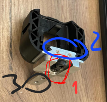

I'm also thinking of such a solution for my Strive:On. The only thing that's stopping me so far is that I have to drill into the frame for this. But if the suffering becomes a little greater...

As I said: If you do the math with a bit of engineering knowledge, you'll see that neither the old nor the new latch can hold the battery when it comes down to the real business. Take a look at the solution for the Torque:On (assembly video from Canyon), the battery is screwed in there and that also holds the even heavier 900Wh battery!!
