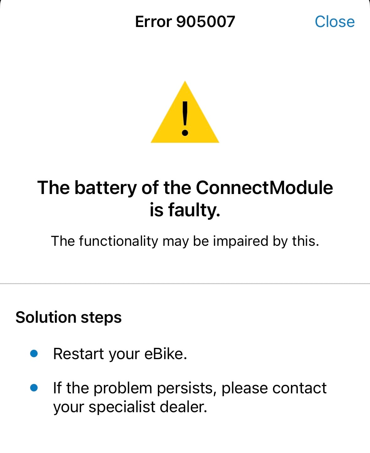

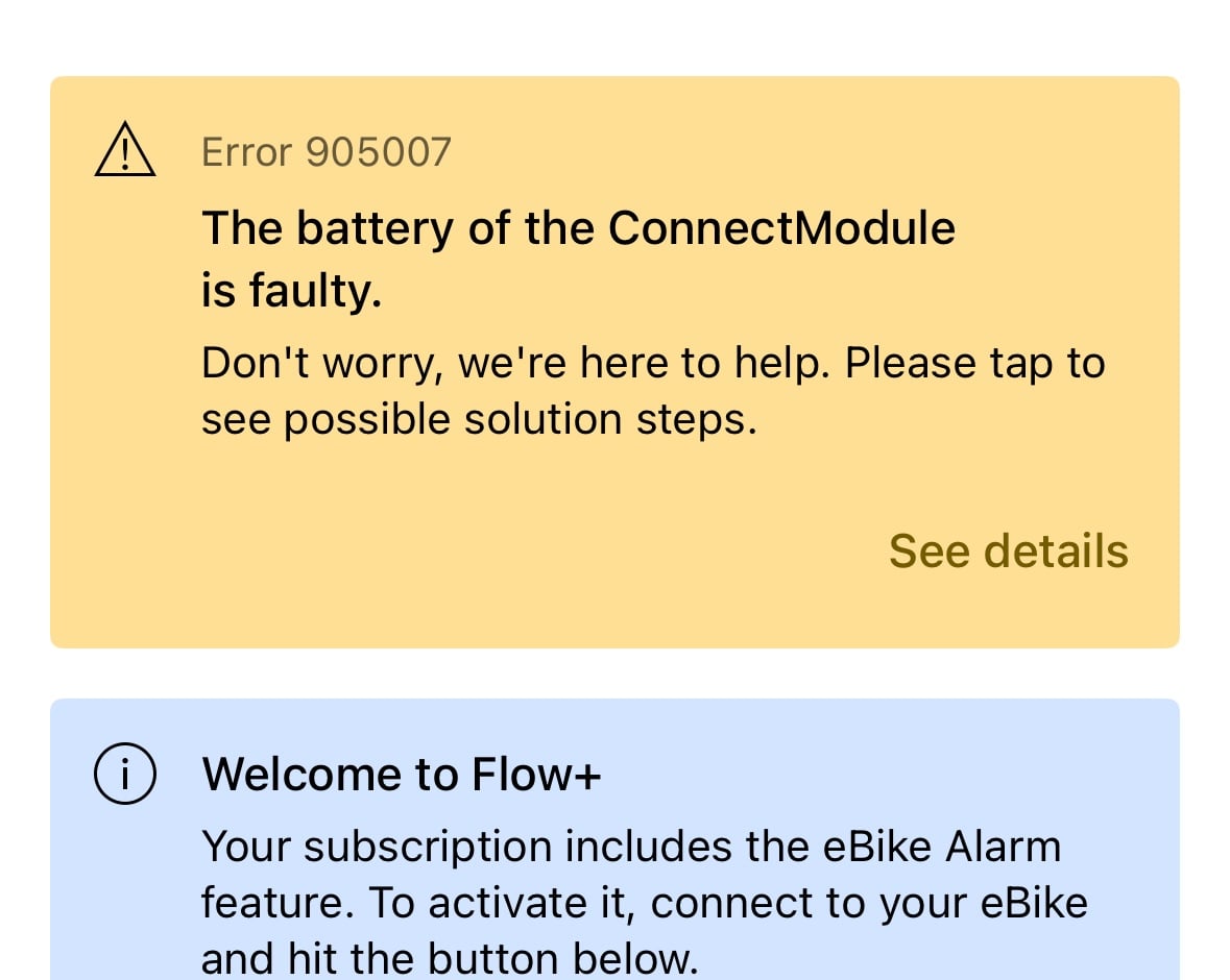

Here we go again..........
Bike not working... and just before holidays!
Hope Canyon can resolve this in 2 weeks time
Back to Moto, at least it doesn't throw any errors!
