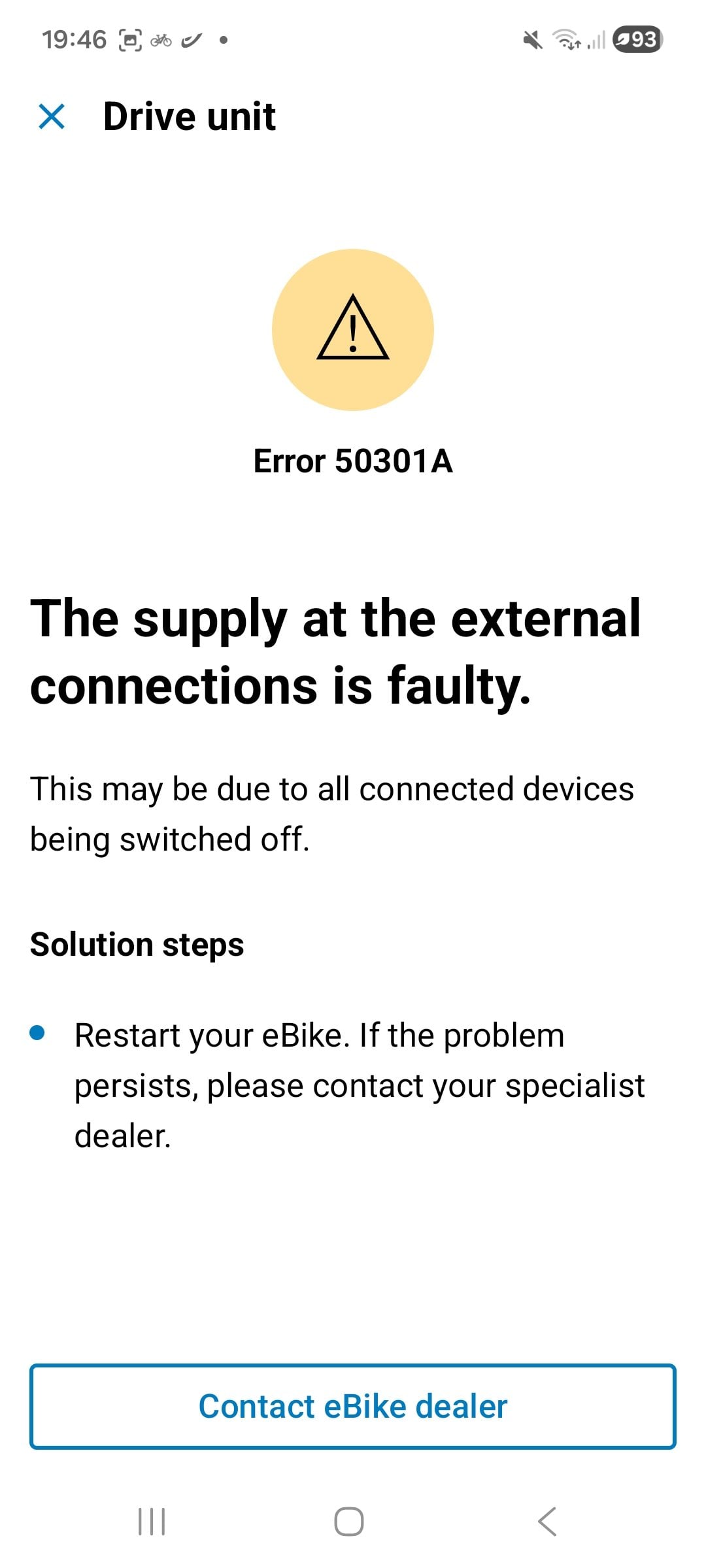

Then it was my turn to get problems, the bike has only run 290 km. it started with me feeling like I was getting less assistance in all modes.
today when I was out cycling it started with cut outs and the display started to glow orange. I can fix it myself but feel I'd rather send the bike back and have canyon fix their junk bikes.

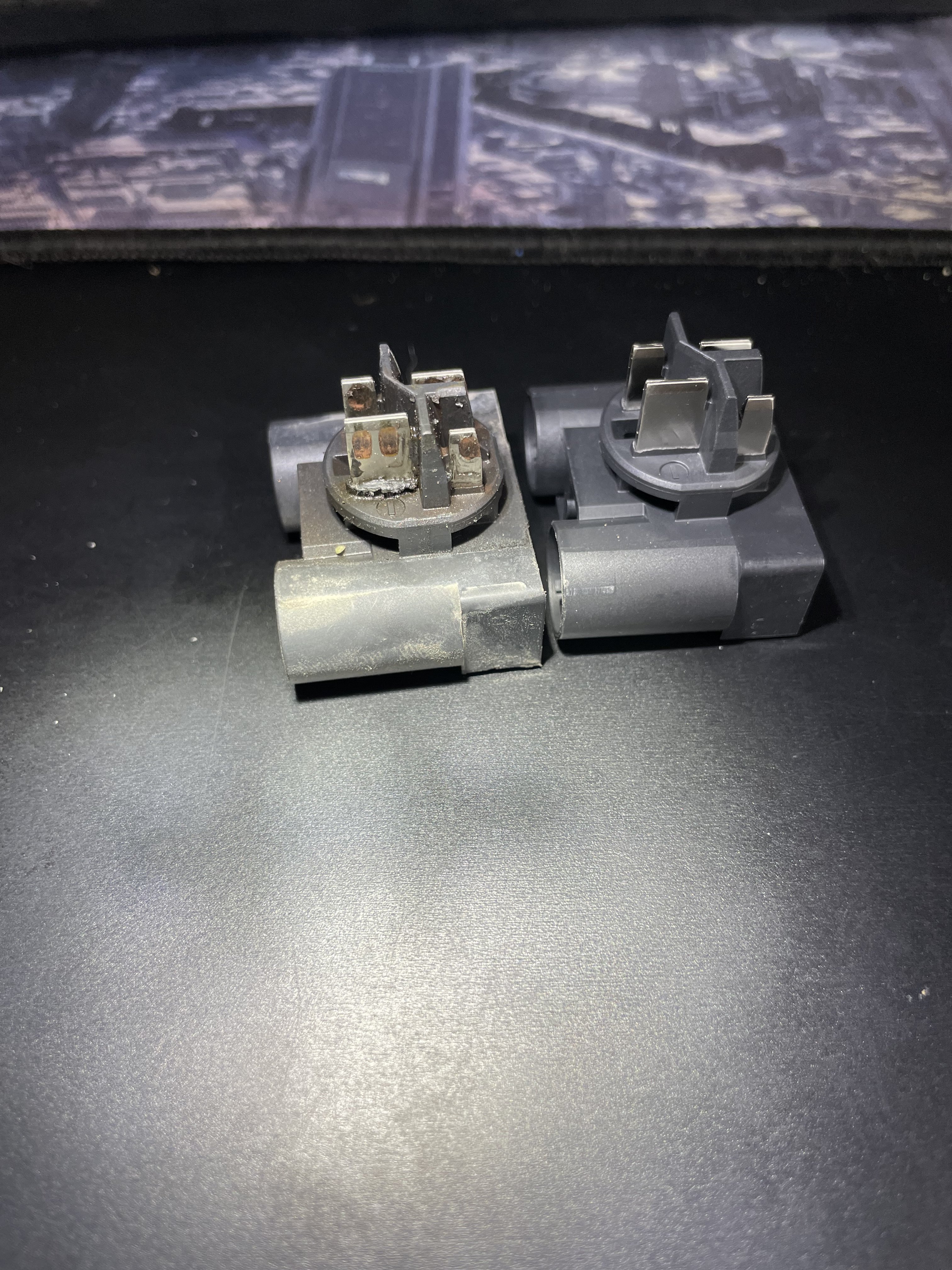

hey folks,
reading this thread a while already and had the inital problems with power cuts but fixed them with your help, THANKS A MIL!
Now having some trouble with power cuts again when getting harder hits during uphills or flat sections on trails...
I already did all the reworks on the bike, fixed the connector, fixed the latches, added cable straps but sometimes have still the power cuts as written above... this also happened during ebikes races in uphill power stages and this is just suckzzzz :) :)
I have to say I´m riding this bike really hard... full enduro no matter what, 2-3 times a week with 2x 750w batteries most of the times2000-3000meters of downhill every ride... I am around 4,500km on it and the bike itself is awesome, just this power cuts are killing me...
When checked the connector while I´ve added screw lock, I noticed small movement in the connector itself, I would say, this is as per design but not 100% sure... anyone see movement in the connector itself

So you performed the locktite mod on the upper bracket, and still having power cuts?
You did this?
thanks for your answer! :)
yeah i did this but the connector itself have same play by himself, at least I´ve noticed this... now I´m unsure if this is coming from riding a lot and hard + switching batteries
For sure is the connector or the cables that are damaged.
Either way, you need to remove the upper bracket, and check the connectors (bracket-battery + cable-bracket).
Remove any dust or dirt.
2nd
and because you have 2 batteries, check the latch on each, with them installed. Check if the batteries move, and confirm which type of latch you got there.
Hope with this, you can solve the issue!
Ps: do you get the orange light on the controller anytime?does it turn off and stays off, ot turns on after you pushing the on/off button?
2nd
regarding the batteries, I have already the 3rd pair of latches on them because even if you get the version 2, at a certain point they have play, I also have a 3d printed part in this latches that are reinforces the construction... also I´m using cable straps at the bottom latch holder to have a tighter fit of the batteries in general.
The other thing could be that maybe the batteries connector itself is worn out... I would say, its not a warranty thing but I´ll check on this too...
thanks again, will do some more research here but maybe someone who reworked the upper connector with locktide can remember if the connector had someplay in the construction itself
regarding the light, yeah... its getting orange and switches off... i can switch it back on without issues
