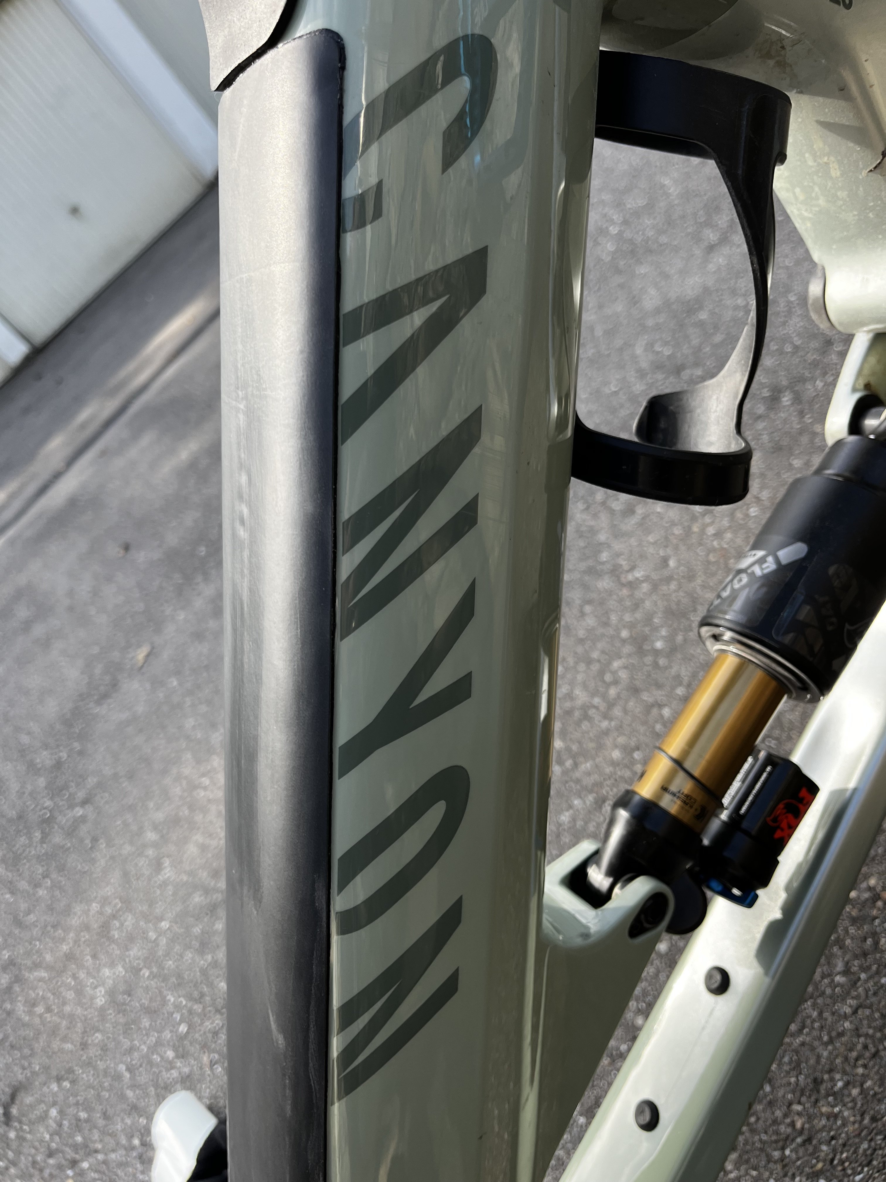

Boa Tarde :)
Would you happen to have a link to the torque specs for all the bolts? I don't seem to find one despite searching... Obrigado
jxrx
Dec 12, 2022
100
37
Zürich

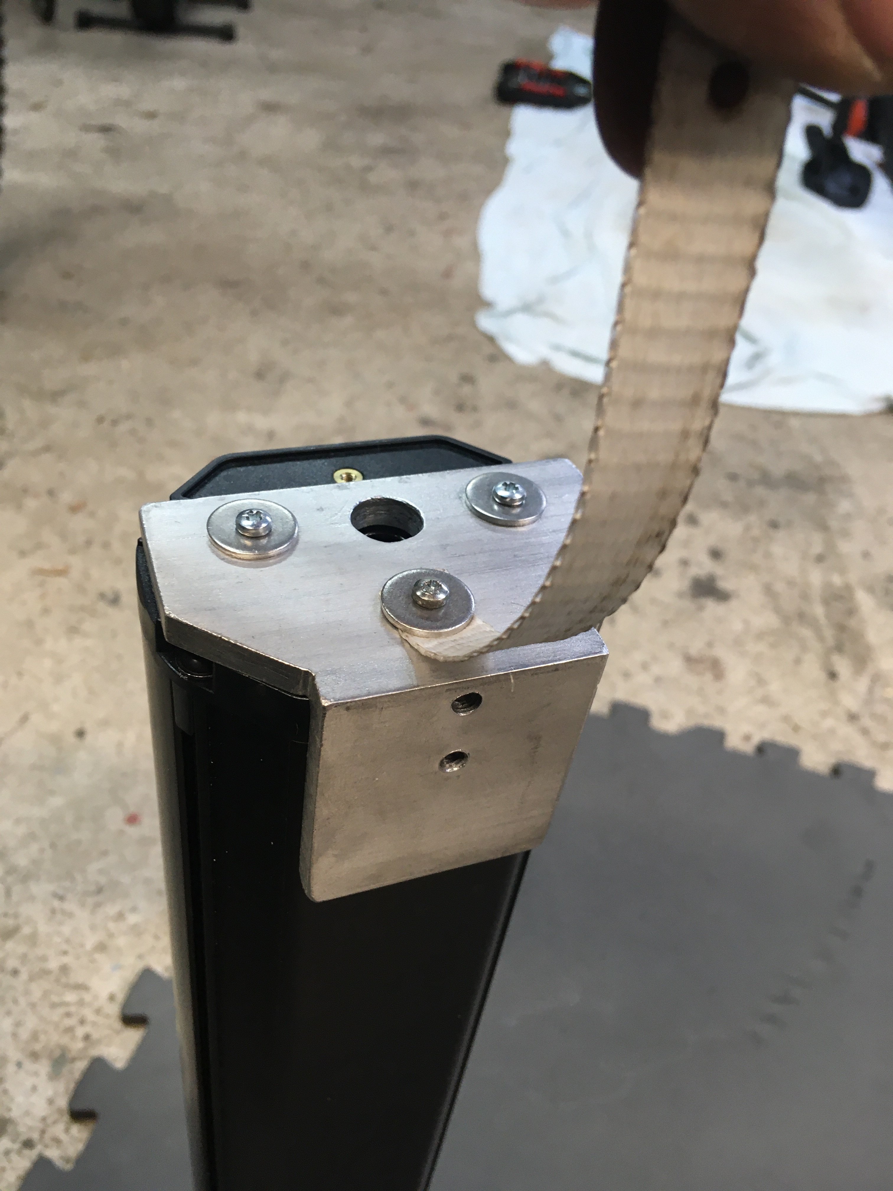

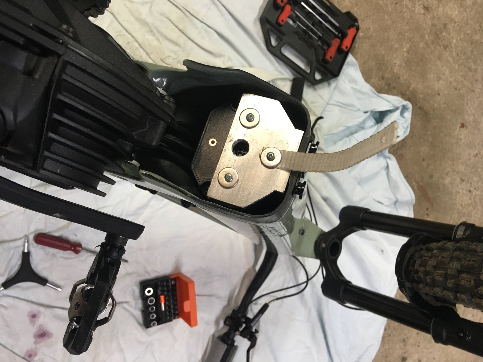

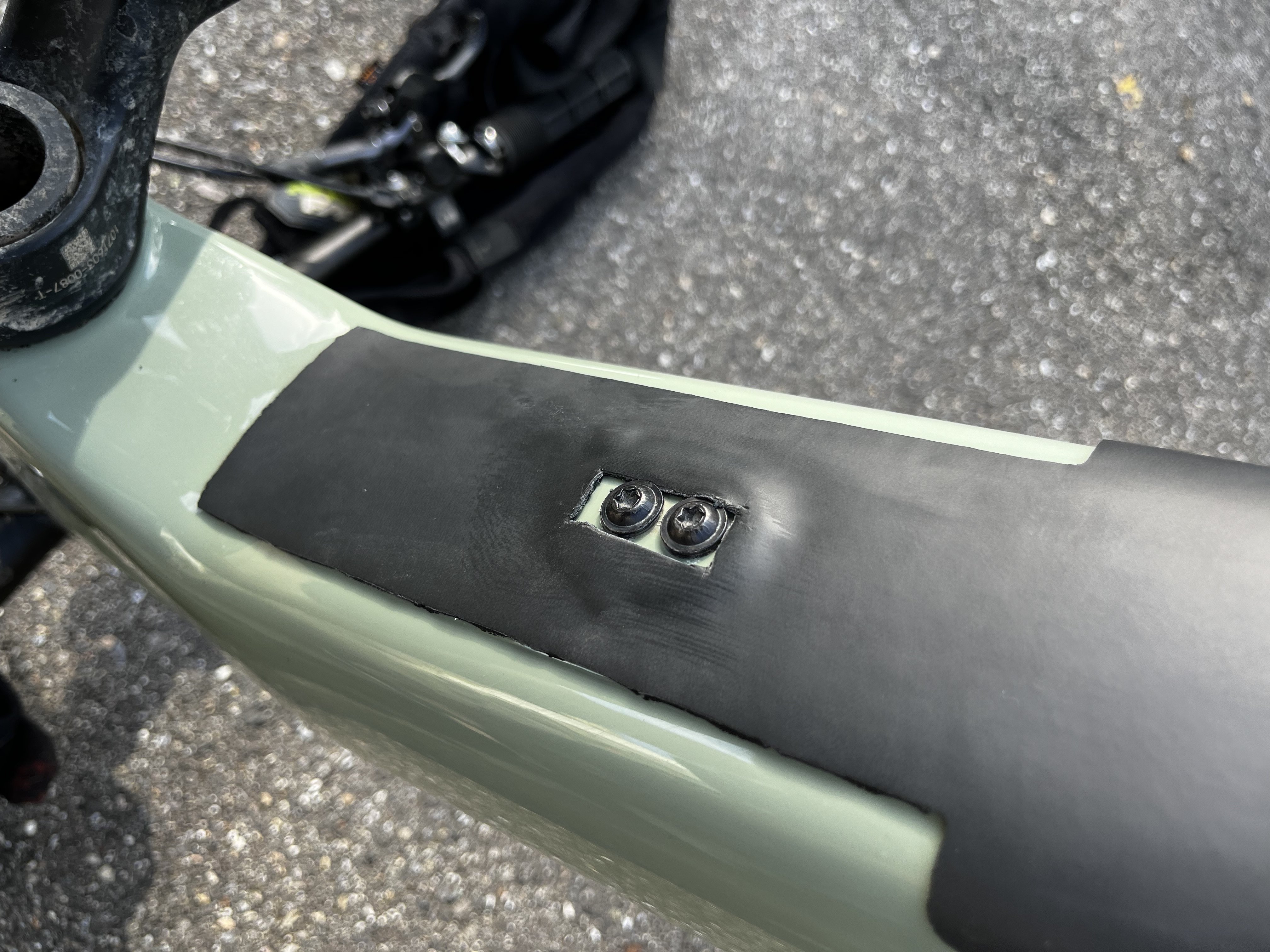

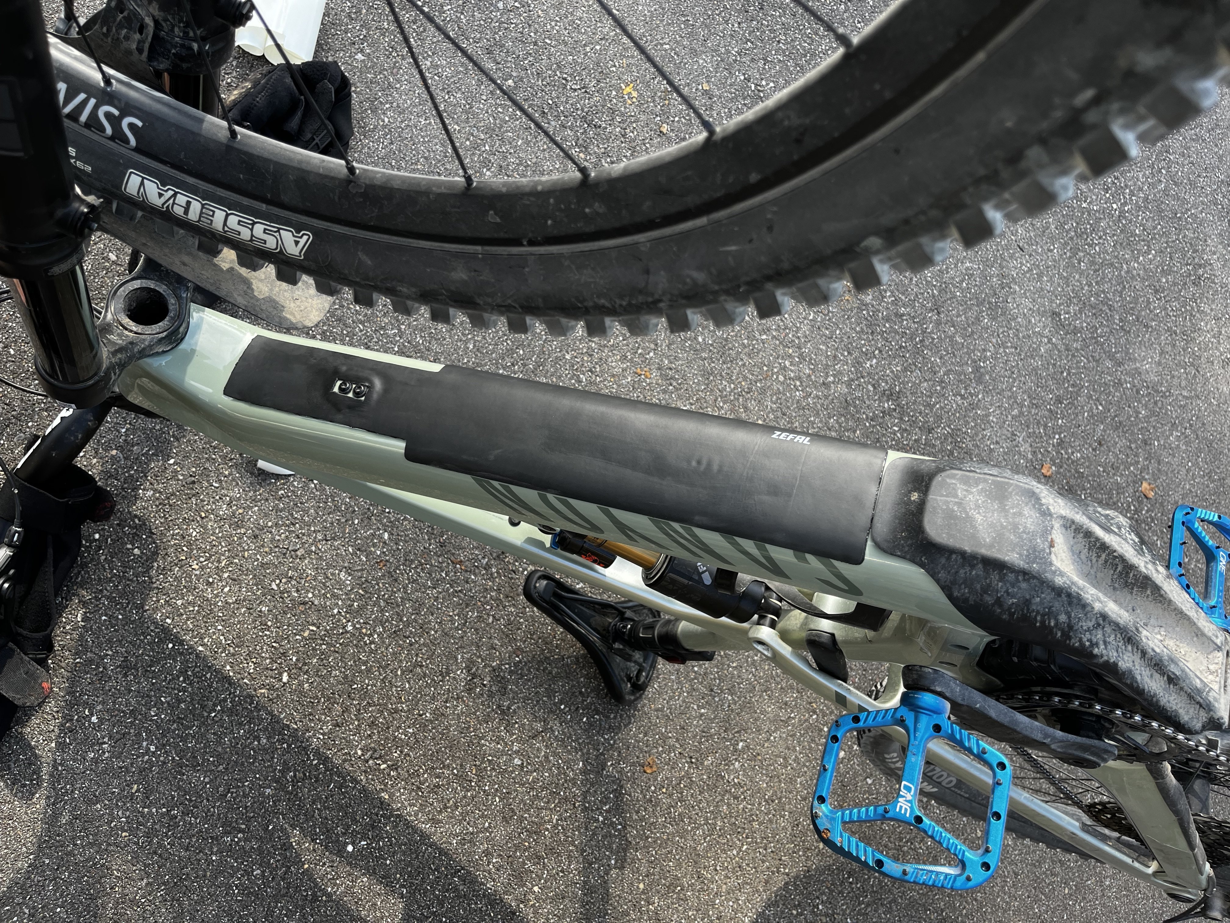

The upper Battery bracket is supported in total by 6 bolts (if I'm not wrong... didn't take any pictures!)
So there is 2 holding the backet to the frame, acessible by the outside.
And then there are 2 more:
2 in front (if you look inside the downtube)
2 underneath (if I recall correctly) --> these were the ones I found unbolted, and connect the bracket itself to the stainless steel adaptart that than it's connected to the bike throught the bolts you see outside on the downtube.
I found this picture hope it helps.
The highlighted bolts were found ½ and ¼ unbolted.
After all being assembled with lockthread (btw - only the outside bolts have from factory!), and assembled with a simple solution I've made and still testing, everything is working better than new!
No noise from the battery, no disconnections, nothing! Well... at least ±200km after I've made this.
do you know if anyone has made a video of this process at all? I'm struggling to get my head around it although more than happy to get into it and give it a go I'm concerned about 6 cables and those metal sliders etc. can't get my head around how I'm going to get that all back in the right place!
Mario Antony
May 5, 2023
231
183
Portugal
It's not that hard.
#1-Remove battery
#2-Disassemble lower bracket
#3-Duct tape/zip tie the cables (should be 2 groups)
#4-remove the metal strips that protect the cables
#5-Remove outer bolts that secure upper bracket
#6-remove upper bracket
Disassemble upper bracket/Clean/threadlock ALL bolts on the upper bracket
Reverse everything, and you're done!
Take your time, and remeber, it's just an ebike! It won't fall from the sky 😉
After this, you should be trouble free from all the cut-outs.
