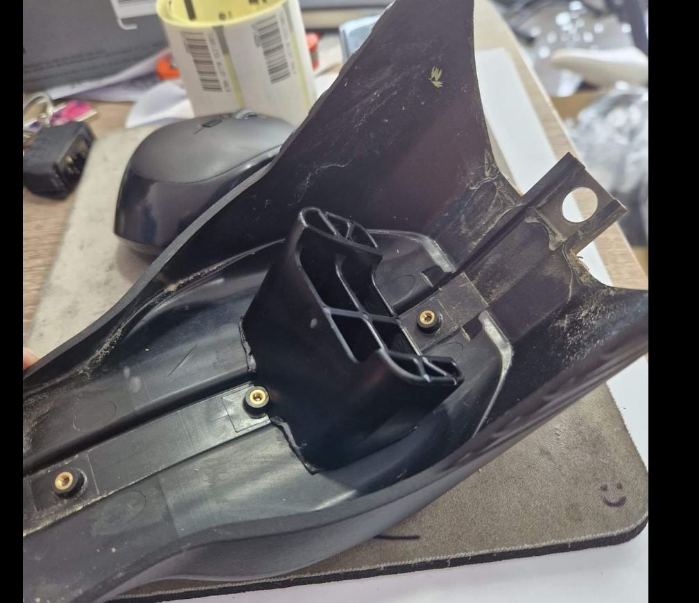

@Mikerb Can you show a pic of your bash guard? I beleive Whyte also had this issue but resolved it with a block of plastic on the bash guard which helps support the battery when the bash guard is installed.

Hi Rob,
I have had the E160RSX for over a year and no problems with the Bosch battery latch or cutting off issues. All I know is that I saw a post on the Facebook "Whyte Ebike Riders" group page referring to........from what I gather........the MX model in the range and a mod that Whyte have made available to resolve the issue. Not sure what could be different with the MX model compared to the full 29er though!! The pic below is a screenshot from that post showing the block of plastic fixed into the bash guard.
Just another thought on why this may be occuring........given the weight of the battery care needs to be taken when inserting it into the downtube to avoid it hitting the battery connector with force. That is more likely to occur if the battery removal/replacement is done with the bike upside down on its bars/saddle. Just letting it drop is likely to bend the battery connector mounts progressively, enough to allow some vertical slack when secured. In the case of the Canyon I think that vertical slack may also occur over time due to wear of the aluminium "slot" which the Bosch clamp locks into..........it should be steel not ally ( the Bosch battery rail is steel).
Thanks. This is helpful. Whyte have had a similar issue with these clips breaking (from an internal industry source) , and it must be only related to the MX model if they've made that bash plate mod to fix it.
That plastic part looks like it is glued on (as a fix after production) and that adds pressure to the battery to reduce the downwards force of the battery hitting the clips.

I have to give credit to the canyon mechanic who's working with my bike, after several back and forth with Bosch tech, the guys at Bosch could not understand that the bike was in a different place than my phone (where my bike is set up) since the bike is in the service centre and not with me, so they never understood that the bike could not be unlocked, therefore the mechanic couldn't test it to se if the issue it's solved, the mechanic, fed up of trying to get them to understand the situation, had to use his own personal phone to set my bike, I gave him my credentials to access the flow app (no worries, I'll change the password afterwards) so the bike is unlocked and ready to be worked on, but still pisses me off the amount of bureaucracy required to fix a bike, it's insane

Hi Rob,
This is a interesting resolution/fix. I can imagine that this will be the way that Canyon 'fix' the Problem on some of the Strive's. When my Strive:ON arrives I have a spare bash guard (as well as a couple of other bits too). I think I'll be designing and 3D printing this 'fix'. If successful I'll make the file available
Do you think the bash guard is sturdy enough to give the battery the support needed? Doesn´t the bash guard just slide on up front?
I'll have to wait and see when I have my bike and the guard (It's scheduled for delivery Thursday next week). I'll keep the thread updated.
It seems to be such a shame that this one issue is the Achilles heel of this bike.
Agreed.
Another issue I thought of with supporting the battery from the bash guard / skid plate is the energy from hard hits to the skid plate being transferred the the battery and the connector.
