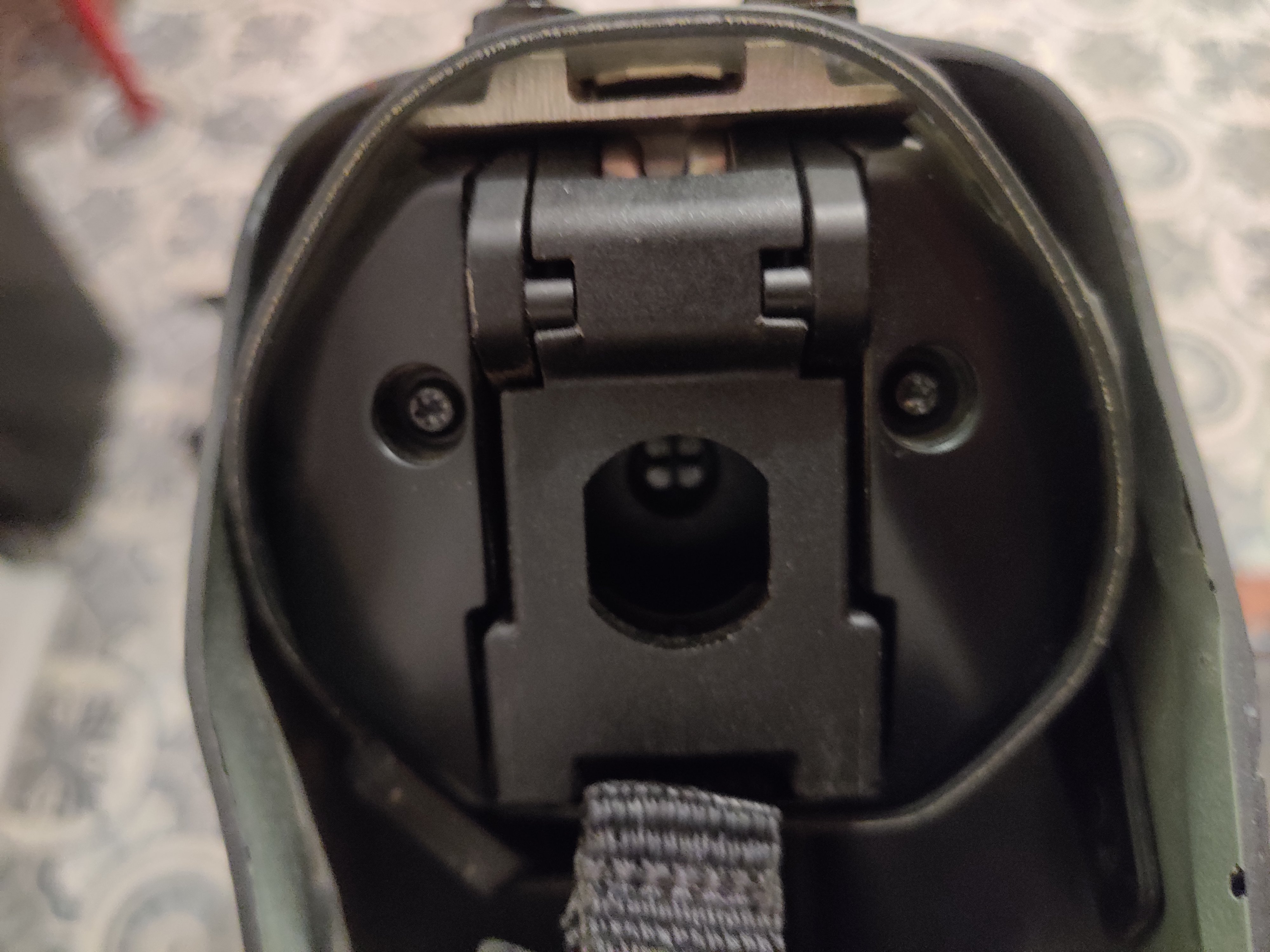

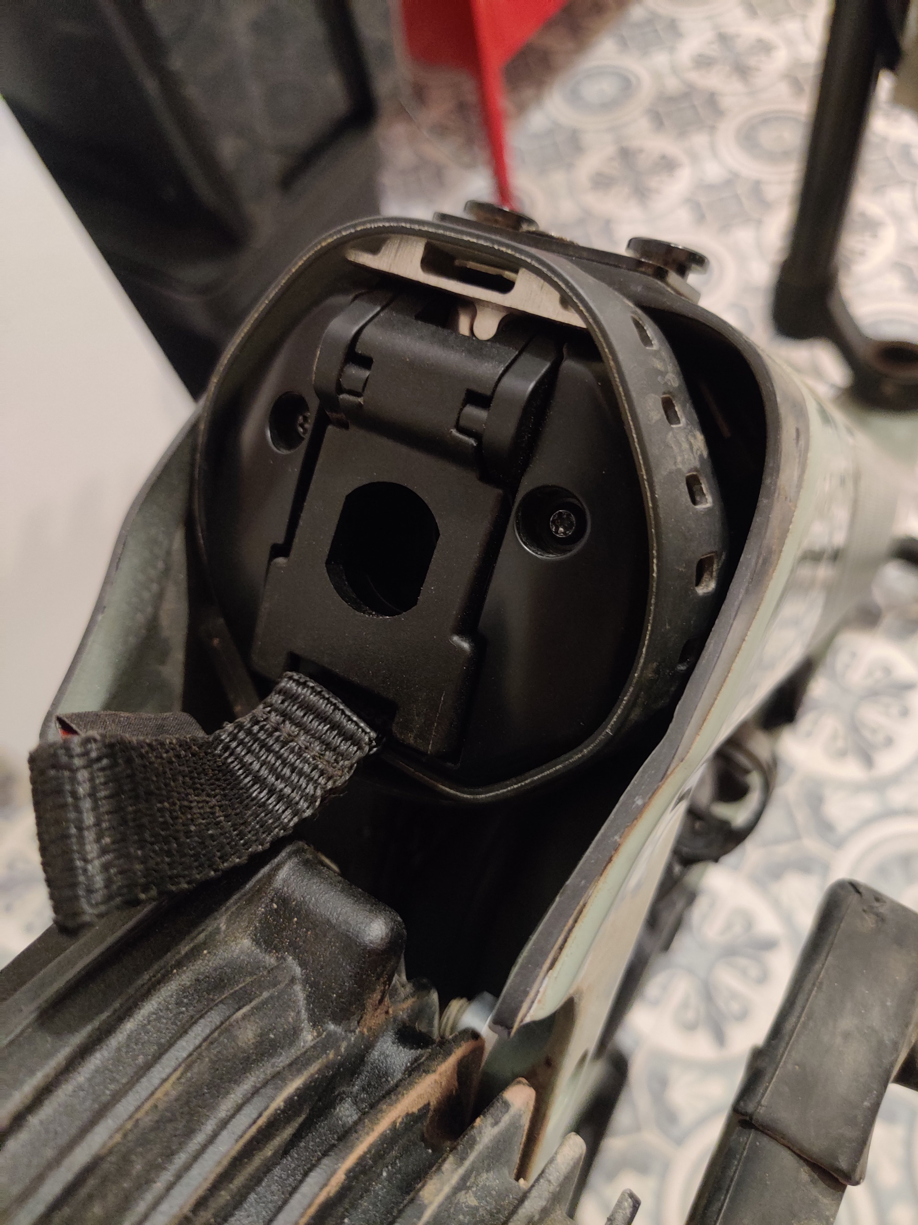

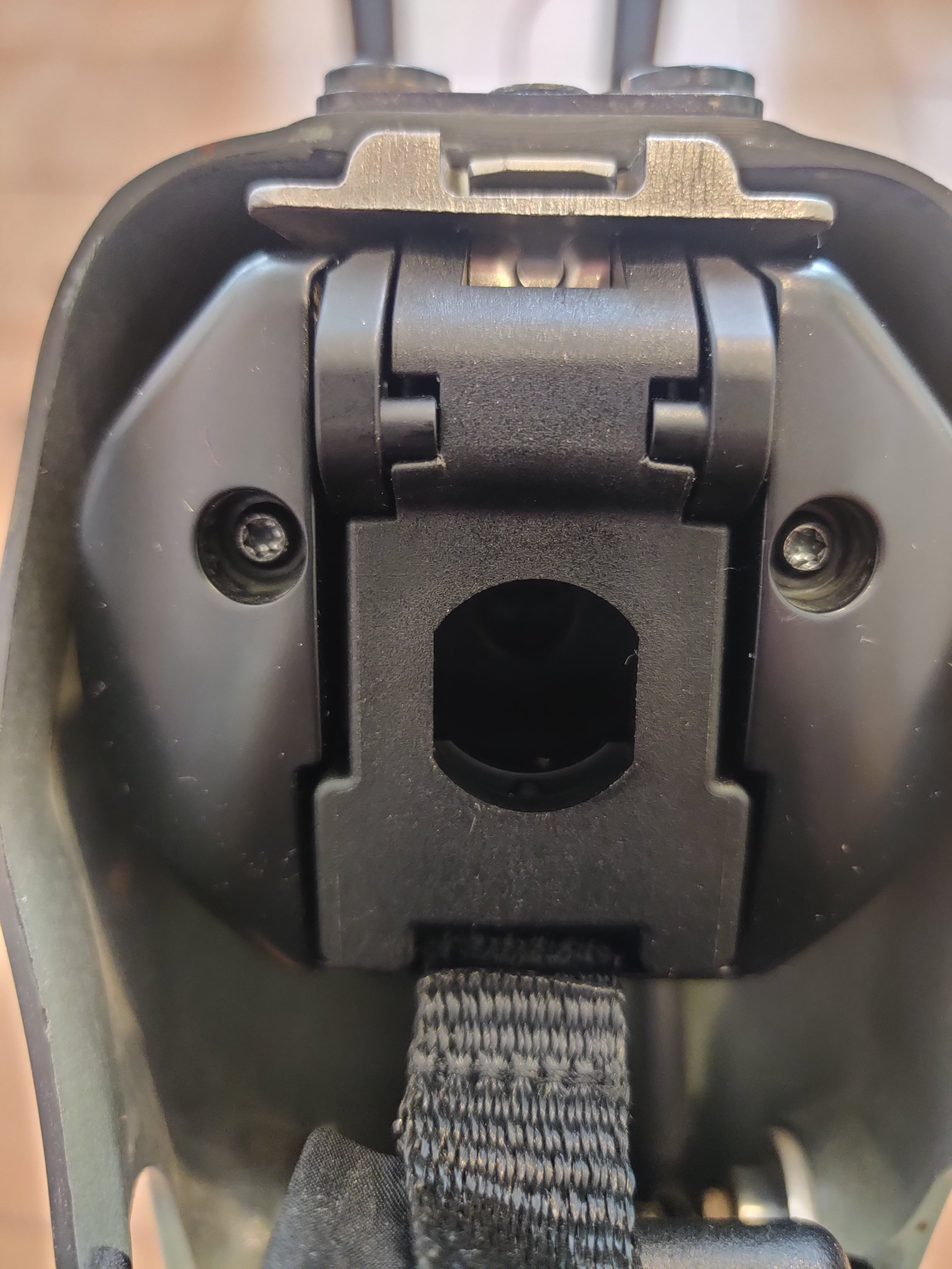

I finally got the bike yesterday, once unpacked I checked the battery latch and already is damaged...I went on a ride today and it seems more noisy than normal, like a lot of rattle from the downtube, just like when I started with the problems last time, however no shutting down problems, when I got home after the ride, I had a look around and I don't see much that can be done, at least as a DIY level, unless some of you it's a DIY god with insane resources 😂, I did notice a bit of play between the battery and the bracket where the lock engages that could be solved with a big 'ol tierap, I had one lying around but it's busted and doesn't lock when in tension, I'll get some new ones to try and will report back, I've attached a picture, also I've attached another picture, so you can tell me guys if it's normal or its something that shouldn't be there, I don't remember seeing it, but I've tried to move it to see if it was loose, but it was tight, thanks in advance

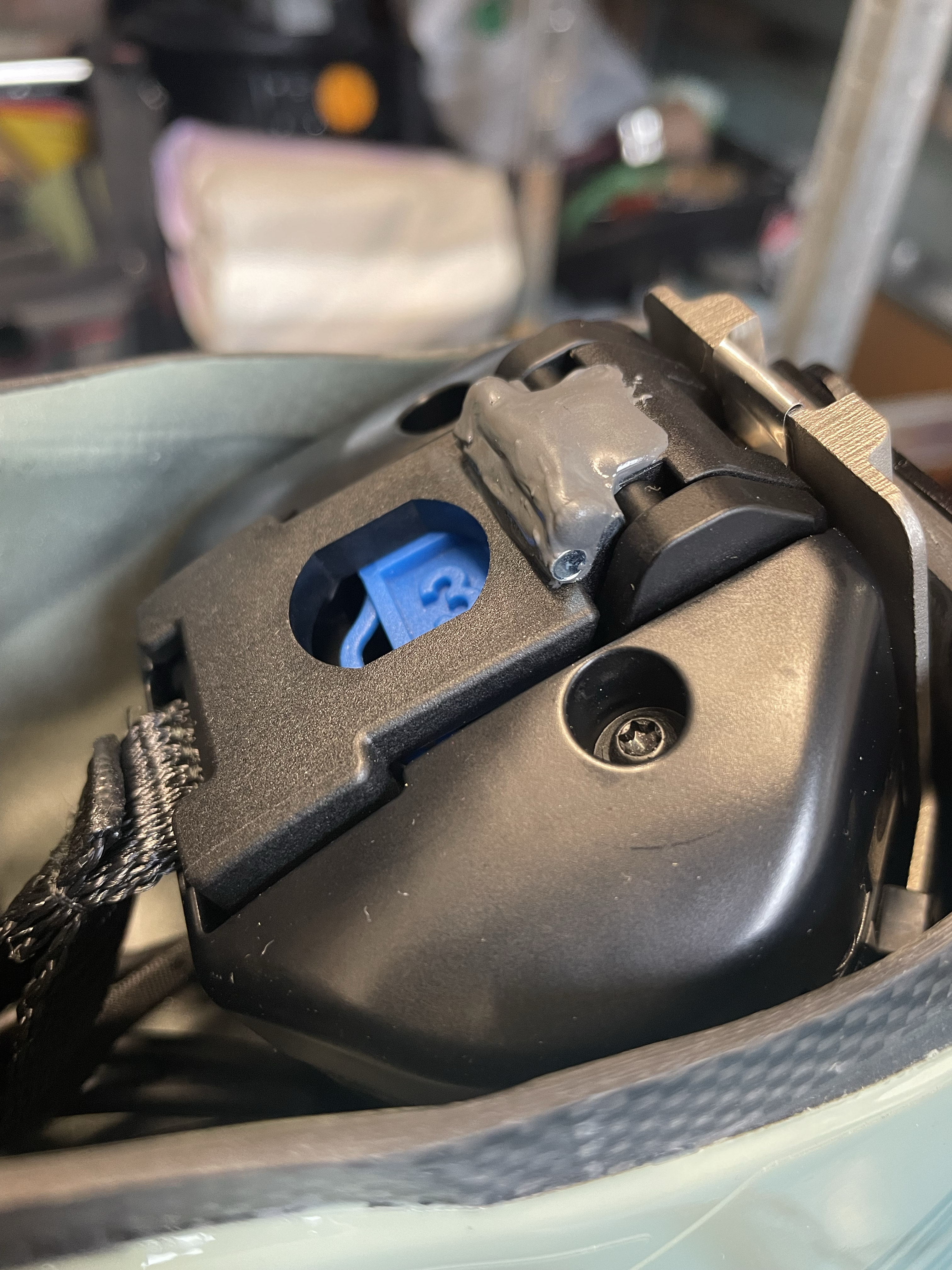

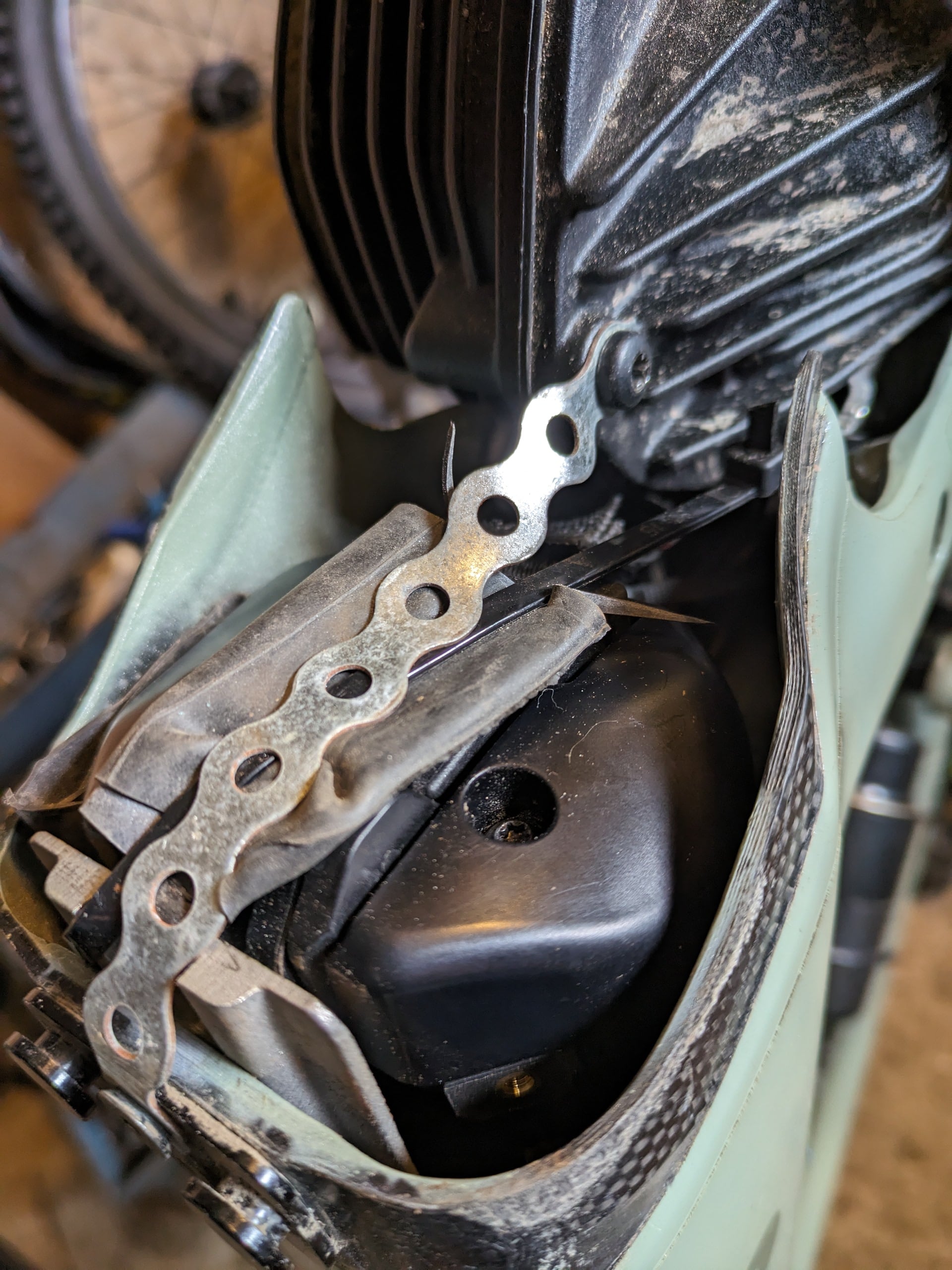

Hi all, as yet untested will try tomorrow with a broken lat
Hi all, as yet untested will try tomorrow with a broken latch. View attachment 123798
Took it for a spin today on some properly rough enduro trails and it didn't flicker once, and that was with a broken latch. I've got a new one coming so with that and the hack, upgraded from bodge, think i'll be all good.

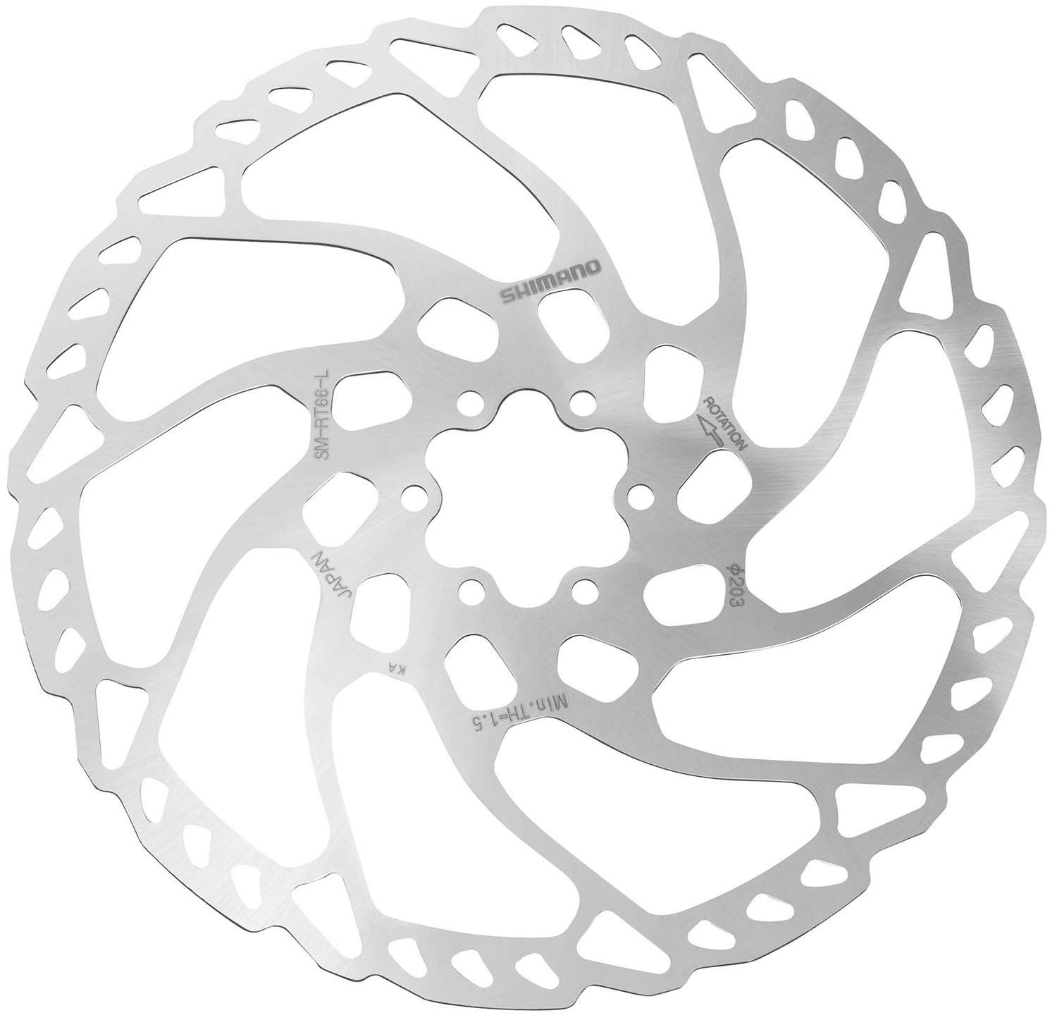

I really, really dislike the Shimano XT brakes on the CFR. They're weak, fade quickly, and the lever has no feel.
Can't decide what to replace them with. Hope Tech 4 V4 or Magura MT7 Pro are on the list, but are there any others that I should be looking at?
Aug 27, 2020
38
39
Middlesbrough
I had the complete opposite opinion and was very impressed by them. I was coming from Magura MT7s on my previous bike and although the modulation of the XTs might not be quite as good, I found them to be equally powerful when setup right. Maybe worth a bleed and check the pads are not glazed over?
thewanted
Apr 2, 2023
96
41
They’re been bled twice, and both callipers replaced by Canyon.
I could order some Galfer purple pads to see if it improves things, but the levers are still not going to have any feel. I have 2 friends with XT brakes and they both feel the same. It must just be the way they are.
emtbeast
Jan 10, 2022
358
407
Slovenia

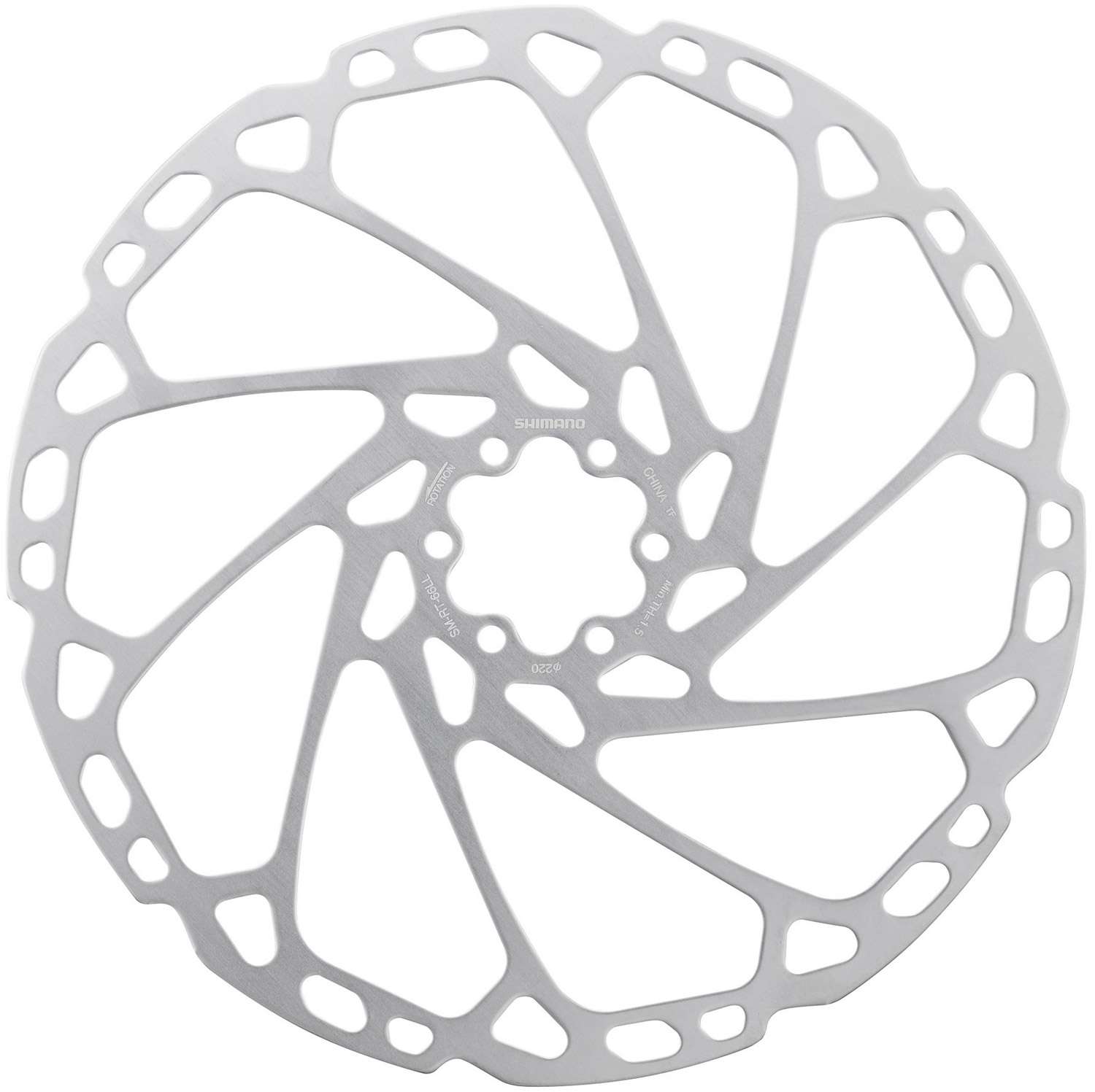

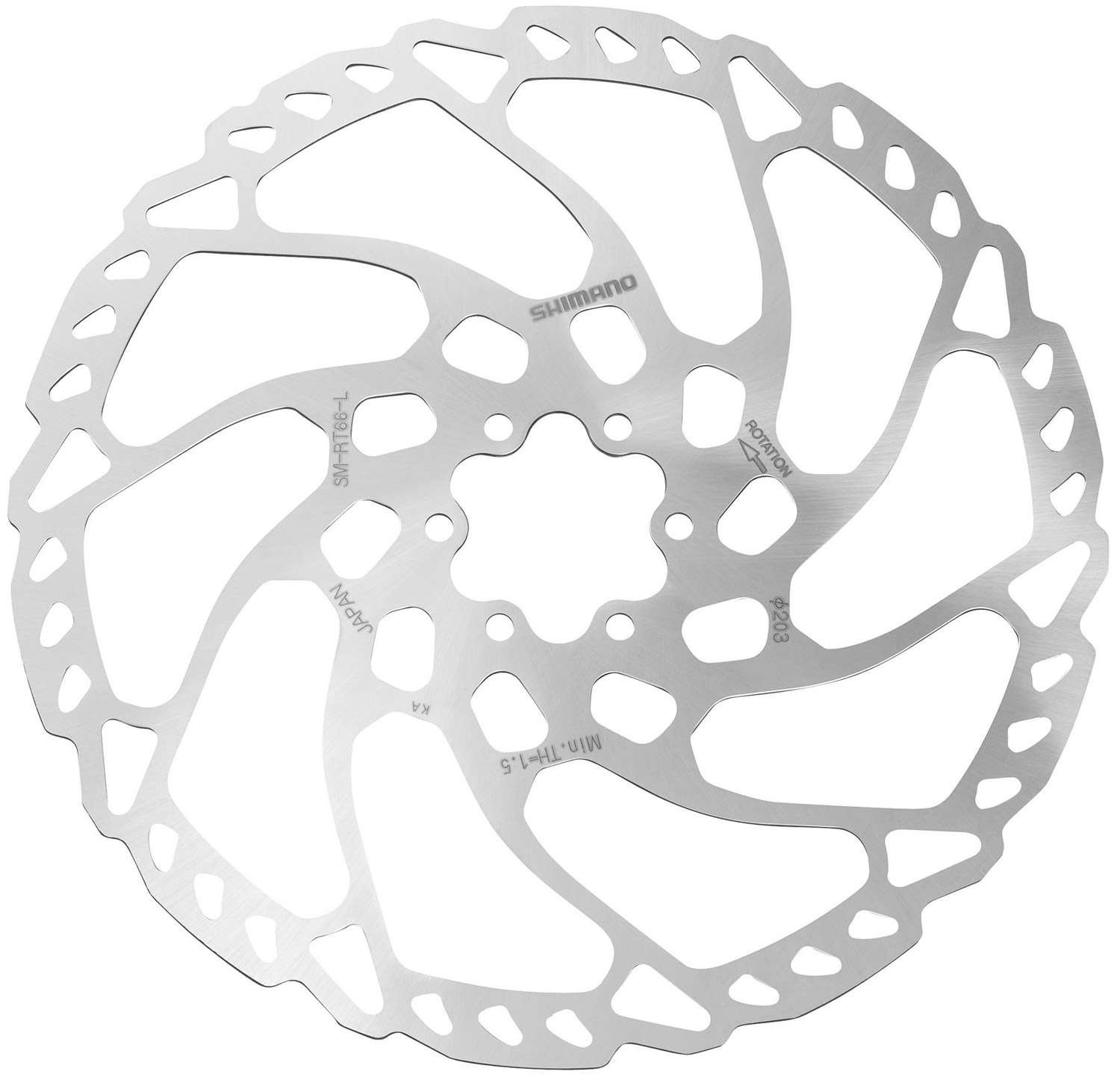

Maybe this helps with XT brakes...so I always preferred Shimano brakes combined with Icetech rotors before anything else on my amish bike, on my current ebike I have the XT four pots, couldn't be happier with them.
Although I didn't like them as they were specd from the factory, loud, extremely weak and just not up to the task.
Ok so just like the Strive CFR my Reign E came equipped with the RT-66 rotors(SLX level). I am not sure why(probably cost)but I have seen a lot of companies spec bikes with these rotors.
I replaced the rotors with 2mm thick Galfers and the difference was like night and day. I bet that even the Shimano 1.8mm RT-76 would do the job much better.
IMO the RT-66 rotors aren't a good match for an ebike going downhill full send, just good enough for those XC guys or couch potatoes going for leisure rides.
I would recommend trying this option before changing the whole brake setup, especially with all the through headset hassle on this bike.
Edit: I also want to add this buyer review to my post...as it probably also explains why the rotors aren't up to the task. You can see if your rotors are also stamped if the edges are rounded and the surface more like glass not rough.
"The Rt66 rotors were always laser cut and perfect. Today they are "stamped out" without any communication. The laser cut out ones are still depicted in some online shop photos, but you get stamped out rotors. The result is very disappointing. The braking force is uneven, vibrations, less powerful and makes a lot of noise."
Attached are two pics of a laser cut and a stamped RT-66 rotor. Shimano-SLX-SM-RT66-6-Loch-Bremsscheibe-203mm-ESMRT66L_800x800@2x.jpg Shimano-SLX-SM-RT66-6-Loch-Bremsscheibe-220mm-ESMRT66LL_800x800@2x.jpg

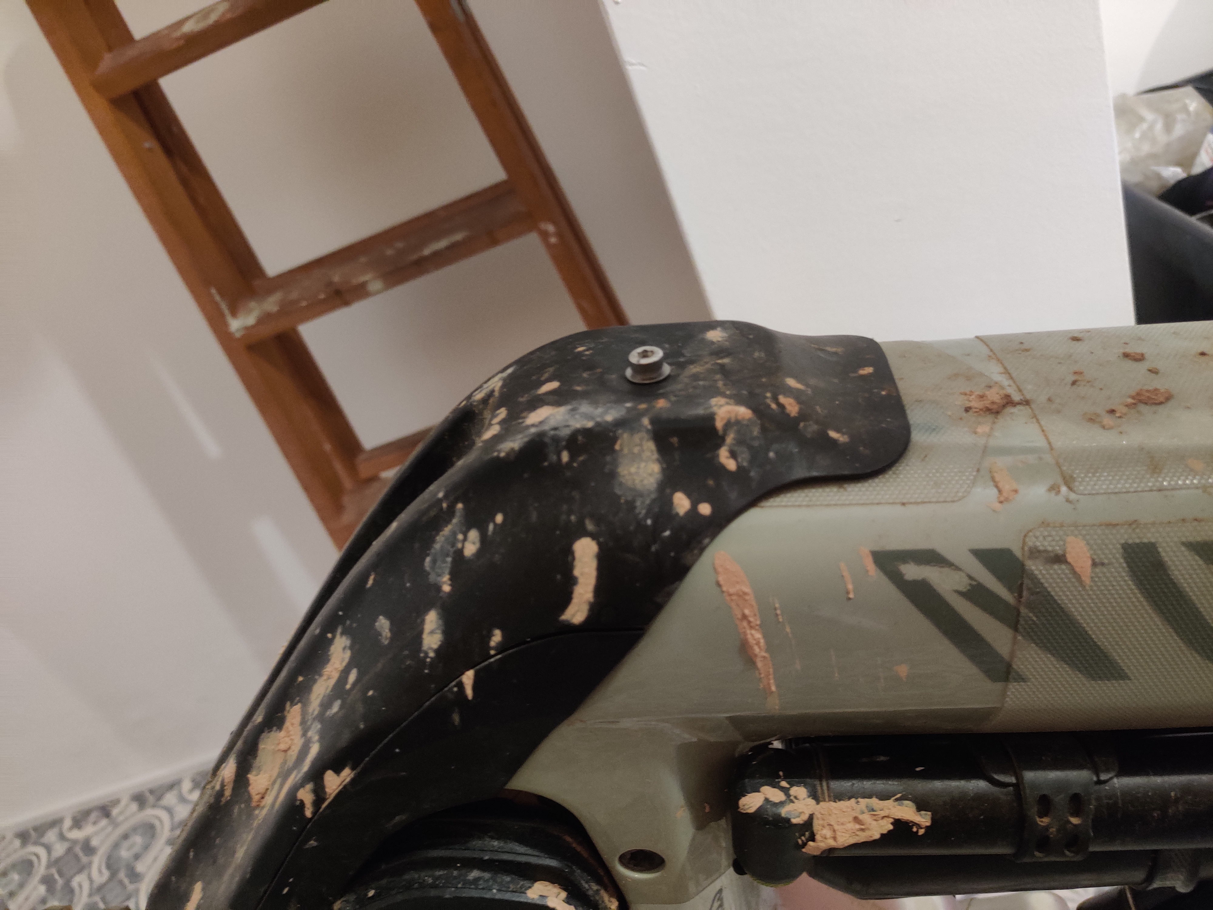

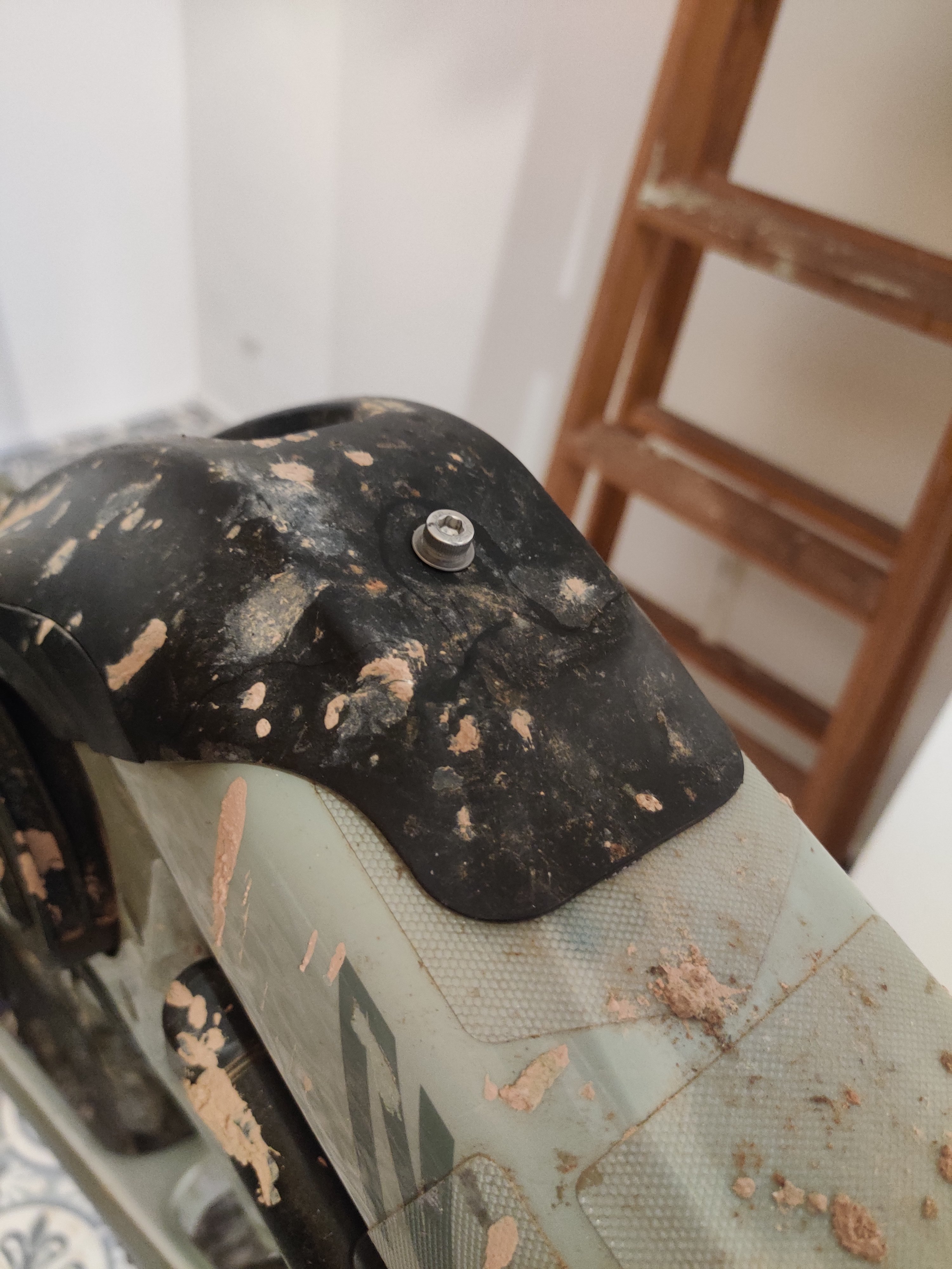

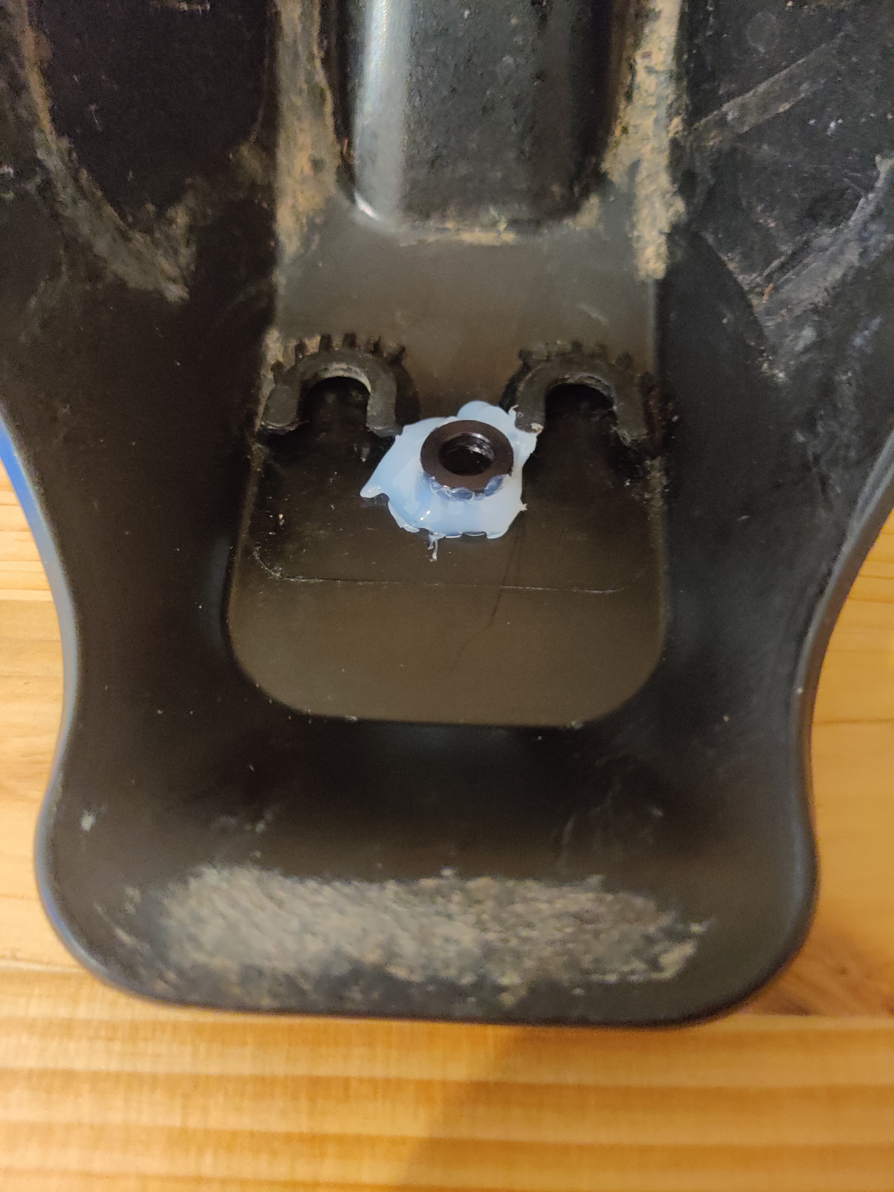

I've done some "mods" to try to improve the battery fastening, well the second one is more of consequence of smashing the bash guard against a fallen tree🤭, but also proves that holding the battery with a chunk in the bash guard is off the table, I've used a gear strap to hold the battery against the bracket on the frame, you could wiggle the battery fully installed in the bike before, causing some rattle, I couldn't tell today if the rattle is gone, because the bash guard was constantly coming off the fwd pins, only held by the aft bolt, hence causing some rattle, bike still working fine, no cut-off so far, I'll keep you updated on how it's holding on.
If you guys want I could explain more of what I've done with the bash guard, but I think it's pretty self-explanatory.
