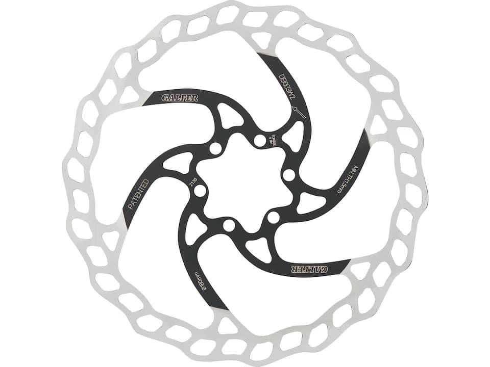

I’m wanting to replace the noisy 220mm Shimano front disc with a Galfer 223mm disc. Anything I need to do to take into account the extra 3mm?

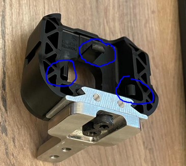

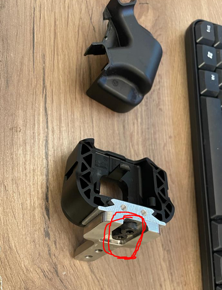

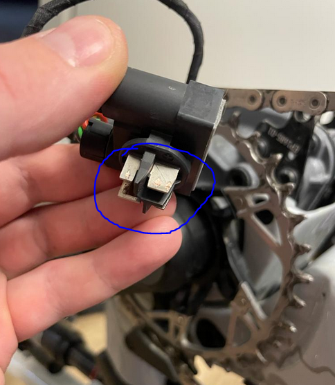

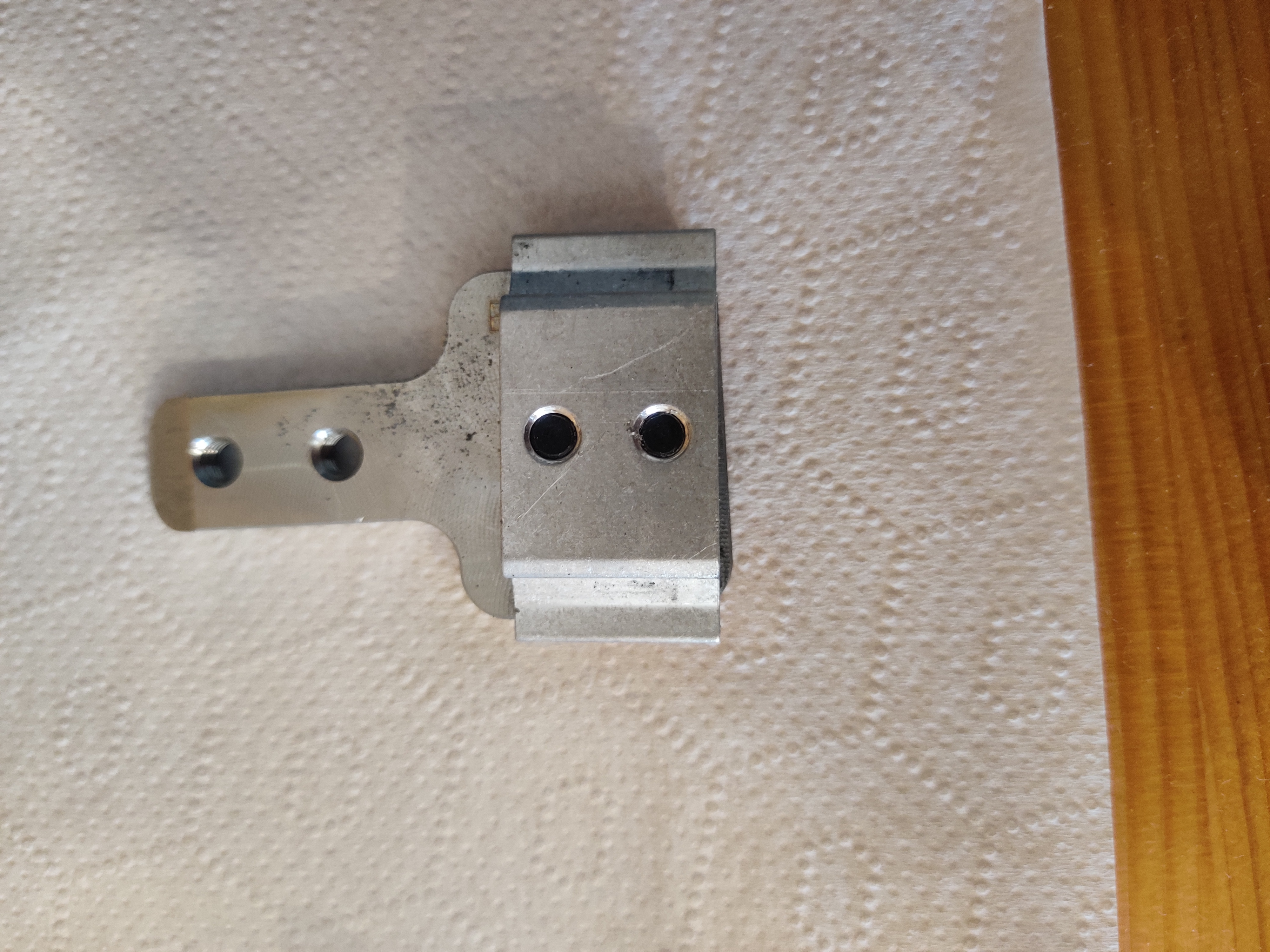

hey everyone, i also have a strive: on limited and the same battery problems. I have taken it apart completely and examined every single component (i am a mechanic). The problem was found immediately. That the tabs break is due to the battery moving with its weight. On the connector you can see the friction marks from the movement. It was the red marked screws that were loose. I put them back in place with loctite.
wenna
Aug 1, 2023
209
144
Sweden
How is the connector mounted to that piece that was loose?
eddie89
Sep 18, 2023
8
17
germany
How you managed to remove and reattach it in the downtube?
It’s pretty deep down AFAIR 😉
you need someone with thin arms ;) . Then you can loosen the screws. At the cable cover you have to pull out 2 long aluminum sheets with pliers 20x400mm so you can pull the cables. Is a job of 15 minutes.
Any chance you can do a YouTube vid on where and how to put the adhesive?
Thanks for the information, I've assumed the top battery holder was not the issue, but it absolutely makes sense, I have to check mine when I have some time (and find somebody with small arms) to see if it's the case.
Speaking with a Bosch certified tech, he told me Bosch suggest them when they troubleshoot, to check everything on their system, but not sure if that's a part of their system and if they only focus on battery, motor, controller, wiring etc... and not on the mounting hardware, I'm saying this because when I brought the bike to Canyon for the latch issue, the tech told me he went through everything and even it's written in the report, I guess, I'll find out by myself...

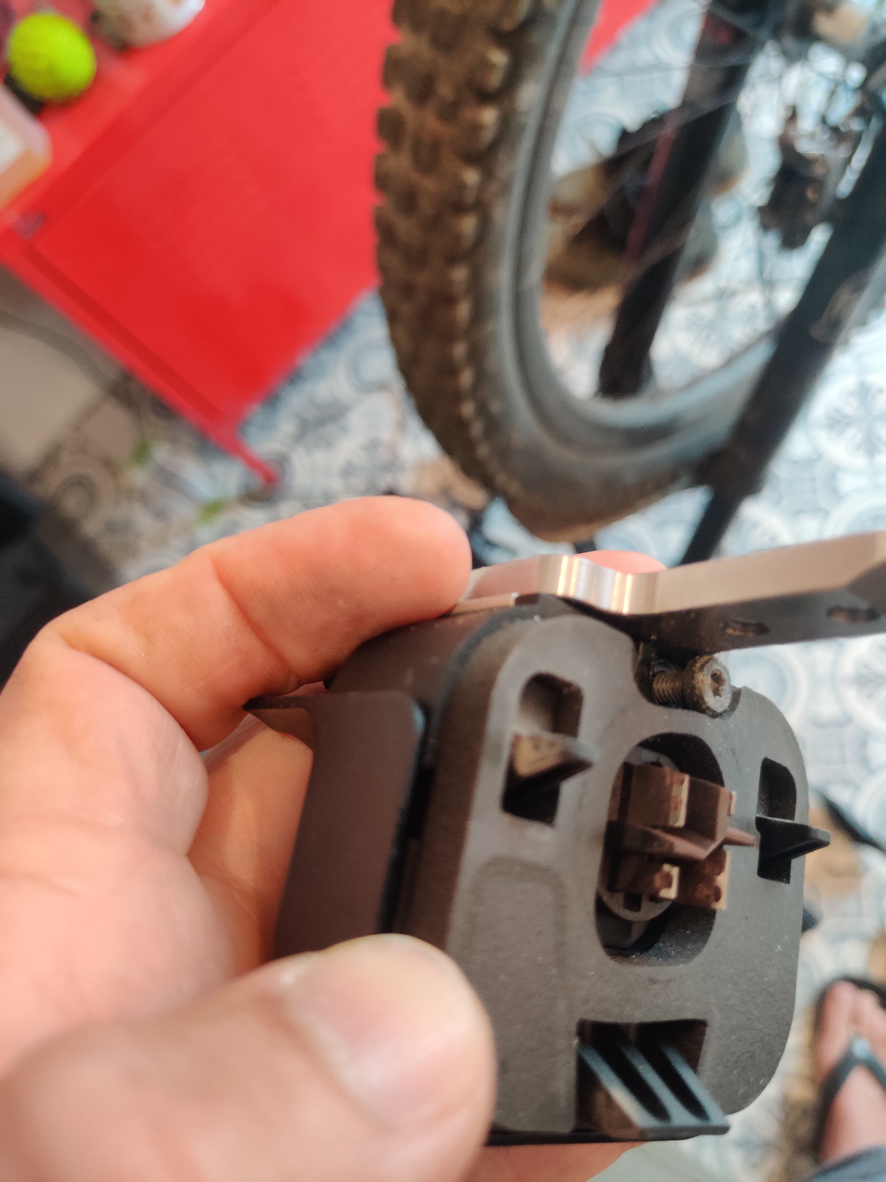

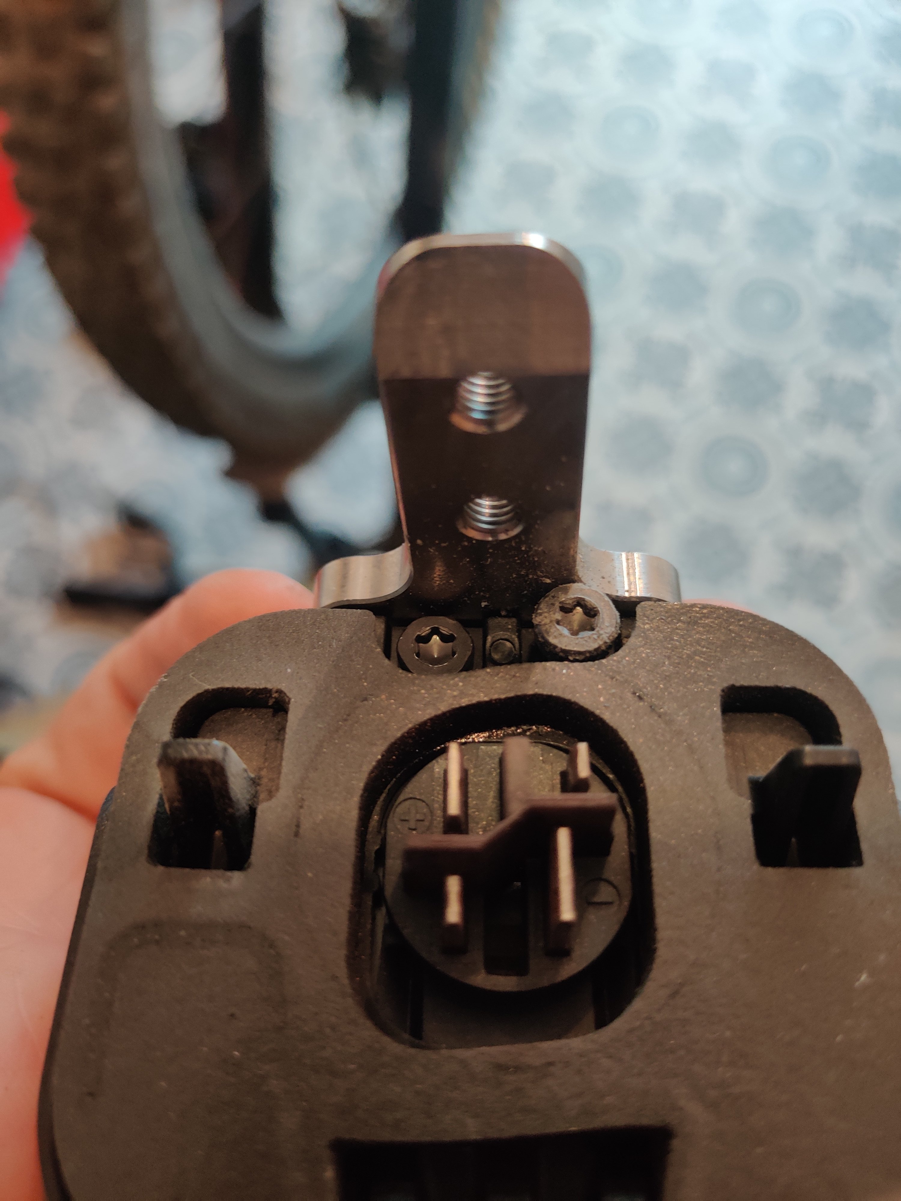

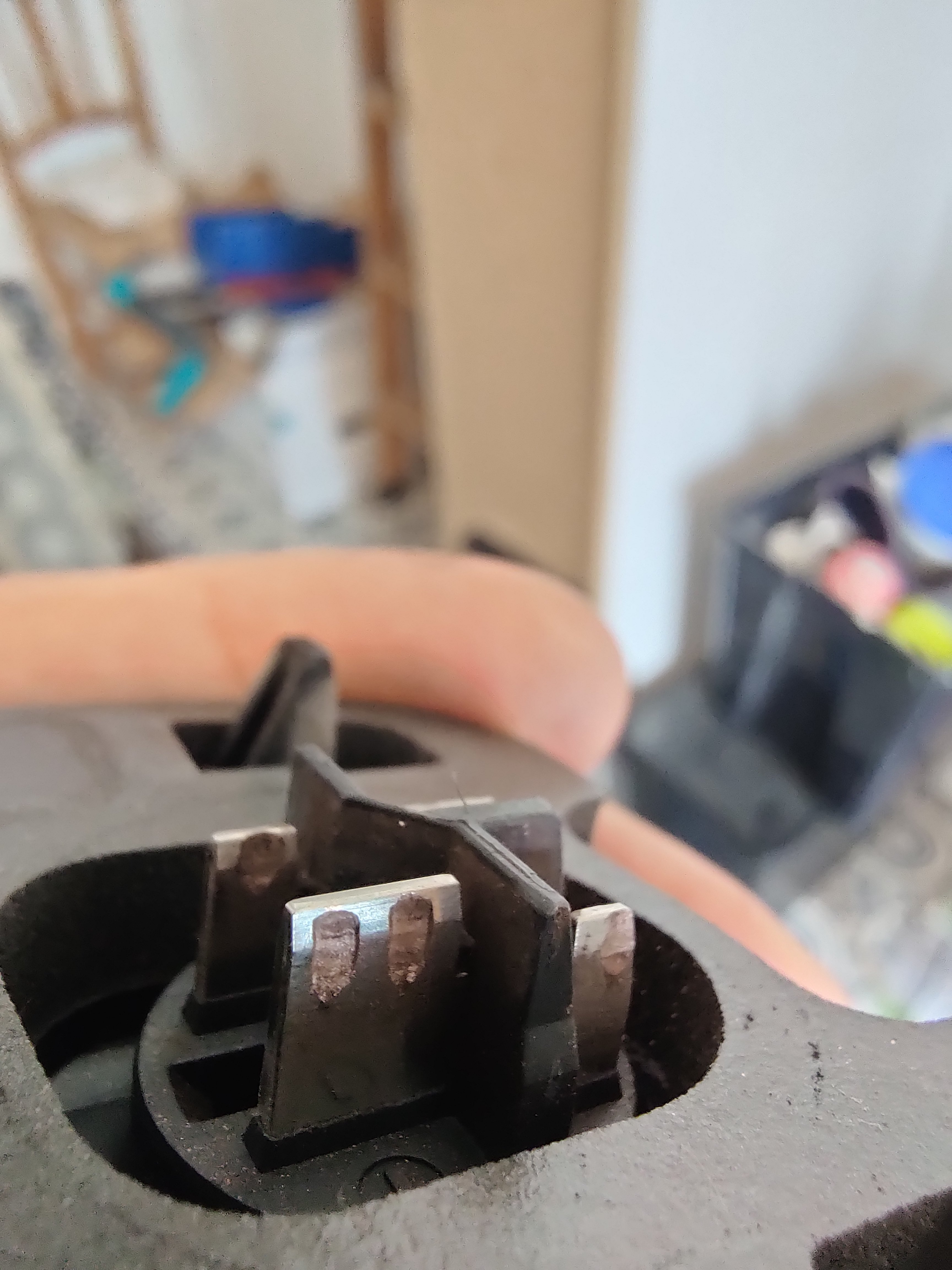

Quoting my self here, Canyon tech definitely didn't check everything over, the top battery connector/bracket has some issues: I had a loose bolt that didn't came out because the battery, I'm wondering if the bolt being out quite a bit, makes for a not so safe connection, as the battery had a stop avoiding it to sit completely on the connector/bracket (see pics) + the 2 metal parts on the bracket were misaligned...
A couple of tips to work with the top connector: the connector has to leads coming out of it, so you just need to remove the covers for the cables, and once you have the bolts holding the connector/bracket, you can just pull it out, to make things even easier, remove also the bottom bracket for the battery latch, it's only 2 bolts and will allow for better access for the connector/bracket to come out, and for your arm to get inside, you'll need your arm to hold the connector/bracket while you screw it back in place.

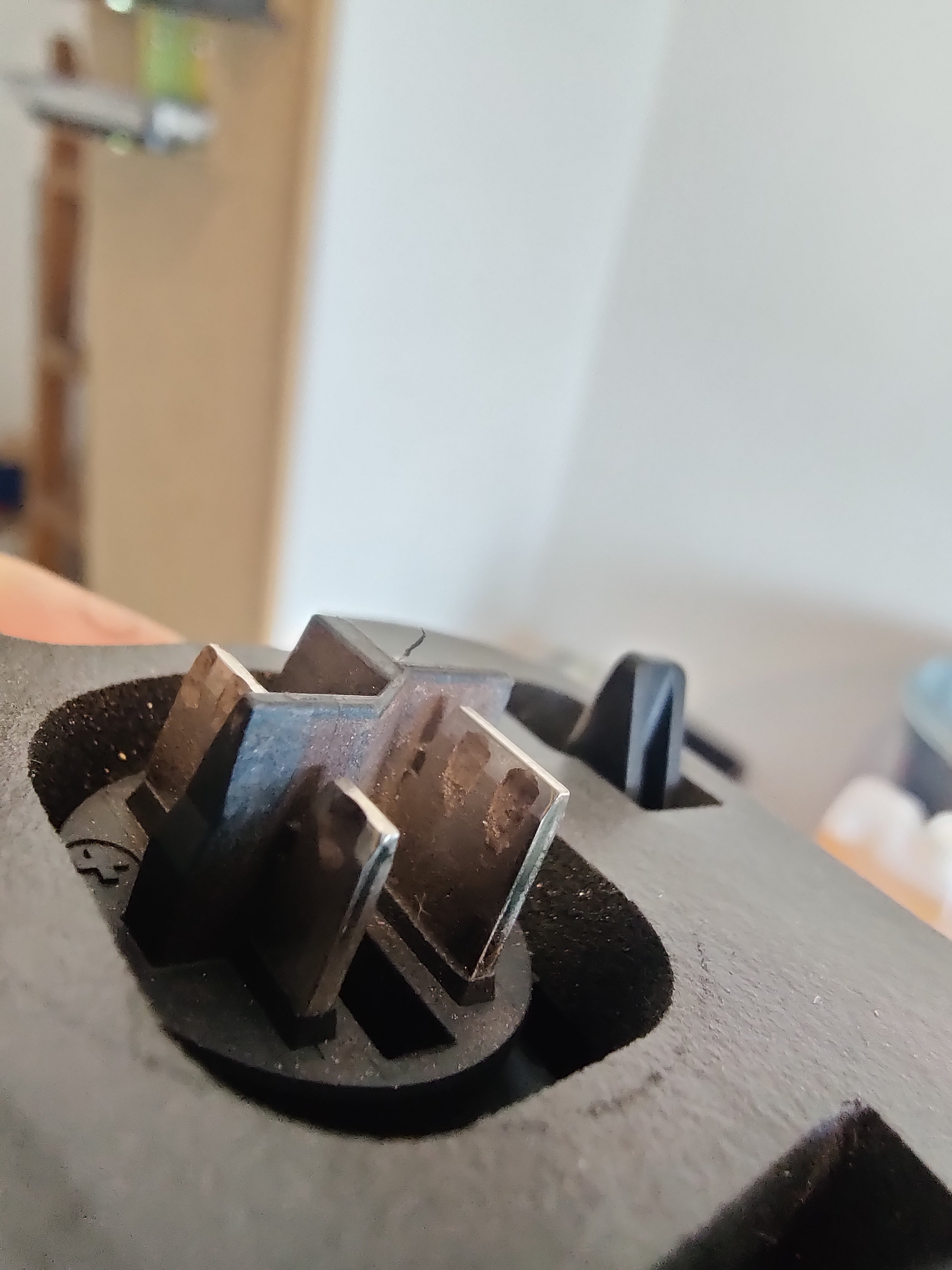

I've also noticed quite a bit of damage to the connector pins, I don't know what to do, I'm not sure to raise another warranty claim, as I don't trust anymore the canyon techs, or just order one with my own money, I think tomorrow I'll visit my friend, who is a Bosch certified tech and it's the only bike mechanic I trust, and see what he thinks
