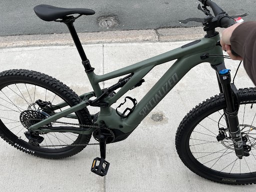

I just put downpayment on a S4 Comp Alloy in green. Picking up towards the end of May as I'm heading out of town. Looking forward to riding it and can't believe I'm paying what I'm paying for a bike! They are few and far between at my LBS so I figure I better bite the bullet while I can.
I'm a hair shy of 6'2 with a 32" inseam. While I have the S4, there is an S5 in the back not put together yet that I could also get. Any opinions?
You need to sit on them really, but I am 6’2” and have had GEN2 XL and GEN3 S5 with 210mm dropper.

For all of you 6’4” tall gen 3 turbo levo riders out there. Are you on S5 or S6 size bikes?
I just took delivery last week of a S5.
I am technically 6'3", but short legs and long body. 32" inseam, long torso. I just clear standing over the S5 frame. Essentially a 6'5" torso. I needed to put the seat all the way back, and just installed a 90mm steam and 800mm bar. The cockpit fits very well now. I think a S6 would've been a better fit, but I cannot say the difference the longer wheelbase would make on handling. As a note, the bike shops I visited prior to purchasing all recommended the S4 based on my height only. An S4 cockpit would have been to small I believe. In the end, I based my choice on Rob Rides as he is 6'3" and got the S5.
Sep 19, 2020
99
94
Squamish, BC, Canada
I’m 6’2” with long arms and legs. Lots of stand over clearance on my S5 and my previous XL. S5 fits perfect in low/slack aside from throwing on a 210 one up dropper, which will be changed to the new 240 at some point as 210 still doesn’t get high enough.

So I rode both the S4 and the S5 back to back and decided to stick with the S4. Can't wait to get back from vacation to pick it up!
