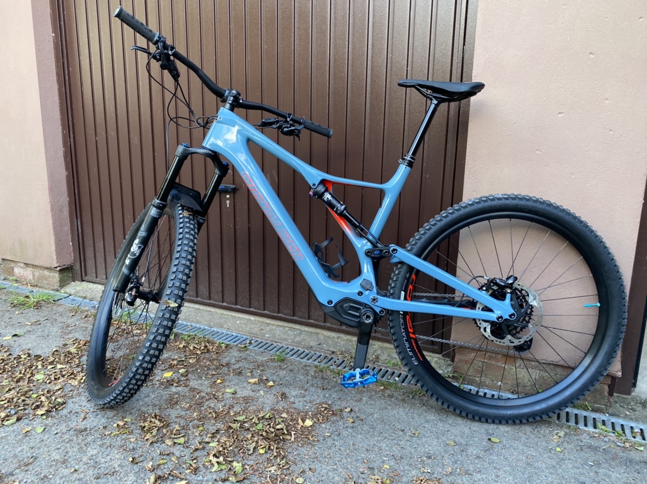

First ride on my own SL tonight and I bloody loved it. The shop changed the brakes to Code RSC’s for me with 200mm Ice Tech rotors both ends - and very nicely they worked too. I changed the grips but otherwise everything else was stock on the Comp Carbon... and, it all worked really well! I had big plans to change the suspension, dropper and drivetrain but I’m not sure I’ll bother now.
I got dropped a bit by my 80Nm toting riding buddies on the steep stuff but everywhere else was fair game. It’s a lot more playful to ride than my Trance.

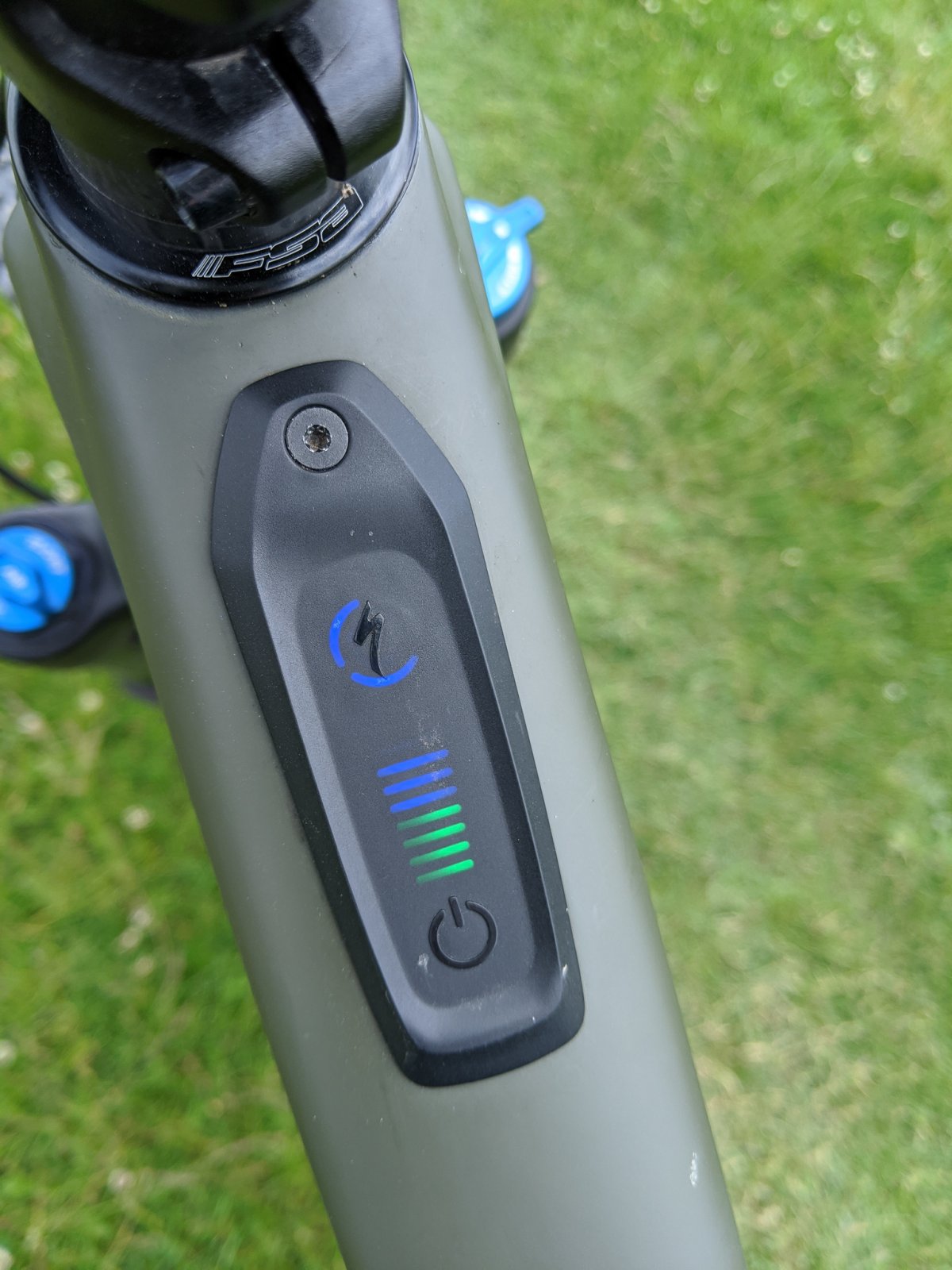

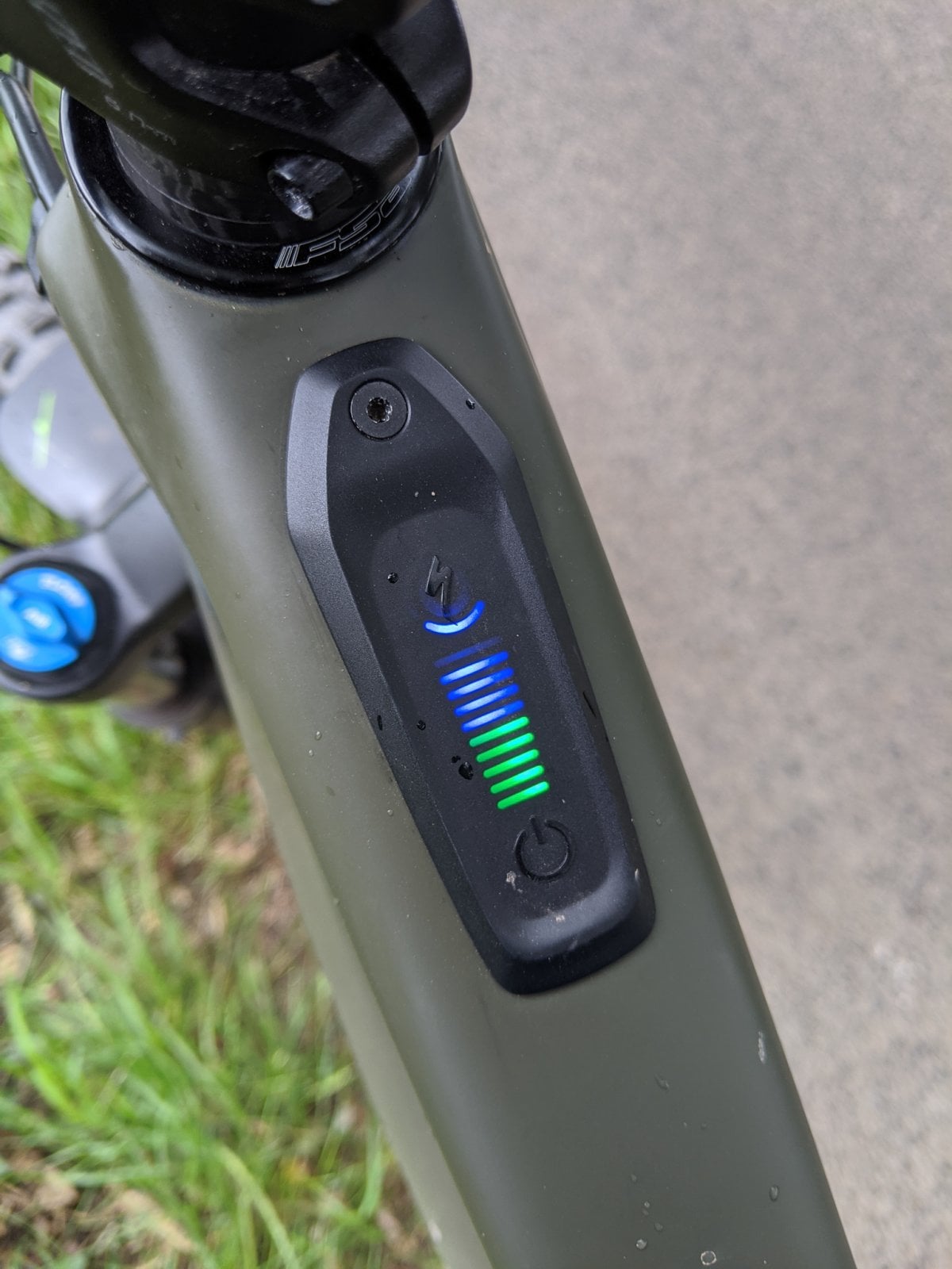

I set off with the bike reporting 150% battery / 15 bars lit on the TCU.
Within a mile of my door I was on the canal path all the way to Devizes.
Of course it was pretty flat (until Caen Hill) but it took a bit longer than expected. Dodging dog walkers and two families of swans and cygnets right at the side of the path.
Did the whole stage in Eco mode, knowing I had a climb up to the Wessex Ridgeway to come later. And I didn't want for more power, with the SL happy to accelerate on the flat and no resistance when I hit the motor speed limit.
On average, I was budgeting for around 7.5wh drained per mile.
In practice, when I checked my drain at the end of this stage, I nearly spat out my americano: 65wh used.

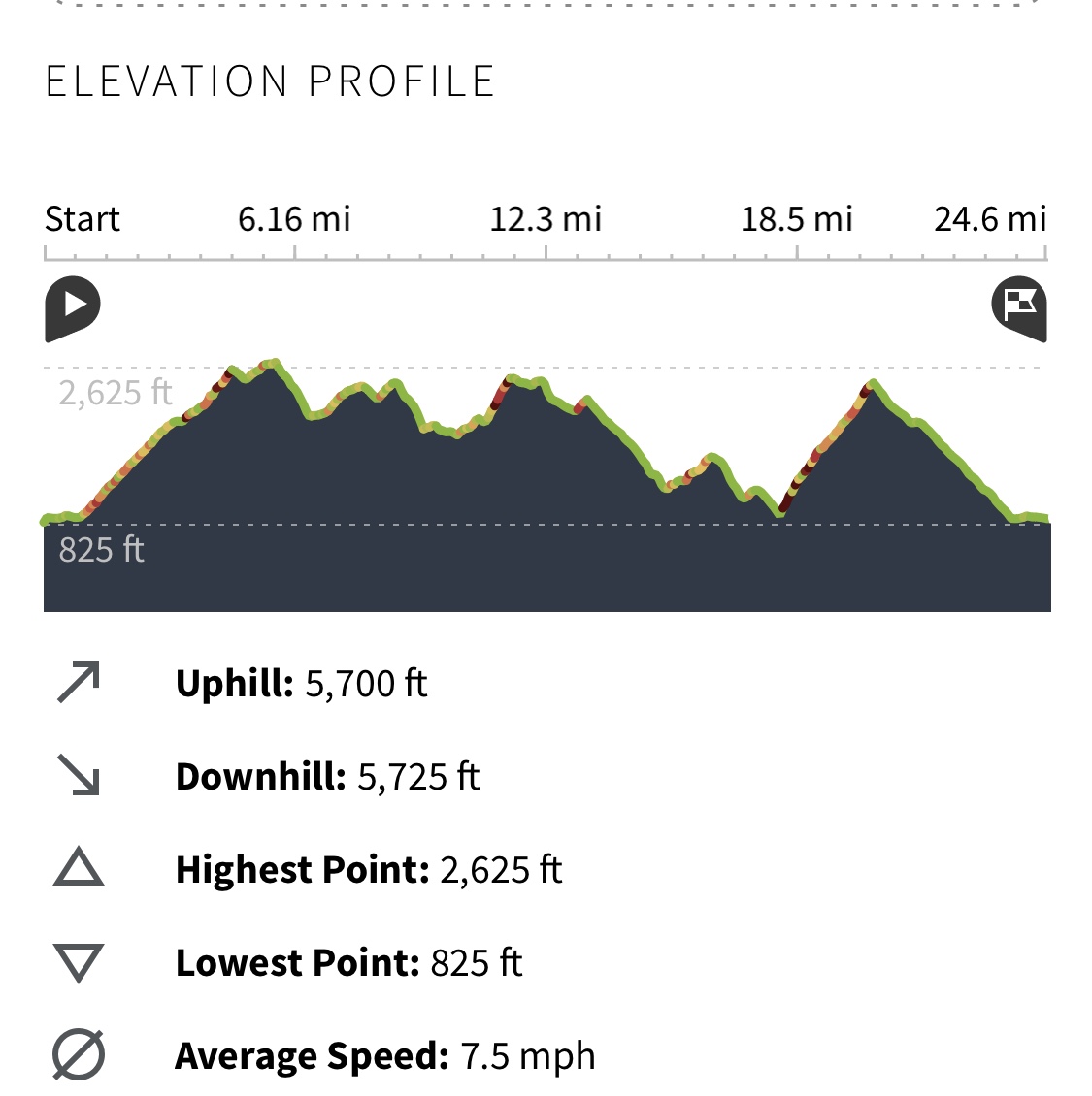

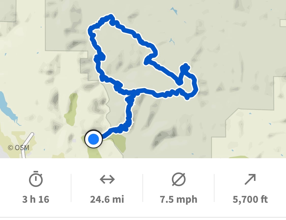

Another day at Henry Coe State Park in Bay Area, California. It was a great run until I got spooked when I stumbled upon a fresh kill while climbing - around 19th mile marker. Good thing I had my timber bell on to warn animals of my presence. Warning graphic image!
I'm in the Bay Area and thinking of trying Henry Coe. The length and vert of your ride seems about right for me. What specific trail(s) did you ride?
