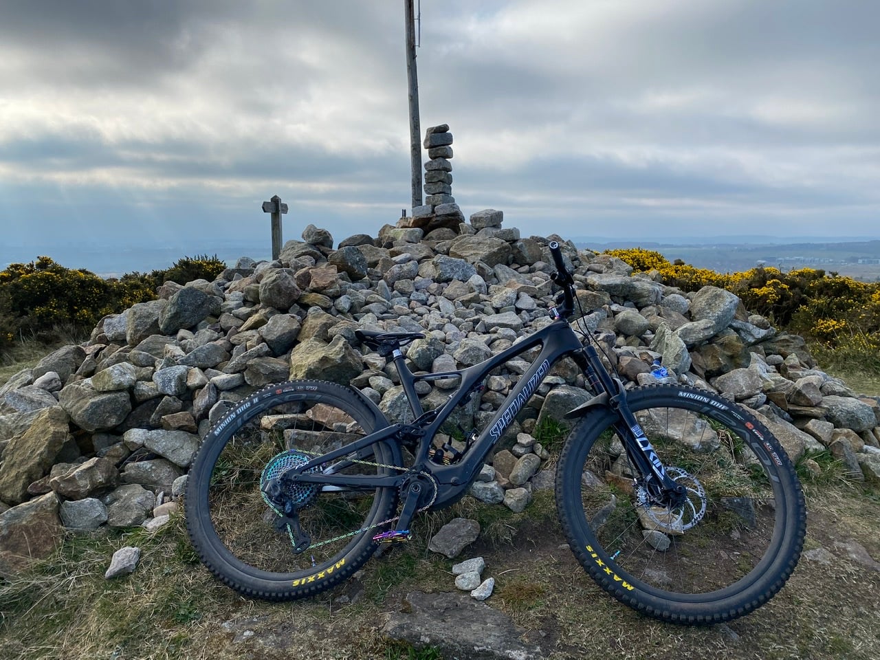

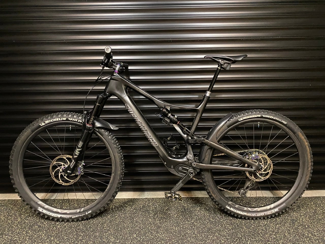

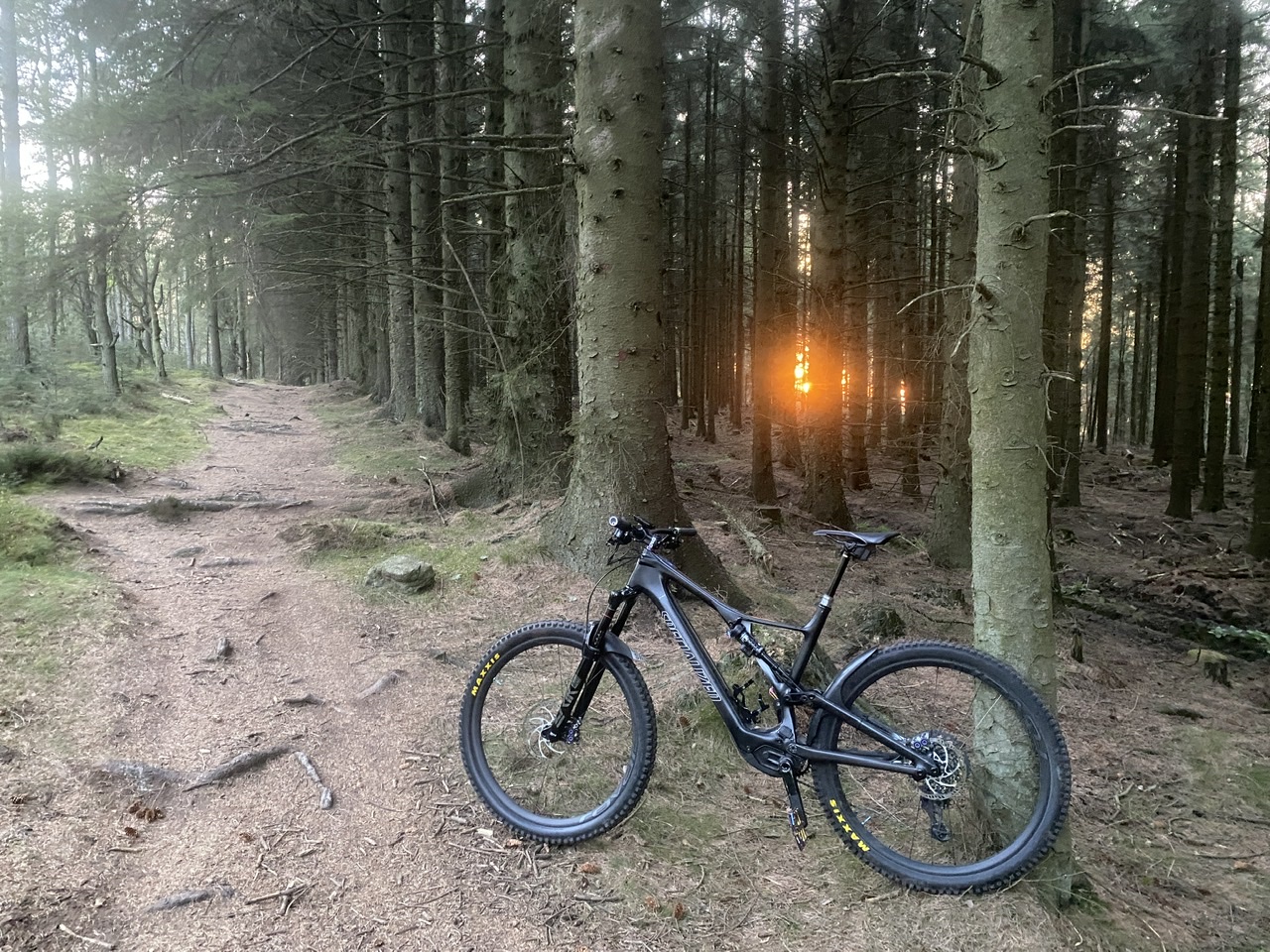

I’ve got a test ride thread out here somewhere that has details of my build in it - but here’s the info in an easier to read format rather than spanning over loads of posts...
My Bike:
Specialized Levo SL Expert - Size XL
What’s changed:
Full Invisiframe kit
SRAM XX1 AXS derailleur
SRAM XX1 cassette
RockShox Reverb AXS 170 x 34.9mm dropper post
RockShox Lyric Ultimate 160mm 51 offset fork
ENVE DH Carbon bar
ENVE 55mm Carbon stem
Magura MT7 brakes
Magura Storm HC Rotors (200mm + 180mm)
Magura Carbon levers
Specialized Phenom S-Works saddle
HT Components ANS-10 Supreme pedals
Ergon GE1 Evo Grips
Maxxis DHF 29 x 2.5 front tyre
Maxxis DHR II 29 x 2.3 rear tyre
Muc Off 45mm tubeless valves
Mudhugger FRX mudguard (trimmed) at rear
Some cosmetic changes - Magura purple rings for the brakes, some titanium iridescent screws dotted about... and iridescent headset spacers.
View attachment 30025 View attachment 30026

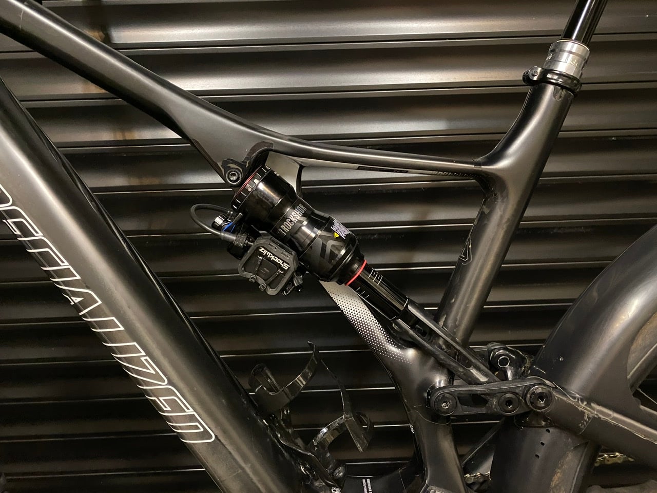

Fitted the Super Deluxe Ultimate last Friday when I got home from work. Was due to go for a ride on Sunday, but did my back in playing golf on the Saturday! Properly ruined, and I lay in the fetal position all of Sunday / Monday as it was the only thing that eased the pain!!
The bike has sat with the shock on for over a week teasing me. Although my back is still not 100%, I thought I’d take the bike for a gentle ride today.
We’re back in Covid lockdown again (although it’s lifting at midnight today ?), so I couldn’t go too far anyway.
Some roads, some fire road type trails, and a little bit of single track. Nothing particularly wild, but I’m really pleased with the shock so far. I no longer feel like I’m riding a bucking bronco when riding over rooty and rocky paths!
Looking forward to getting it out on some ‘real’ trails... hopefully next weekend. By that time, I’ll hopefully have done my 2021 damper upgrade to the Lyric too.
As things stand, the only original parts of the bike are the frame, wheels and cranks... although the cranks will be changed as soon as the Praxis carbon are available in the UK. Due beginning of Sept apparently ?
Nice one on the ShockWiz placement - I was wondering the best place to put mine.

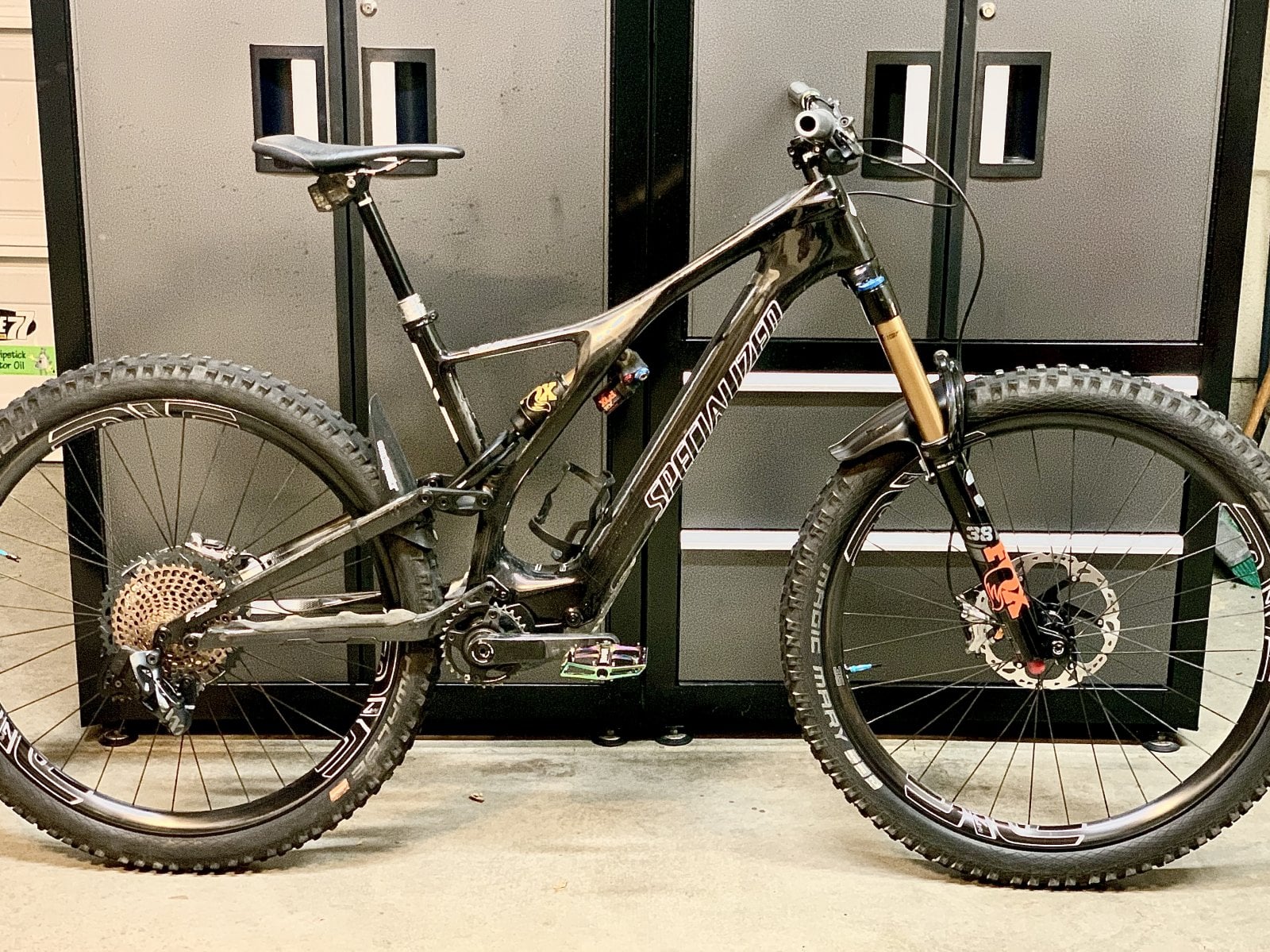

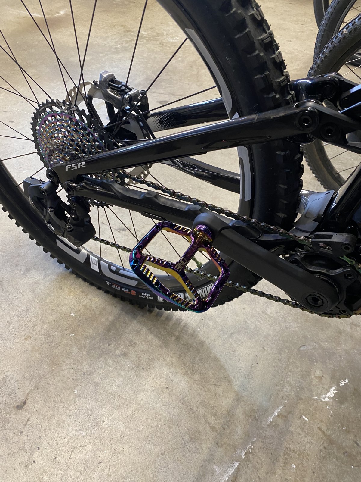

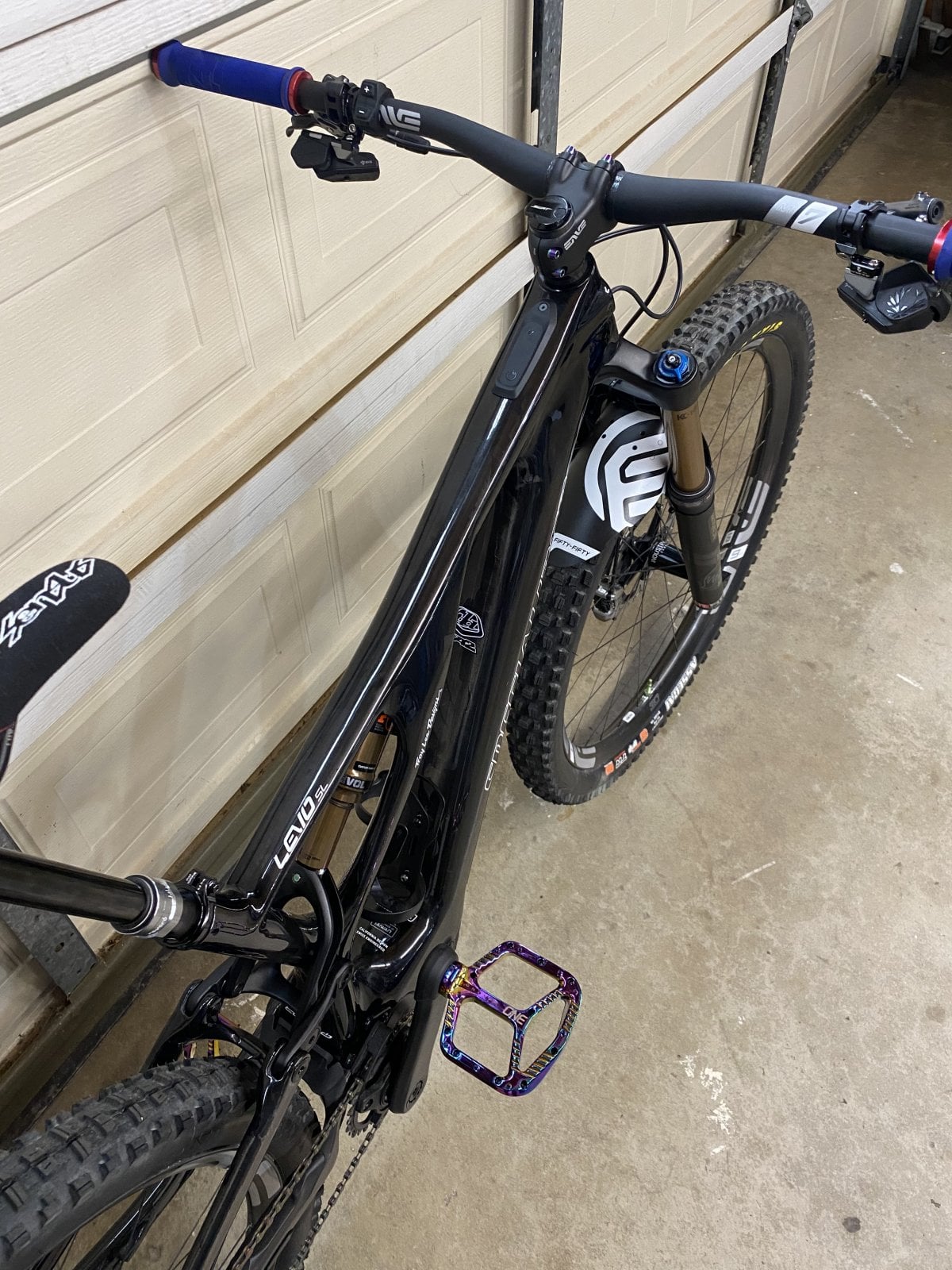

I've been waiting until my baby was all done to make my first post... I think I'm finally there. I might add some oil slick decals and some more oil slick Ti bolts, but I'm not sure how much oil slick is too much. I am absolutely in love with this bike
Specialized Levo SL Expert Carbon - Size M
Enve M630 Wheels with i9 Hydra Hubs
SRAM XX1 10-50t cassette (Oil Slick)
SRAM XX1 chain (Oil Slick)
RockShox Reverb AXS 150 x 30.9mm dropper post
Fox Factory 34 Fork (2019 - Freebie from a friend who took it off his s-works)
Fox Factory DPx2 Rear Shock (2021)
Praxis M30 Carbon Cranks
ENVE M7 Carbon bar
Shimano XTR M-9120 Brakes
Shimano front rotor is the XTR-RT-MT900 in 203mm, rear rotor is RT-EM810 (waiting on the RT-EM910 that is only available in EU it seems)
SDG X Sensus - RADAR FULL KEVLAR Seat
Sensus DISISDABOSS! Grips
Oneup Components Aluminum Flat Pedals - Oil Slick
Maxxis Assaegi DD 2.5 max grip front
Maxxis Dhr II 2.4 max grip rear
CushCore tire inserts and valves
Fifty Fifty Front Mud Guard
Added some Ti bolts to the stem, and rear shocks. Might add some to the brakes etc.
