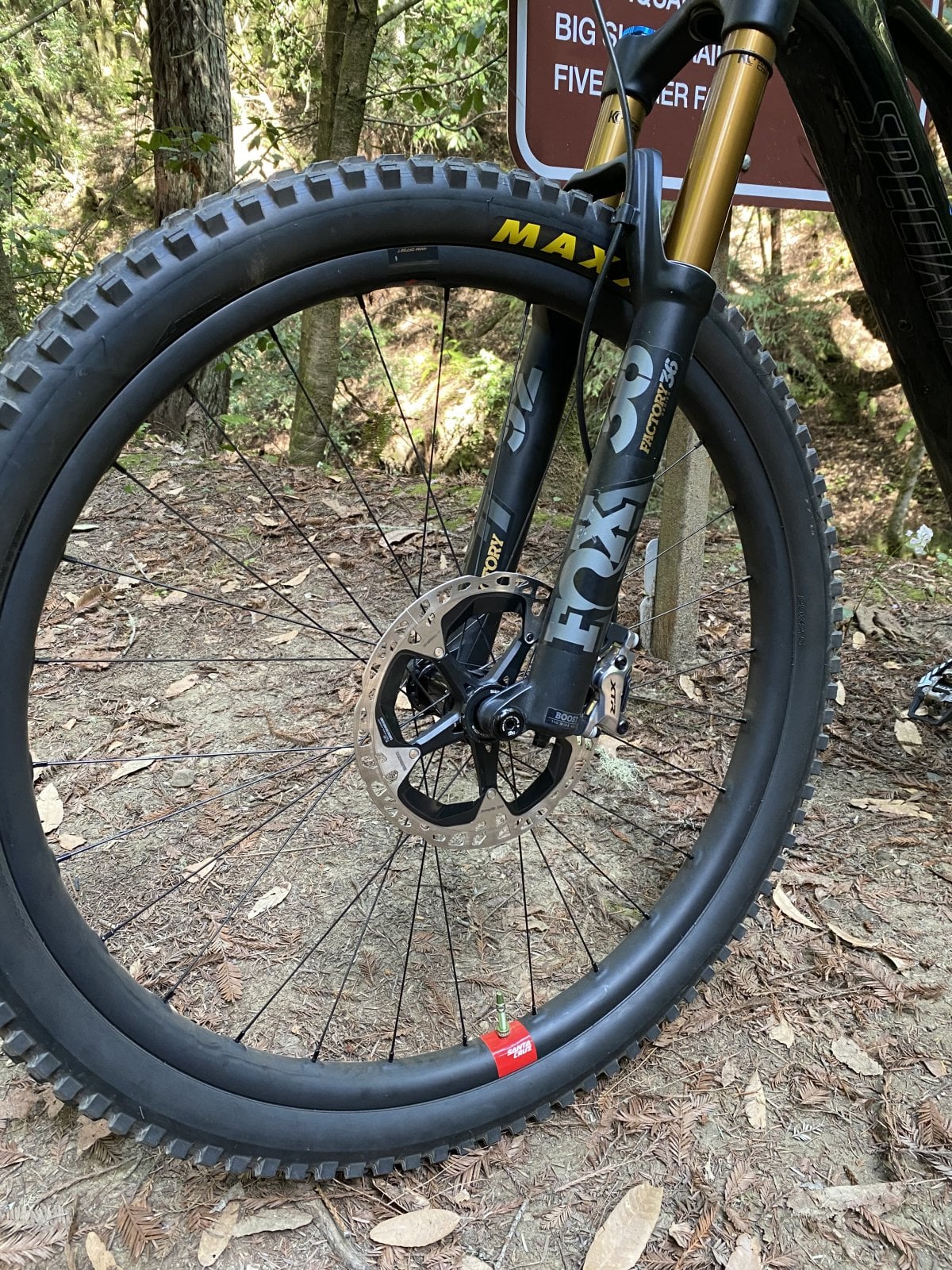

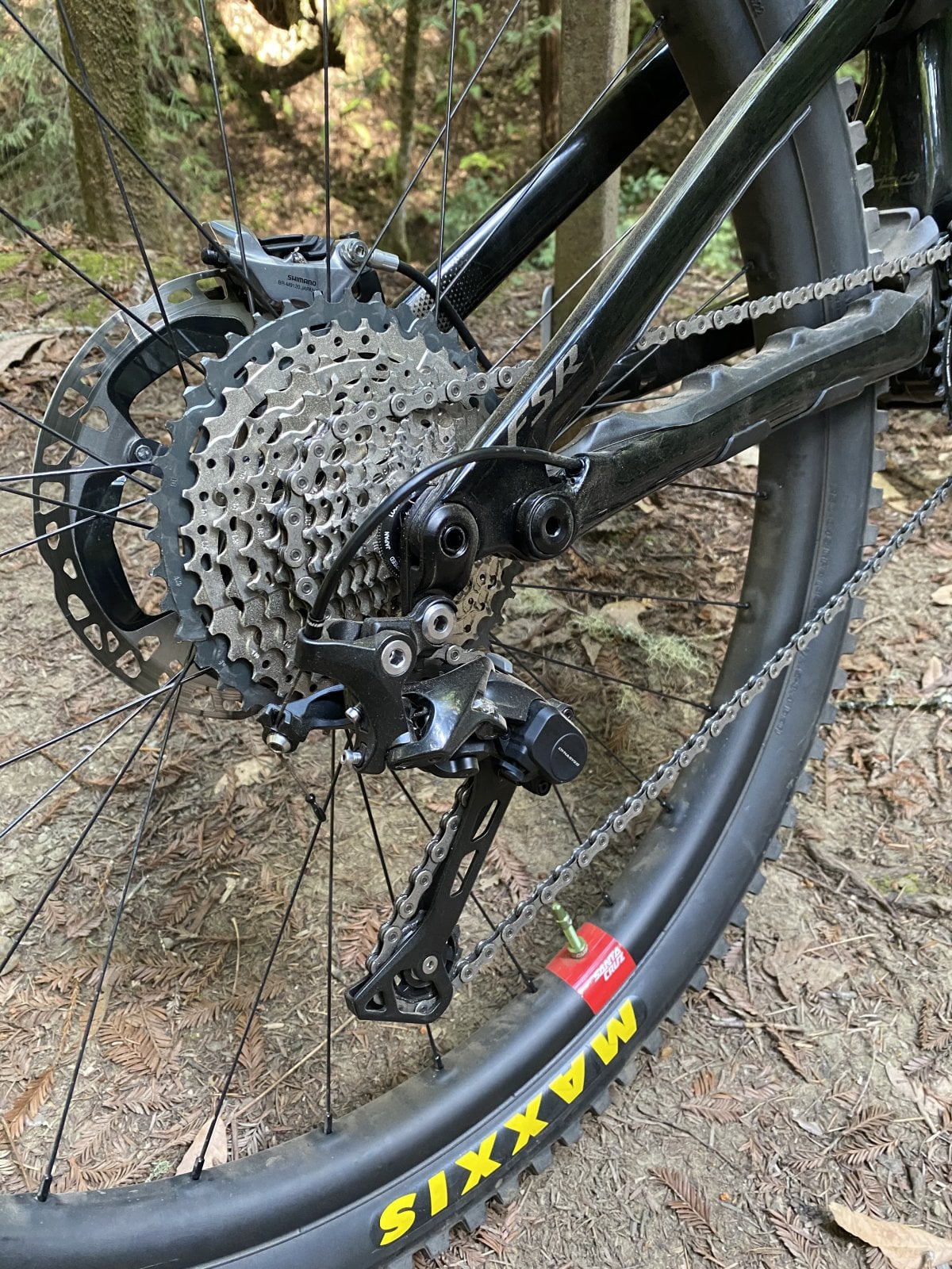

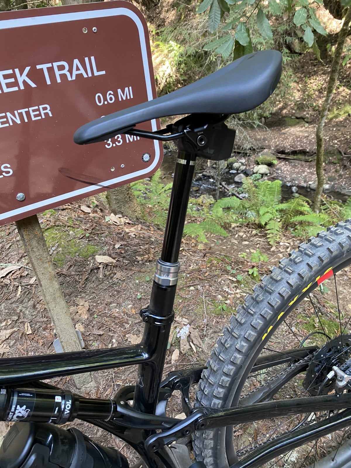

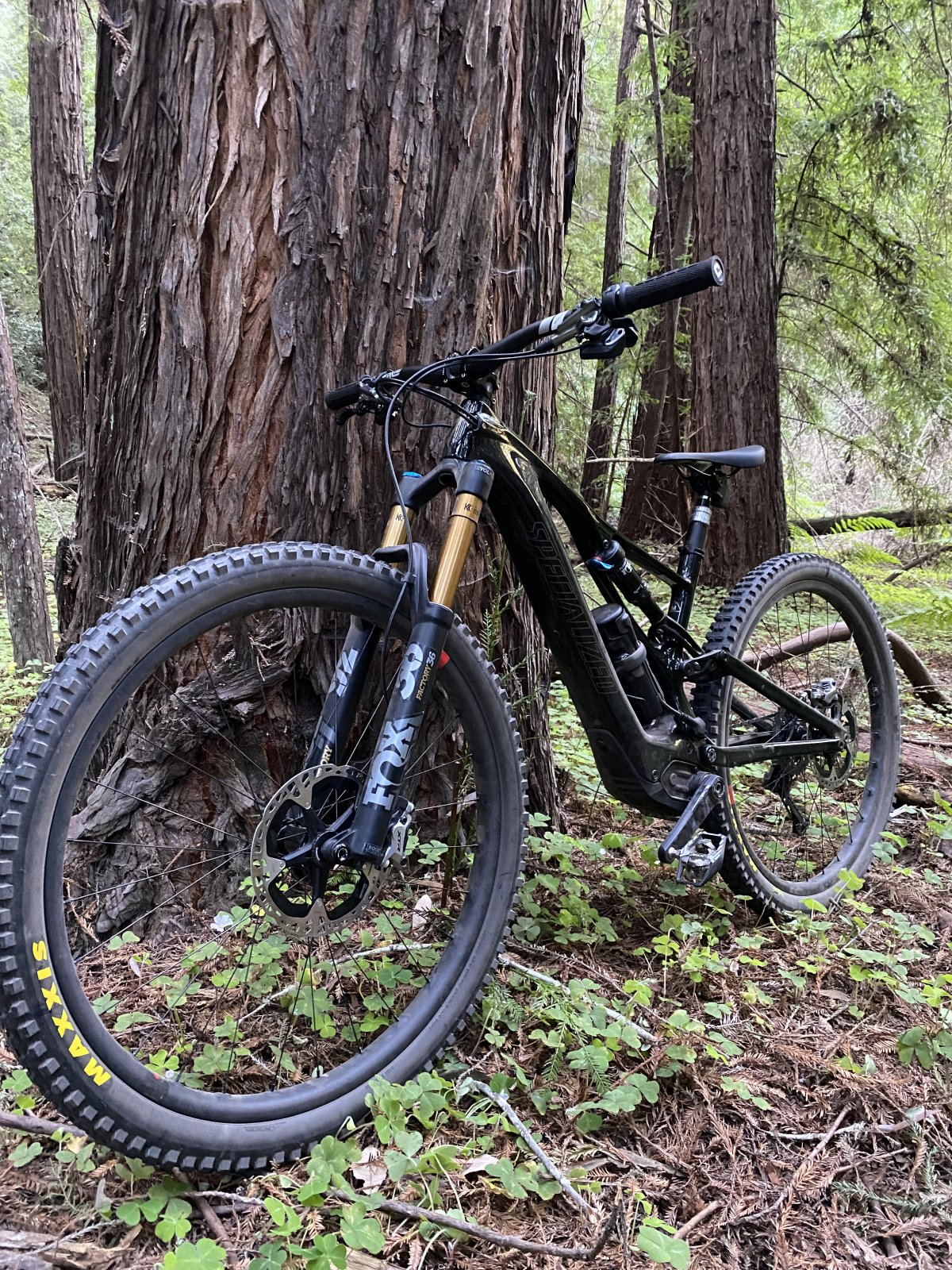

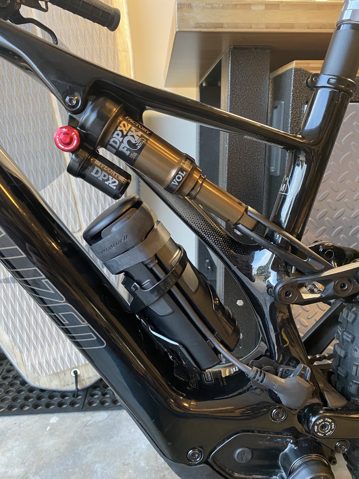

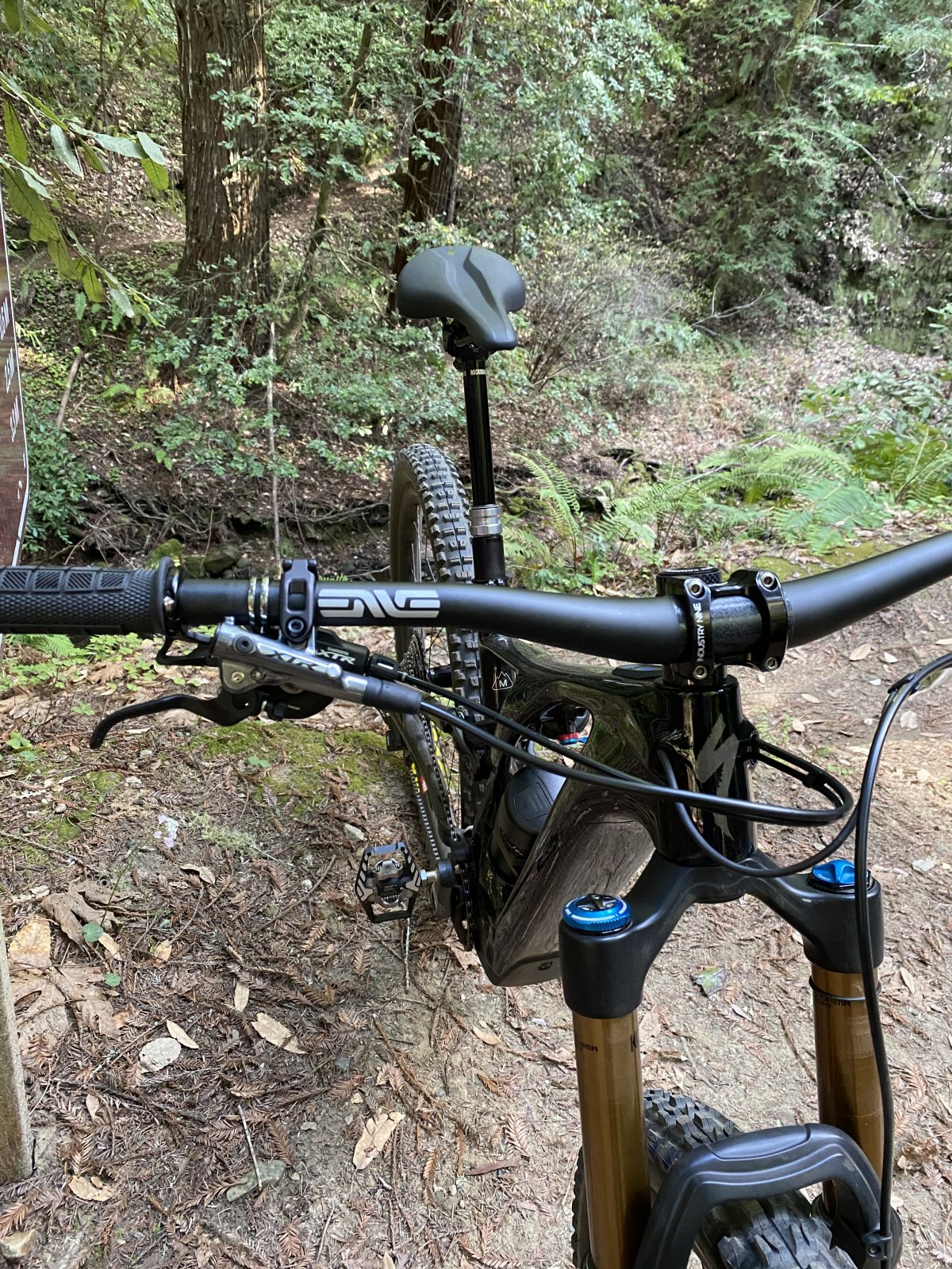

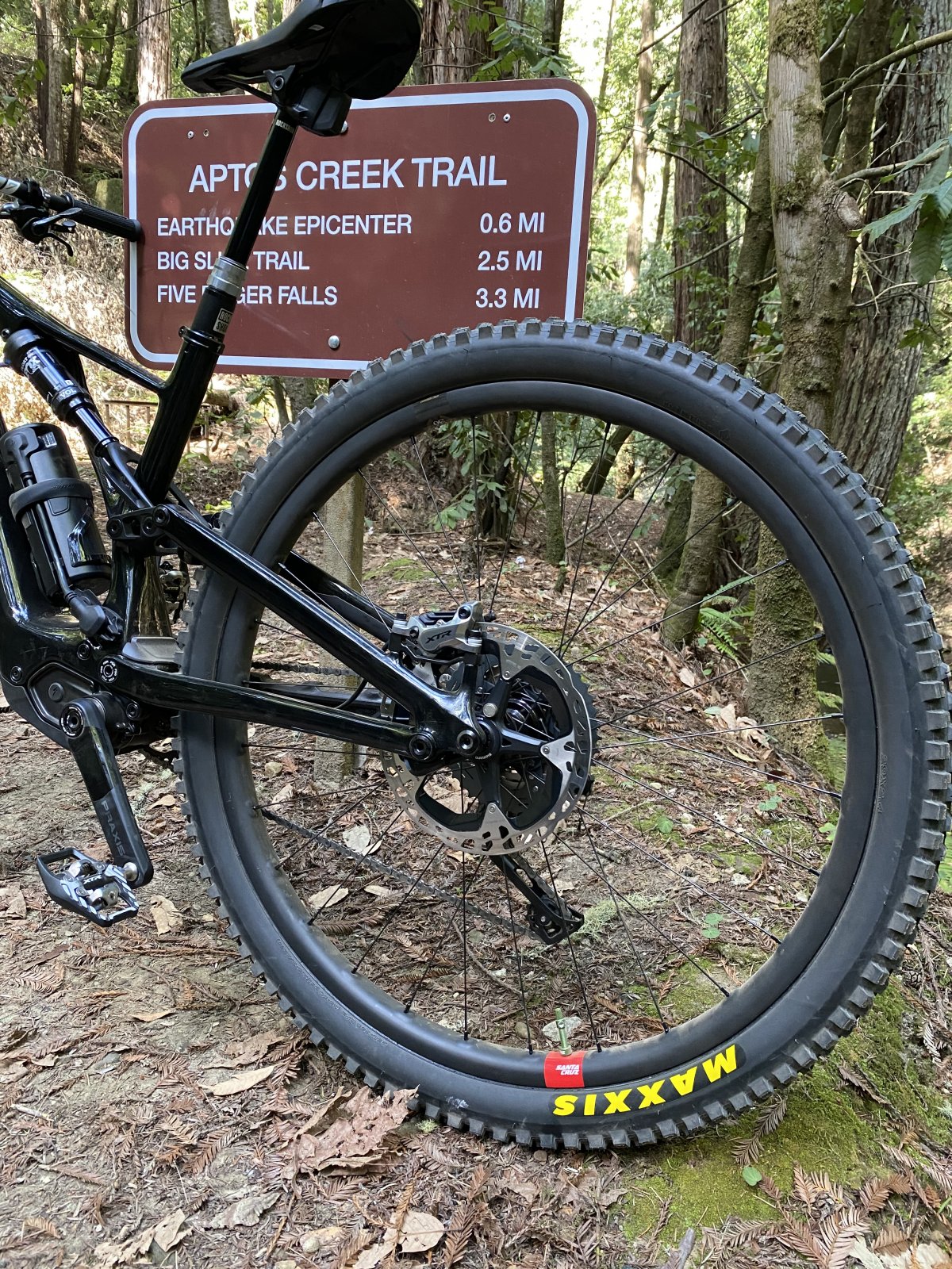

I thought I would share my Levo SL shimano build. I don't care for Sram components except the AXS seat post so I decided to buy the SL carbon comp and then do a full custom build on the bike. I installed 11speed instead of 12. I feel on the ebike it's unnecessary and not a good fit. 12 speed is not robust enough and to finicky. I finished the bike today and took her for a maiden voyage. 3 hrs, 30 miles, 2500' of elev gain, 33% of battery life left, and lots of smiles. The ride included the range extender and I rode 90% of the ride in "trail mode". I will upgrade the cranks to carbon when they are available. I would like to upgrade the shock to the DPX2 or X2. I am hoping someone will do it and post it.
This was my parts list:
Pedals XTR M9100 PD-M9120
Brakes XTR M9100 BL-M9120
Shifter XTR SL-M9000 11-speed
Derailleur XT long cage SGS Shimano XT RD-M8000
Cassette XT CS-M8000 11spd (11-42)
Chain CN-HG701-11spd
Sram AXS Seatpost
Bars ENVE M7
Stem Industry 9 35mm
Fox Fork 36 grip2 150mm
Fox DPX2 210x52.5mm
Reserve Rims 30 with Industry 9 hubs
Centerlock 203mm IceTech Rotors front and rear
Maxxis Minion DHF 2.5 – front
Maxxis Minion DHR II 2.4 - rear
Cushcore
Odi Elite Pro Grips
How do you like the feel of the reserve 30 carbon rims? I know they are bulletproof but how do they ride, do they ricochet through rock gardens throwing you off line, things like that?
Thinking about getting them but I need micro spline as I want to utilize 12-speed Shimano cassette, chain and I'll be using it with the SRAM AXS rear derailleur.
ridesantacruz
Feb 4, 2020
99
105
Santa Cruz
The Reserve rims with the I9 hubs are killer! I don't have any complaints. Never noticed an issue. I use Cushcore with the rims and run my tires with about 19PSI.

Nice one! Was the routing of the rear brake a problem?
