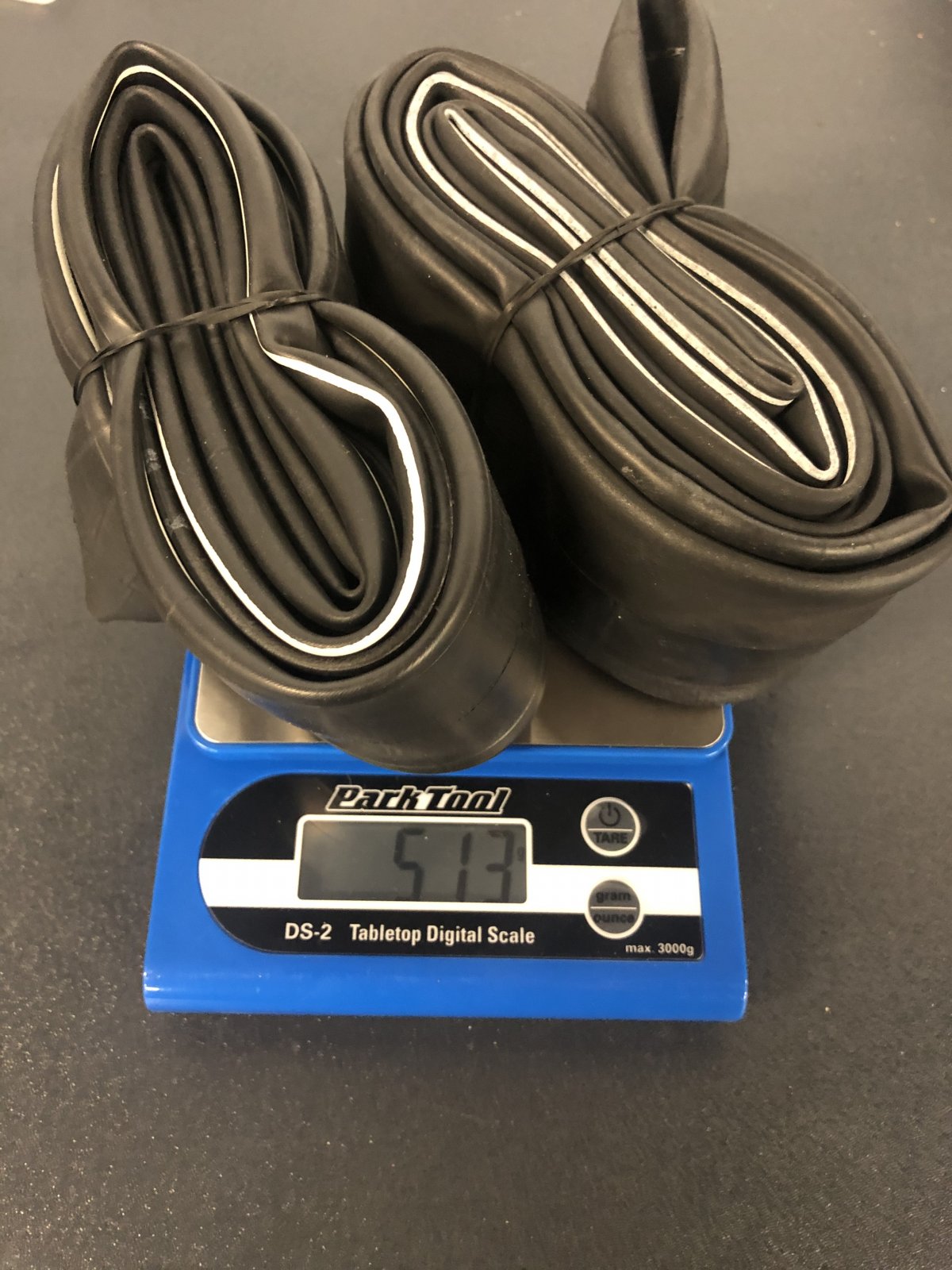

If they're the same as the 2020 levo fsr then you're looking at 2235g front and back. I changed the wheels, tyres and tubeless, it took 1.5kg off and it was a different bike. Could actually get the front wheel up.
I think best changes for weight weenie will be wheels, tyres and that NX cassette.
X01 Cassette alone drops 250g

Heck with a GX or better cassette a decent wheelset (even aluminum), you could add XC cushcore and still be lower than stock weight wise.

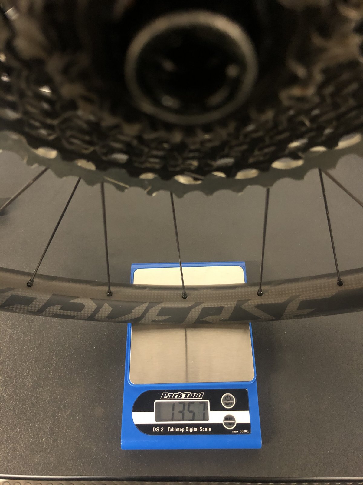

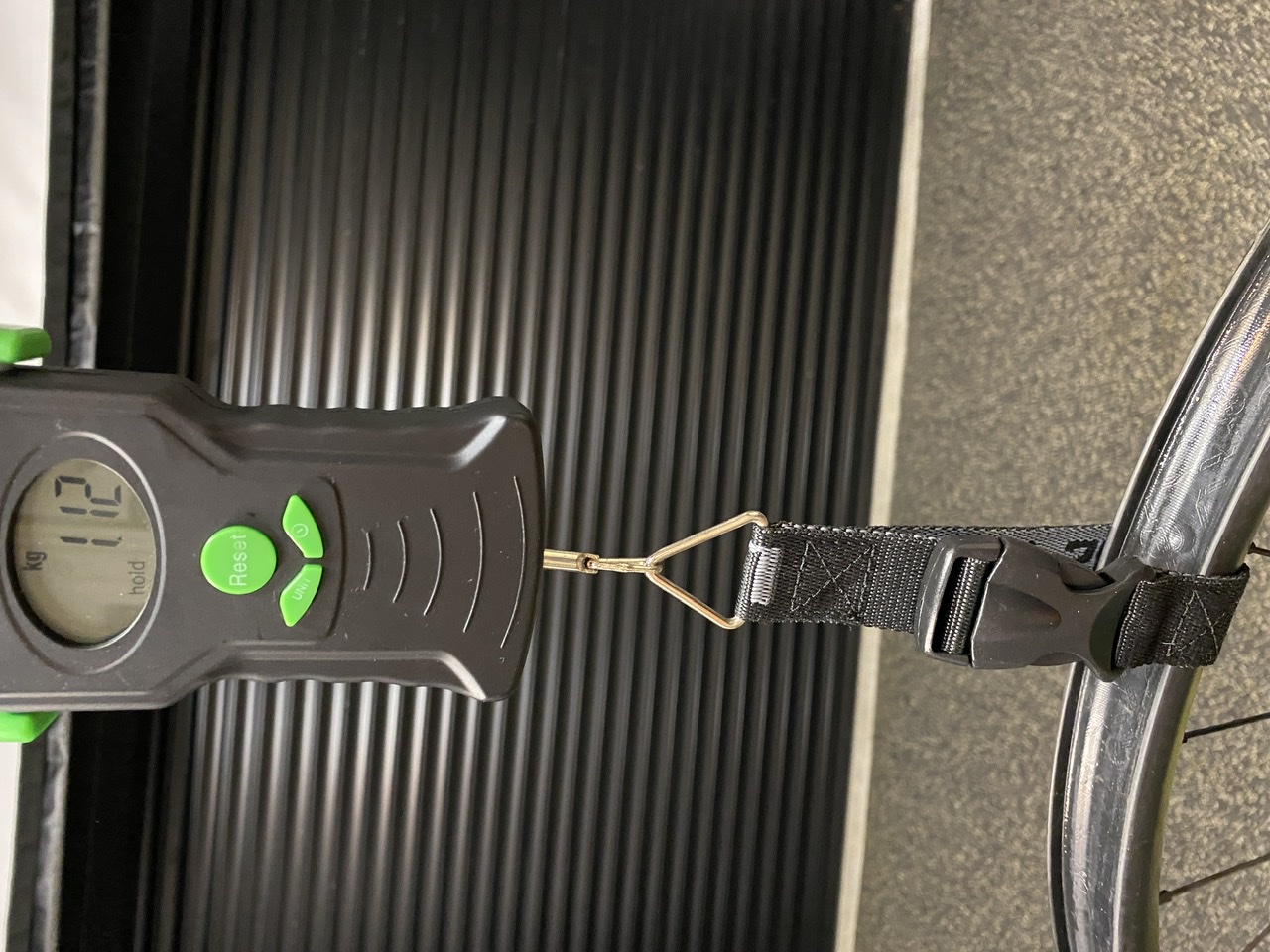

I’ve got the carbon Roval wheels with the Expert. I have the front with no tyre on it at the moment.
1.12kg with the SRAM 203mm brake rotor attached.
Mine are listed as 1800g for the pair on Specialized website - which is a 29 x 30mm inner diameter wheel. 30mm wheels are classed as Fattie now - whereas my 27.5 x 38mm were Fattie 3 years ago!
You can get 29 x 25mm Roval’s at 1360g for the pair. I’m sure other manufacturer’s do a lighter wheel though.

I putting a spreadsheet together with all these weights but the single biggest thing that jumps out at me is the tube weight.....at 500+ for pair of tubes it’s a no brainer to swap over to tubeless especially as the tape is already fitted so simple job to swap valves and buy some sealant. (for full geek on I’ve weighed the valves & correct quantity of sealant??‍♂️)

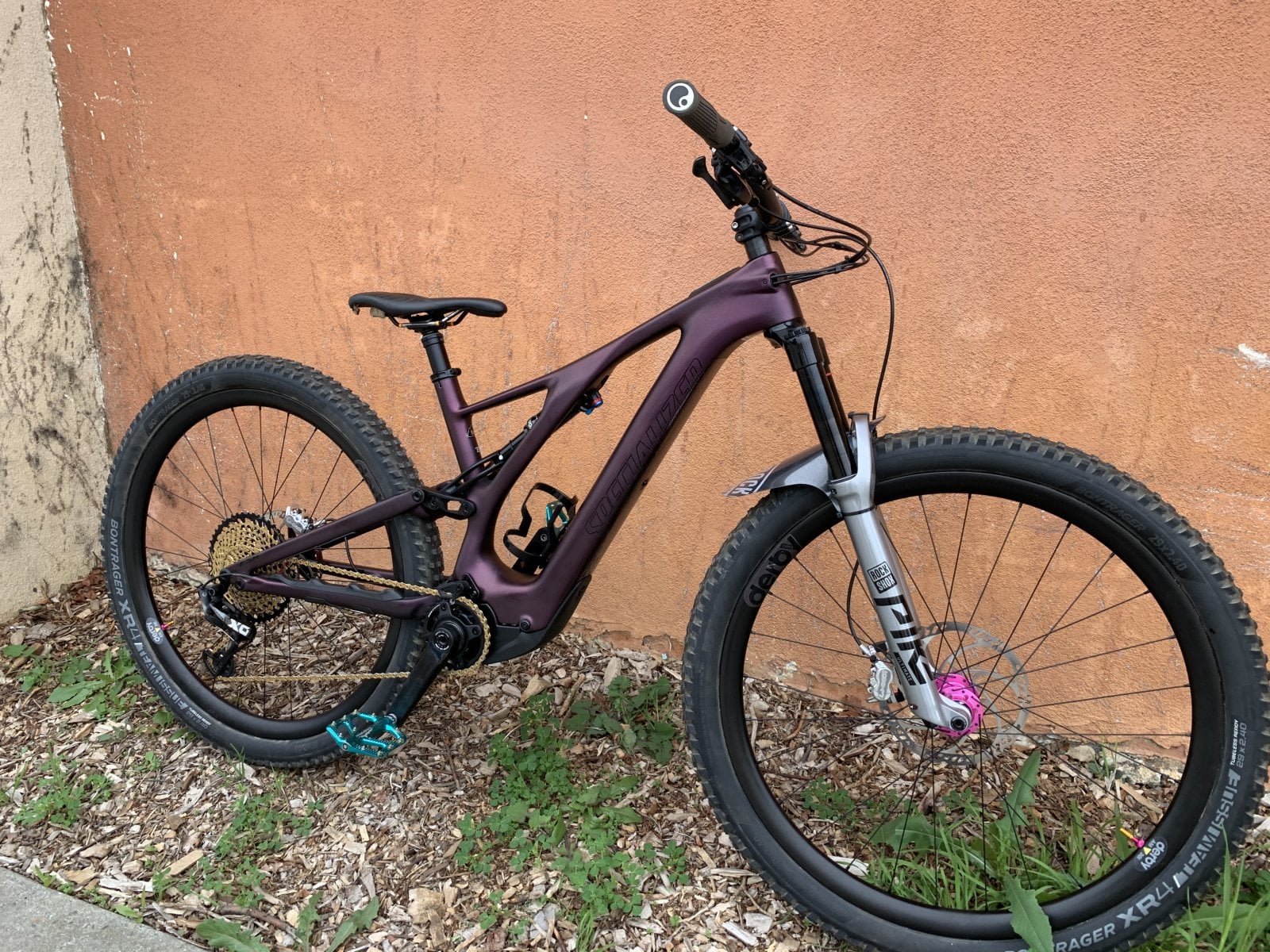

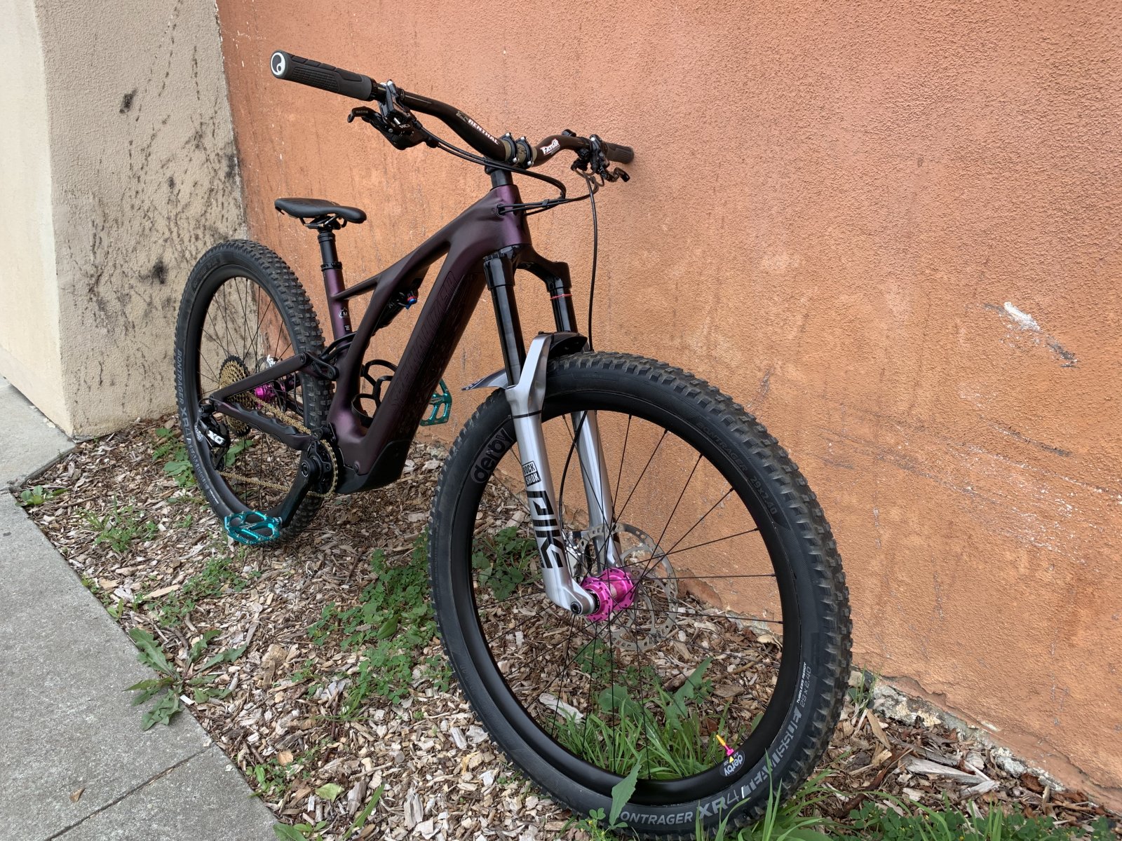

Sorry for the low res photos. Here are the photos again (full size). Size of the frame is medium. List of mods:
1. Renthal bars
2. Syntace megaforce2 stem 30mm
3. Magura 1893 brakes 203 front 180 rear storm discs
4. RS Pike ultimate
5. Derby carbon rims with project 321 hubs
6. Bontrager xr4 2.4 team issue tires
7. One up 180mm dropper post with wolftooth trigger
8. XX1 eagle cassette with X01 derailleur, XX1 shifter and XX1 chain
9. Sqlab saddle
10. Canfield brothers all mountain pedals
Does this build work our cheaper than an s works?

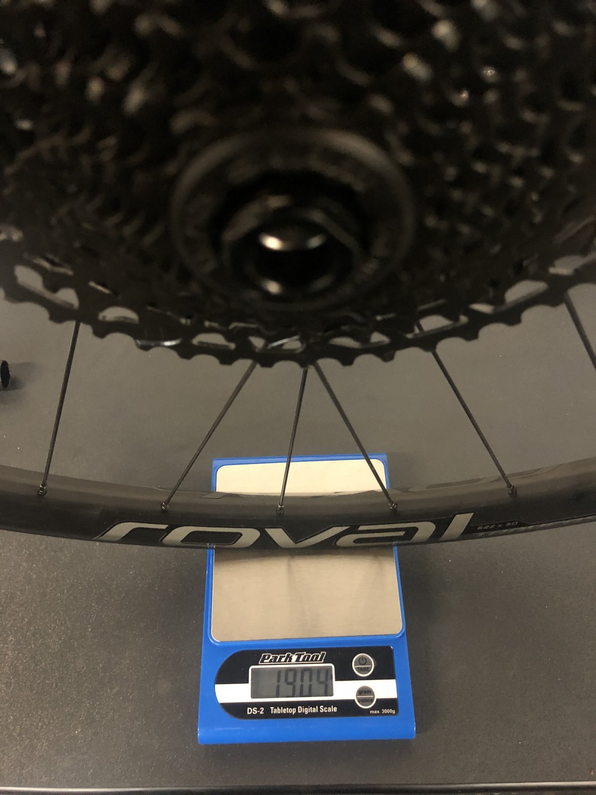

Haven’t weighed both wheels but rear Roval alloy wheel with NX 12spd cassette below, no tyre tube. Can do the other/both tomorrow if needed.
Wow, about 1300g for the rear wheelset? So both front and rear are what, 2,400+? That's a heavy wheelset! I think I'll be replacing them with a set of Industry 9 Enduro S Hydra's at 1,900g.
