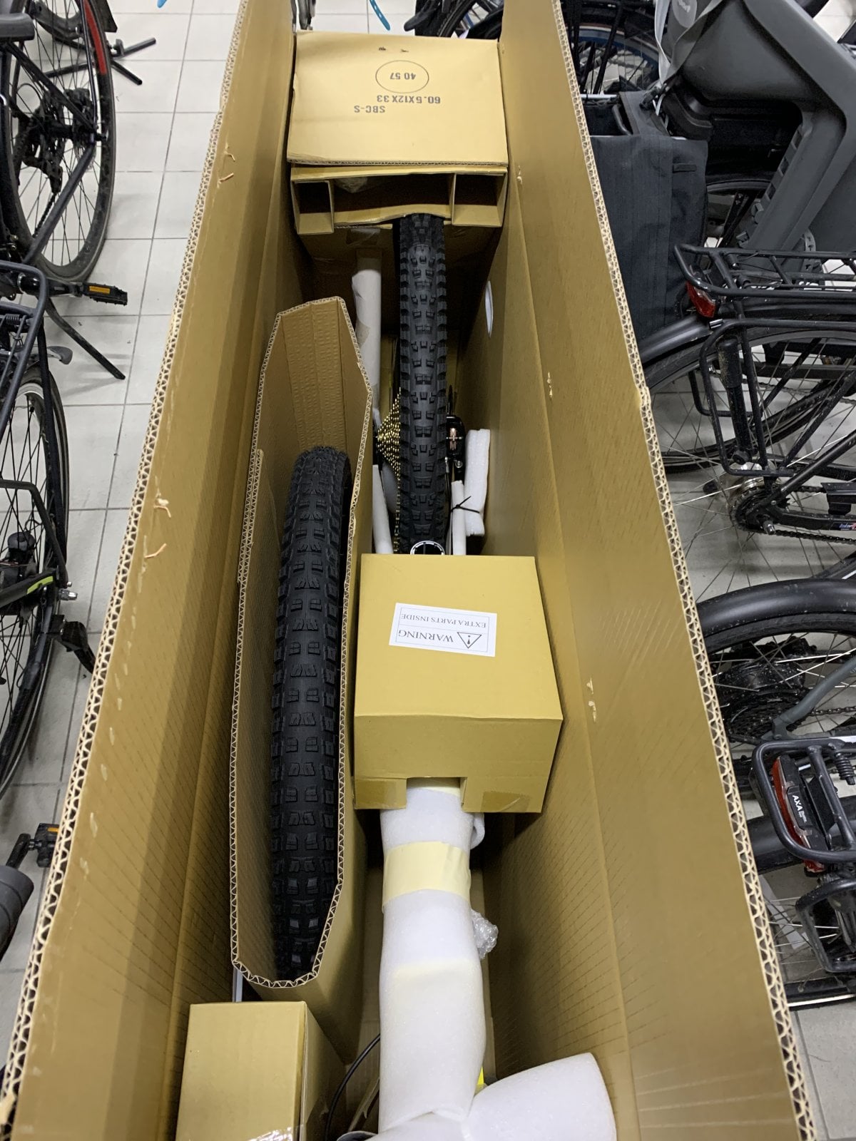

Today a box arrived at the bike shop with my name on It!! Ooh yes! Tomorrow I will assemble it myself. I'm looking forward to it.

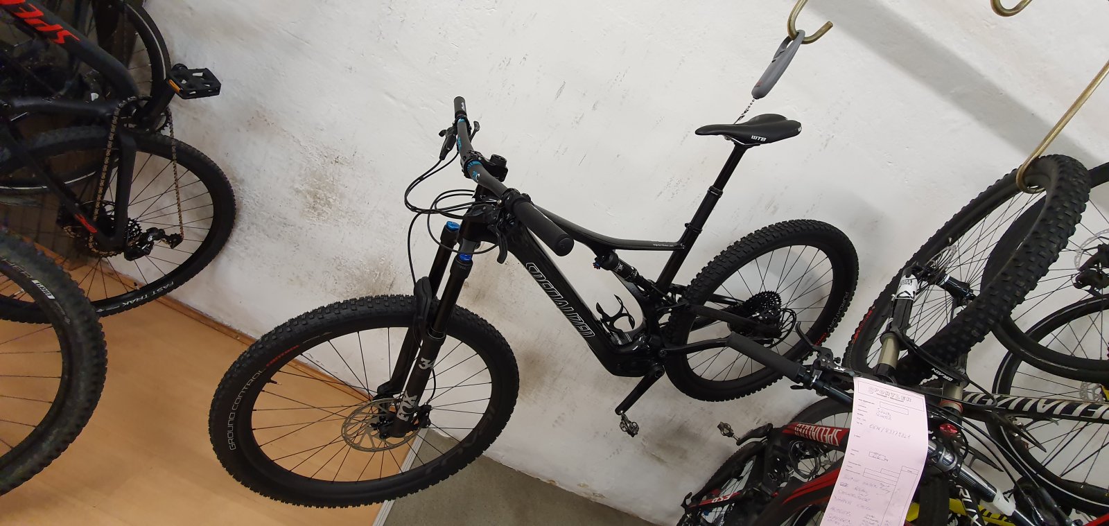

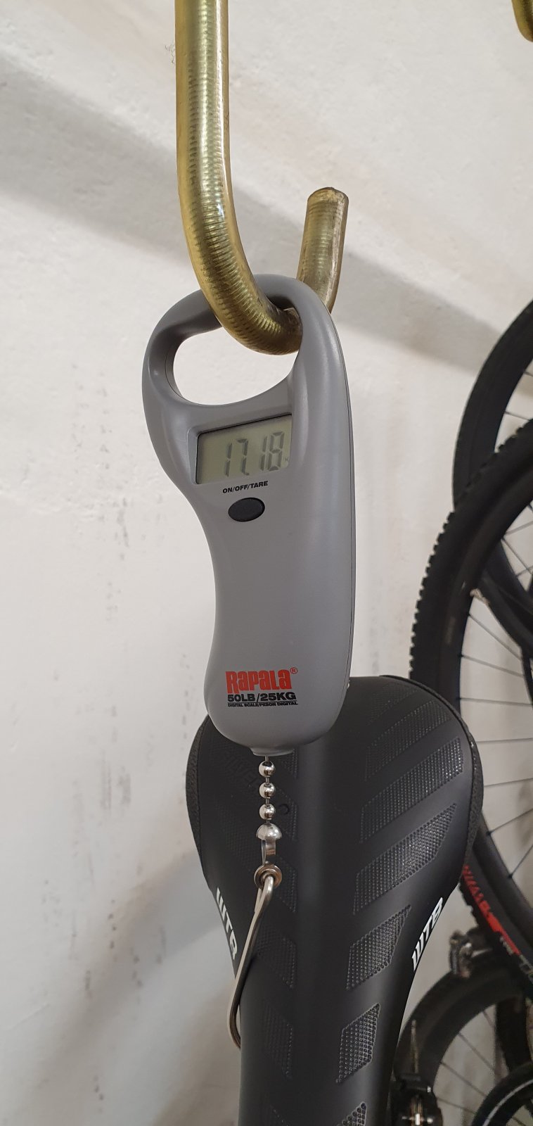

Great weight!
But...
I'm curious, did you put on the ground controls, foam grips and tiny SPDs just for the weigh in or do you actually ride those?
I love a light(er) bike but there's no way I'd compromises on tyres or control points no matter how much weight it saved.
The ground control and the purgatory work petty well, much better than i thought when i decided to try them.
The grips are fine, no problems with them, and yes, i ride the XTR pedals. I´m very used with them. Why not? The SL is almost like a Stumpjumper to ride, so no problem.
