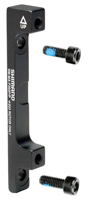

Swapping the front and rear brakes from SRAM to Shimano XT was a massive upgrade. You would need to get the following:
- two new shimano olive and barb insert kits.
- Shimano brakes of your choice.
- Shimano mineral Oil and Bleed kit.
- New 6 bolt rotors of your choice (203mm front and 180mm rear ice tech is what I used).
- Caliper adapter for front 203mm shimano rotor. Make sure you get the one in the photo. 203 rotor adapter.PNG
You need to cut the SRAM rear brake line at the lever and use a barb connector fitting (see photo) to attach an old brake line to the end you just cut and pull it thru to the rear swing arm. Then you attach your new shimano brake line to the barb on the old brake line and pull the new line back thru the swingarm and frame back to the bar. The barb has one left hand thread and on right hand thread.
- Caliper adapter for front 203mm shimano rotor. Make sure you get the one in the photo. View attachment 26707

XT's offer much better performance, modulation, much better stopping power with less finger force and les arm pump. It is night and day between the SRAM brakes on the carbon comp and the new Shimano XT 8120 4 pistons I installed. The actual work of swapping the brakes over is not "massive" if that is what you mean.

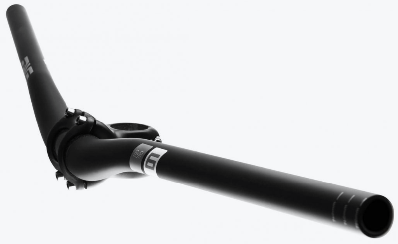

31.8 mm enve bar and 31.8 mm stem I bought three years ago...not sure the exact model. looks like the M6 stem in 40mm. I think the bar is close to 25mm rise like the M6 bar they offer now.
I've got the same stem, but 55mm I think - and the DH bars (which I think are now called the M7) Mine are almost 3 years old.
I removed 1 of the spacers from underneath and put it on the top. Will see how that rides, and then swap another if I need to. I'm on an XL, but haven't found the front end lifting any more than my 2017 Stumpy on steep climbs.

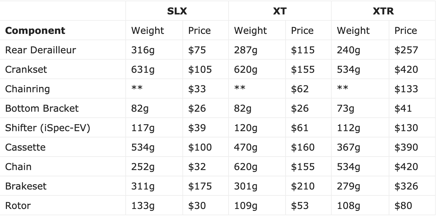

I thought to replace the brakes on my SL. The SRAM G2 ULTIMATE, 4-piston caliper by the Shimano XT BR-M8020 / 8000. Personally I think the XT brakes a lot better than the G2 but does anyone know the weight of the 2 sets and what do you guys think about replacing the Sram with the Shimano?[/QUOTE
New 12 speed groupset weights
XTR chain weight in your table is a misprint
as is the shifter
10 speed Zee shifter 120g (£22) 12 speed XTR is £70 (127g)
10 speed Zee R/Mech 270g (£44) 12spd XTR is £170 (242g)
Deore 11-36 Cassette 350g (£24) 12spd XTR is £200 (376g)
SRAM 1030 Chain 264g (£13) 12 speed XTR is £45 (262g)
overall weight is lighter than XTR and £103 Vs £385
*online prices
I honestly can't see that many people in the market for a super lightweight 37lb Eeb would ever need a 42t sprocket. Never mind the stupidly large 51T XTR has. and if you do it's possibly not the weight of the bike you should be looking to reduce ;)
