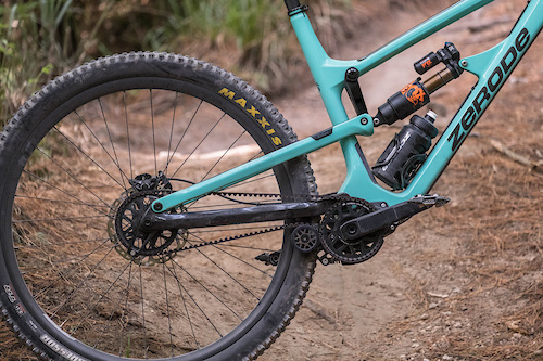

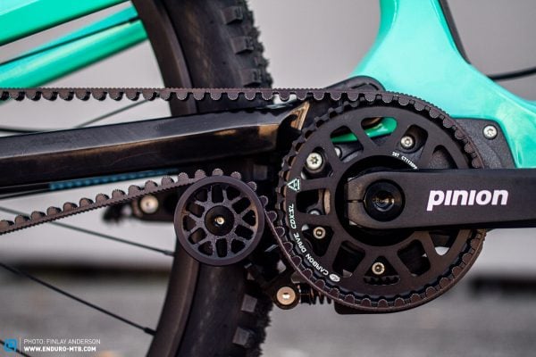

AND the tensioner… it’s placed same stupid way at Simplon and Bulls. Or is it only way to place it?
These bikes has low bb’s(i.e. vs Pole), that tensioner will have a hit with rock/tree at some point.

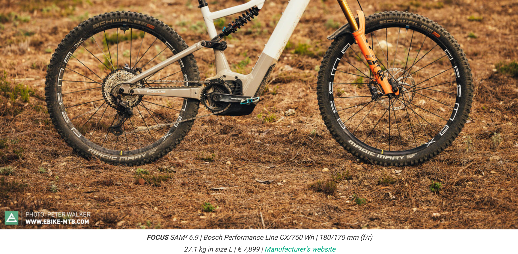

Yes you have a point there, I was wondering why that is also, with it's 25,3 kg it's probably scratching the no go zone for some people. While this is not an official Simplon weight but from the E-mountainbike magazine review I think we should wait until Simplon put the bike in thier configurator.

Although this weight is probably correct as the test bike had Magic Marys Super Gravity Super Soft tires and those are quite chunky.

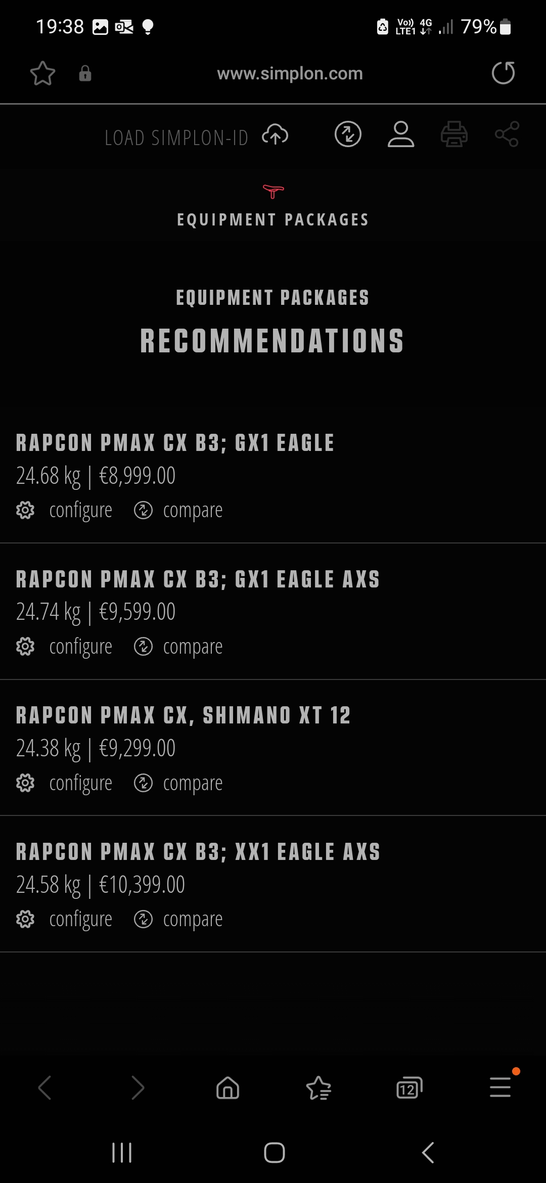

We were comparing the Bosch and Pinion system and the result was the Pinion one should be slightly lighter...these are the weights for the Pinion Rapcon CX bike...
It is about 500g lighter than the Simplon Pinion with the same tires(check in the configurator).
So there is a difference somewhere...will have to wait and see...
I love that idea with Pinion, but i think i will ride with my Levo(or new Levo) to the sunset. Maybe if Pole Sonni rebirths with Pinion i might change my mind.😁
The tensioner as far as I saw has a small bashguard behind it, although I fear that it's not up to the task of mtb abuse...on the other side It is sitting pretty far behind, close to the rear wheel, and the wheel being a 29er...I think it could survive...🤷‍♂️

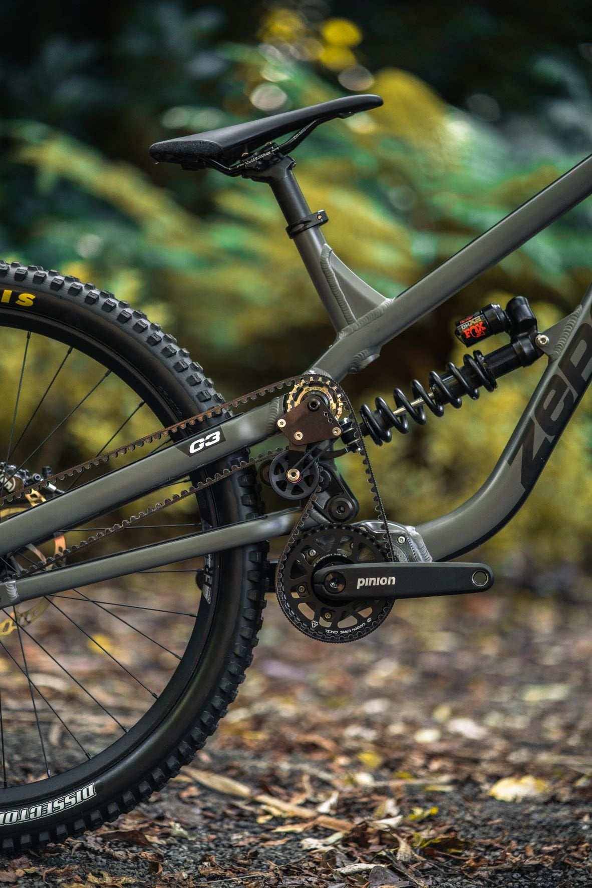

that tensioner.
It does look like a huge weak point in the whole concept !
I know they need the tensioner to keep the belt tension consistent through the full travel and maintain good wrap around, but it appears like it was just adapted from something lying around the office.

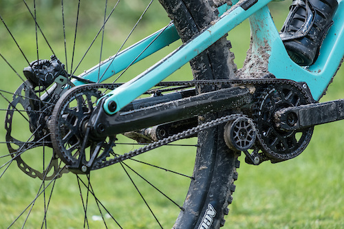

Kimmoi
Jul 6, 2018
391
386
Finland
This is from my Levo, i have new one now because that one in the picture cracked in the end.
Tensioner hanging there? :rolleyes:
