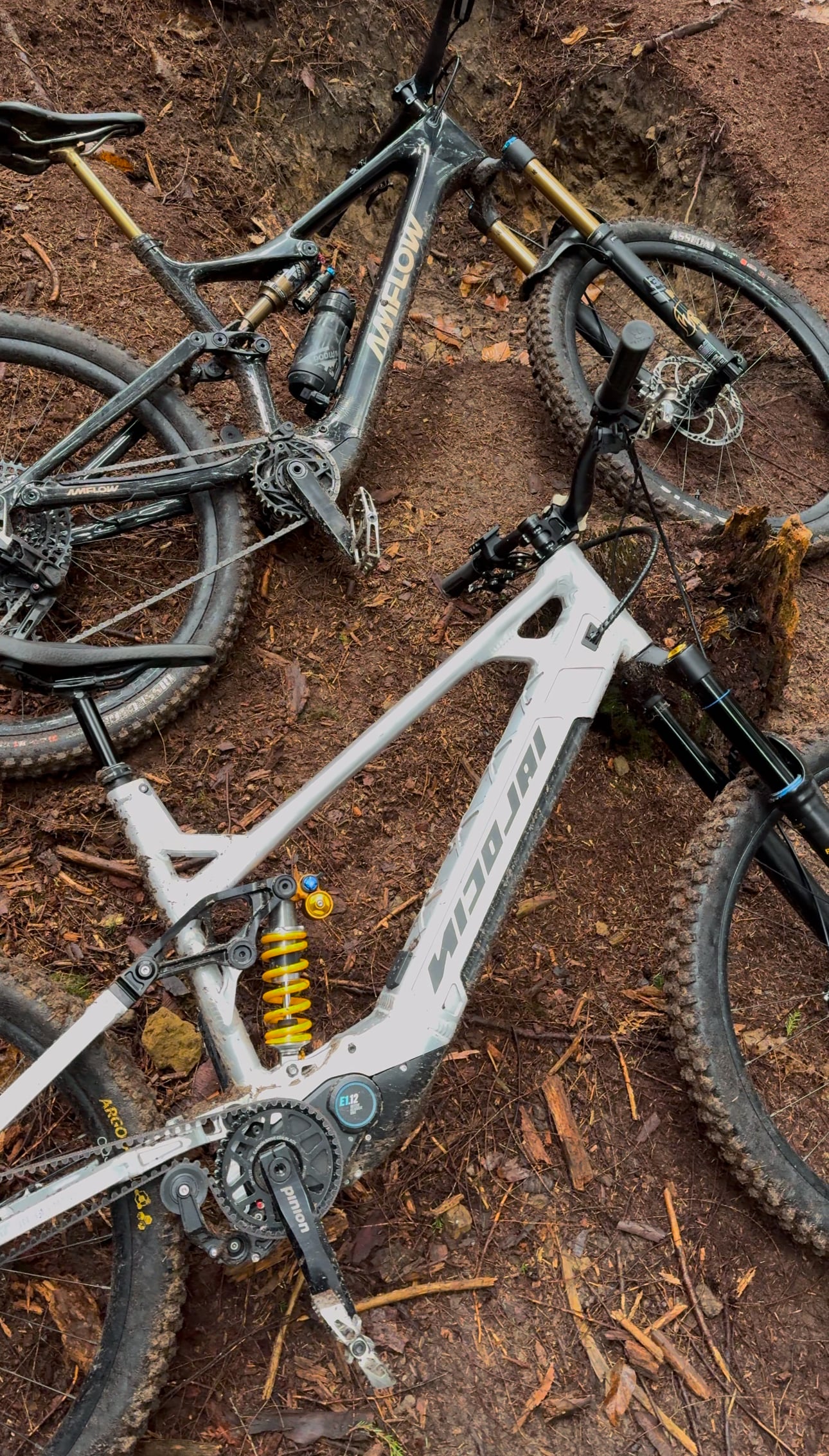

Rob Rides EMTB
Administrator
Staff member
Jan 14, 2018
6,292
13,850
Surrey, UK
By the way, loving this bikes handling. The suspension performance is incredible. As is the handling. It handles so much lighter than the weight suggests.
The rear suspension is so supple, ultra reactive and actually feels pretty playful, which surprised me a bit.
I’m running it as a mullet bike, I reckon the weight reduction out the back with the smaller rear wheel and tyre, no mech / cassette massively influence how the rear end performs.
Hitting enduro trails on the bike is so good. Ultra quiet, very good chassis and incredible suspension.
The motor noise still bothers me on gears 1-4. And it’s a bit clunky elsewhere. I’m getting used to it, but have a wish list for a V2 Pinion already!

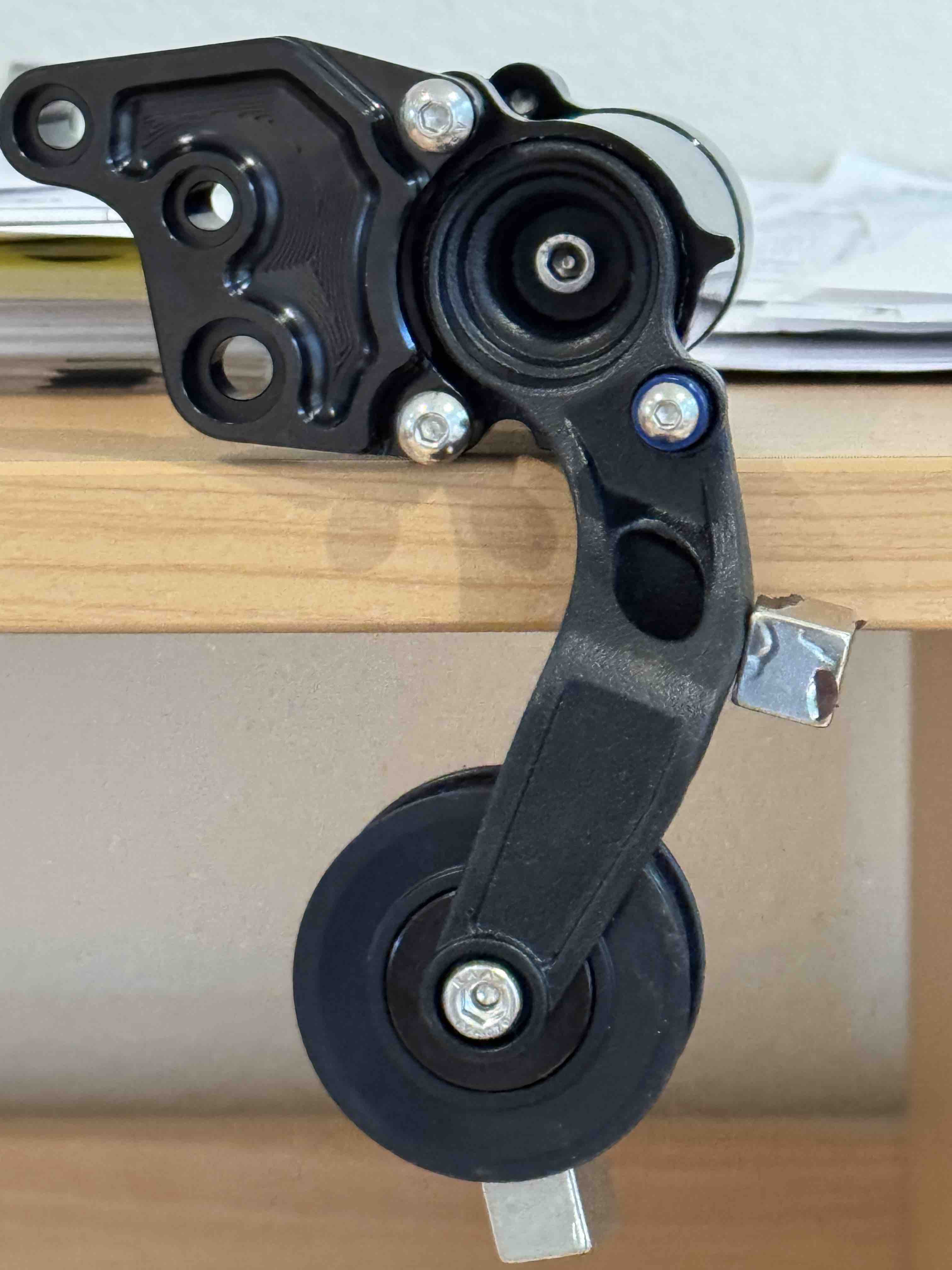

My bet is that this tensioner is provided by pinion, same as the crank?
Maybe Nicolai could have machined an AL one but as we mentioned it, casing this part on a jump and it could really destroyed the bike with a light piece.
As for v2 to me:
- tob tube integration or low profile controler
- noise
- tensioner more integrated. We could have a higher fixation of the pulley that does not go lower than BB
- wonder about an inverted installation of the tensioner or a high pivot / could generate drag so I do not know

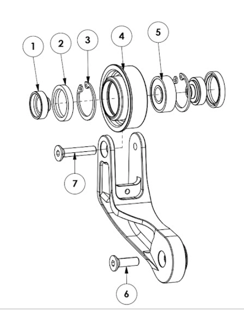

It is heavy isn’t it!

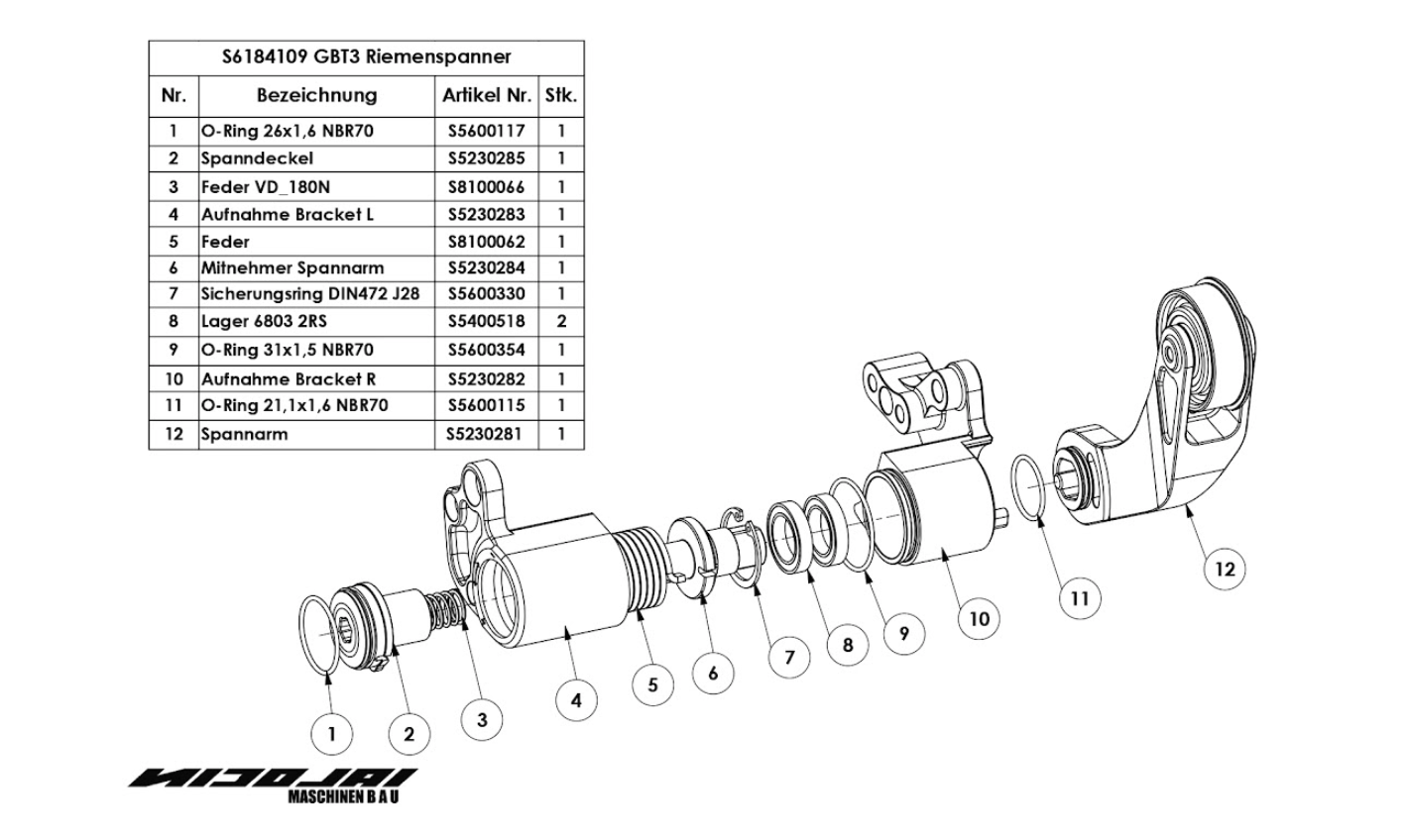

Wonder why they chose this material? I can only assume it’s for strength/ durability vs aluminium - it’s exposed under the bottom bracket so will no doubt be at risk of impacts.
I did some digging into this. It looks like this tensioner is second iteration of the one used on the GT1 EBOXX bikes. The original version looks like it had a CNC alloy swingarm and an external mechanism to adjust spring tension.
Also the prior version was unified - it consisted of 2 end-piece housing that were single pieces mated together that both housed the spring as well as provided mounting flanges.
This newer version (don't have a diagram) separates the spring housing from the flanges, so different flanges can be used with different models for their bikes (Saturn flanges or EBOXX flanges). This is clearly a more flexible design and would also allow a DIYer or other OEMS to craft their own linkage flange to outfit on other bikes. OTOH, this probably makes for a heavier design due to the extra attachments. As to why the the moved away from an CNC arm to a cast metal (BTW, I don't think its full cast iron anymore since the magnet weakly attaches) I'm not sure.

A lot to unpack here:
  1. This tensioner is not from Pinion, but rather from Nicolai partnership with Universal Transmissions.
  2. The Pinion tensioner that goes along with their own MGU (and their other gearbox products) is IMO a far worse design, as it sits keel-like under the motor, directly exposed to strikes and mud, not to mention an ungainly look.
  3. Nicolai is a better design and they know this - it's transverse mounted behind the motor (fully behind with the EBOXX and mostly behind with the Saturn) so it's out of harm's way. As such arm could be fully alloy. If anything, It seems over engineered.
  4. As you hinted there are other places to put the tensioner that could streamline the design - on the swingarm, on rear axle mount on the frame near an idler gear, but all this requires deliberate design work on frame builder. Frankly, Pinion should provide a better tensioner design that directly mounts to their motor.
  5. Something to think about - create a rear suspension with concentric rear axle path. That way you wouldn't need a spring tensioner at all. Because EMTBs have mid-motors this may require an idler gear configuration.

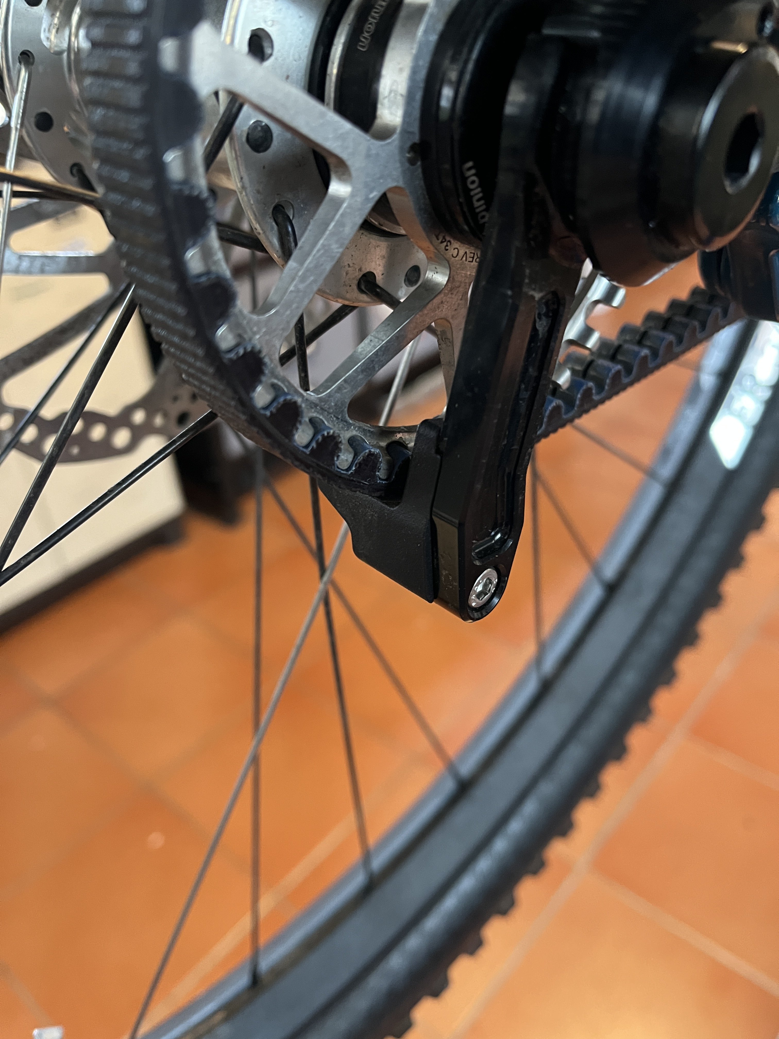

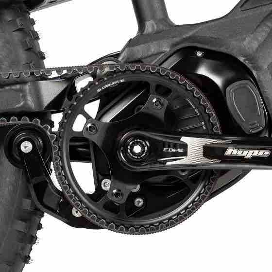

Has Nicolai bailed on the their proprietary rear sprocket? I see a snubber hugging the belt and full alloy rear sprocket on this bike.
Yes. When I collected the frame, I was told that customers reported belt squeaking with their "antiskip" sprocket, which led them to reverting to the standard one, with a snubber. I personally prefer the look of the silver one anyways and don't mind the snubber. Have changed the front sprocket to a silver one without bash guard in the mean time, too. Both sprockets are stainless steel though, not alloy.

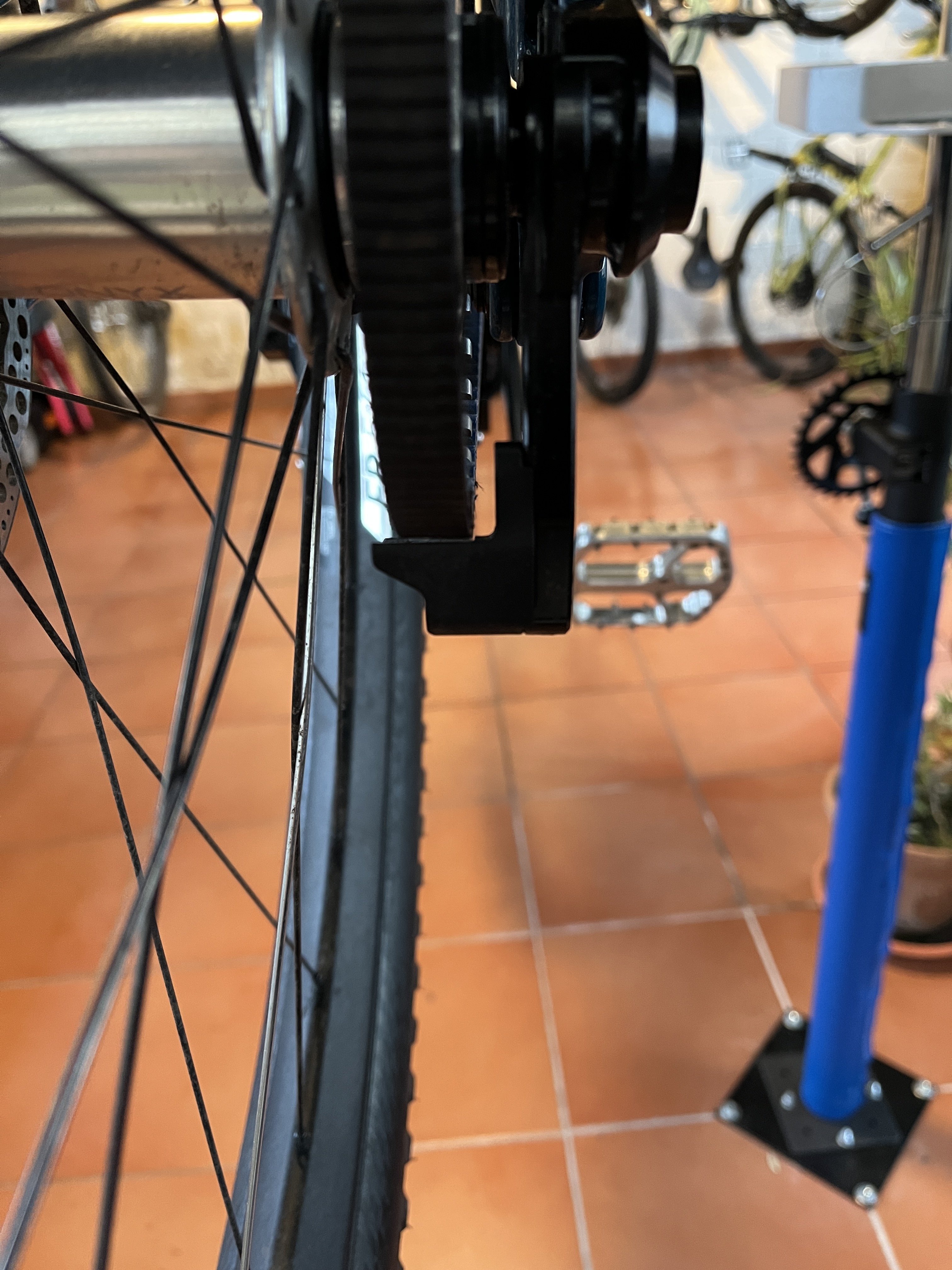

Sorry to hear about being laid up after the crash. Is it possible to get a close-up picture of the snubber and how its mounted?
When you get back into the fray of riding, I was wondering if you (or anyone else with snubber-configured version) run an experiment:
  1. Remove the snubber before your ride and take it with you.
  2. Ride the bike in various conditions (uphill and down) and see if the belt skips. If it skips a lot then put the snubber back on during the ride.
  3. If skips infrequently, then try turning up the spring tension on the belt tensioner and see if it stops skipping. Of course there is a sweet spot of belt tension for proper performance, but perhaps running a bit more taught might help.
The reason I'm requesting this is that the ratio of the motor requires a pretty larger rear sprocket at 32T - that seems like enough teeth to prevent belt slippage under tension. When using other internal gear transmissions like the Rohloff, the ratio is such that the rear sprocket needs to be quite small (like 20T). In this situation a snubber is essential as there is simply not enough teeth for the belt to cling to. But 32T and at a larger diameter MOA is larger, I think it just might work without one. Of course, belt alignment would need to be true and use Gates CDX belt.
A few more months at least before I get anywhere close to being able to try what you're looking for... but for starters, here's pics:
There is a tiny gap between belt and snubber, less than a millimeter I'd say. I can shove a sheet of paper between belt and snubber, but not much more. The snubber has some scratches already and I'd guess it is something that needs to be replaced frequently. However I too feel like the snubber might not even be necessary.
View attachment 153012 View attachment 153013
Thanks for snapshots. Since the snubber is just a bushing rather than an actual roller, It leads me to think that belt skipping is rare with this model. I don't think that would fly with something like a Rohloff, where the gear ratio of the IGH requires very small rear sprockets (18-22T).
One thing I can't quite make out from the pics provided: does the snubber mount at the thru-axle or off of a derailleur hanger?

It‘s not a derailleur hanger per se, but it reminds me of a UDH with a dropout specifically suited for the belt bushing/snubber. Bike is in the shed and the shed is really cold, so I will check tomorrow.
