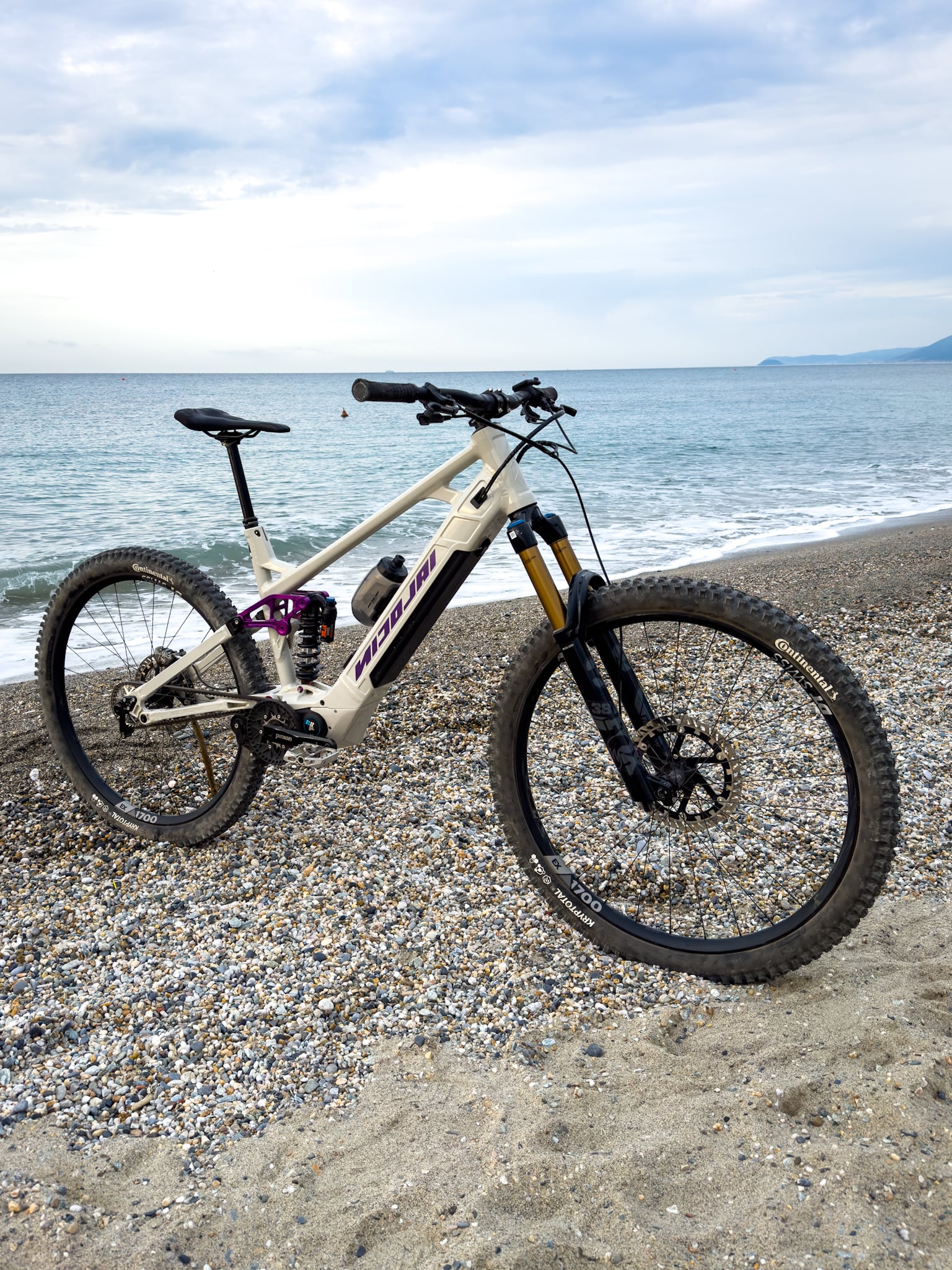

This sounds a bit goofy but could you wrap the mgu in some automotive sound absorption vinyl/foam stuff? I want this thing to work so badly…

Nicolai Saturn 16 MGU

You’re probably right, but we can dream! I hope you’re wrong though. I know Rob wants the same thing. If enough people voice what they want, they might well make it.
I think Nicolai is very much tuned to the market. Therefore, in comparison to 160mm market, there would be much less of the potential client base for the 190mm and up ebike, similar to the Pole setup.
Yes, some people would love to have one, myself including. It is all about what sells. Nothing more. Nothing less.
And since we speak about what we dream about, I would also want to have the 800W 45km/h MGU version available, purely for shits and giggles of it.
