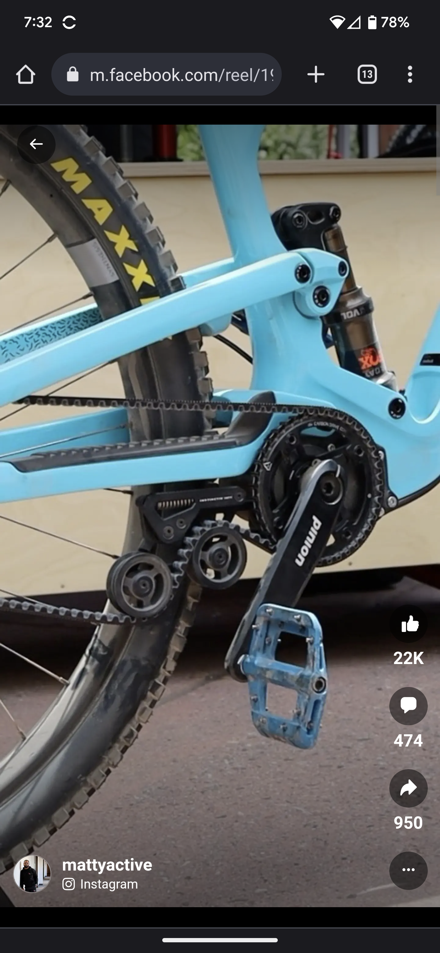

It seems like a whole lot of overthinking going on here. I’m sure belts will be fine. Rear triangles are not going to flex to the point of derailing a belt. Tensioners will be placed out of harms way and there will be options for chains for people that don’t want a belt. I’m just looking forward to having this tech arrive so no more drivetrain maintenance or damage happening. In the meantime, I’ll continue riding my Voima like I stole it! Whoo hoo!🤘🏻😎

It is a valid point that a chain has one a dvantage over a carbon belt............ie it has some sideways flex, and will operate when not fully inline. It may well be that other manufacturers pursuing the combined motor/gearbox design, decide that retaining the chain rather than a carbon belt is more suitable for a full suspension emtb. After all the chain would not need to be as narrow or eavilly engineered as a chain that needs to move over a 12 speed cassette so could be pretty robust, suffer less wear and be cheap to buy ( e.g a fixie chain). Alternatively they may look for an alternative belt design that does have some sideways flex.
Pinion can run with Chain OR belt, the Bulls bike with the motor has a chain drive so Pinion have already addressed the issue from their point of view. It is the bike makers who use the MGU that make the choice.

Just doing some thinking here...one thing that got me interested in the video was that he mentioned(also heard that before somewhere) the frame for the belt needs to be stif(not move sideways) for the belt drive or the belt could skip of the rear cog.
I wonder how that is going to work with an emtb, as sideway forces on the rear triangle on an mtb/emtb are significant. It is true that in those situations(downhills) usually we don't pedal, but anyway it could be a point to look at for the future.
There is the belt snubber at the back that is keeping the belt from skipping over the teeth, possibly also marginally sideways to the outside, but not to the inside of the frame.
One of the requirements for the beltdrive is that the belt line needs to be perfectly straight, any sideways movement can put excessive strain on it. Could this mean that belt life on emtbs is going to be shorter or more prone to damage?
There's been full suspension MTBs with belt drives for years without too many issues. My friend has a Zerode Kapito with 3000km on it and is still on the original belt and sprockets. Sure, there are some breakages out there, but there's issues with chains too. All in all there's a whole lot less maintenance with a belt.

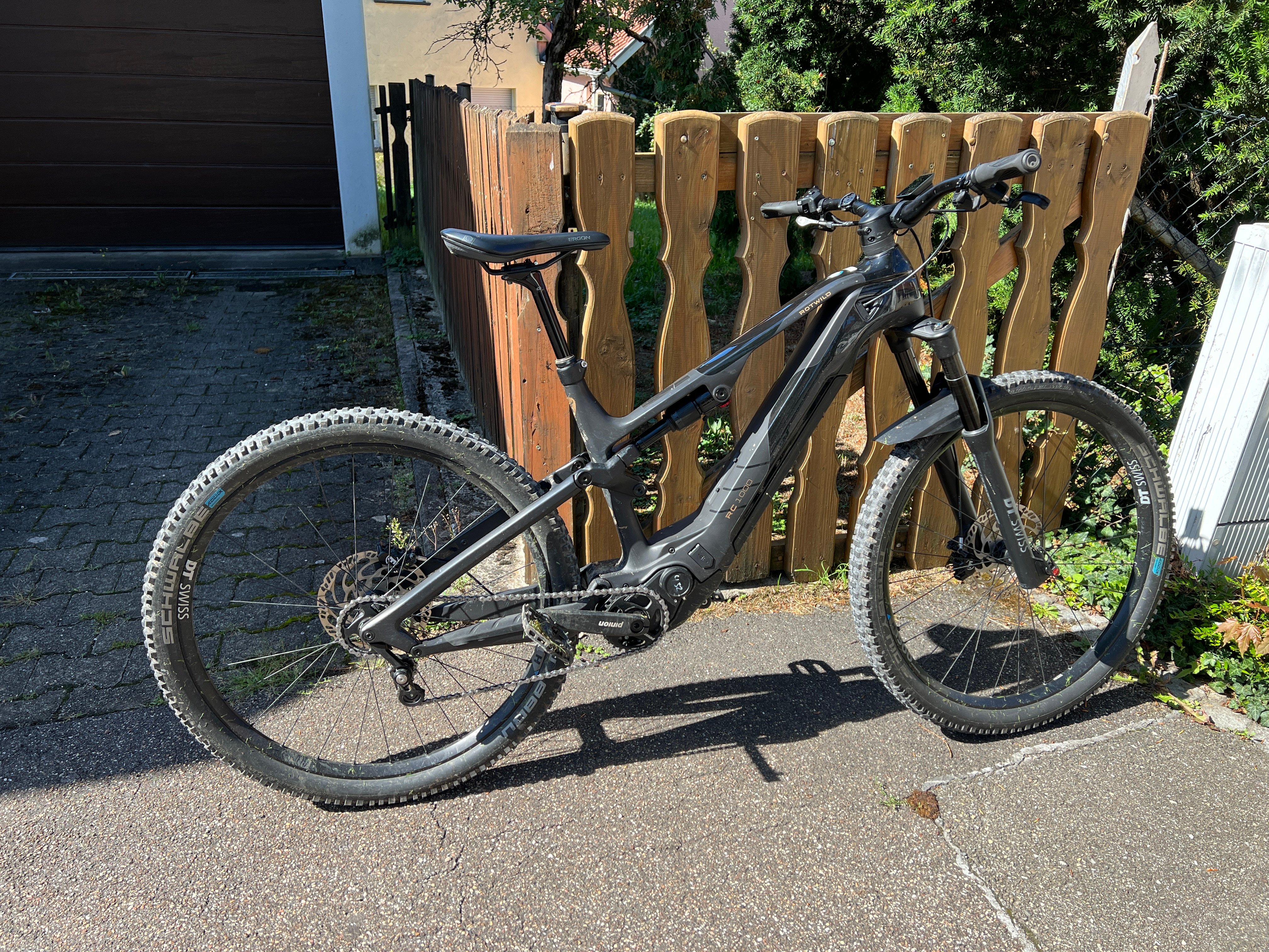

Been reading all the Pinion stuff and I think it’s a game changer. When I got my first eMTB I really wavered over splashing out on a used Nicolai with the Rohloff hub and Gates belt. That carbon belt is deffo the way to go for eMTB as it’s bomb proof and maintenance free, it’s just finding a reliable and waterproof gear and engine combo to suit it. Not sure why Rotwild paired a GMU with a chain but the Pinion and Bulls look ace. Started saving……
