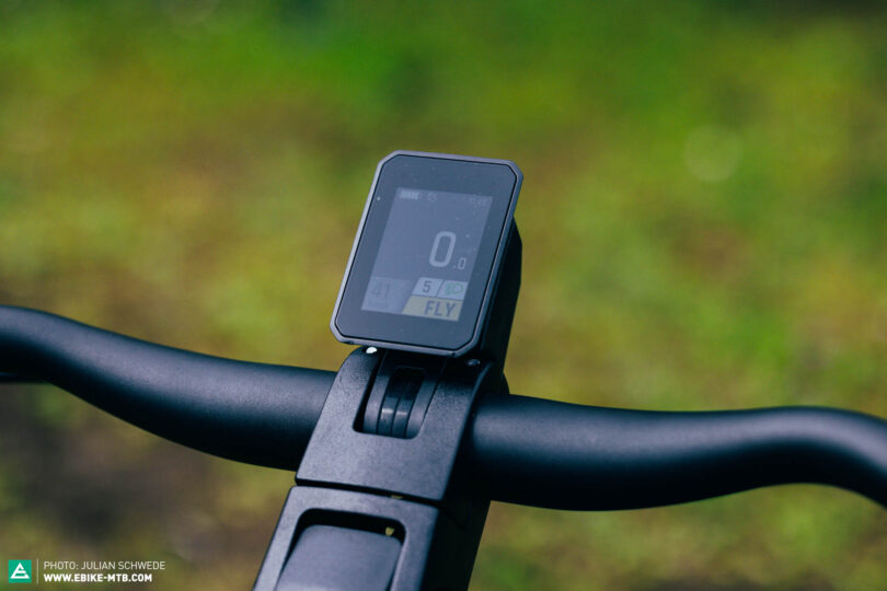

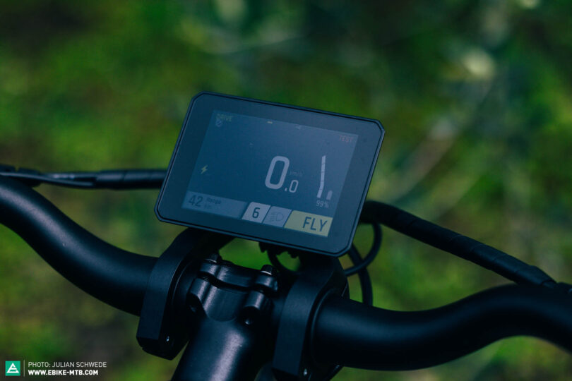

Are there any pics of the other screen options and how they're mounted? I'd be keen to get away from a screen next to the grips and have something a bit more minimal for changing gears/modes.

I put some images in the tech thread in motors.
Pinion MGU E1.12

Just after posting I saw some other pics in your first link in this thread, thanks!
I guess you are going to want to see what gear you are in, I just want to get rid of anything that's likely to break off in a crash, and the screen next to the grip is still a bit exposed.
Maybe they can have something like the shimano screen tucked behind the bars, or just a set of LED's on the top tube for the future...
Still, it sounds like a big move forward :)

I think they have an option for a top tube display and simple switch unit.

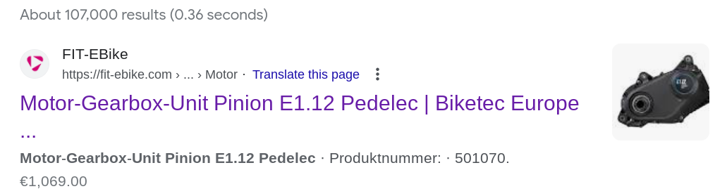

It's about €1069 . So ballpark about the same as a Gen4, EP8, Mag S.
But then you don't have to spend another €3000 on a T-type transmission for longish lasting and smooth shifting. OK, that's with the necessary bits and you could be cheap and just spend an another €1000 for your mech/cassette etc .. So it would still be about double the price of the Pinion.
Even if you went with a basic Deore setup, still cheaper or similar ish once you take into account belt etc.
