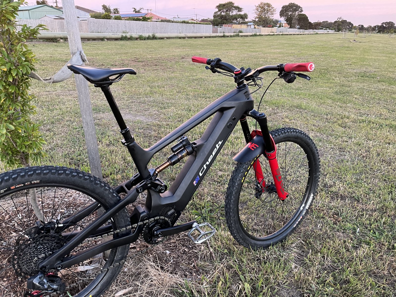

Finally got the frame and charger (the last piece of the puzzle to dribble in), built it up over the last two days and went for a quick ride around the block before it got dark tonight. Looking forward to a proper ride to test everything.

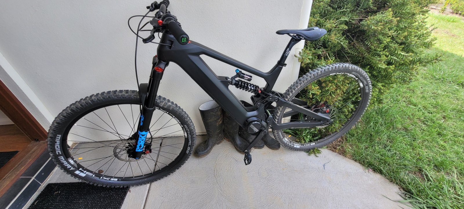

What a fantastic bike, also second day and wrapped!!
Not sure what it would be like without the power upgrade, but the power delivery is so ample and smooth.

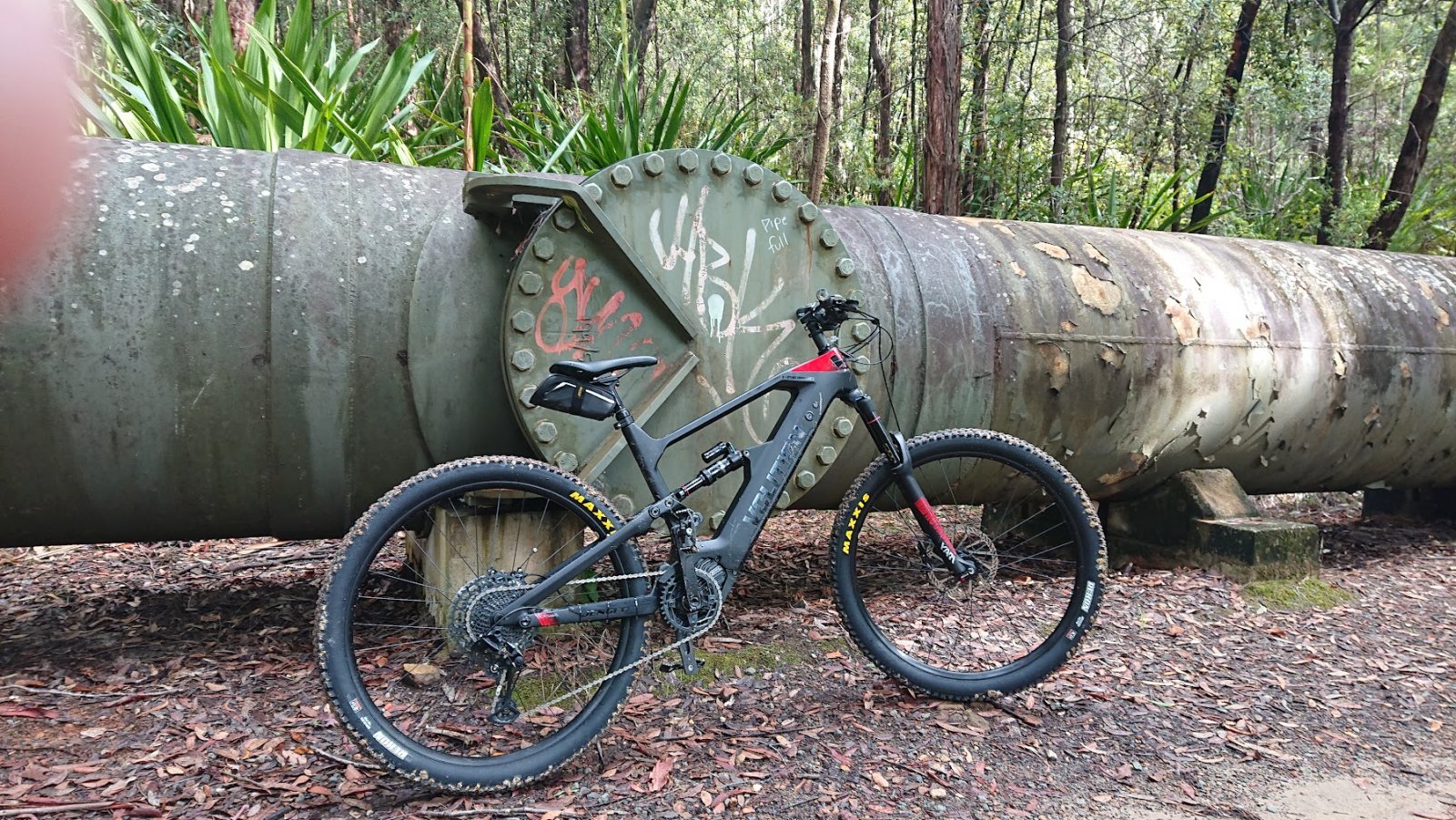

Finally got out for a shake down ride on mine and wow is it fun.
For anyone wondering mine is a very diy CHEEB V2 build. Mostly the best aliexpress can offer... brakes are def the first on the list to upgrade!
With the m600 I rarely need to move out of assist lvl 1! So much power.

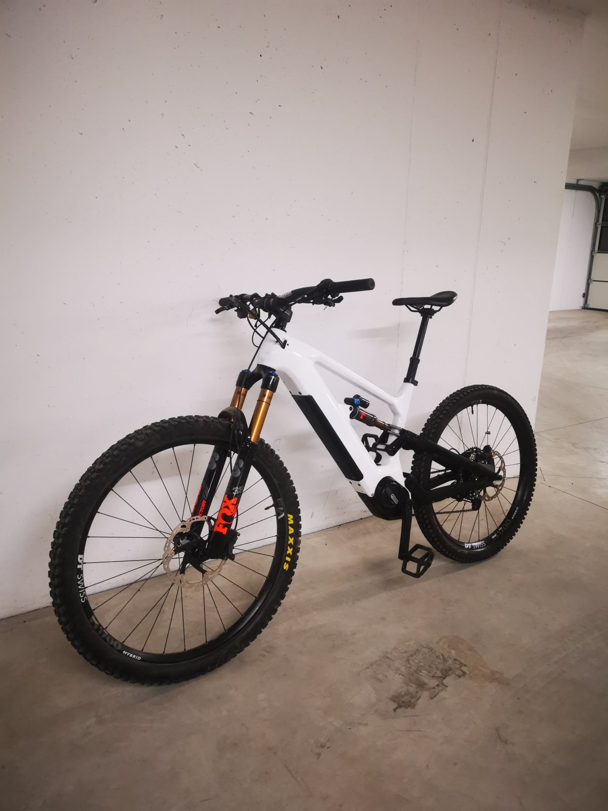

I have the DPC 241 (Bluetooth) Display. Contra: Hard to read, the smaller details I cannot identify while riding, generally difficult depending on light. Visibility is not good at all. Plugs getting loose from time to time, causing Error 30, no problem if You are aware. Clamp doesn’t fit to 35mm stem.
Pro:
Stealth look and safe place. Good menue and all information You need on one screen. Charging port for phone.
