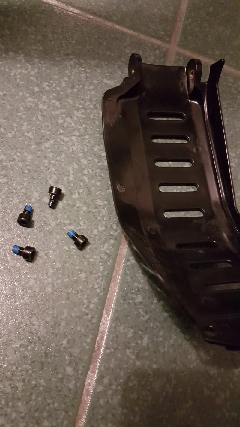

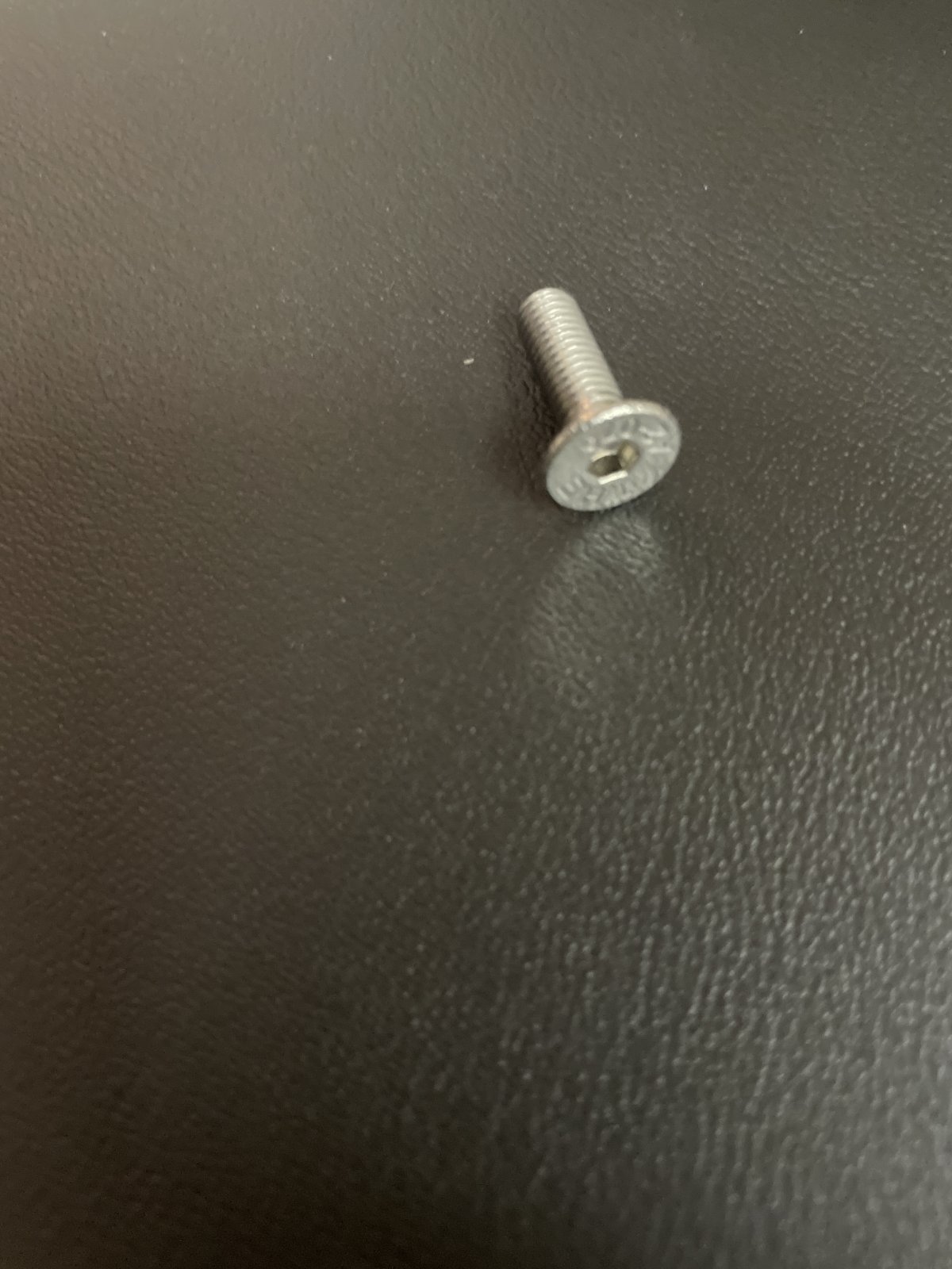

And yet another question, while trying to mount the lower crankcase, the only screws I have left are the four ones on the picture; but they don't fit. Where is my mistake ?
The two lower ones fit, the two upper ones do not - you need longer ones and with a different head.
I had the same problem

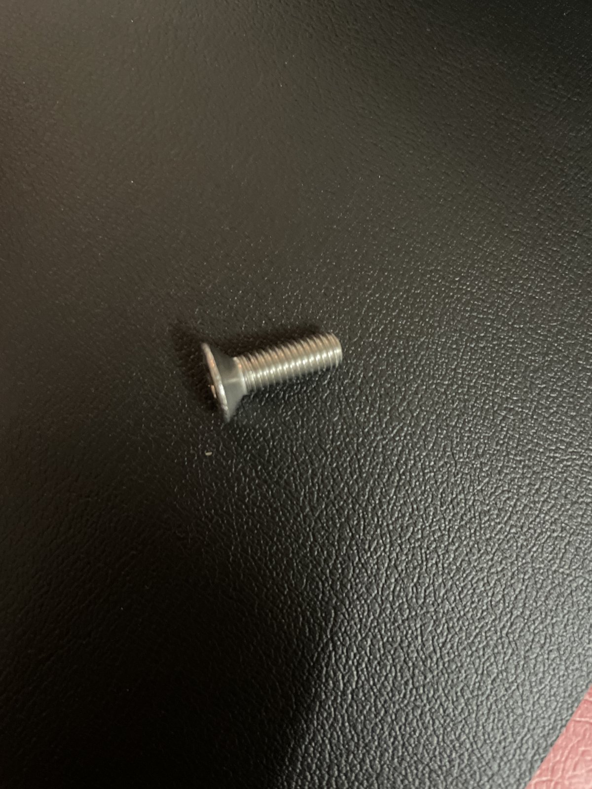

Not Your mistake - its Dengfu‘s mistake! You need 2 M5 Hex Screws with sunk head. The other 2 screws will work.

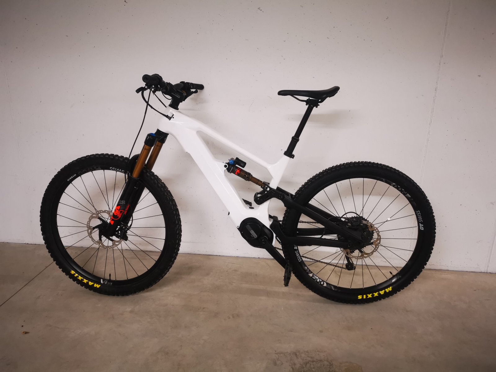

Feck that! Never painting a frame again ? A lot of work. Also I like the slab grey Zeb / purple contrast ?
Hi Rob,
On V1 Cheeb, now many cans of spray did that take you? I see they sell kits but wondered if it took you 2 or 3 kits, (one base, one colour, one clear per kit)? It's obvoiusly hard work and time consuming. I used to do cars.
Rob Rides EMTB
Administrator
Staff member
Jan 14, 2018
6,292
13,853
Surrey, UK
Hi Rob,
I think I bought 4 cans but had a can left

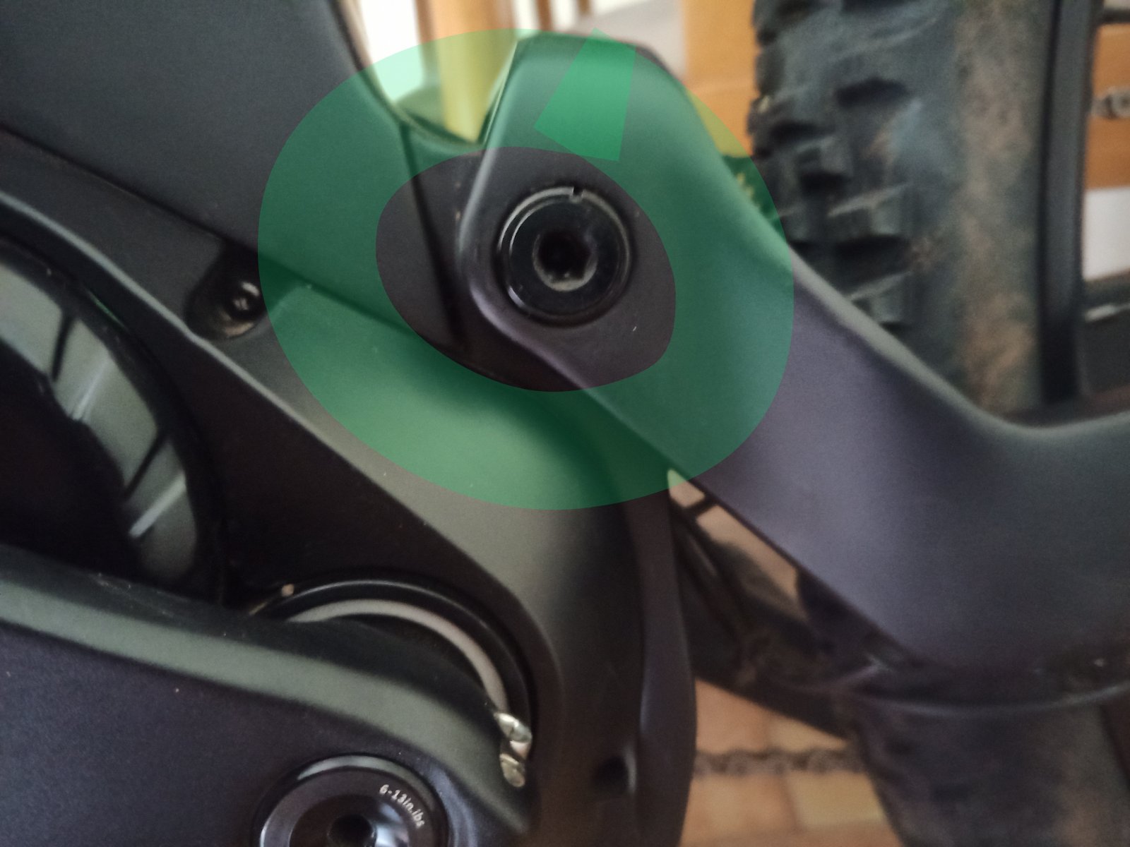

Question re:
What torque should this be?
Also, at the other side, should it look like this (threads showing) or is there a part missing?

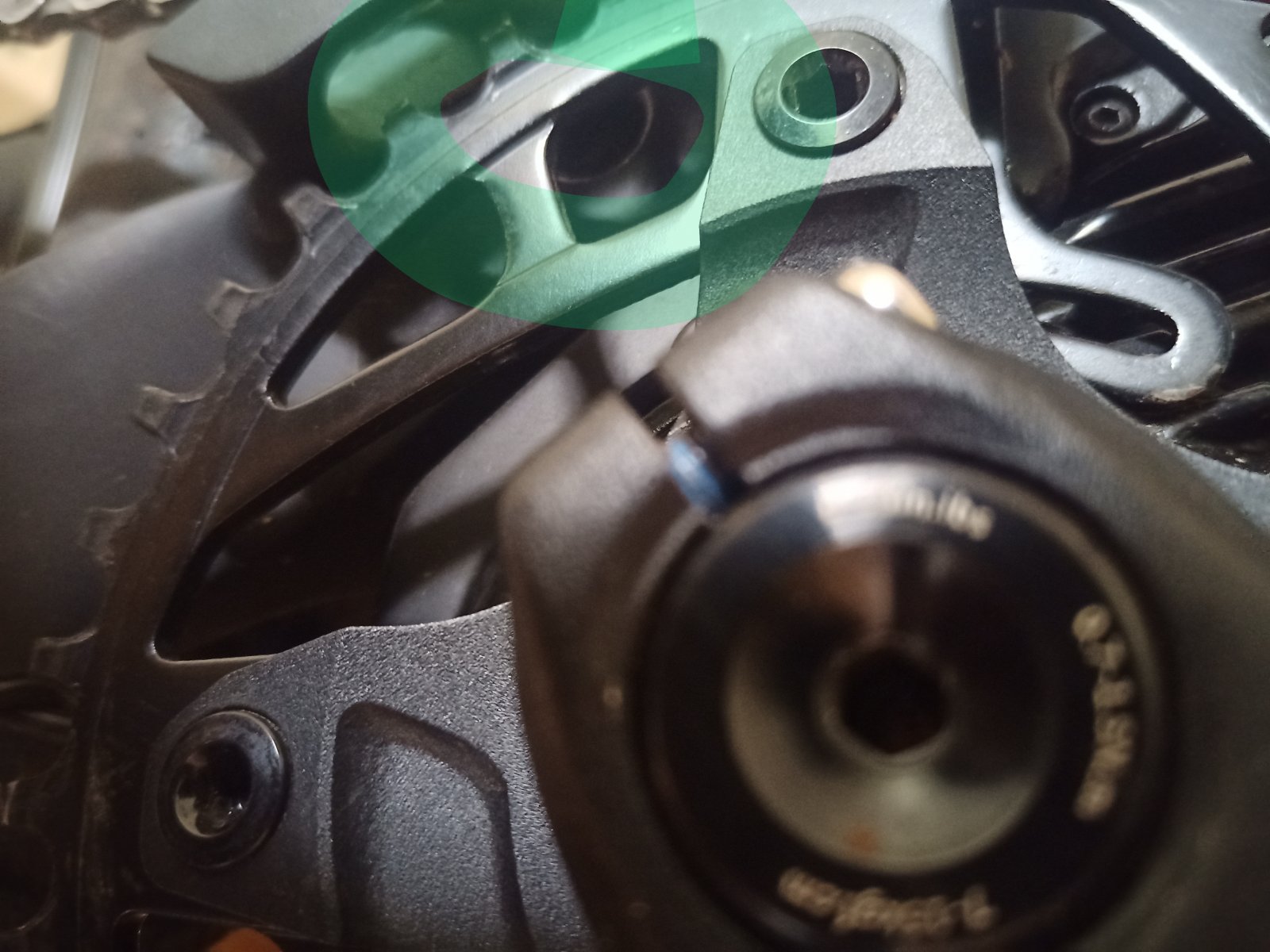

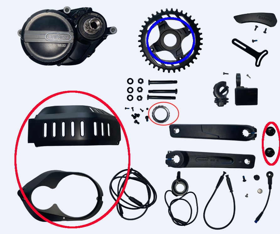

I'd like to buy the spare parts on the schema. It seems bafang won"t sell the part in the blue circle separately from the chainring.
Do you know elsewhere I could buy such corresponding part ? (I don't even know how to name it) I would like to find a lighter one...
