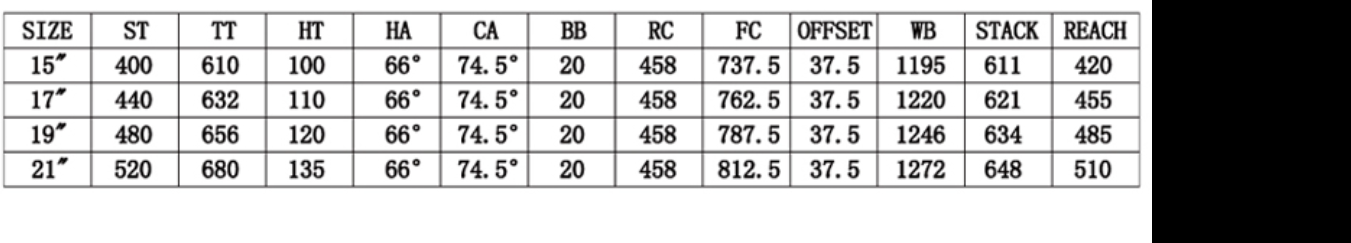

some of you around 1.80m tall what frame did you pick as a size?A friend of mine would love also dengfu e10.I gave him to try mine, but it is too big for him.So what would you advice 19 or 17 inch frame.I am thinking the 17.He tried in the past my kenevo xl and it was also big for him.So in my opinion the kenevo xl 2018 is like 19 inch dengfu.What do you think?
I‘m 183 cm and the 19‘“ fits perfect with short 40 mm Stem.
I'm 171cm and I ride a 17" and its a perfect fit. I based my frame size on the "Reach" measurement if thats any help.

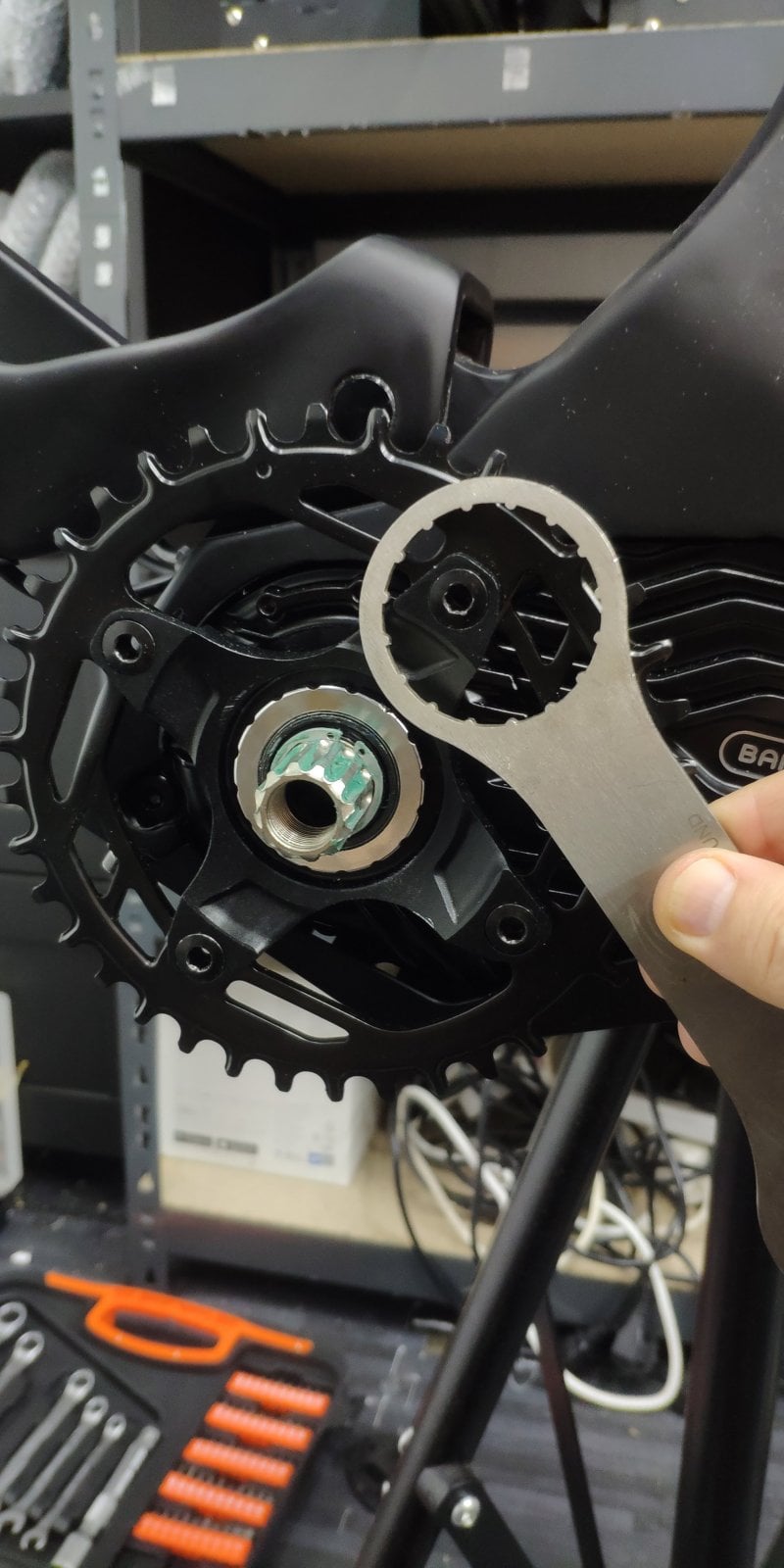

So im getting towards the end of my build but im at a loss on how to install the chainring. I even have the Bafang wrench but that wont fit in the chainring, seems like I need a socket for that. Any suggestions?
