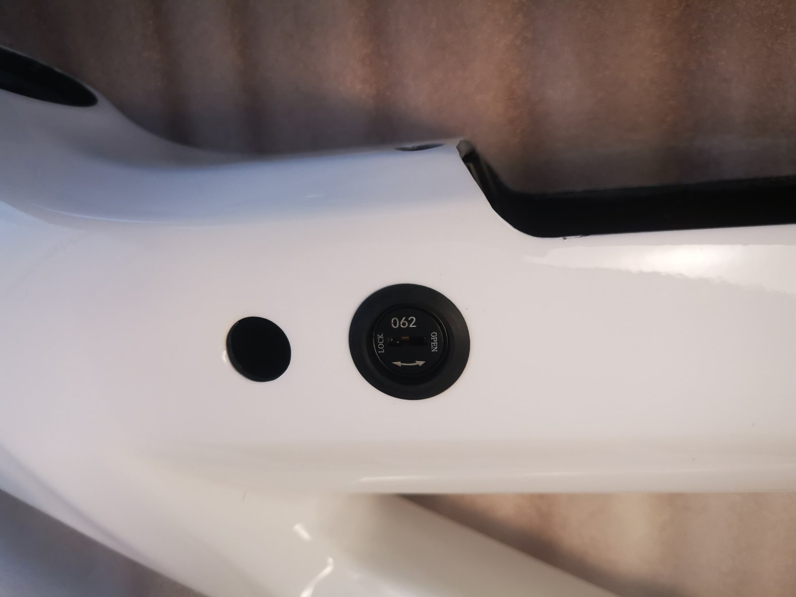

did you mean the circle beside the key slot?

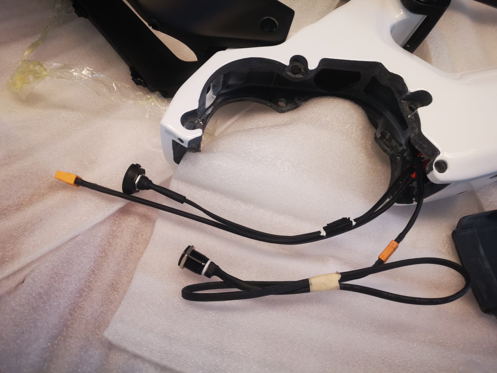

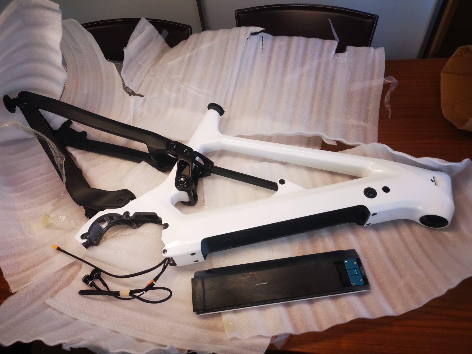

Hi guys, finally motor arrived. Can anyone tell me what thias part is for?

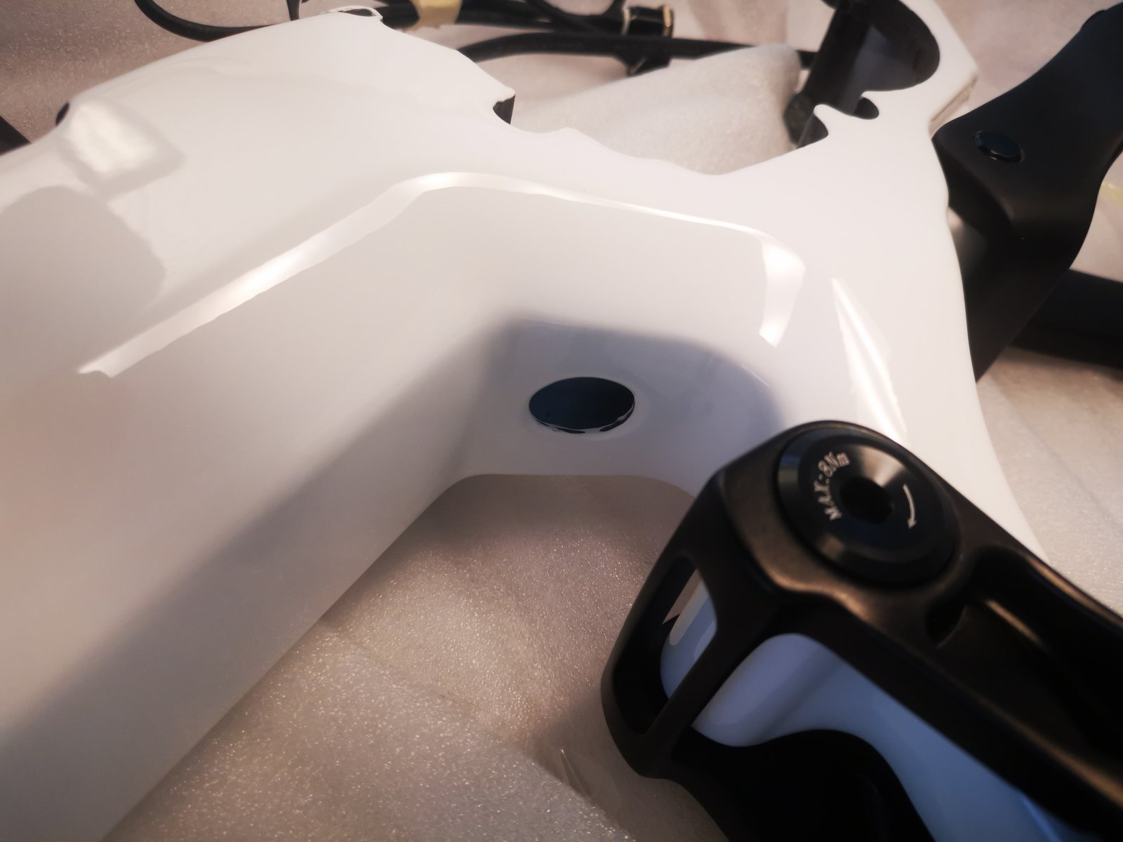

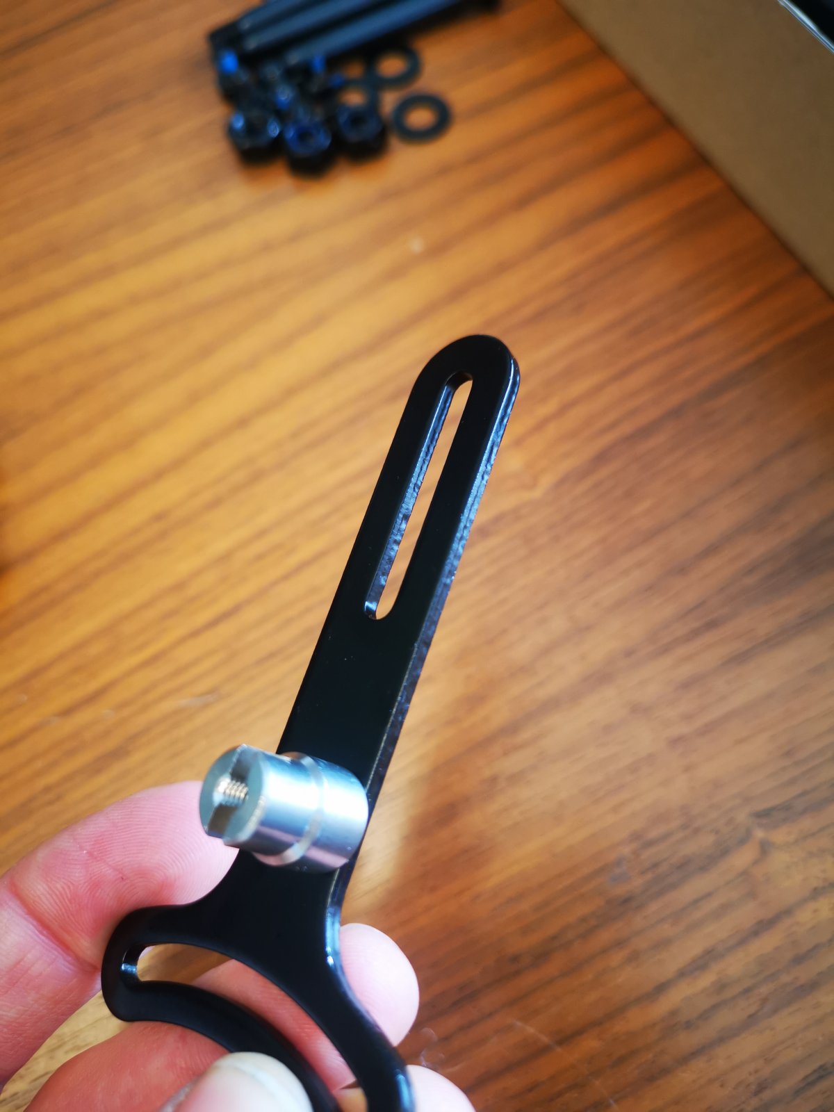

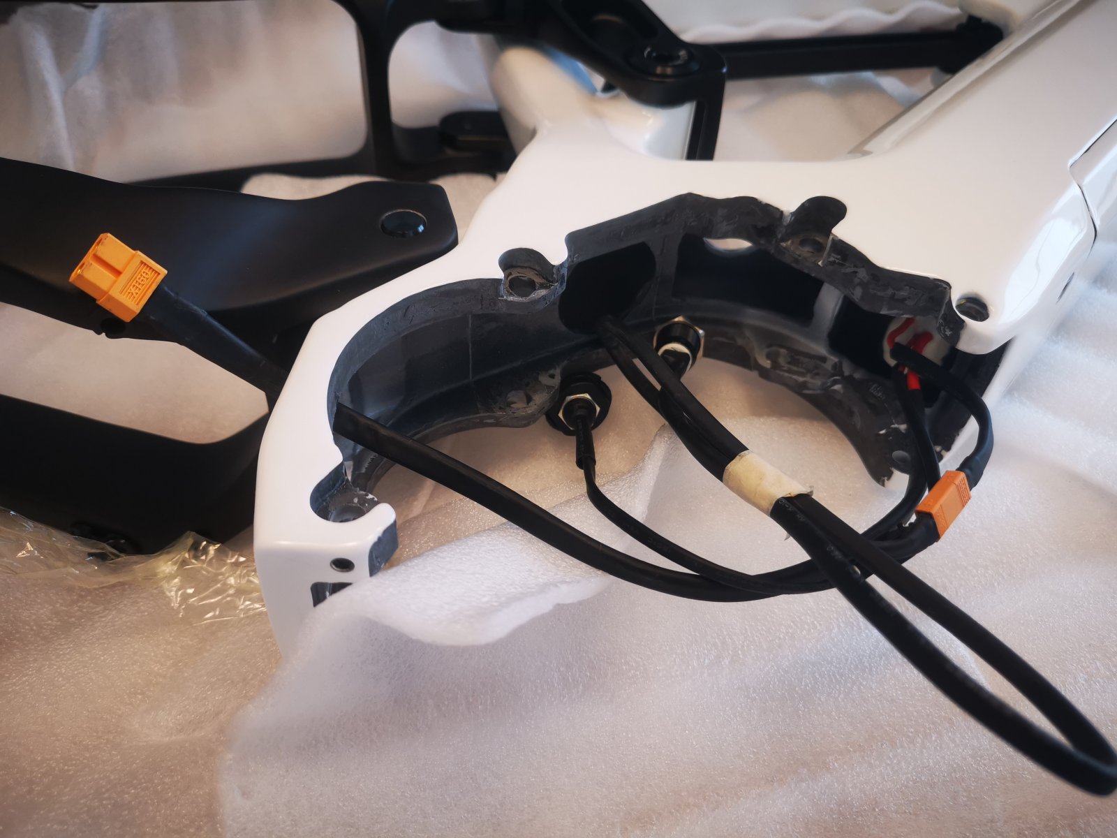

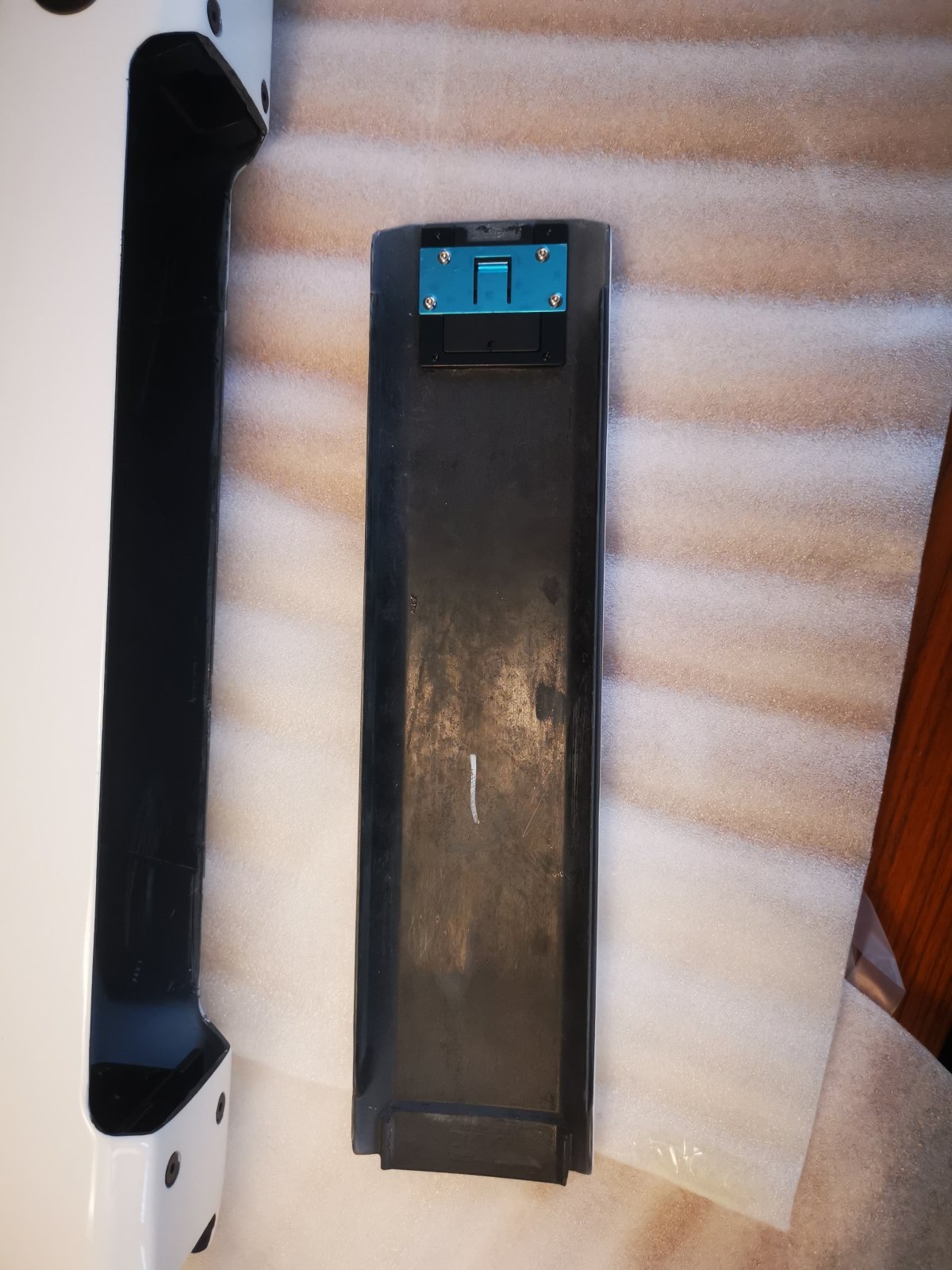

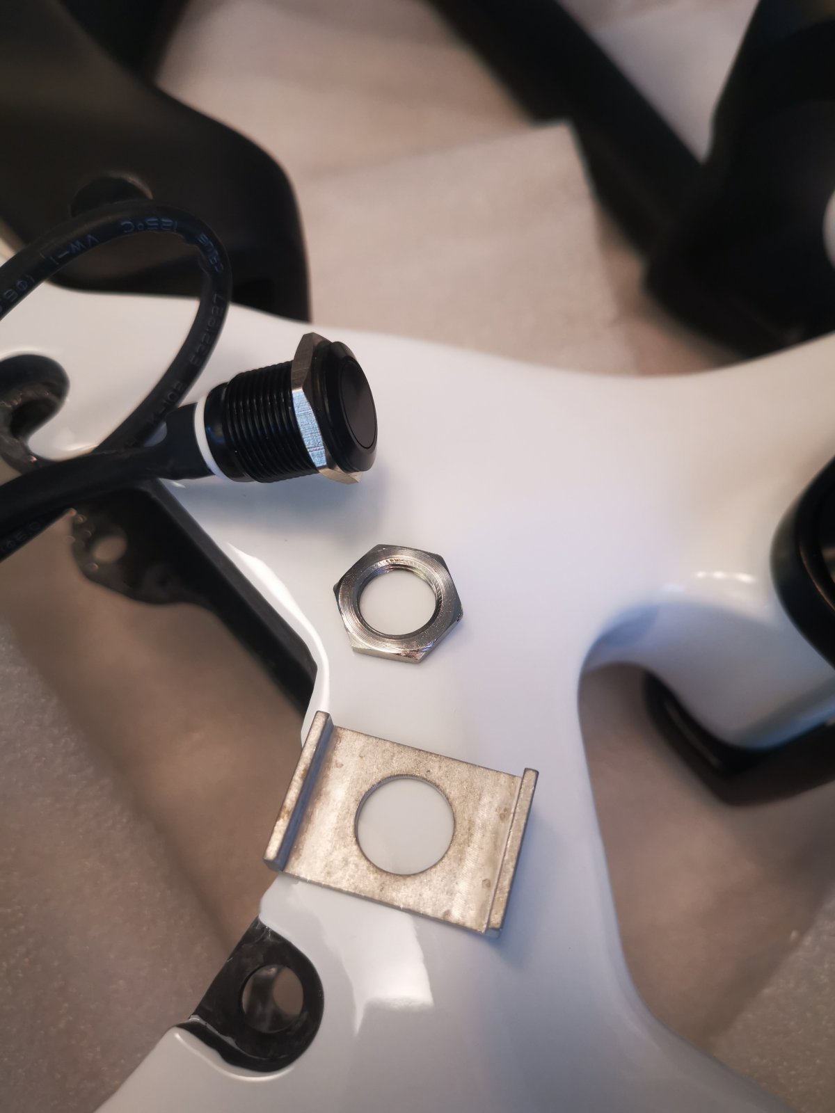

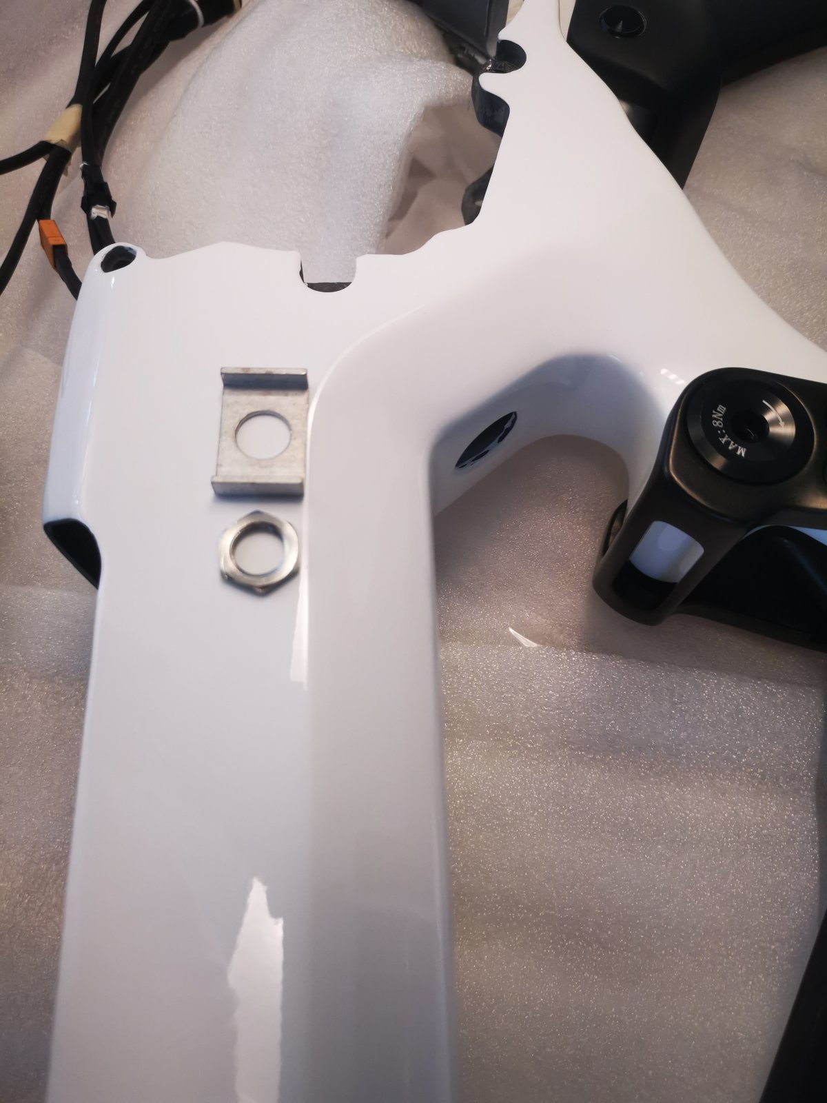

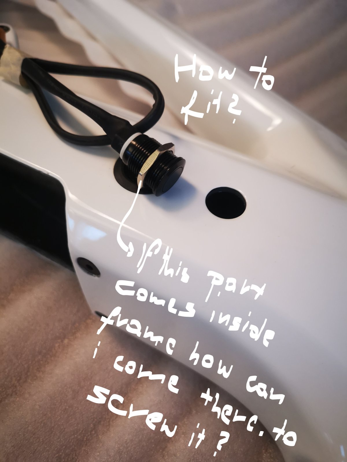

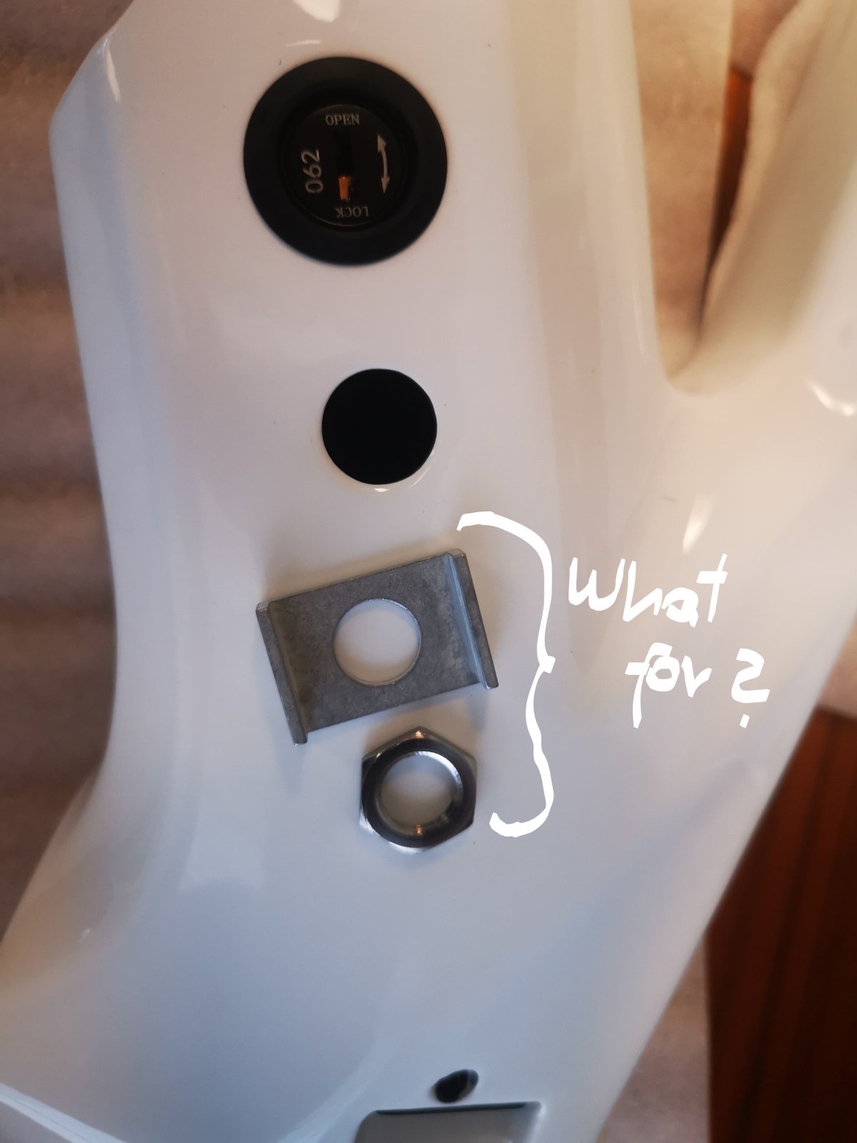

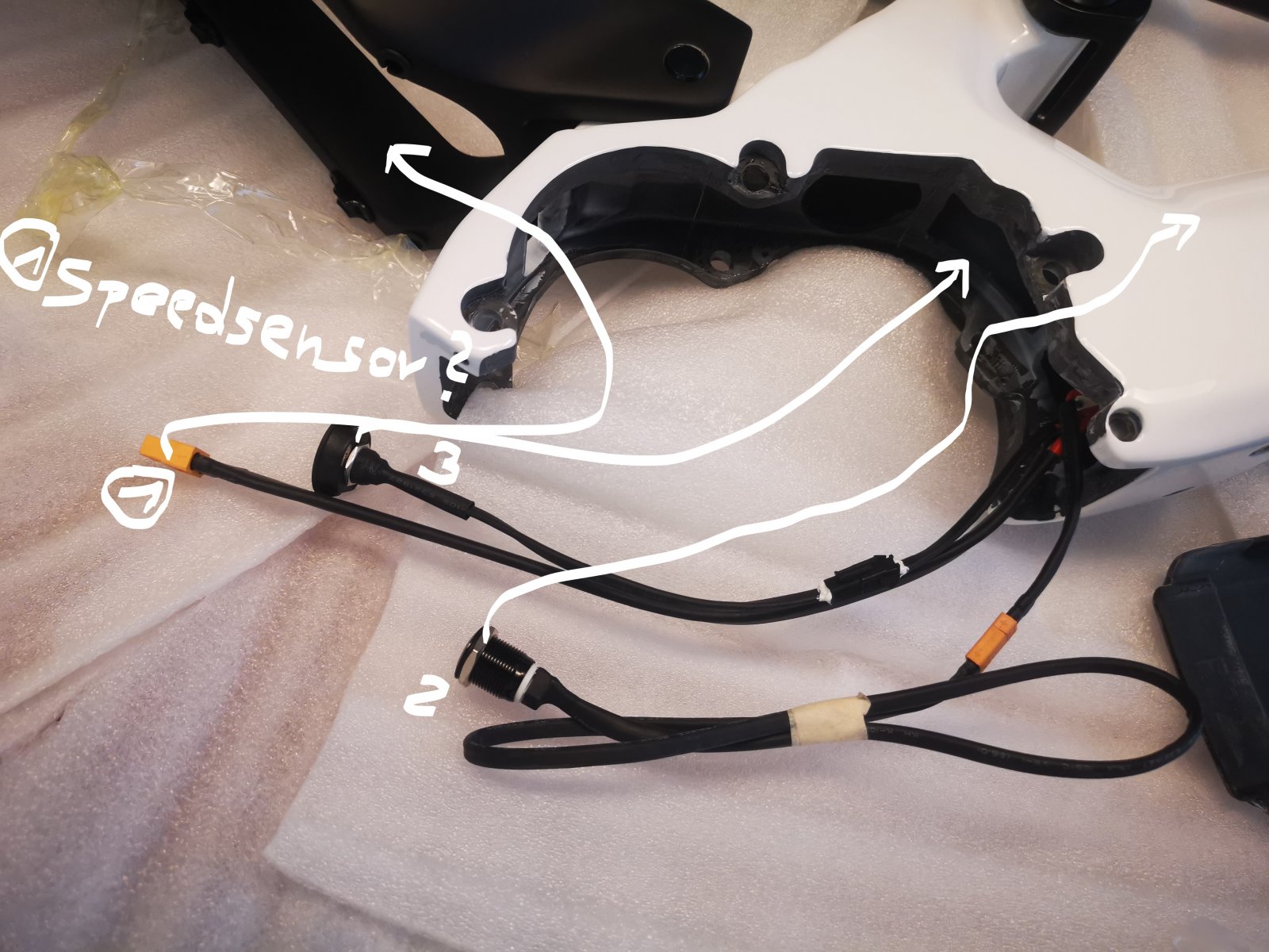

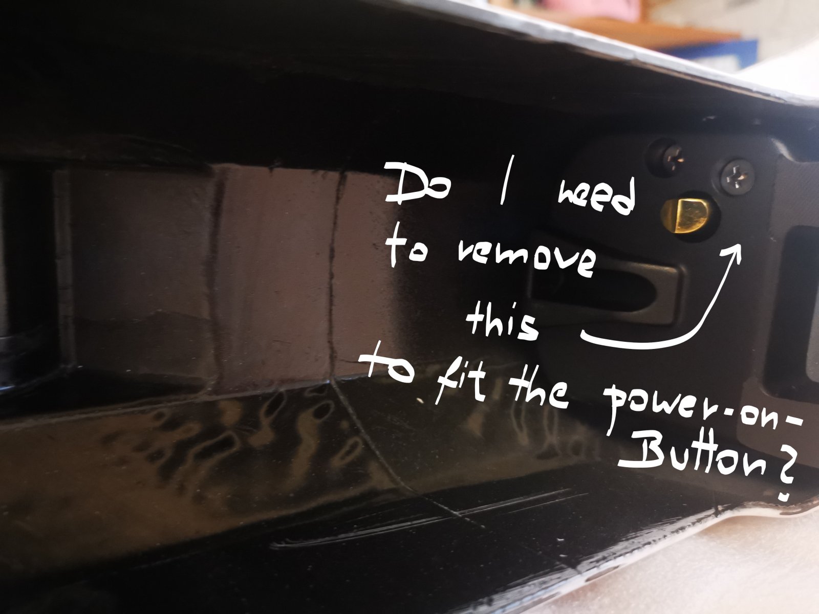

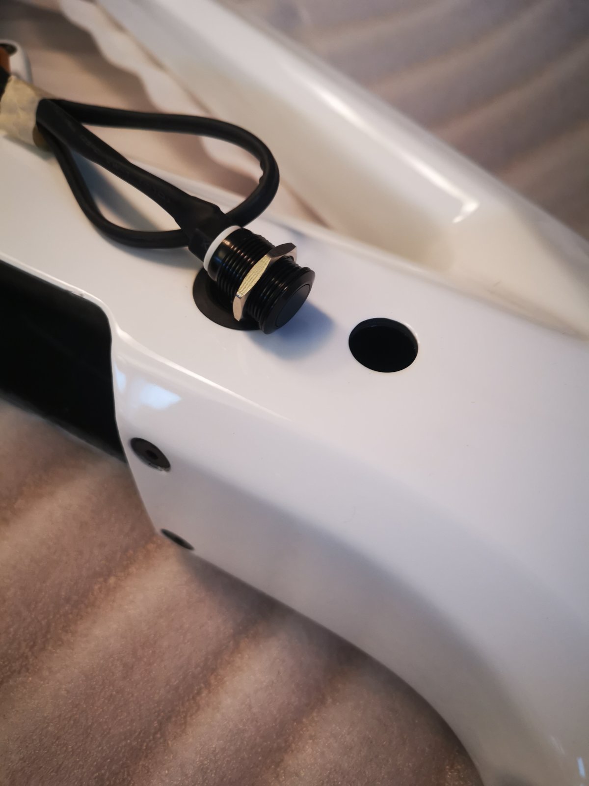

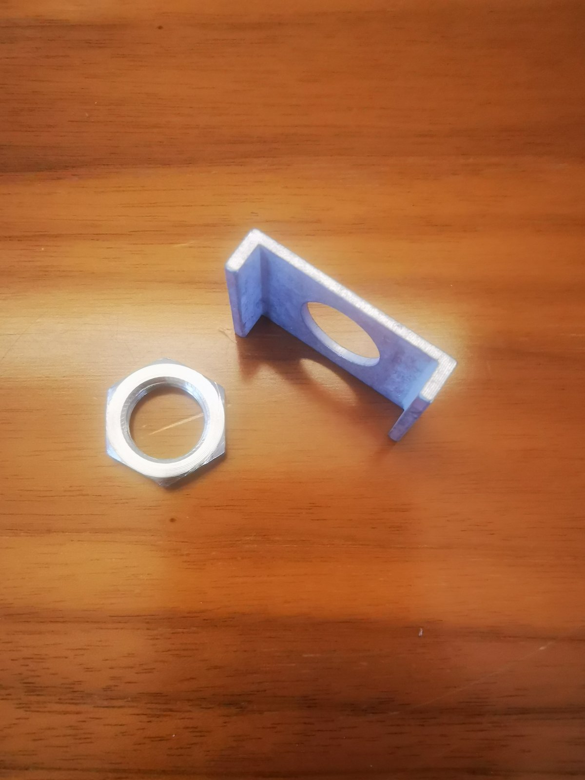

So finally my frame arrived but there are some thinks I do not really understand so maybe someone can help me? See questions in attached pictures. Thanks to anyone who is able to give some help!!
I see battery cover but no battery so it’ll ship separately?

Pos 1 is not a speed sensor - this is power supply that you connect directly to the motor. Speed sensor comes with motor. You cannot do anything wrong with motor connectors - they fit in just one hole.
Does your pos 3 also heave this aluminium profile?
Normally you push button inside without nut - directly and nut comes then to the other side. If there are 2 same nuts you can use the second one to ''counter strike'' the first nut so it can not get loose.

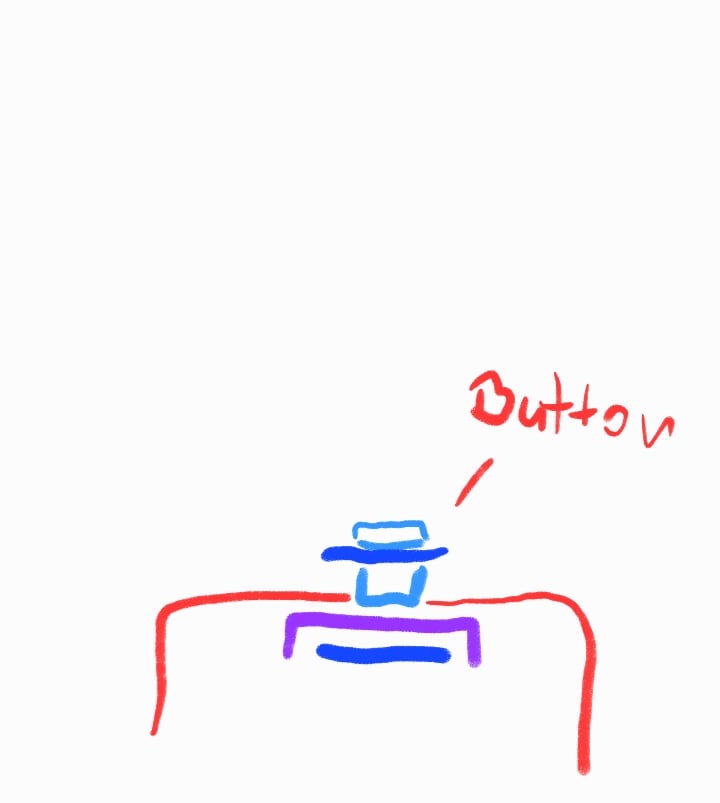

Thanks mate. But do you also know how to guide Pos 2 (power button) upside to the tube? There is a whole but i dont know how to reach it from.inside the frame to hold the nut. Also i do not understand how the controller is linked to the battery/motor. Or is it just connected to the display and the display then is connected to the motor?
Pos 3 has also a an aluminium nut, but a smaller one and i.dont think you can unscrew the nut.

Pos 2 has an orange connector that you can take apart (I'm guessing that from pic).
Pos 3 the same - somewhere shod be a plug so you can take cable apart.
Nut is always from inside and aluminium profile shod be between nut and frame (its hard to see prom pic, but my guess is that from Pos3 you unscrew that nut and put it on the inside.
I'm still waiting for frame so this is just a guess - sorry. Perhaps someone who actually assembled his can write more.

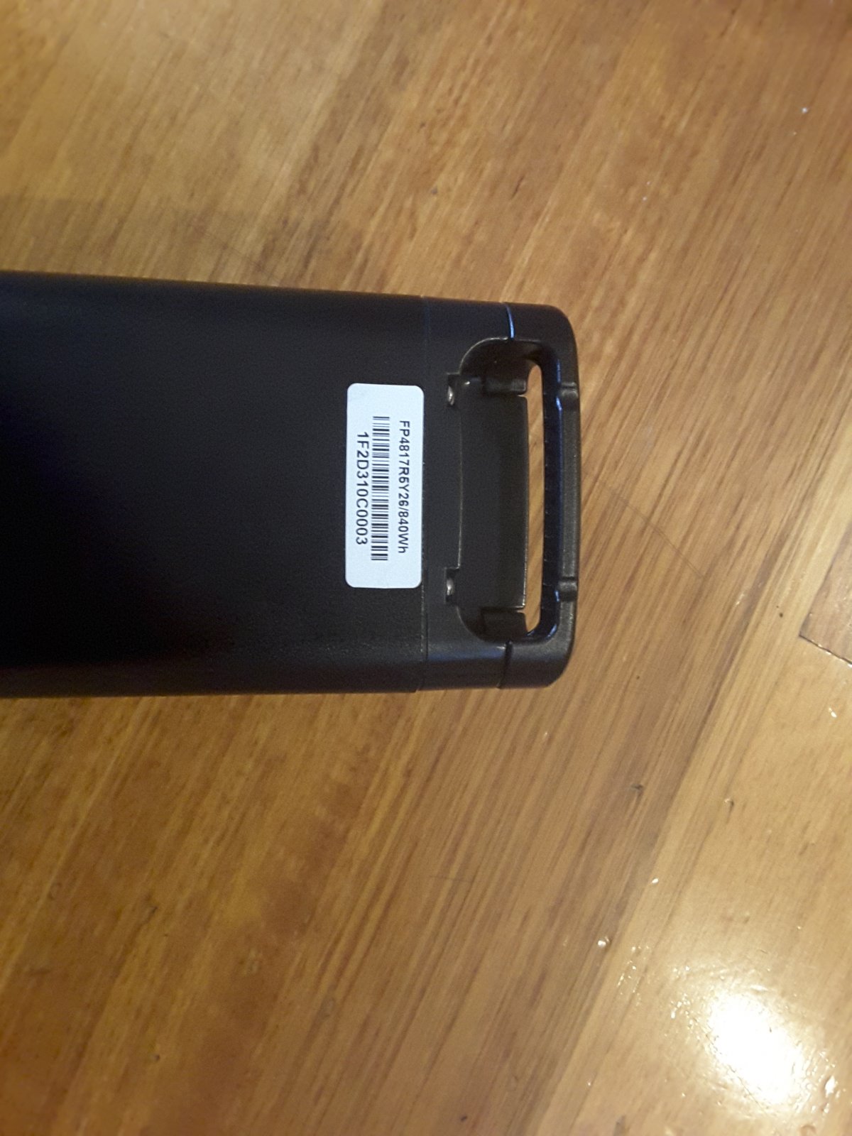

This is the only info on the batt. Perhaps the part number will help. It's definitely a generic battery.
You could also look at aliexpress. I have purchased a few things from them no problem. And I believe you can find E10 bike on there. Worth a try.
