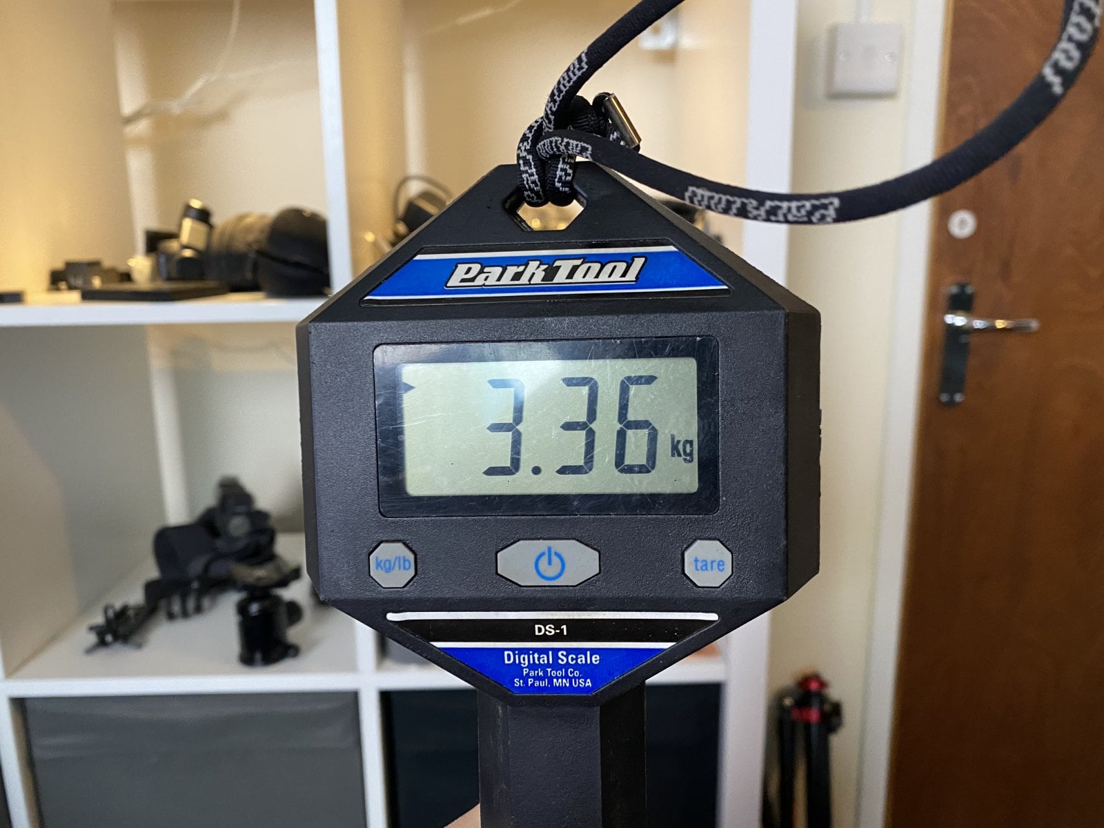

Interestingly it’s a bit lighter than the quoted 3.4KG - so it’s not a M600 hidden inside!

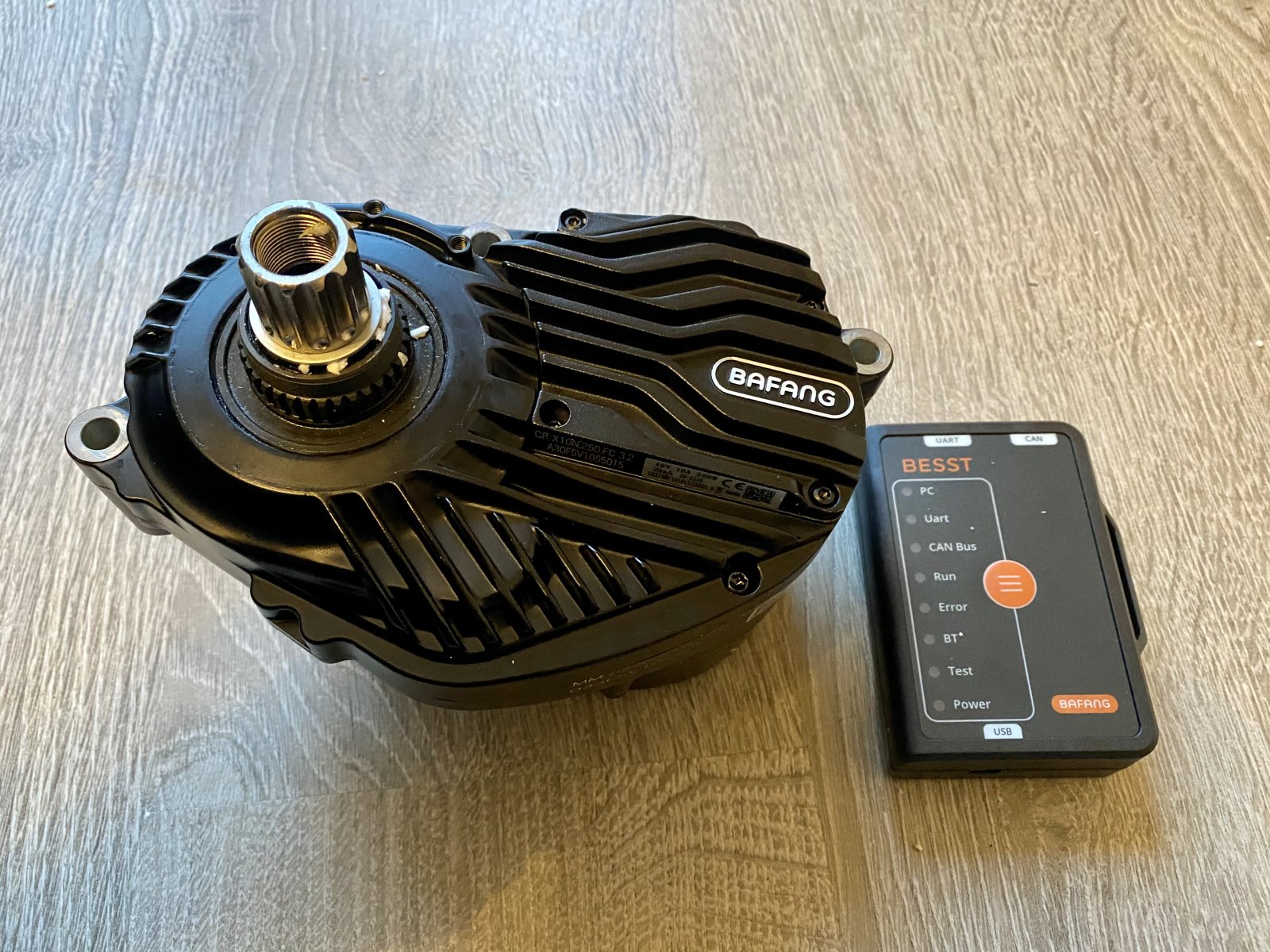

Have you tried the BESST tool yet to see how it's configured ?
I guess you'll be able to compare the settings on there and the previous one in theory ? (and check firmware versions ?).

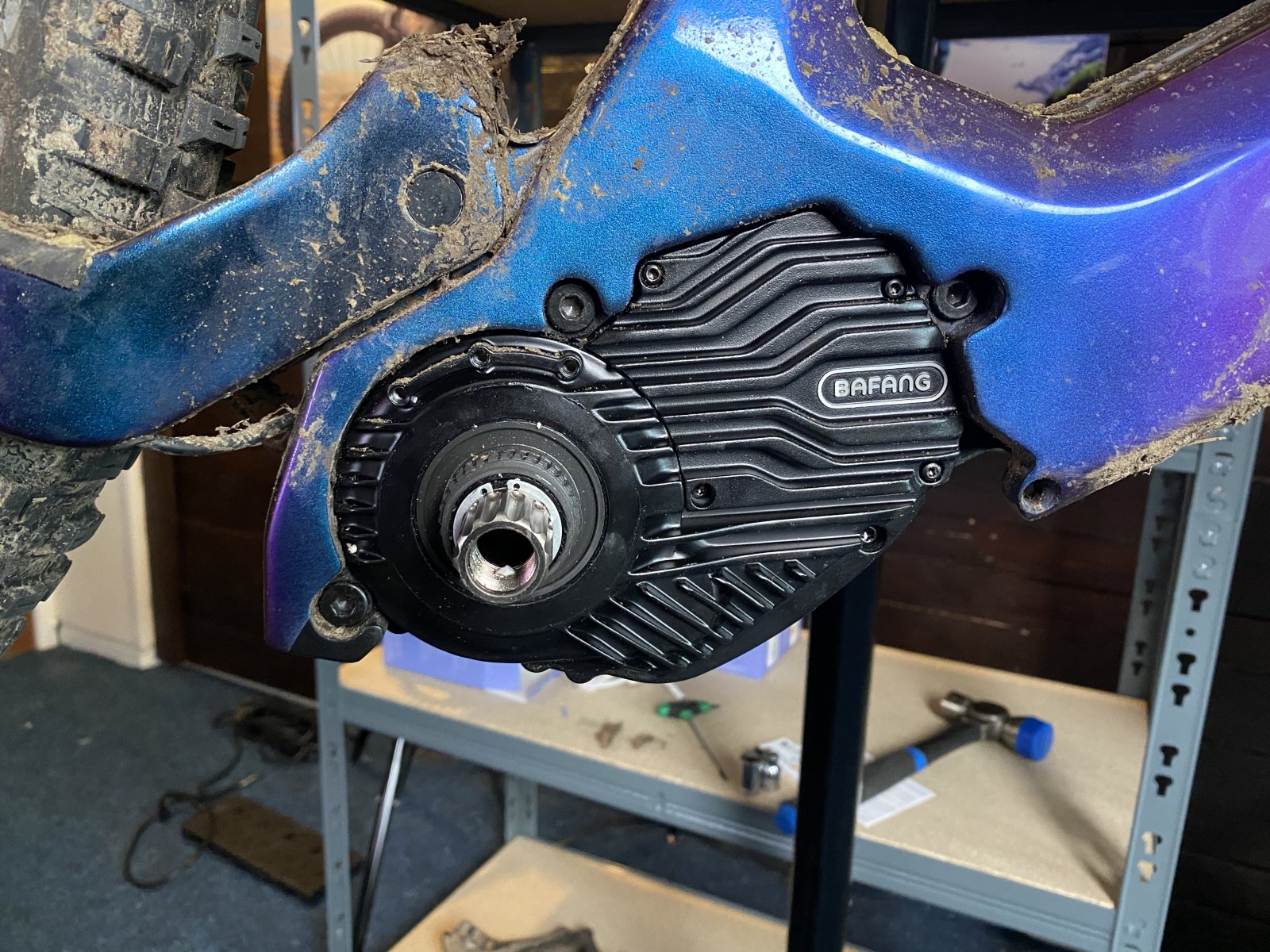

OK. After a very quick 5 minute ride:
Motor feels more responsive on initial pedal strokes
Motor feel like it has more power
Noise level is very similar, maybe slightly louder.
I suspect hardware is very similar, gears probably still plastic gears
Its raining and miserable out side so it needs a day riding to understand it.
Side note, 160mm Lyrik feels really good on the bike.

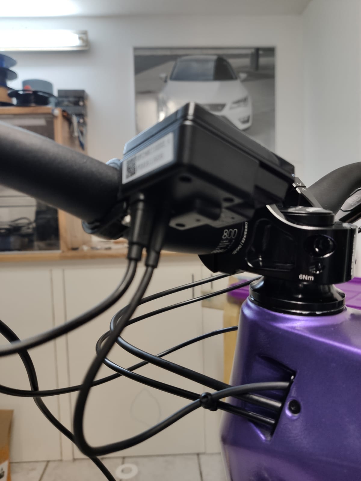

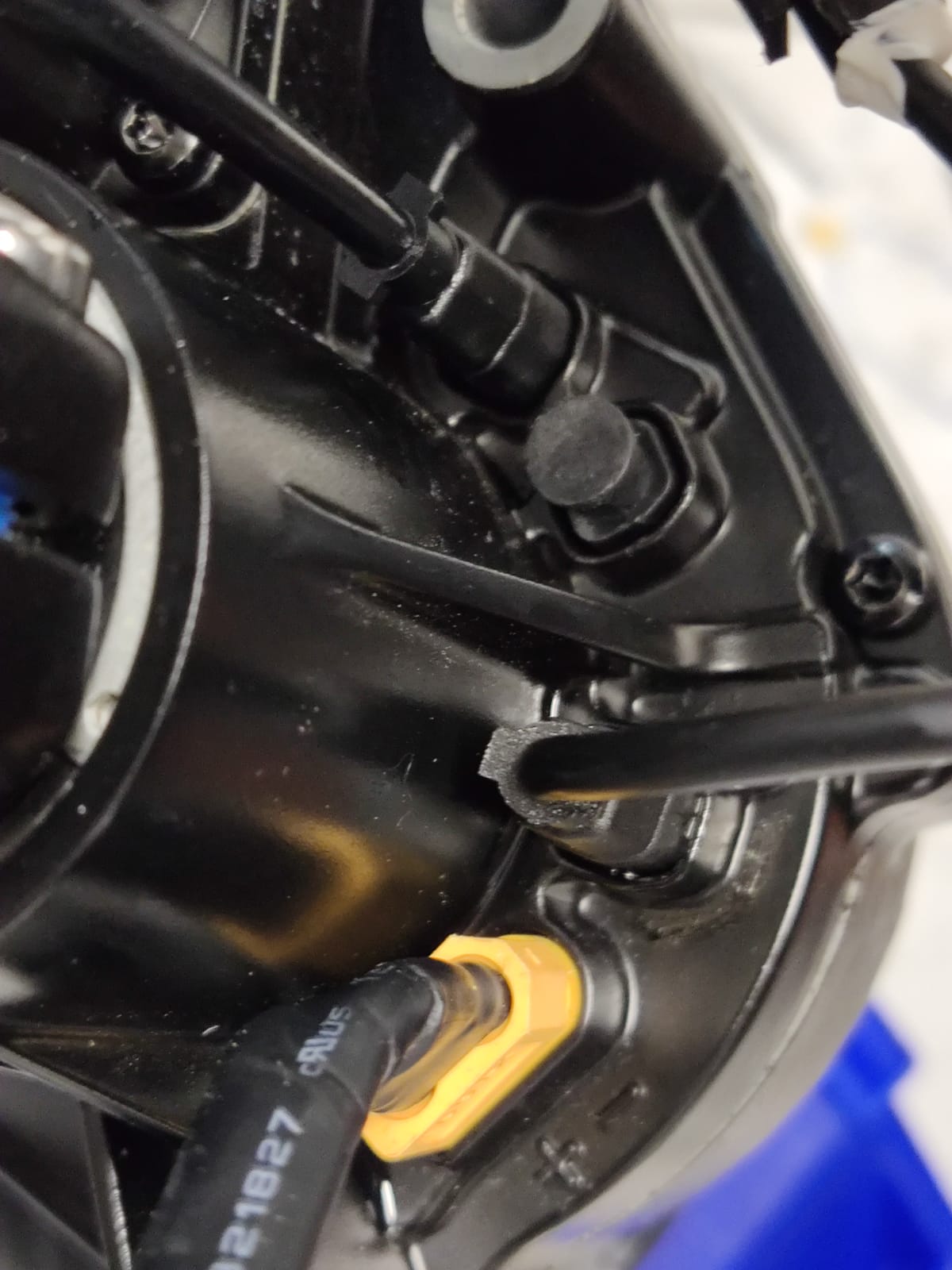

On wednesday i got my Dengfu E10 and already painted it!
Today i put everything together but i have some struggles with it (i work as a mechatronik FIY)
i connected everything like it seems good to me and then i tried to start the Bike an it does not worked....
After a few attemts ai figured out to start it by pressing the button under +- on the handlebar and it worked. So i put everything together and when i finished i couldnt start the bike.....
i have used spray on every connector but maybe have i done something wrong?
i have also measured the voltage with the button on the front right pushed (53VDC) and not pushed (46VDC) what i really did not understand is this the ON / OFF Button or what?
is it normal that one of the connectors on the motor is not connected?
Thanks guys and i will make a review as soon as everything works.
Greetings from Austria!

the process to switch on is:
1st the push button on frame right side (it stays a bit depressed when on)
2nd several seconds (more than 5 i think) on the lower button of the remote
The unused connector is normal (for brake sensor)
check all pins (brittle) inside connectors and take care that connectors are fully inserted after . To be honest, i had the same problem at my first switch on, i have check all connections and after that work correctely, i have supposed that remote connector is not enough inserted in display.
And if it don't work => melody

Ok thanks for the help i will double check it tomorrow!
I hope it will work, but i think the connectors are not the best ones.
MartinEbiker
Mar 19, 2021
7
8430 Leibnitz
Also make sure battery is fully charged. Sounds obvious but mine wouldn’t turn on as BMS had gone to sleep.
I know what you mean. I hava charged the battery at arrival.
And when it turned on once it showed 100% battery state.
I have unplugged every connector on the motor and the ones on the display looked good.
I really dont know whats up because it started one time before the complete assembly.
