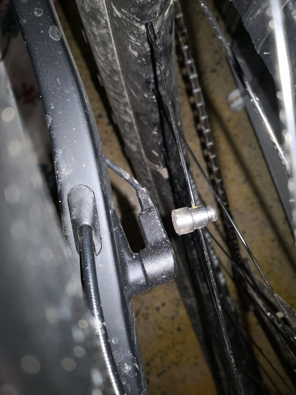

RoyRoy - 100% the bike is awesome for sure, did have a couple of teething problems with the speed sensor when new, now sorted, the bike is a beast. Amazing on trails, ultra plush ride, incredible range and performance, seriously hard to want anything more. PM me if you would more details on the mods I've done. Cheers
whats wrong with the speed sensor. i am having also some erratic speed logging. Not sure if its the gap or alignment of the magnet?
Alignment is the issue. It is very iffy. This works for me. Didn't move it much, but enough to stop the error.
Yeah initially had to trial & error a number of changes but what worked best (for me) was to move the wheel magnet away from & more towards the hub of the wheel to fix it. Since doing that it hasn't missed a beat. Hope that helps

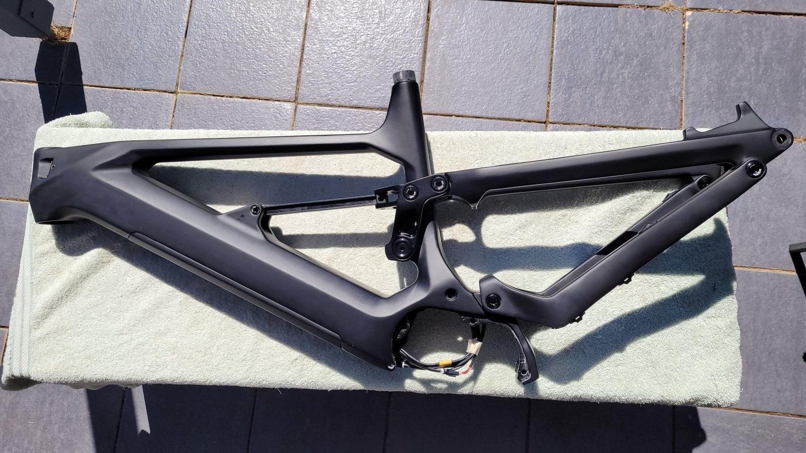

Only problem with DIY is sourcing the parts and getting to tools or paying a bike shop to put it all together.
Hey nurv0,
Not sure what the 'power upgrade' option is - buying direct from Dengfu is not the easiest thing. Mine is just the E10 frame and M600 motor+battery. I know some people get the M500 motor which is 250W I believe where the M600 is 500W.
The $3,300 is just the straight conversion from USD to AUD - so just the frame, battery and motor inc. shipping.
So far I have not paid for any duty - mind you only the frame has arrived yet! Maybe just lucky at the moment.
As for parts, I am going a bit cheap at the moment and sourcing most things from Aliexpress and tires and smaller stuff from other online stores. When everything arrives I will post up pictures of all the parts and links to where I got them. So far I am not buying named shocks/forks and my total extras are around $1400 for suspension, wheelset, groupset (Deore 12x1), seat post (non dropper), hydraulic breaks and disks, shock bushes other bits and pieces!
On the lookout for some second hand Lyrik forks and similar spec rear shock (saw a DVO Topaz the other day for not too much) so can upgrade from the knockoffs.
Having said that the knockoffs forks after a pump up seem pretty good and well made for the price! The cheapo brakes are probably the first thing I will upgrade... but wanted to see how cheap I can make the build!
This is my first full from scratch eMTB build but have tinkered with bikes and electronics for a while and so far it seems fairly straight forward.
Looking forward to the build process - thinking about if I paint any part of the frame so its uniquely mine!

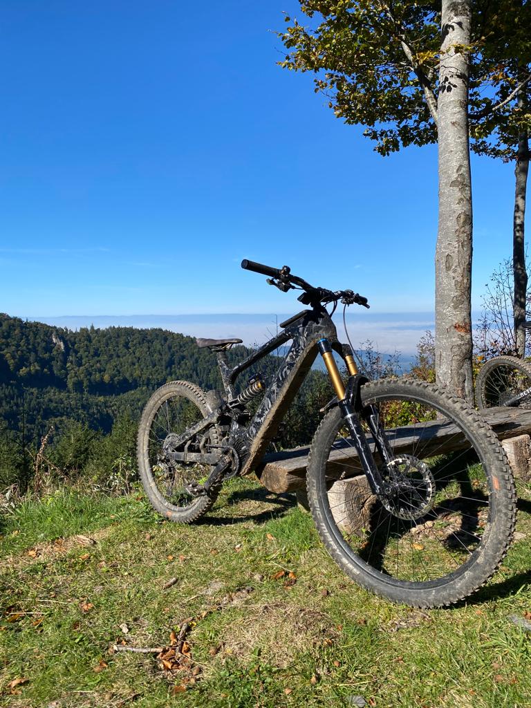

thaeber
Jan 26, 2021
888
769
Bruchsal, Germany
Hi all, I've ordered my e10 and it will hopefully be down here in Victoria soon.
Quick question: what is the rear suspension like on square edge repeated hits, both big and small. I'll be using a 216x63mm (with offset bushes) for the rear and in mullet form.
There is a heap of really good info about motor and controller stuff, but I haven't managed to find anything on the handling for aggressive enduro style riding as yet.
This won't be a gentle gravel road build, I plan on riding it as hard as I do my Yeti SB6.
Thanks in advance :)
I‘m running the setup You described 216x63 with Cane Creek DB Coil Shock and 450 - 550 lbs progressive spring. Fox 38 180 on the front. If the suspension is dialed in correctly (I ride around 30% SAG on my bikes) the rear suspension works flawless. It‘s my first ebike, but I owned many (Intense 6.6, Alutech Fanes, Rotwild RG1) freeride / enduro bikes with comparable rear travel. The E10 at 170mm rear travel (measured on my bike) is on top of what I‘ve ridden before, sensitive on the small stuff, smooth but with good feedback in the gnarly, rocky/rooty sections, and super forgiving at hard impacts and missed landings. A boost for self confidence. I also tried a Rock Shox Vivid Air 216 x 63 with the bike, that worked also great. Sitting a little depper in the travel, very supple and plush in midstroke with good end progression, more comfortable, but less feedback. A matter of taste. Take Your time on the correct suspension setup, and You will be very happy with the bike!

thaeber
Jan 26, 2021
888
769
Bruchsal, Germany
Thanks Thaeber, that's helpful info. I have a Float X2 shock and Fox 36 Factory for the front already lined up to go on. A Fox 38 would be nice but I'm fairly light so I think the 36 will be fine. I'll have to check if the 36 can run a 170 air shaft, otherwise a 160 will have to do. I'll be running 29" front and 27.5" back, so that should help as well.
I'm looking forward to getting it built up and playing around with suspension settings, I'm a bit of a tech nerd with that sort of stuff. :)
Sounds like a great setup! I also run Mullet, HA at 64 degree, perfect!
