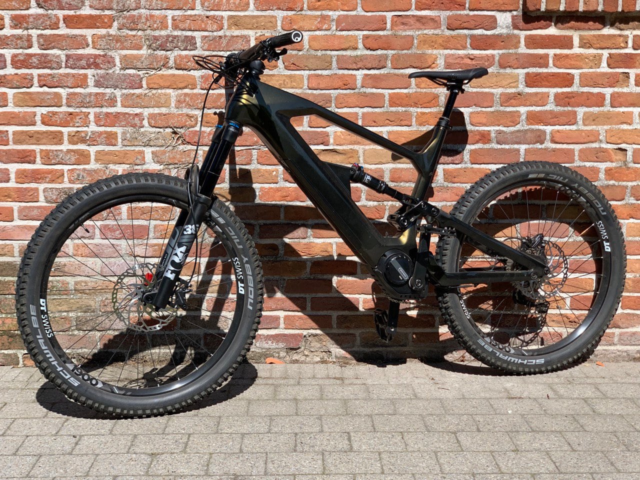

That bike looks like a beast!!!

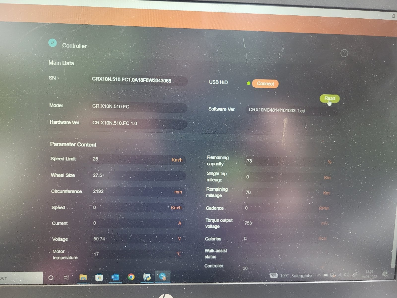

Hi guys, after some problems that i have had with water in the cables (resolved it with the hair dryer) my bike now has another peoblem: i cannot switch the bike on with the third button on my remote. I just tried the Besst Tool and while connected display and the remote were ok (i tried it out cause with the On/Off button on the frame in position Off the display first shows 0%, for reading the controller in the Besst Tool you then need to switch ON the On/Off button on the frame, then battery showed 100%; the display was always on while connected to the Besst Tool and all menu options worked fine with all 3 buttons on the remote). I even tried to recalibrate the position sensor with success - the motor was spinning for a few seconds like it should. I updated the controller with the new firmware - succeeded. Afterwards when disconnecting Besst Tool display was shutting off as normal. After plugging in all cables like it should, pushing them inside pretty hard so that all connections were ok i tried to switch on the display - nothing.
Does anyone know what options i have to start the display and battery without using the remote? Is there any option so that i could proff that the motor is working?
Does anyone have another idea where the problem might be 🤷‍♂️🙈?

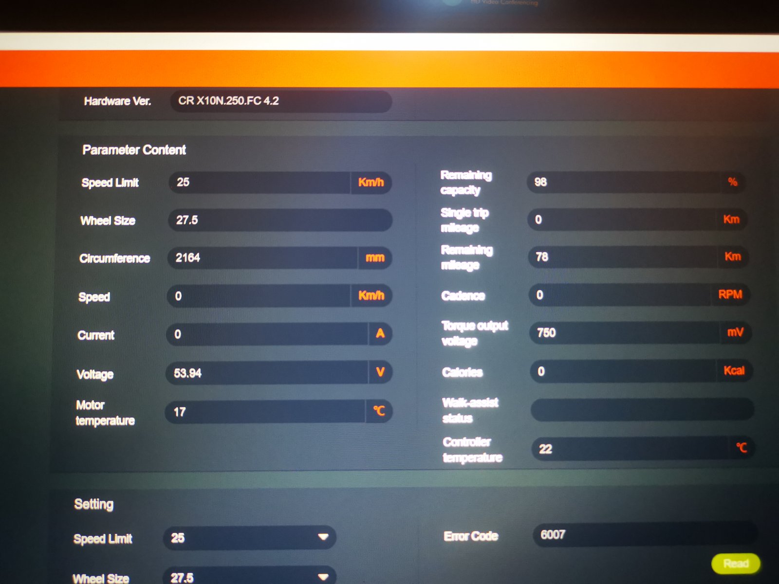

Guys, another quick question. Can it have to do with the Voltage that is showing only 50,74 V in the Besst Tool? In other screenshots (see other picture) of the Besst Tool when my bike was still working it always showed approx. 54 volts :unsure::unsure:
captainhightop
Feb 26, 2021
136
143
If the ignition circuit (battery on/off switch) is cycling on and off due to the usual water ingress, it could be oscillating fast enough between 0 and 54 and the voltage detection circuit wouldn't follow it fast enough to see either 54 or 0v, but it might show something in between. You could link out the switch circuit inside the battery to test this theory. I just hope you've not bricked the controller comms like I seem to have done with my two motors (m600 and m510).
edit: I don't mean the actual external switch though, it's water getting in behind the pogo pins in the battery dock that is incredibly difficult to stop or get rid of.
