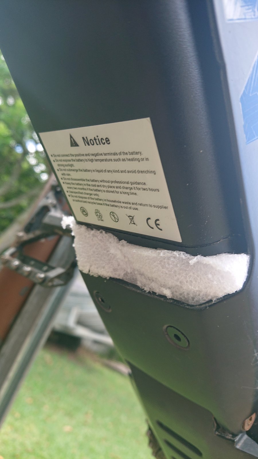

For sure, this is water ingress either on the switch itself or more likely, as it was in my case the battery dock. The symptoms were the same, ticking sound from battery (even when display off). If I could turn on the display, battery percentage going from 0% to 90% and inbetween at more or less the frequency of the ticking. Power was mostly < 20W if I could get anything out of it, but occasionaly would shoot up to normal levels.
All attempts to stop this were:
- potting the back of the dock
- drilling holes in the bottom of the dock
Both of these, only reduced the likelyhood of his happening. Taking the battery apart and linking the switch wire to be always on to the BMS has so far been successful in wet conditions and during cleaning. This does mean that the battery is kinda always on, but all my other DIY bikes were like this anyway and you still have to turn on the bike via the display anyway.
The clicking I think is some sort of relay on the BMS that is flicking on and off due to the on/off switch making and breaking due to the water bridging the contacts (pogo pins or back of them at least). Most BMS's I've used on my self build batteries came with this wire permanently linked so I wasn't too worried about changing Dengfu's battery to behave this way.
I've also added a fabric cover the length of the battery cover to stop the mud blocking up the sliding catch as that was a big pain too, and it has the side effect of providing a bit of extra waterproofness.
Still nervous about it obviously, but no more than the BBSHD and their seemingly fragile controller (at least in British winters). If this doesn't fix it, I'll be retrofitting an external controller somehow unless a cheap source of replacement controllers becomes available (used a BAC800 with eggrider on BBSHD for a while, and a cycle analyst for more fine grained PAS control with their phaserunner kit). The grin baserunner (Baserunner - Grin Products - Product Info) could be a candidate to fit inside the frame with a custom battery and a bit of work I think.
Still I'd rather keep it stock than have to work all that stuff out so fingers crossed I make it through the winter without any more issues.

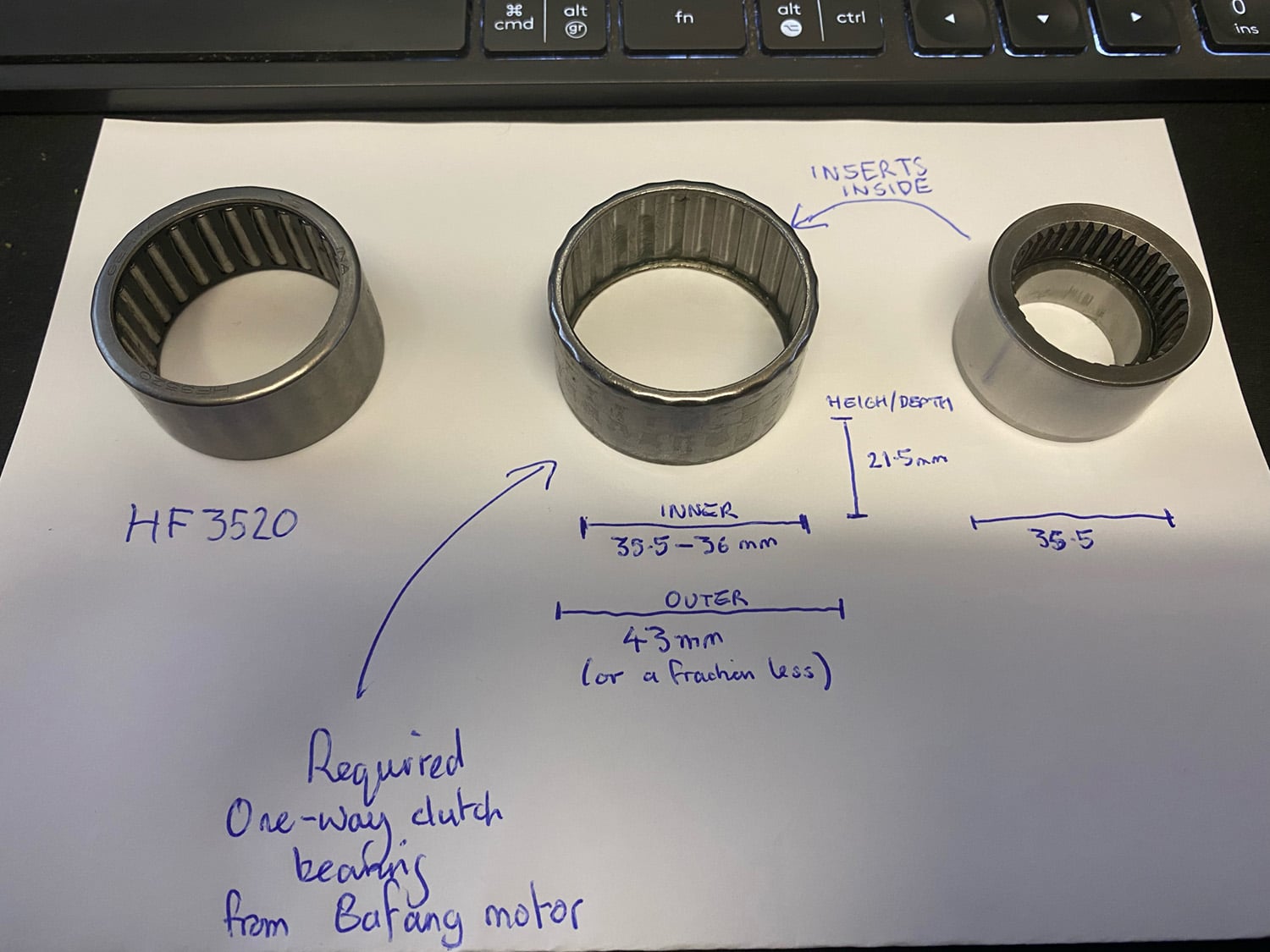

So I've stripped down the M600 motor and removed the clutch bearings - tricky but got there! The smaller clutch bearing is marked HFL1426 and this has now been replaced. Unfortunately, the larger clutch bearing has no writing/model number on it and appears to be a very strange size. Initially, I thought it was a HF3520 but it turned up and is smaller than the bearing that was removed. On closer inspection, the larger clutch bearing on the Bafang M600 has a measurement of approx 36 x 43 x 21 mm. Having looked for this bearing online, there appears to be no one who sells anything of this size. The only reference I can find is a KOYO bearing RFU364322A but this appears to have a 22.4 mm depth which is too big.
Does anyone know where these parts might be available? Until I can find one, the Cheeb isn't going anywhere as the larger bearing was damaged on removal. Gutted!

I've had a good route around the tinterweb and like you come up with nothing, other than the HF3520 bearing that's even close to your measurements. Even imperial equivalents are no where near in size...
Have you measured the bearing dimensions with a rule or something more accurate such as a digital caliper?
Have you actually tried fitting the HF3520 in place?
Bafang will not be making their own bearings, as it makes no economical sense. Might be worth reaching out to them via Ben Rides (Dengfu rep) to ask what the bearing actually is?

So I borrowed a decent digital gauge from a friend and measured the bearings properly. The 'exact' measurements are 42.99mm diameter, 35.99mm internal diameter and 21.8mm depth. It looks like the KOYO is almost exact, if not slightly deeper by .4mm which I think could work okay. It's just finding one... I'll reach out as you recommended. Thanks for your help. I fear I won't be riding the bike for a while :(
The HF3520 literally just falls very loosely inside the bearing recess and the inner gear doesn't fit inside either so it's the wrong size from every angle. Shame - I thought I had it nailed.
Ah that sucks. At least you have the exact measurements and hopefully can find a KOYO bearing from somewhere. I'll have a search as well.

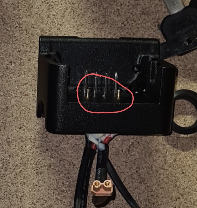

Hi there,
Had the same problems on my Cheeb.
Started at 200km just after the build, contacted Dengfu without an answer, so investigated myself and found out the on/off button is not waterproof, I bypassed the switch which solved the problem until last week :confused:
After doing some muddy terrain, cleaned the bike to hear the ticking noise again.o_O
Checked all the wiring to the display and motor and opened the battery connector (removed the white smudge) to find out it was moisturized inside! Seems Dengfu needs improvement on the electrics.
Hope this info helps for future owners.

When you say you removed the white smudge do you mean the white rubber thing that is over the connector just below the battery isolation switch?
To be really sure, you need to disable the on/off function by linking the wire in the battery internally. No realistic way to waterproof the pogo pins so just bypass in the battery, and water getting in the switch itself is only half the problem.
If you just detach the switch (unless I'm reading you wrong here!), when the dock gets wet it will continually short the switch circuit in the battery causing the output to go on/off randomly.
Just need to be sure you don't put the battery anywhere where you can short the outputs if you do the bypass otherwise you might get a big spark!

as far as i was able to find the problem is with the water in this part. the battery connectors are molded in a plastic housing. which is inserted into the aluminum battery holder and on the other hand is closed with silicone. that's where the water comes in, and it's short-circuited. when i took this part off the bike the water was coming out.

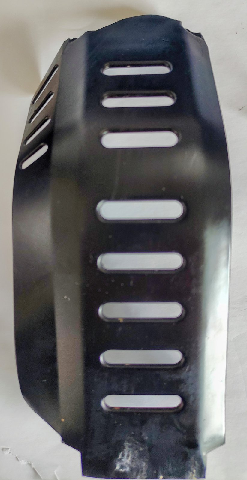

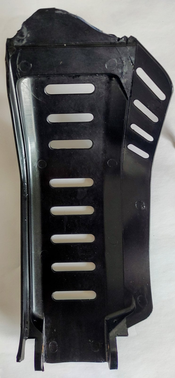

is there now a better solution for motor protection? I have already installed the third rock guard. Those things break out just from the vibration!

It's very difficult to expel all the water from the pogo pins on the battery dock that the switch connects to (which is why I advocate removing the switch and modifying the battery).
Also the controller and/or HMI don't have any way of telling the state of that switch on the side of the bike as it's an input into the battery. (Other than the absence or presence of power). So the button error code isn't about that button exactly, it's about a button on your HMI.
When my bike was were drenched I didn't get error 36 but it did come on without even pressing any buttons as soon as the button on the side was pressed and sometimes without having the button pressed at all duentonthe water shorting out the pogo pins.
There was a characteristic clicking sound coming from the battery due to the battery switch circuit flicking on and off too when this was happening.
Water can also get into the motor and mess up the canbus and other signals, so the error you get isn't necessarily down to the HMI either.
Even after doing the battery mod, I messed up and turned the bike upside down causing a small amount of water in the motor itself to go where it shouldn't have done (after a wet ride). I was luckily able to rescue my controller with careful disassembly and cleaning, but there was a fair amount of corrosion and bare copper showing that needed covering up on the drive control board and the board with the connections to the outside world.
eBikes and rain are always a gamble if you've not prepared for it, and even then you can still get screwed. Its not just Bafang though, all major suppliers have these kind of issues in one way or another, it's improving, but all adds to cost and in the meantime Bafang lag behind in some of these issues. They do conformally coat some of the electronics, but some of the through hole connectors have bare conductor and that's where mine had corrosion which I cleaned off with iso.
I'm thinking it needs some sort of place for water to exit, or other such strategy.

I know the feeling :cry:, I've drilled a few holes in the metal part of the dock hopefully to drain water away also and covered the top and bottom of the battery door on the frame with an old innertube to stop too much spray getting in, but it always gets in some way or other! Also covered the oval bashguard holes with tape to stop spray hitting the motor and I'm working on a better bashguard design to reduce spray further.
It feels like never ends sometimes, especially in UK winters!
I had worse problems on other motors though (BBSHD and Bosch). BBHSD was solved by an external phaserunner controller and the bosch fixed under warranty and then sold it.

I've seen the same problem rarely on my TSDZ2 motors, always the one way bearings and always they work fine when turning by hand. I've even taken a couple apart trying to see what the problem is but they always look perfect. The ones we replaced were always only a problem in colder temps and we put it down to incorrect grease in the bearing. But if the motor was working you would expect it to warm pretty quickly so we couldn't really isolate it down to temperature.
It will be only one of the bearings, the one that isolates the crank and it will be clear to see which one. Good quality replacements are not so expensive.
Hi what would you suggest to use as lubricant on the clutch bearing ?
As I can’t find any info online by bearing manufacturer on what lubricant should be used.
