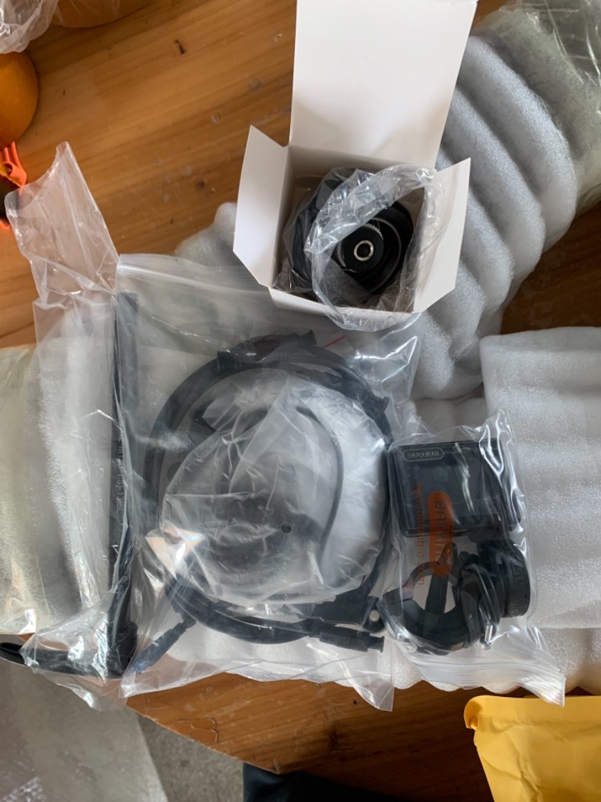

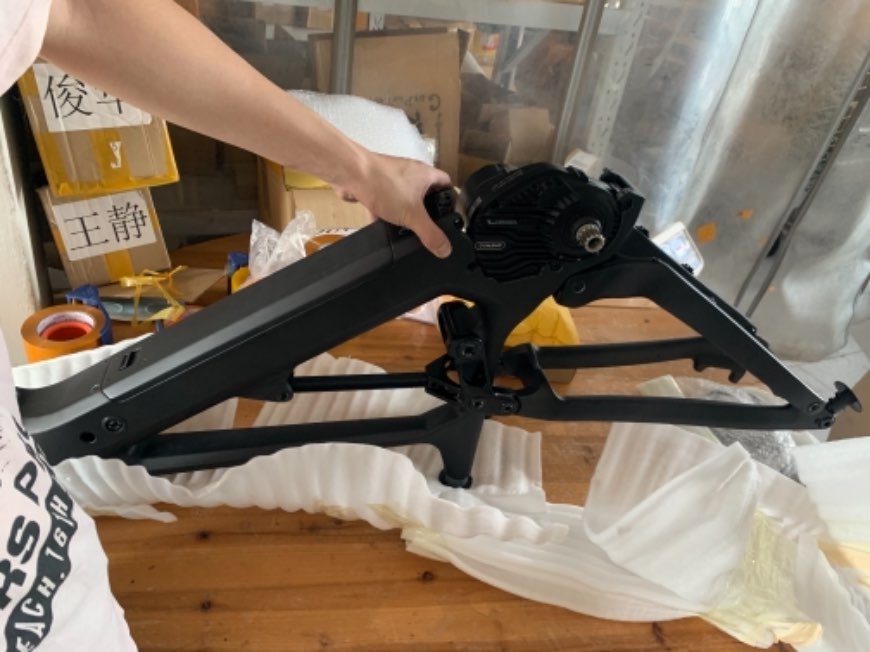

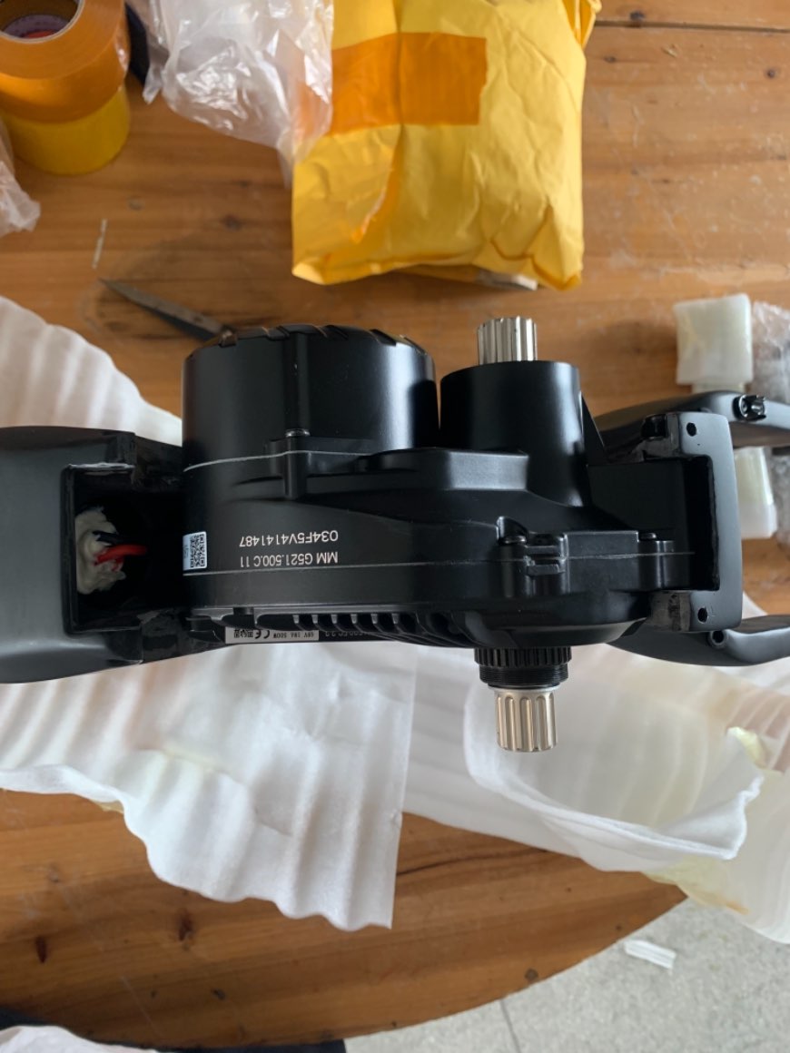

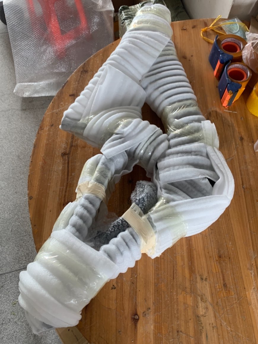

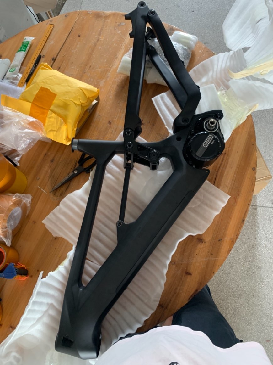

I have an online business and so I am able to get my parts delivered straight to my warehouse in china. It saves a heap on shipping and then I can ship at my reduced rate so I decided to build my bike this way.
So here it is, ready to come over and be put together,

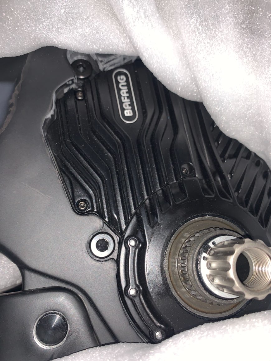

Its an E10 with an m600. We are not supposed to have the M600 in qld but I will not tell if you don't.

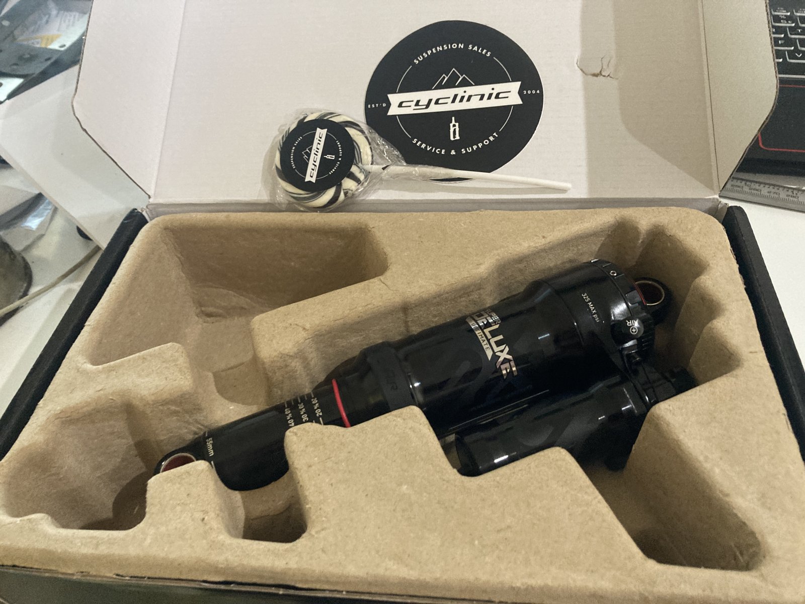

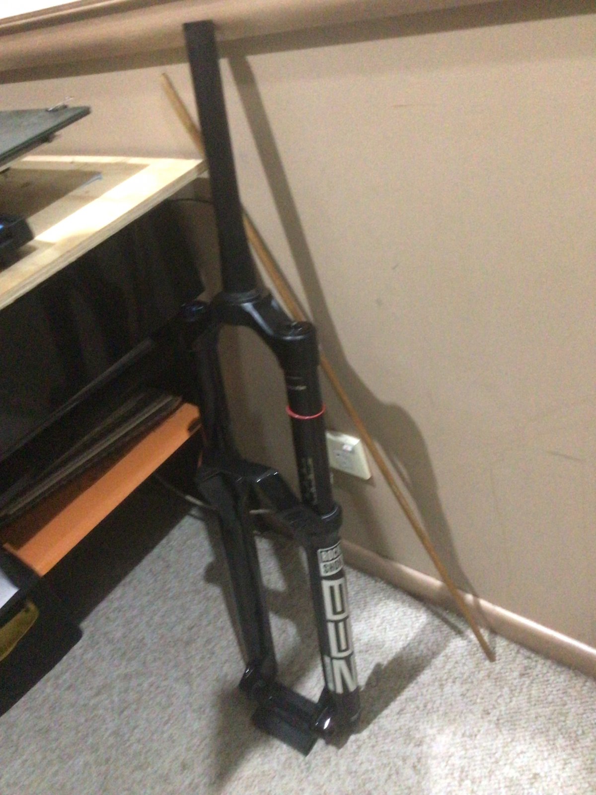

My rear shock has turned up. Im still waiting on the front shock as I got shafted by a business who masquerades as an Australian one and who isn't. That's another story with the cost of duty and gst added into it.

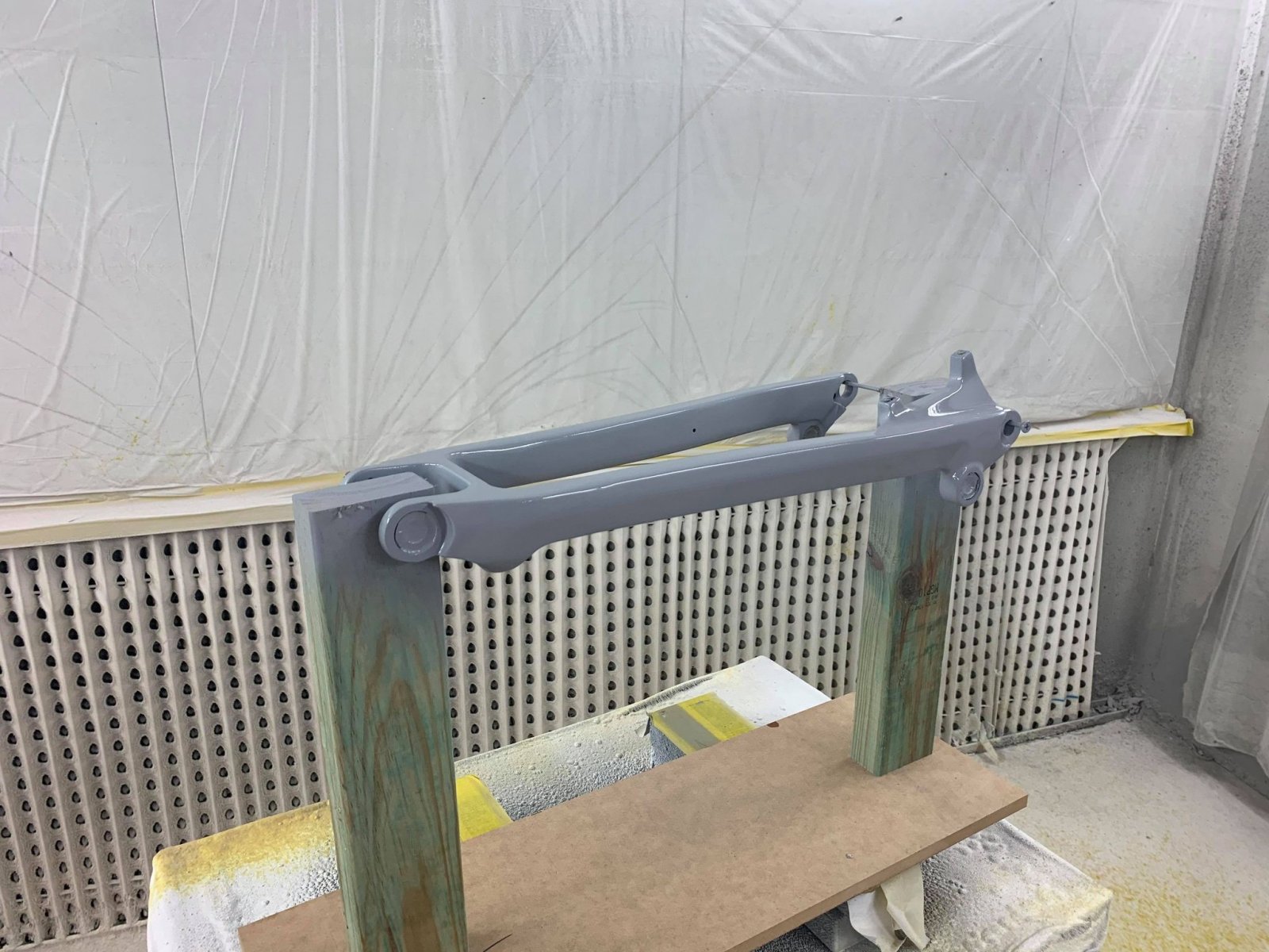

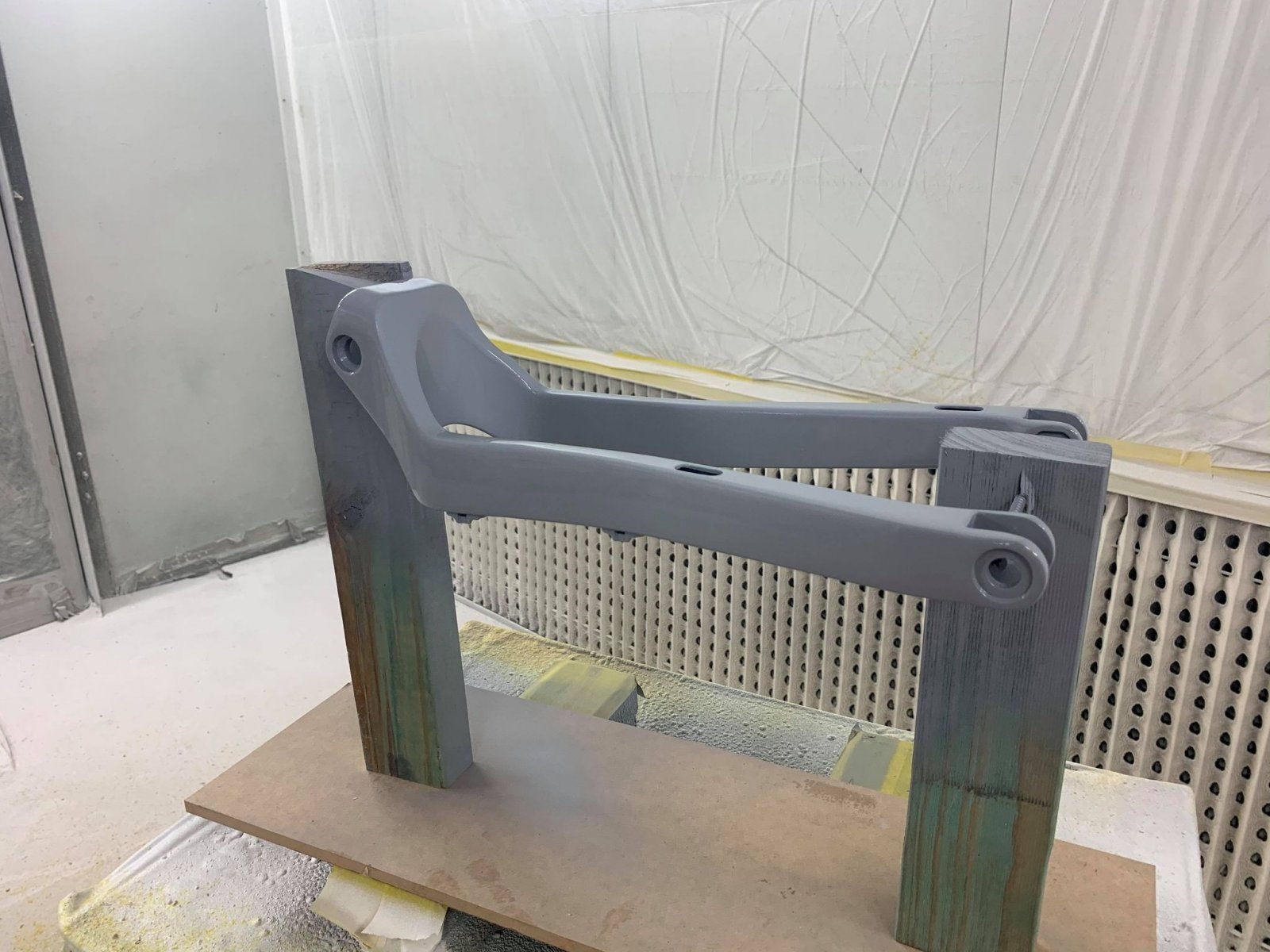

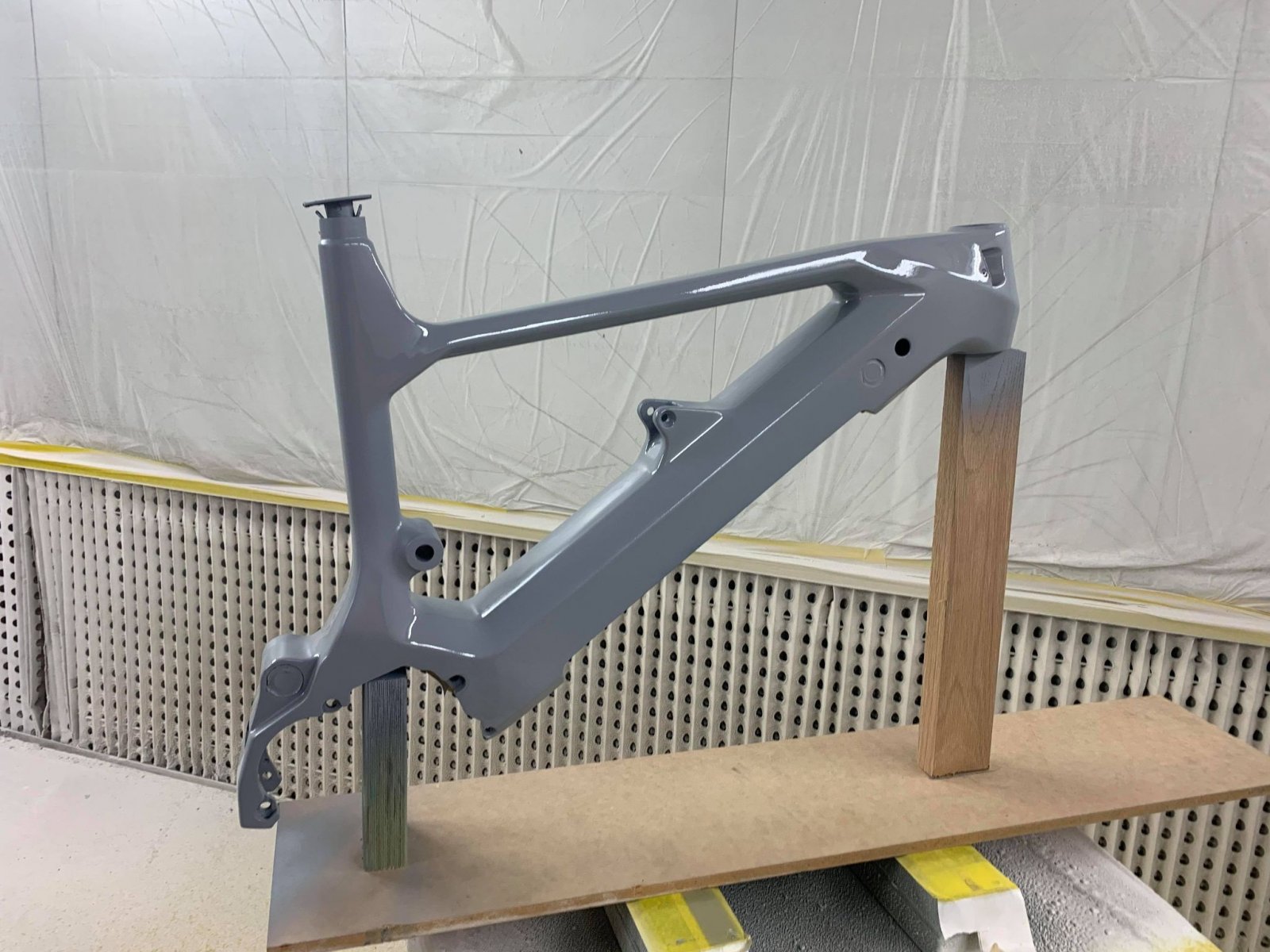

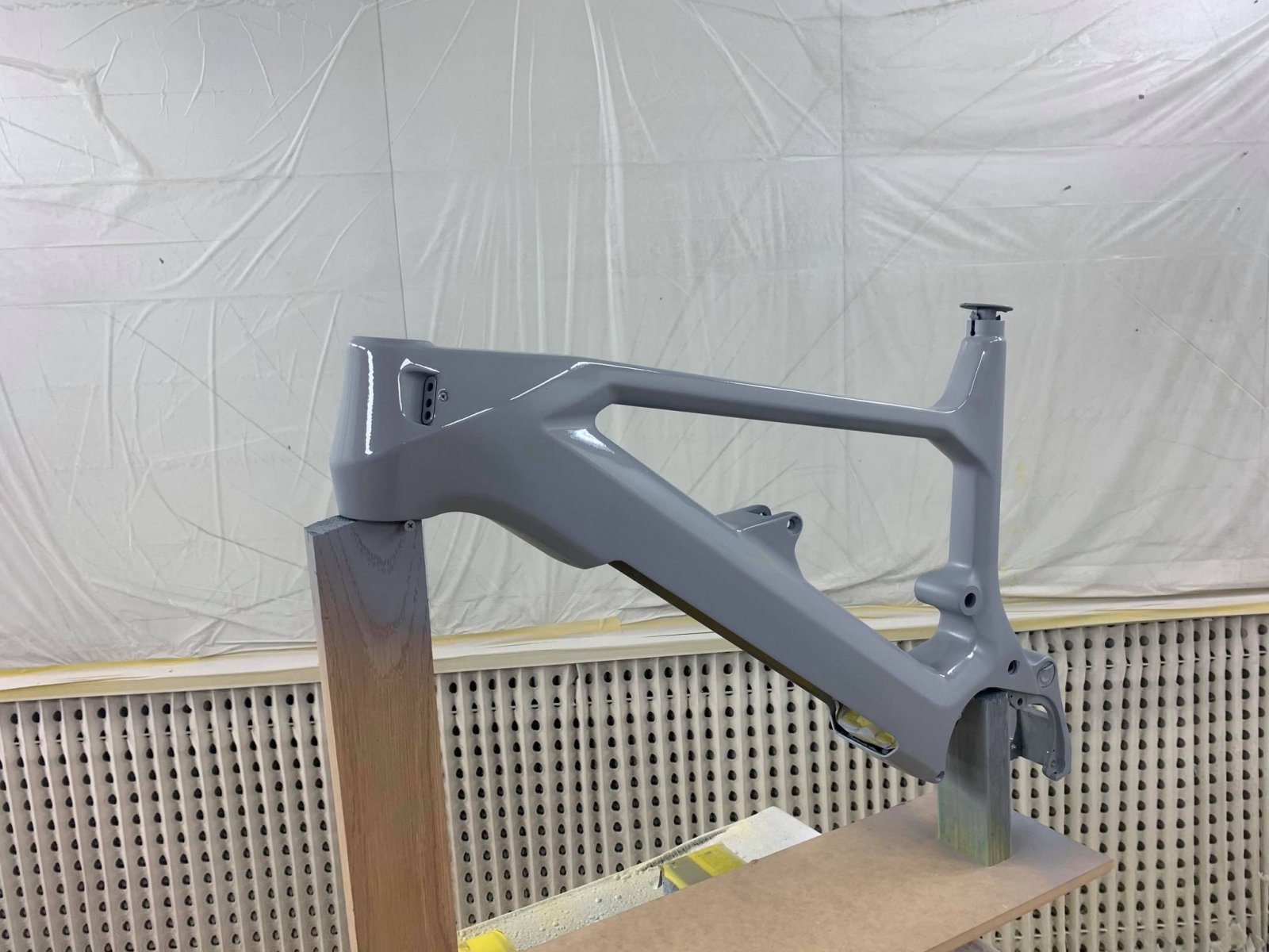

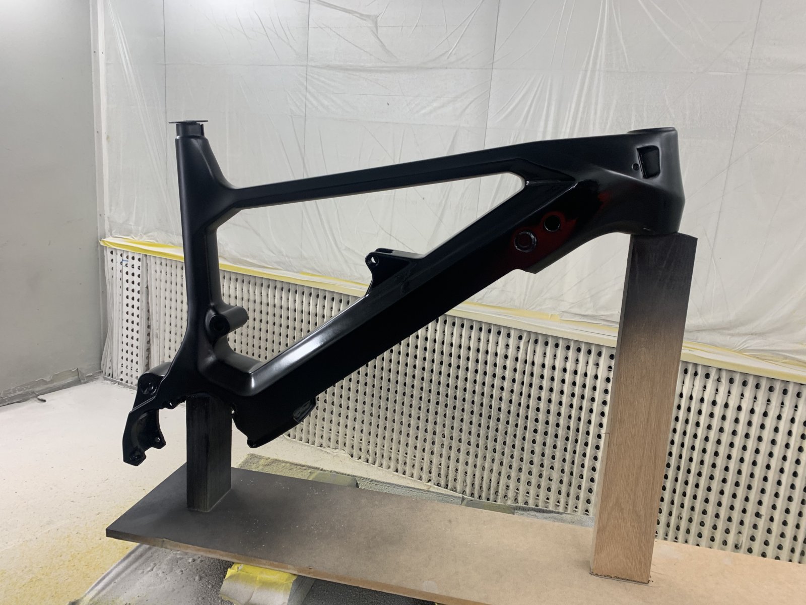

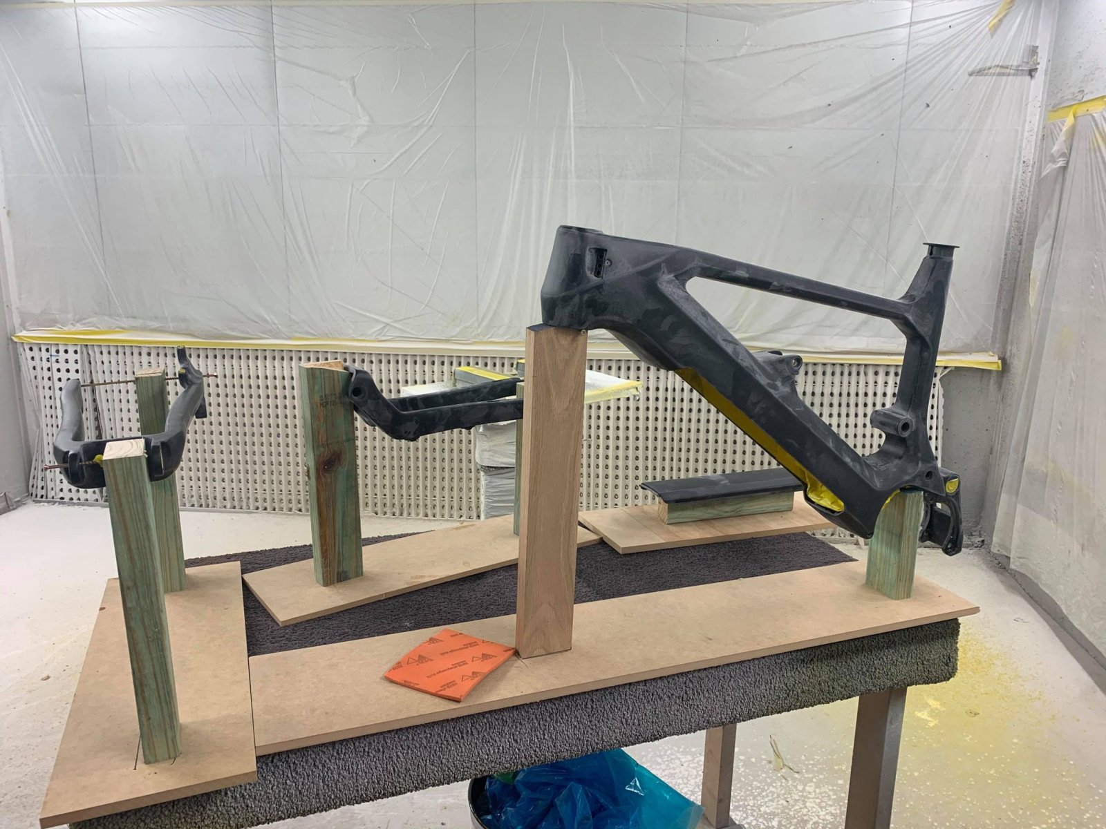

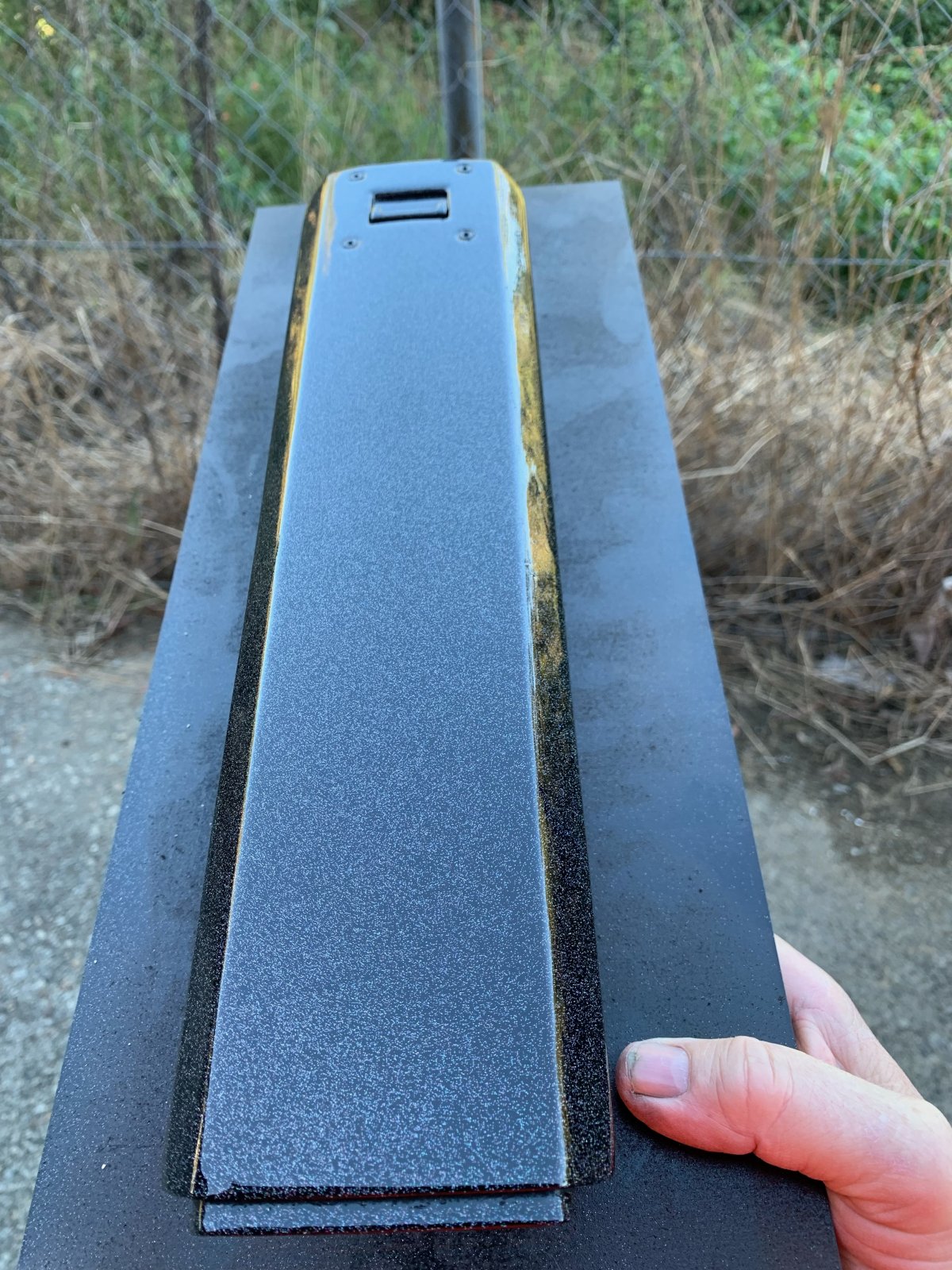

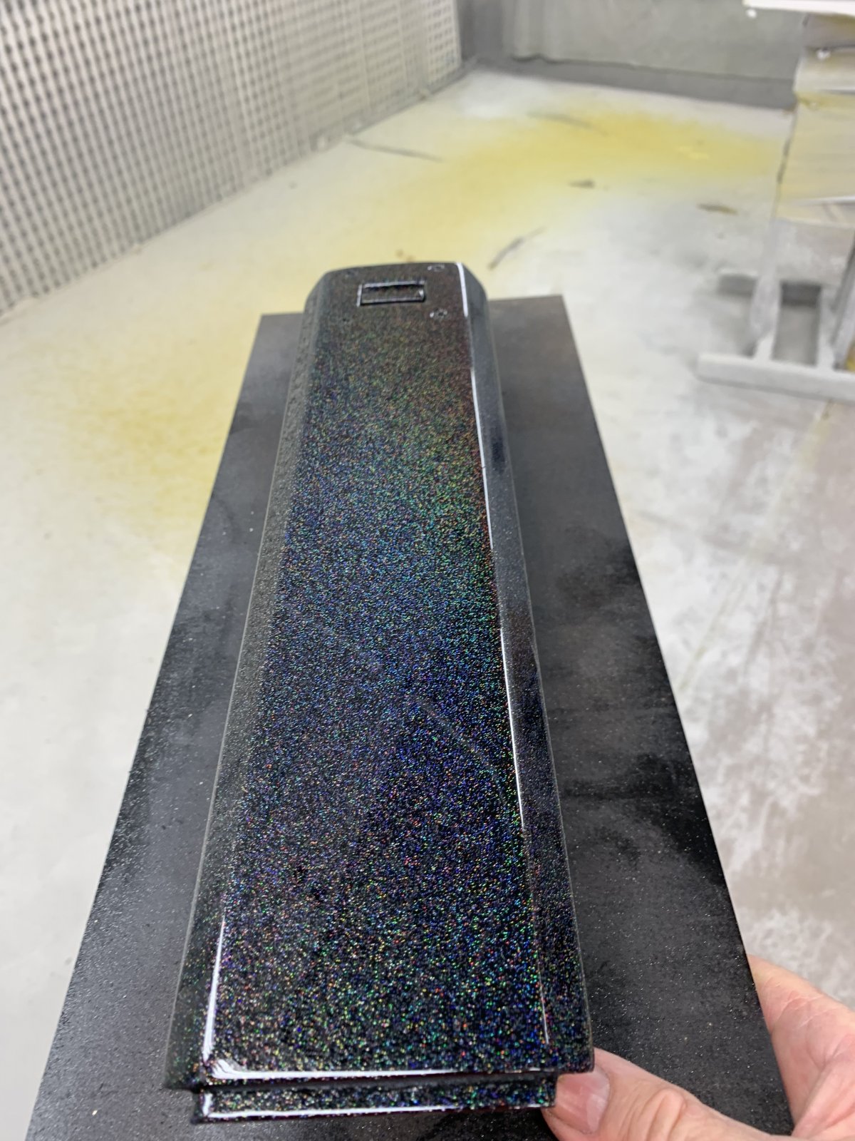

It looks as though you're doing a great paint job on the frame

Thanks
yeah its was a lot but i didn't get hit for duty and gst. I have a business interest in china and so it was easier to do it this way

My offset bushes turned up but im a little concerned as the bush had to be pushed in via a press. Now the pivot point it going to be the through bolt. I am considering removing them and putting in normal ones. When they are in there the suspension will not move at all. I have not tried sitting on it but you will think you may get a little movement from the swing arm. Thoughts ??
I have rockshock rl deluxe and they are sealed bearing at the thick end. I always thought all bushing are press fit. Even if you go back to the original bushing they will still pivot on the bolt. Having said that, these off set bushes are brass. Brass is a softer metal than the bolt, so will loosen up and wear faster then the bolt. Anyway just saying.

Do not fear! Its perfectly normal for what ever make of bush hardware you use, to be a 'tight' fit in the shock eyelet bush. If they were even slightly 'loose' when fitting (i.e. if you can easily push them in by hand), the shock would 'rattle' or 'clunk' during use.
Perfectly normal for the bush hardware to be pressed into the shock eyelet bush. I had to use a vice to fit mine.
Hope that reassures you?

It does, thank you for that
