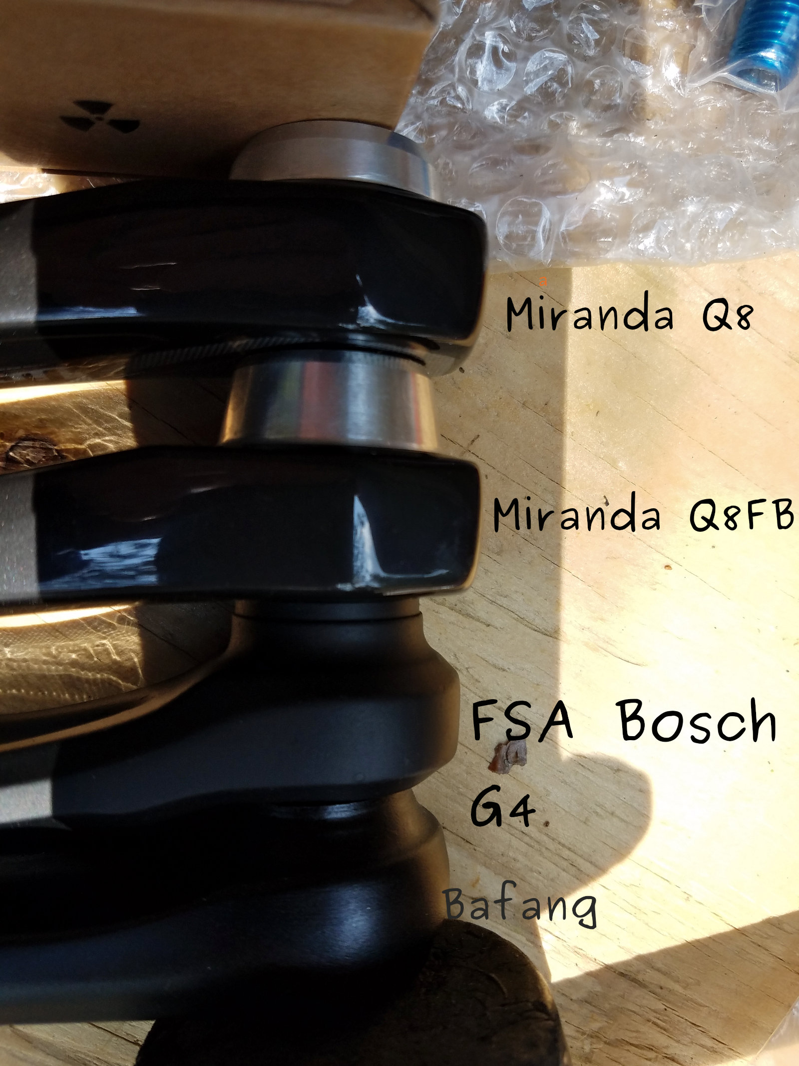

ISIS Crank arm measurements for the M820
Outside to inside overall. Offset only
Bafang 27.7mm 8.2mm 220g
FSA 27mm 9.3mm (Bosch Gen 4 arms) 205g per arm
Miranda Q8 29mm 9.4mm
MIranda Q8FB 32mm 12.5mm 155g per arm
With the miranda Q8FB, my feet are flat on the pedals. Previously, my feet were shifted outwards to the edge of the pedals.
