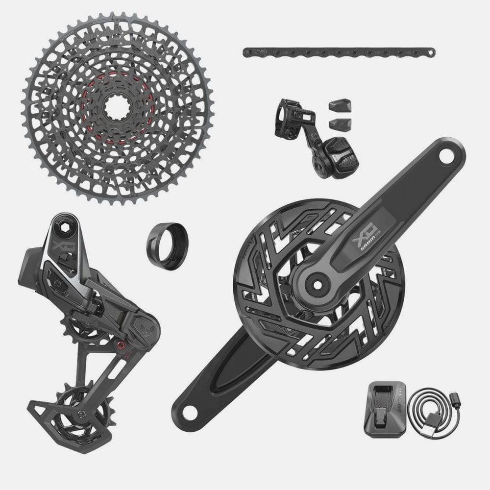

My T-Type has shipped, so I was watching the installation video in preparation for fitting it tomorrow.
On the SRAM site, there is a bike calculator that tells you chain size, and key position specific to your model.
It asks for brand, model, wheel size, frame size and where you have the adjustable geometry set.
I tried all options out of curiosity… and the only difference is a 27.5” wheel (doesn’t matter where the flip chip or chain stay adjustment are) is 116 links, and a 29’er is 118 links. All setups need the key in position B.
I wonder if everyone who has swapped from a mullet to 29’er knows that they need to add a link to their chain? I’m also curious whether Specialized provide the S-Works (or Pro) models which are fitted with T-Type with extra links should you decide to run a 29” rear wheel?
Anyway… the setup ‘sounds’ incredibly simple, so hopefully it’s as easy as the videos suggest when I try it tomorrow evening!
I had the same dilemma when installing transmission on my Gen3 Levo. It required 120 links in low mode and 118 in high. As I frequently changed between low and high I sized to 120 links and had zero issues in either mode.
For the SL I sized correctly to 116 links as I'm unlikely to change to full 29er anytime soon, if I do, I'll buy another chain.
If you wanted to lengthen the chain, you would need to use 2 powerlocks as it wouldn't be a good idea to rejoin existing links using a pin that was previously removed when you spilt the chain.
Re-joining the links is a no-no as I found out the hard way. I had to add a link on the SL2, and had a whole heap of unused XX1 links in a tub... so I carefully added 1 with my Park Tool chain tool, and had it so it was nice and supple.
On my first ride, and the first real climb under load, the chain snapped - and I was stuck! I didn't have any tools with me, and was miles away from my house.
I then tried again, and the next time I rode the bike up a 20% climb, it snapped again. I fixed it with a power lock in a couple of mins - as I had my backpack with me.
My chain has had 2 power locks on for the last few weeks now - knowing that my T-Type will be here soon.
I'm sticking with 29" for now, so I'll go with 118 links on the new chain.
When you push out a pin, the head breaks off. This is the washer looking thing you see around the chain breaker.
If you're starting as a 29er then it will be easy for you to reduce the length of the chain if you ever go mullet...
I am having trouble understanding why the chain length would be different. The chain goes from the chainwheel to the cassette, the distance between those should not change no matter what size wheel we install?

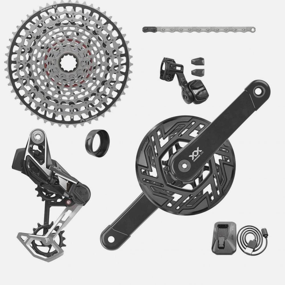

Cheapest way to buy it for the Levo SL is as a 104bcd groupset. You'll use everything in the groupset apart from the chainring.
X0 is the way to go, same performance as the XX but a little cheaper. It also looks like GX will be with us soon...

I bought the XX from Swinnerton Cycles, as I wanted the magic wheel. I used QuidCo to make the purchase, and got (or will get) £25.24 cashback, and also got £13.40 back for using my Chase bank card. It ended up being a few £'s over £1300.
Hopefully can get a little back off that by selling on my XX1 AXS derailleur, 2 x chains and cassette once it's all fitted.
27.5 = short chainstay position
29 = long chainstay position ie +10 mm, so longer chain ;)

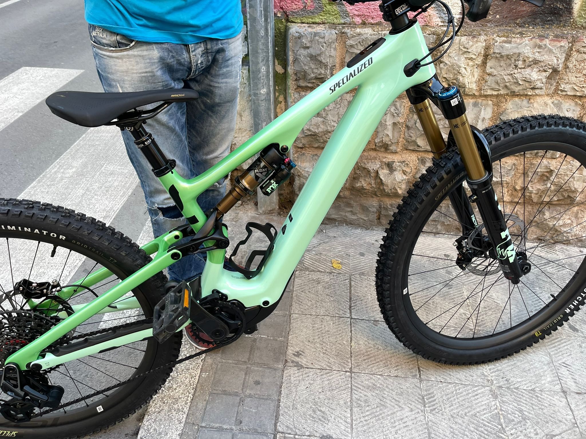

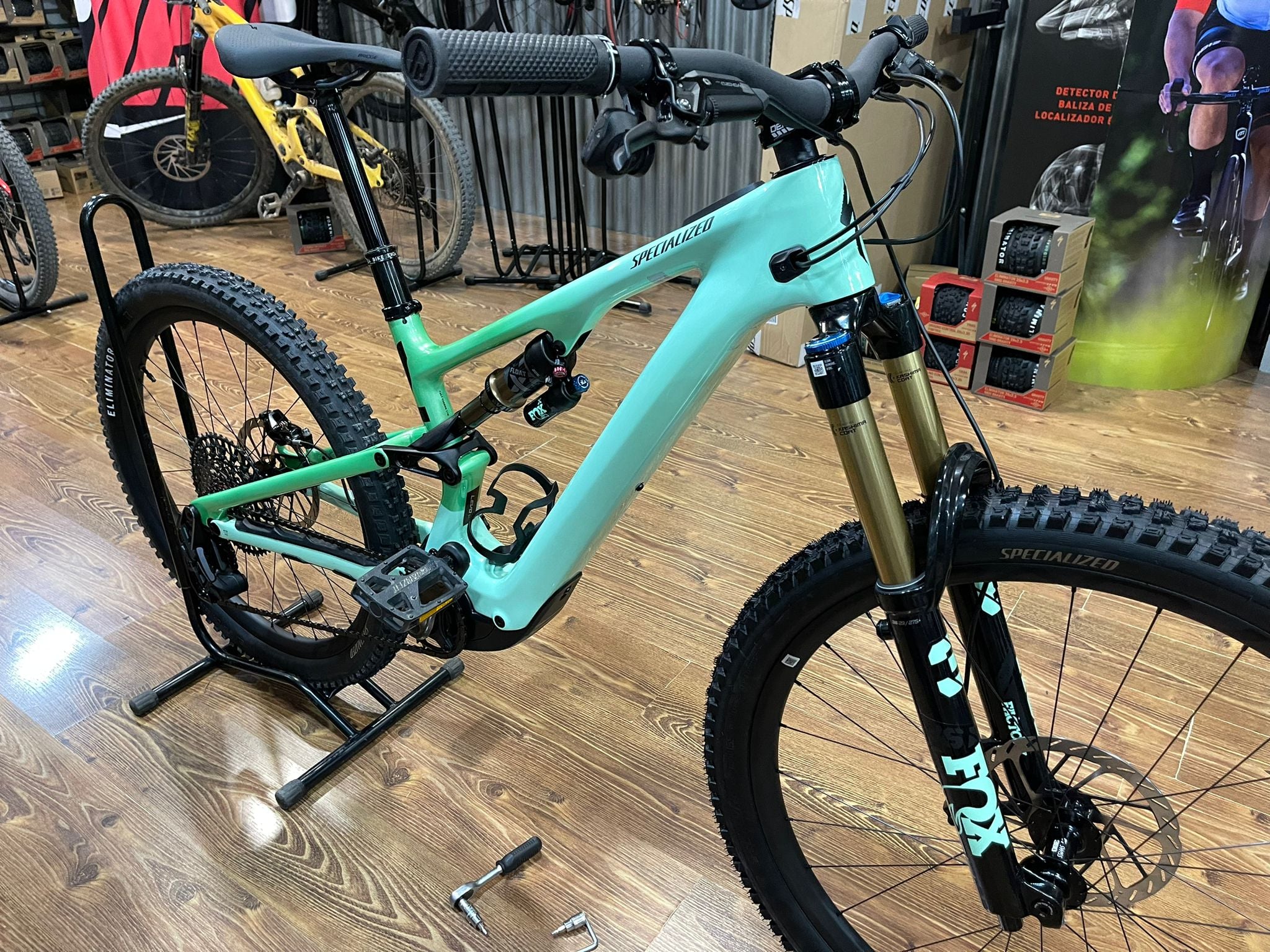

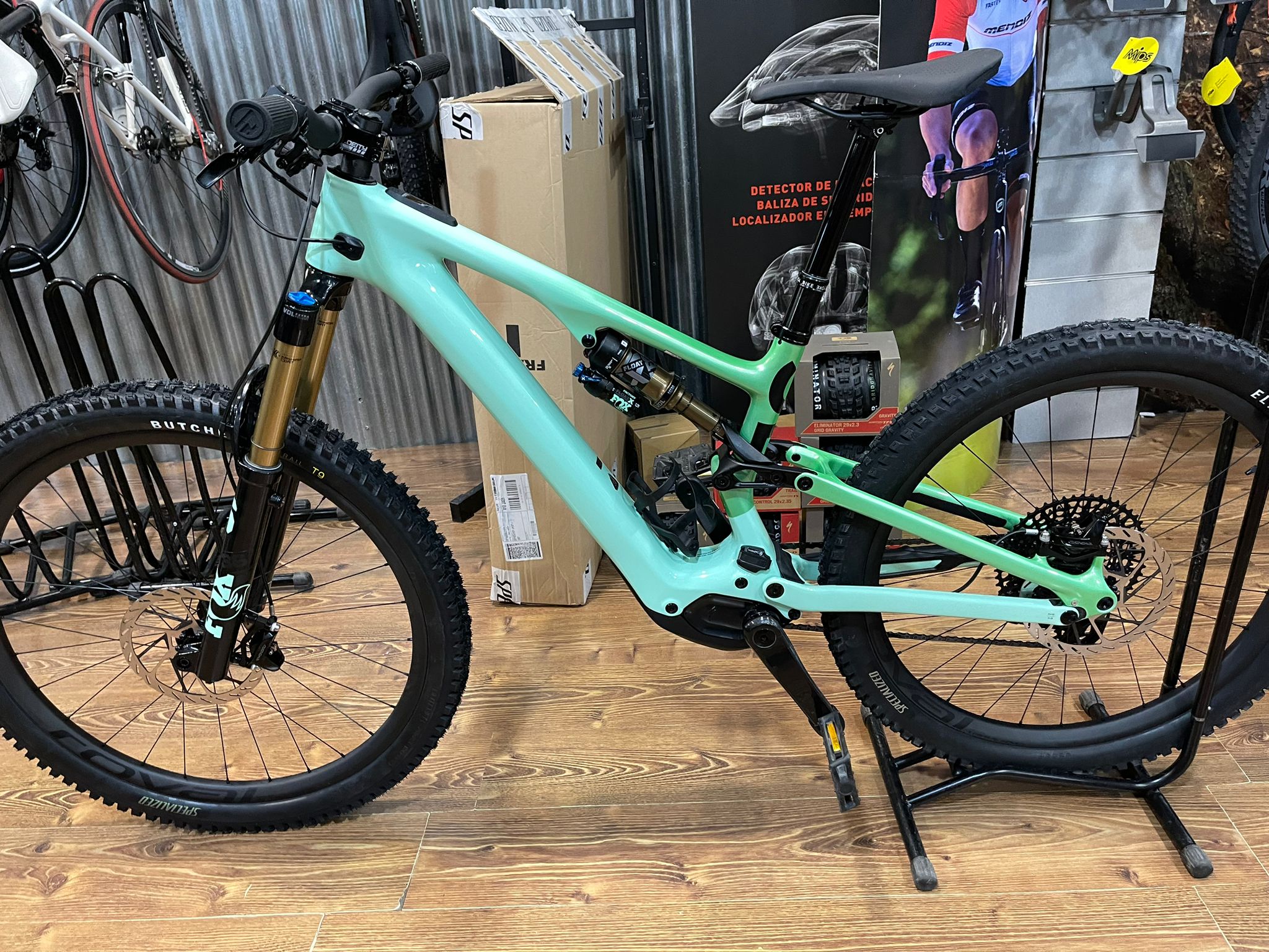

The PRO are already in Spain
ad81a5ad-4ca6-40eb-ab45-755d3b3c7750.jpeg f64d72a9-f214-4a95-8019-1f1822008a66.jpeg cc69987b-95f9-4724-80c5-43df30030dd9.jpeg
That is incorrect. For 29 you are supposed to change the rear dropout position which results in a longer chain stay.
